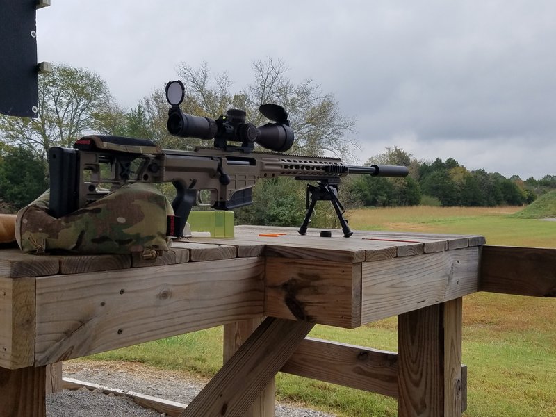

TheGerman Got to take the old girl out for a walk last night. Shot great as expected. Got a good laugh when my buddy shooting him Remington 338 Lapua was crying about how much recoil he was fighting even with a can. Another guy that was out there with us told him to sell his piece of shit and buy a Barrett without me saying anything to instigate it!!! Masterrace indeed
Take 3 with the damn picture posting problems.
[IMG2=JSON]{"data-align":"none","data-size":"full","src":"http:\/\/i1383.photobucket.com\/albums\/ah303\/triplesknives\/D1933853-57F3-4CB3-A89B-5288CE10AA2C_zpsj06frrkc.jpg"}[/IMG2]
