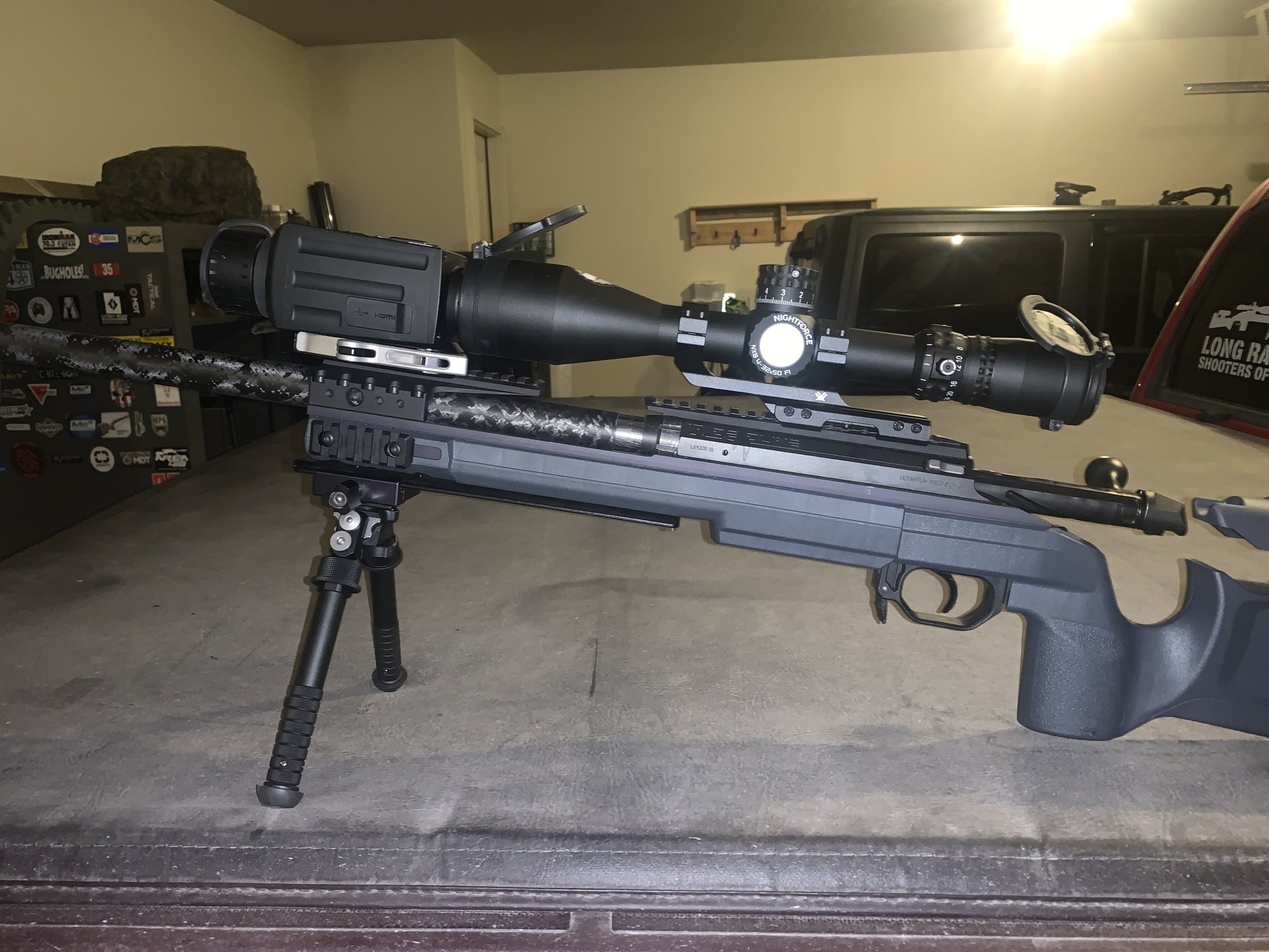

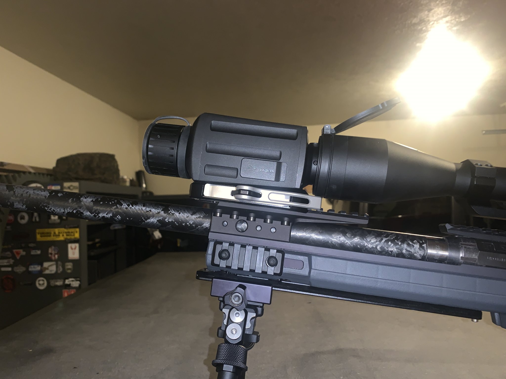

    For those of you considering the objective mounts...
    I'd vote just don't do it given my past experience with objective mounts from other companies & the weight of this thing...
    You also need to to push down on buttons & twist on thermal for focus
    Leverage is a powerful force
    Maybe your accuracy requirements will allow for the flex though so take this with a grain of salt
    That is a very good point i haven’t considered. If I were to go this route sounds like a bridge/enclosed forend would be the better way to do for use on my bolt actions. Thanks to everyone for the feedback.

    ...sounds like a bridge/enclosed forend would be the better way...
    Finding a way to rail mount my previous unit is how I "fixed" my accuracy issues.
    Don't get me wrong maybe Burris/ steiner have figured it all out and know how to beat the issues... but physics just seems to favor this being a loosing proposition
