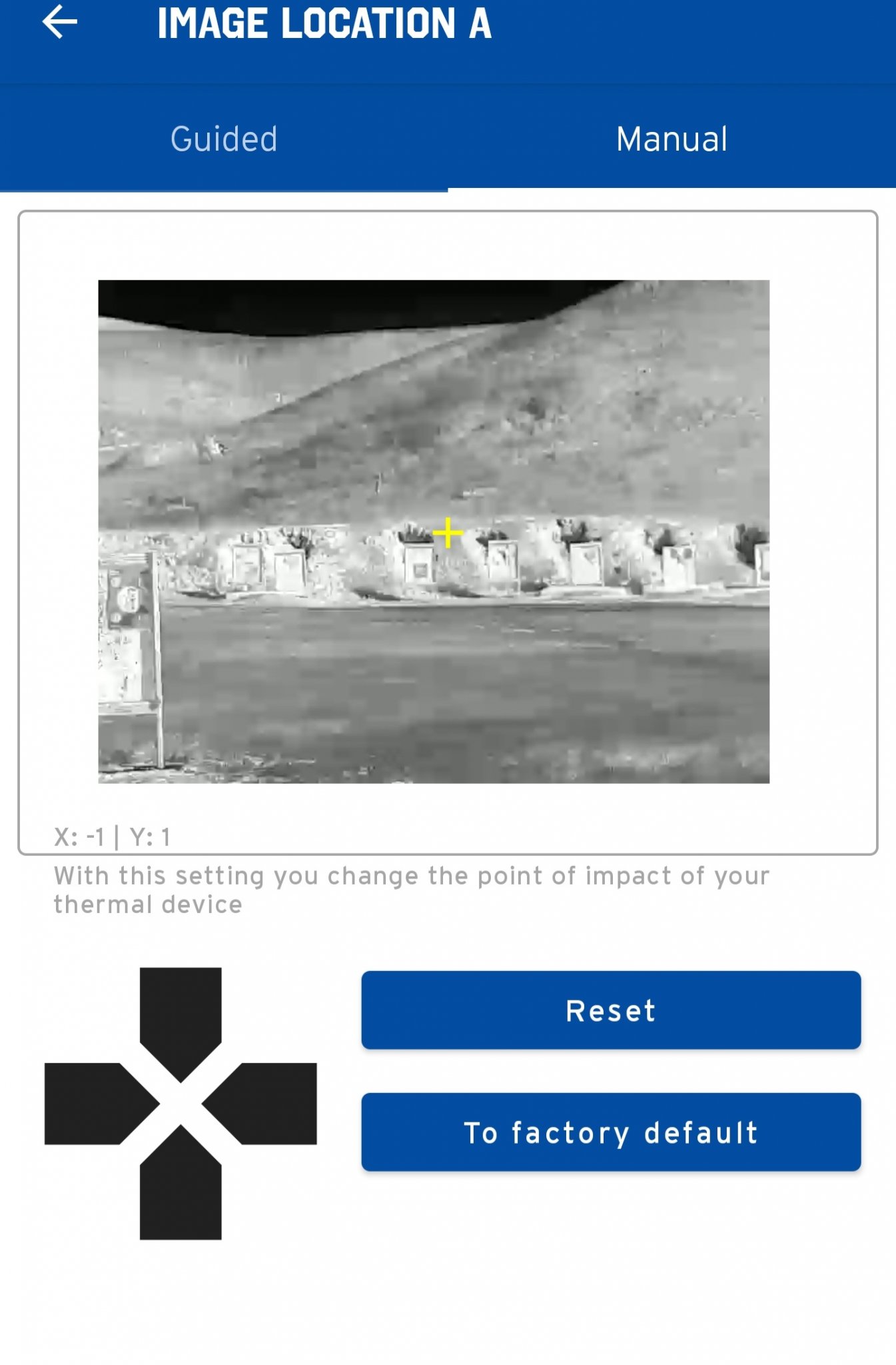

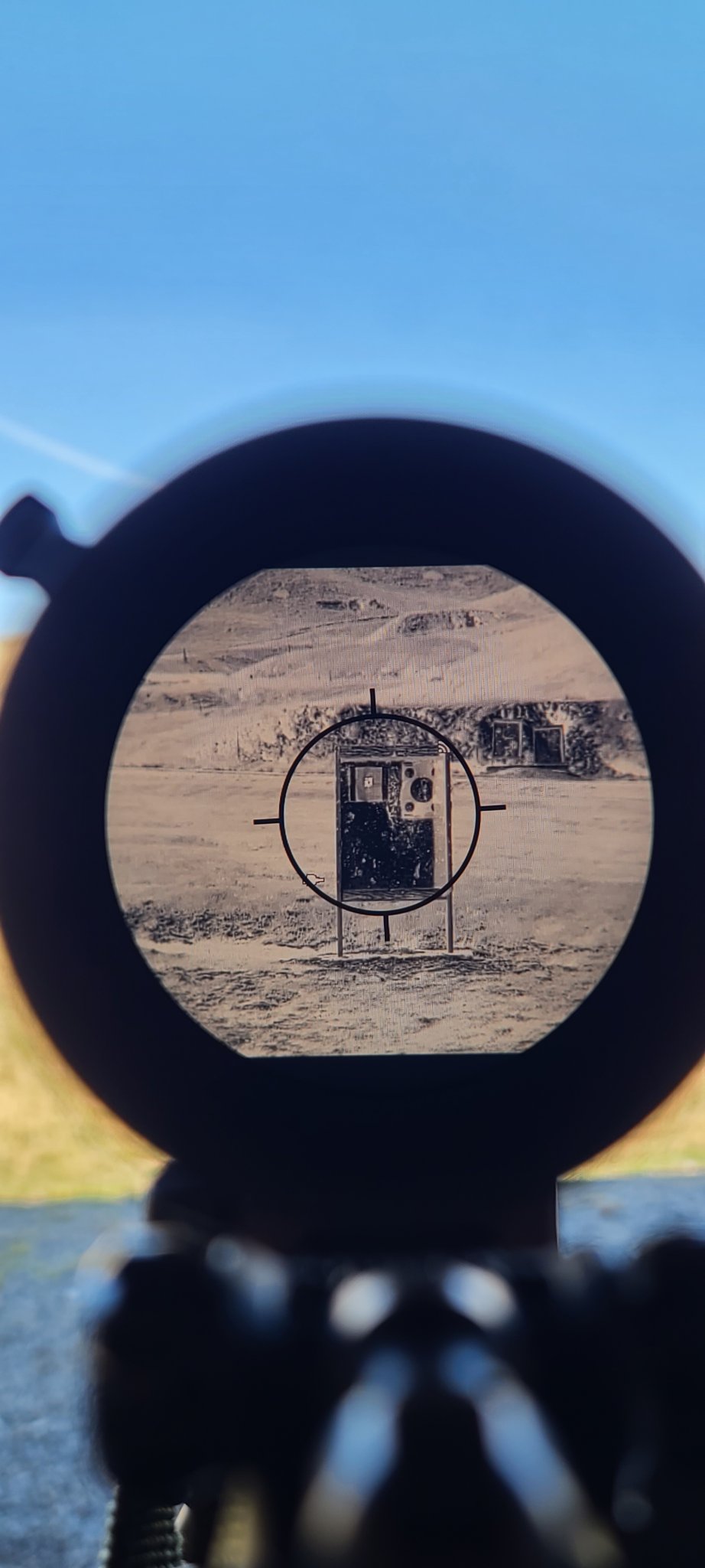

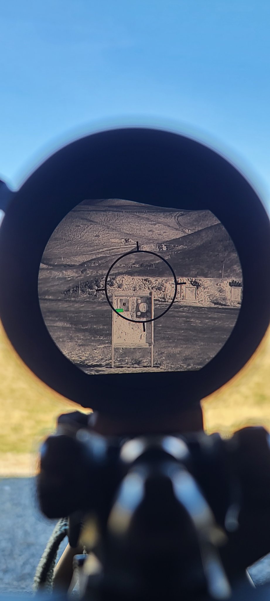

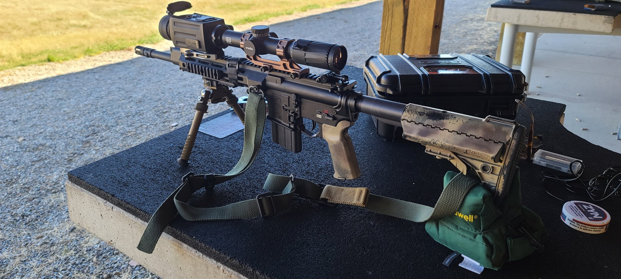

Finally took the C35 out for a test run. Collimated it, shot it, the works.
Zeroing was easy and can be done with the wifi enabled on the Steiner App. You can actually watch the display moving when doing this. It will save your settings and attached them to the scope. You have 3 save settings for different rifles.
Upon turning the unit off and on, dismounting and remounting, and disconnecting then reconnecting the app, it seemed the unit retained zero (which was what I was hoping for...obviously).
The image is.....damn good. I'd risk to say that it looks almost BAE like in the detail, sensitivity, and realism (if you play with the settings, that is)
For 1999..... you can't find a better 640 res clip on and I'll take that to bank all day.
Anyway, here's some pictures. The target is at 25 yards, EOTech vudu 1-6×24 was at 2x optical magnification.

I think I'm following the question and I'll try to explain the entire process as its in my head so you can get whatever info you need out of it. If I'm not following / answering your question / thought process just send me a message and we can plan a phone call or hit me with a follow up question so that I can get on the correct path
This should apply to most thermals with profile options. I'll apologize now cuz I'm not sure how to say this in short form...
The profiles are coordinate saves.
You are saving "zero" coordinates for each profile.
Basically doing the same thing you do in a day scope.... when you adjust X & Y coordinates in the program its the same as you'd adjust the elevation and windage turrets on your normal scope... but on a day scope we spin our turrets to 0 as a reference. Can't really do that on a thermal. We always have 0 0 as it came from the factory amd we basically recorded how many "clicks" we needed on the turrets to get poa & poi to the same place
So if you have 3 rifles let's say a 22lr / 223 / 308.
Let's say we throw the Thermal on The 22lr and we go "zero" it.
Let's sat we did this on profile "A" and the result was X -3 Y 4.
Means we needed an offset from the factor thermal "zero" of -3 & 4 to get our poa and poi to the same place
Now we decide we want to swap this unit to the 223 rifle
We mount it up and switch the thermal to profile "B"
We now have to "zero" the thermal for this rifle and let's say we end up with X 10 Y 7 to get our poa & poi in the same place
Need to mount on your 308
Swap to profile "C" and repeat the process to find "zero" coordinates
From now on...
We should be able to mount the unit back on the 22lr and simply change to profile "A" which should move your reticle to X-3 Y4
Shoot stuff
Decide later you need to mount it back on the 223 just mount it the same way and switch to profile "B" which should move reticle to X10 Y7
Shoot stuff
Need to switch back and forth 50 times no problem just mount the same way and use correct profile for each rifle
Now to get to where I think the disconnect might be...
let's say you rebarrel the 223 Or trade it for another
Profile "B"s zero coordinates are now worthless
We don't delete that profile necessarily, but we can edit the "zero" coordinates to go along with our new barrel / rifle
So we mount thermal on the new set up and select profile B
This will move our reticle to X10 Y7 cuz that's what we had saved... doesn't matter though... you can just "zero" (poa/poi) for new rifle from here or you could move to X0 Y0 and then "zero"
However you do it... you will end up with new coordinates to get poa & poi together for the new set-up. Let's say it's X5 Y5... hit save.
From now on profile "B" is going to move your reticle to X5 Y5
All these saves are just coordinates for a zero the same as spinning your turrets on a scope.
If a scope had no profiles I could just punch in -3 & 4 when I mounted to the 22lr
And change it to 5 & 5 when mounting to my new 223
I could also do a factory reset of the scope (which will likely set all profiles to X0 Y0)
Set "A" as -3 & 4 and "B" to 5 & 5 and it'll be ready to throw on either again and shoot stuff
And the above basically applies to clipon or dedicated scope but with a clip on you are usually moving the screen a certain number of "clicks" from factory zero to make your day scope not need to be moved.
Alternatively... you could always leave a clip on unit at X0 Y0 and mount it to twenty different guns...
But you'd have to adjust day scope for the offset.
So rifle 1 might need to spin both elevation and windage a up certain amount to get poa / poi together
Then rifle 2 might need to spin both down
3 might need 1mil left and 2 mils up
4 might need 3 moa right and 1 moa down
Now what I wouldn't depend on is buying 3 of xxxx thermal and think I can zero a unit on this rifle and if it dies I just punch in same XY coordinates on another of the same... that might not work out
Hopefully my rambling contained the info you needed but if not like I said just hit me again we will help you get it sorted

You nailed it! That was exactly what I needed to understand, Thank you
