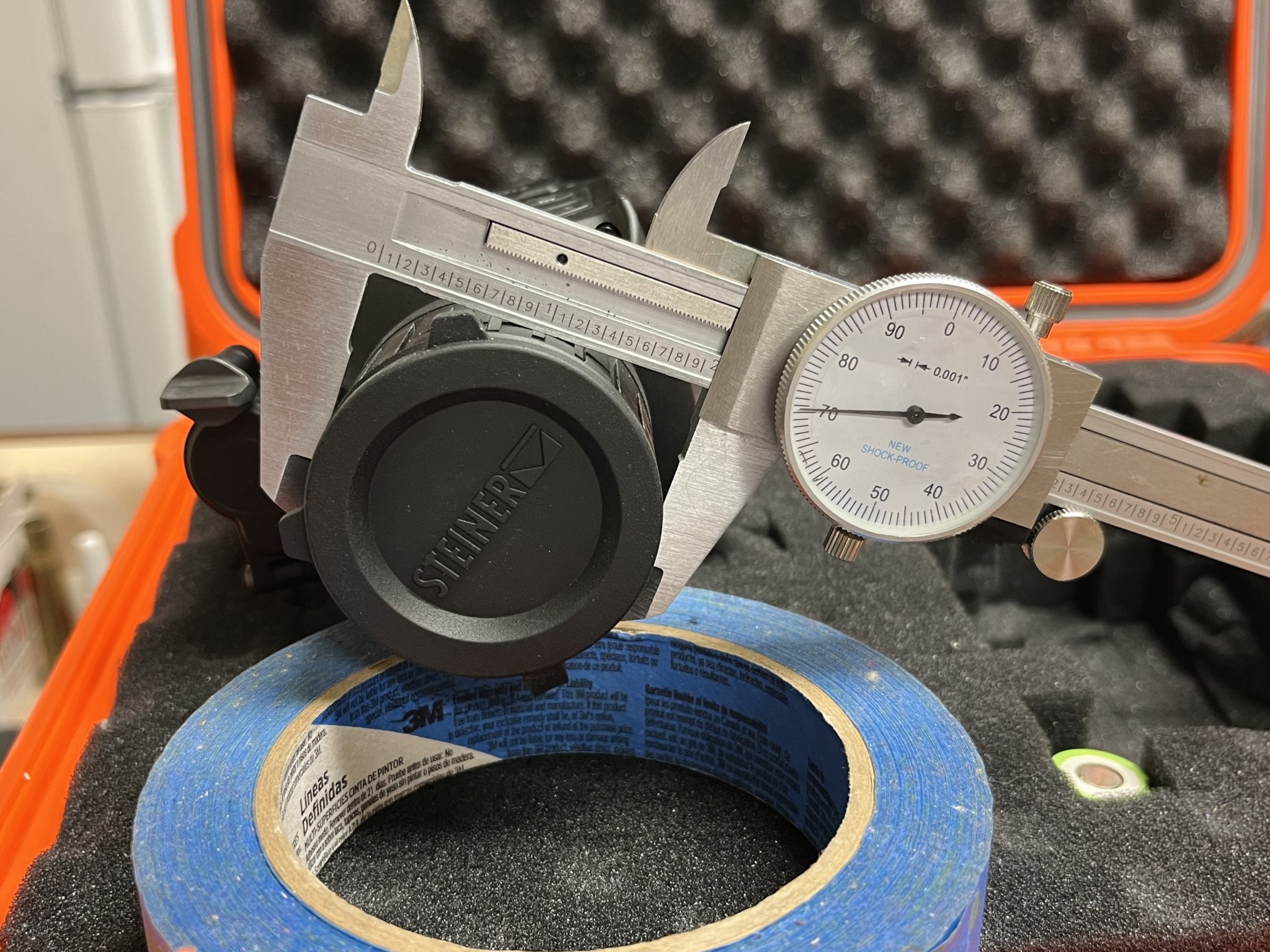

If someone is willing to get me dimensions I can start offering them. Already off custom throw levers for hide members that are $15/ea.
Gonna have to lean on someone else..... I just shipped my C35 off yesterday so won't have one for a couple weeks.
@srt-4_uk is local, I'm going to try grabbing his and getting what I need.
I got 1.970

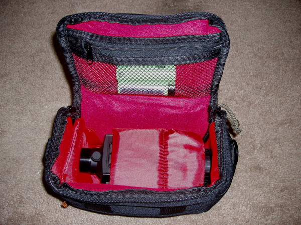

Anybody find a good padded case for these? Something I can attach to a belt or a pack or something? I've got a little 8x5x3 molle-ish pouch I'm using right now but it's a wee bit big and not very protective.
