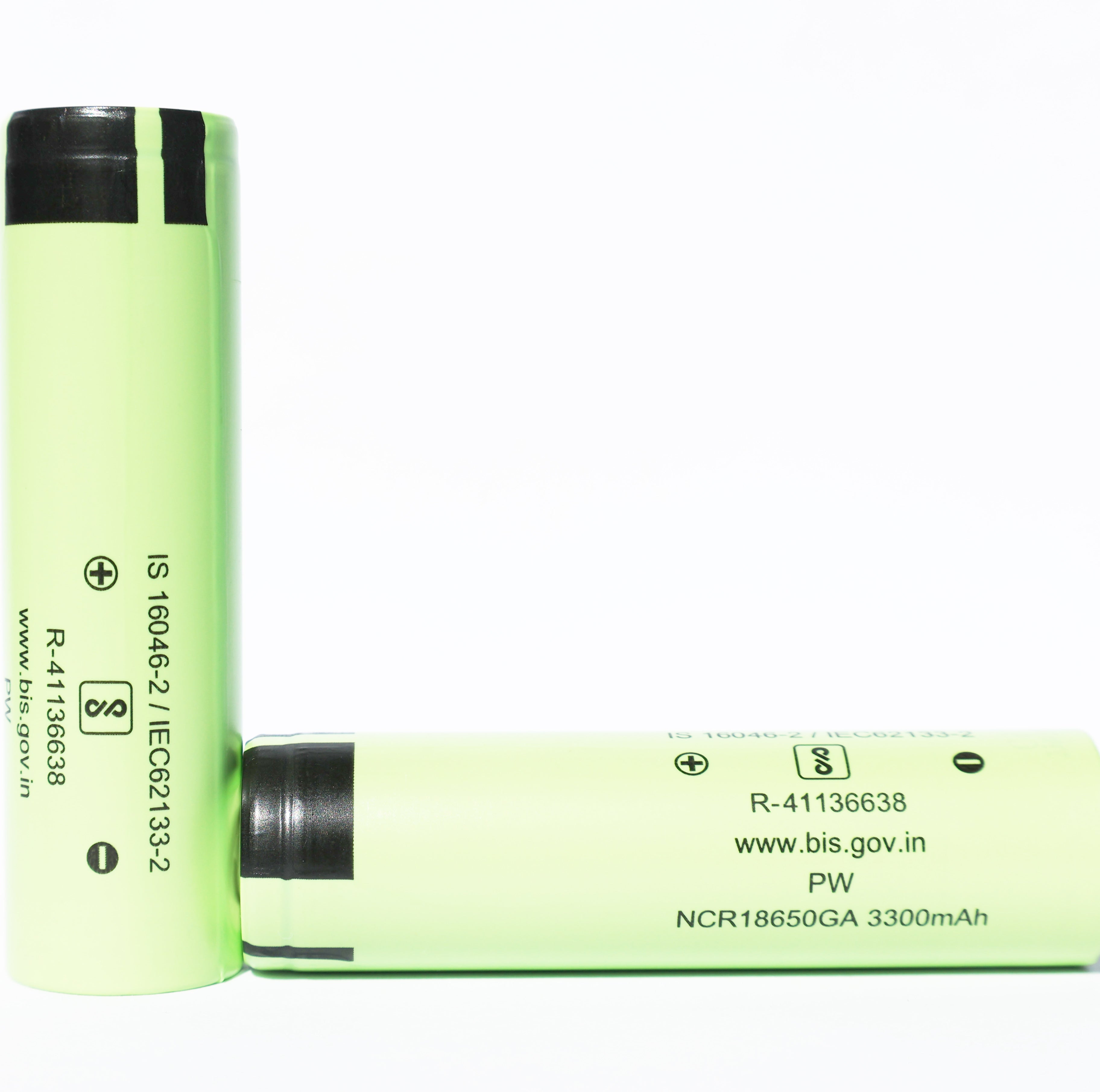

Isn't a standard cr123a 3.0 volts?
That's correct
If I'm reading that correctly you should ensure that you put it in electronics with a voltage regulator of some sort in the architecture
What we "should" do and what we "actually" do due to our own curiosity doesn't always add up. Most units have a range of voltages they will work with, I remember years ago everyone saying you should not use Energizer Lithium AA batteries in expensive camera gear, as a working pro I needed the extended length and so decided to risk it and none of that equipment ever failed using the higher voltage lithium AA's. I'm not saying there's a risk, but sometimes the benefit may be worth the risk, that is something you have to decide.
Rechargeable always scare me unless a manufacturer says they were made to work with them because the voltages seem higher and sporadic when coming off different chargers.
So I always "ASSUME" they have built in a voltage control if they referenced rechargeable batts
They used to scare me, but having used so many with all kinds of different devices with no noticeable adverse side effects I am not so concerned anymore. Maybe some of the cheaper "off brand" batteries which I tend to stay away from anyway may have more of an issue.

I feel similar, that is a crazy high number for mah... we've seen this before with other batteries and those with the equipment have shown they are usually grossly inflated and do not perform as hoped.
These batteries have served me well for several years and last a long time in my flashlights, plus they can be charged with micro usb which most of us have laying around
This is the non-USB version, but there have been times where I brought my light but forgot my charger so prefer the above USB version
These are fantastic for devices that use CR123A and can handle 3.6v
And these are fantastic for replacing AA batteries, excellent for high drain devices
You need flat top batteries, not button top. None of those will work.

Nice. Can anyone confirm what mah comes with the Steiner from factory, 3400mah seems high for factory provided. Panasonic makes good Li-ion but how to know if this is real Panasonic or counterfeit?
That is the battery that comes with the unit.

These are the batteries that I bought.
They are the same as what came with my C35.
