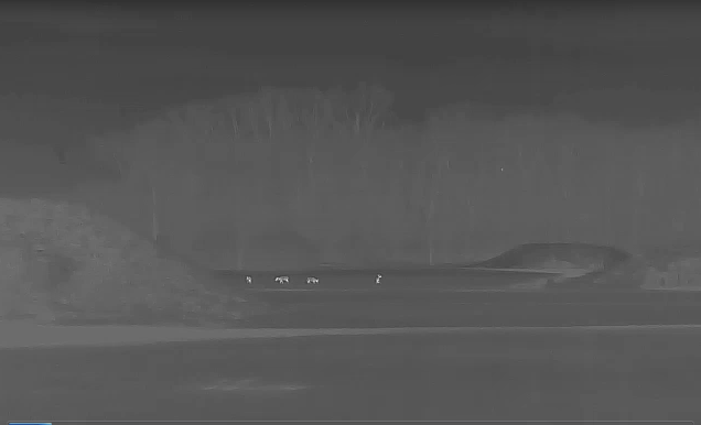

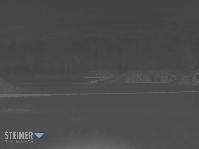

Took mine out to the range on Saturday night, and managed to get a couple of pics. You may have to zoom in on them since they are unmagnified straight from the unit. We were using Grabber sticky-backed handwarmers as thermal targets at 300 and 500 yards. They measure 4"x6". The white dots showing at 300 (right of center) and 500 yards (center) are the handwarmers. No problem targeting them at x4-x6 scope magnification.
Second pic shows 4 deer around 350 yards out. If you look closely, you can see a bird in the trees above and behind the 500 yard berm.

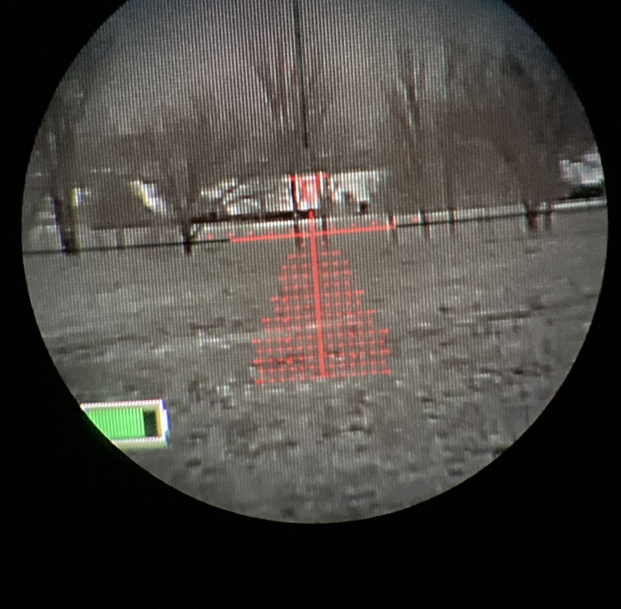

Got my S35 zeroed the other day. Least intuitive zeroing procedure I've ever undertaken, but I got it done.
Temps were in the mid-50s with some humidity, so less than ideal, but a black 6" shoot 'n see left in the on again/off again sun which was then stapled to a 14"x14" white target made for a hot enough spot to put the Steiner reticle on and get zeroed at 100yds.

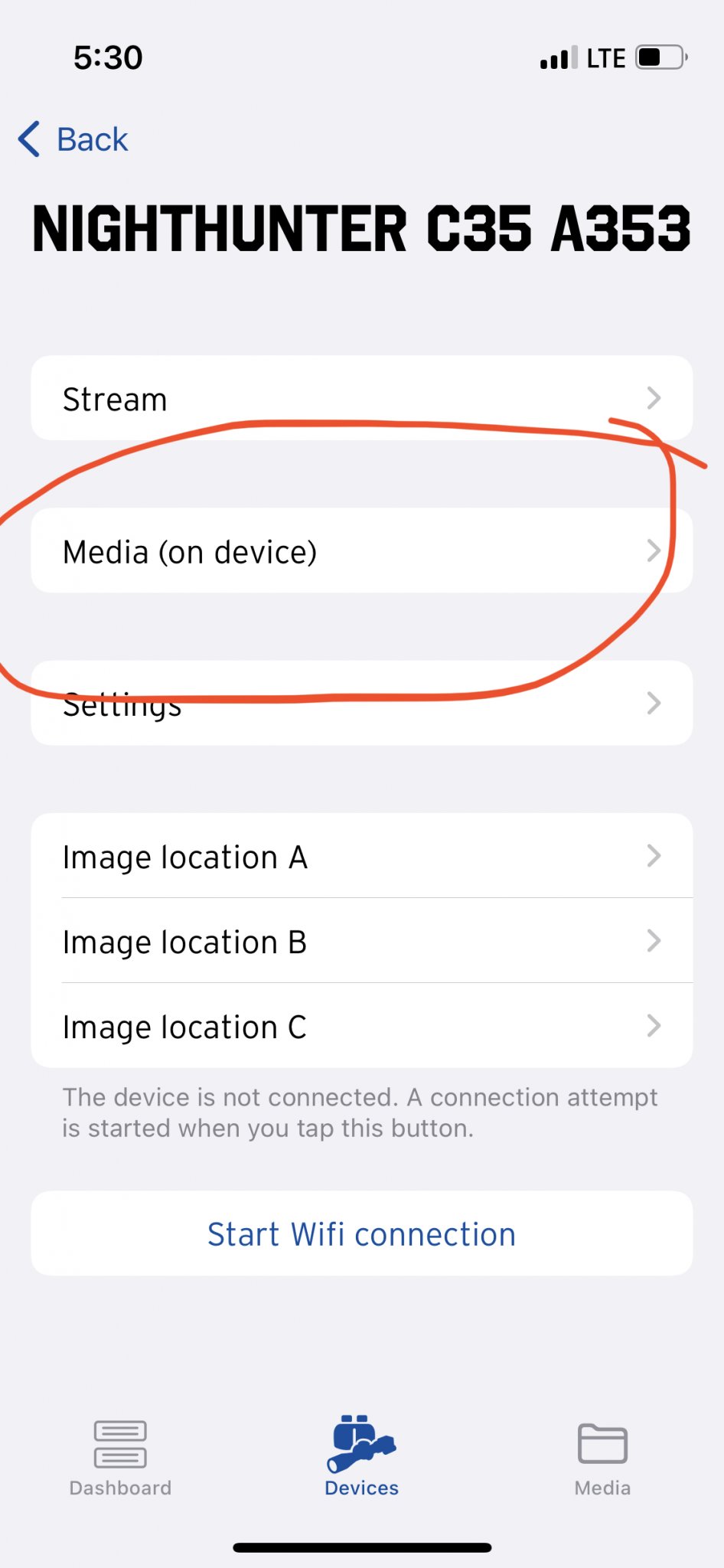

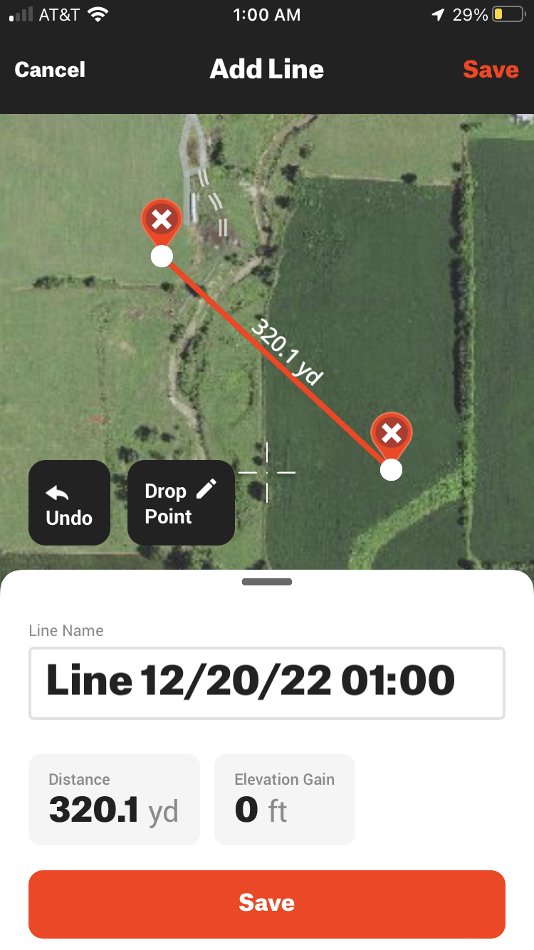

Called in a bobcat last night and got a neat video of him through the c35 but I have no idea how to save the video to my phone.
Anyone figured out how to do that yet?
Turn your wifi on and you can share to your phone. Go to media on device and click the file you want. Save it to your device. My stuff is out in the shop, and I’ll too lazy to walk out and get it or I’d post some pics
I did that. I can delete the media but can't save it. The little icon that looks like a rectangle with the arrow pointing up was where I thought I could save it but that didn't work. Gotta be something small Im missing.
Reactions: roostercogburn98
Try turning off the cell service on your phone while connecting via wifi on your phone and C35 (really bluetooth I think). I had some issues streaming from my S35 to my phone and turning off the cell service fixed that. I wonder if it'll help in this instance too. The directions in the manual are pretty poor for these things. Trial and error seems to be the way, though the S35 and C35 do have some differences even though they're the same general electronic guts.

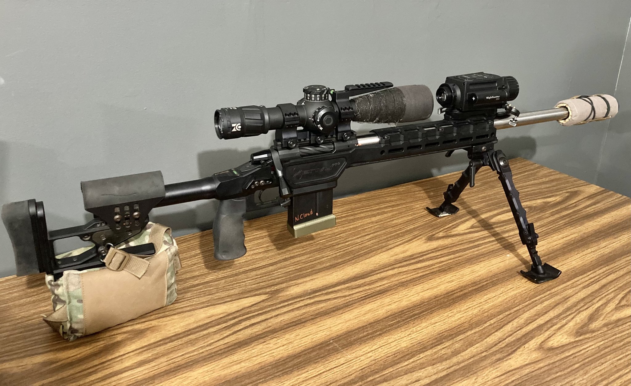

I’ve had some time with the C35 now and i feel that it’s a great value for the price.
Pros-
-Affordable
-Durable
-Easy to adjust settings
-Good picture quality
-easy to zero
-Returns to zero when taken off and put back on
-Usable at mid to high magnification, if you have a positive ID on the target you can zoom in quite far on the scope and make shots. Longest shot so far is 320 yds on a coyote.
Cons-
-Heavy!
-Hard to adjust focus from behind the rifle
-Battery doesn’t last long. That’s ok because you can switch them out or run external pack.
Overall I would buy it again.

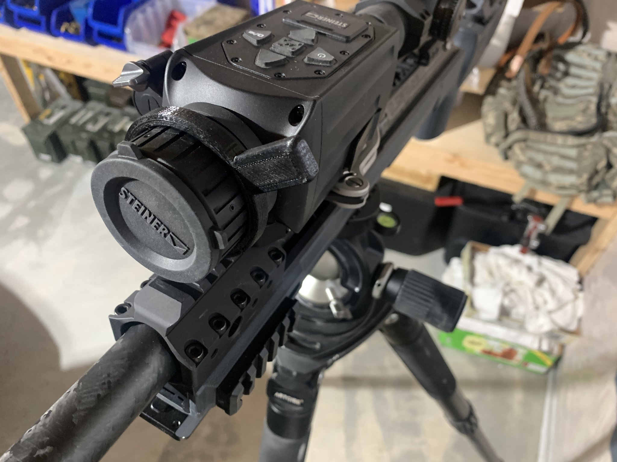

The Vortex Defender O-24 cap is a bit tight on the ocular, but on the good side once it's on it won't move.
The Defender 0-44 is good for the front objective, but it's just a hair looser than I'd like. I bought the 50mm Switchview lever and with longer screws it will fit over the Defender cap and as a bonus holds it in place.
Reactions: Glassaholic
