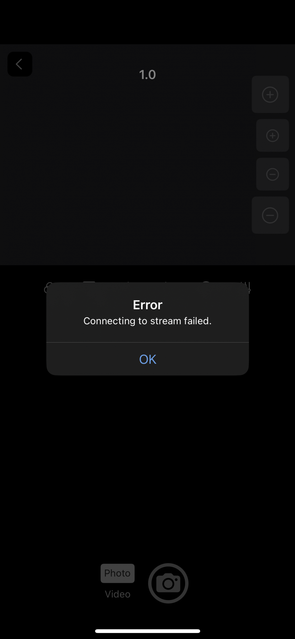

Anyone having trouble streaming their C35 to their phones?
Yes, I can connect, view files and go to settings, but unable to stream live view. I've tried two different phones, uninstalling and reinstalling app, airplane mode, but wasn't able stream. Called Burris today without any resolution. Hopefully they'll come up with firmware fix soon.
Agreed, the live streaming doesn’t work. I could zero the thermal, but it won’t live stream. I deleted & reinstalled the app. Hopefully, my zeroes are still saved on the thermal🙄

Here’s the message

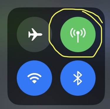

Turning off cellular doesn’t effect anything. I removed the app & reinstalled it without effect as well. It would appear as though this is a Steiner app issue. Great…
Files & Folders is now also checked, but it still isn’t working. This blowz…
Thanks for trying. Do not update the app. Steiner has their head up their ass with this update. I just lost a few hours that I’ll never get back;)

Here’s a response from Steiner:
Comments from Steiner Optics Support:
Hi Lou,
The new update must have broken the app. We are also are not able to stream.
We have forwarded this to our Engineers to get a fix started.
Hopefully they’ll have a fix shortly
