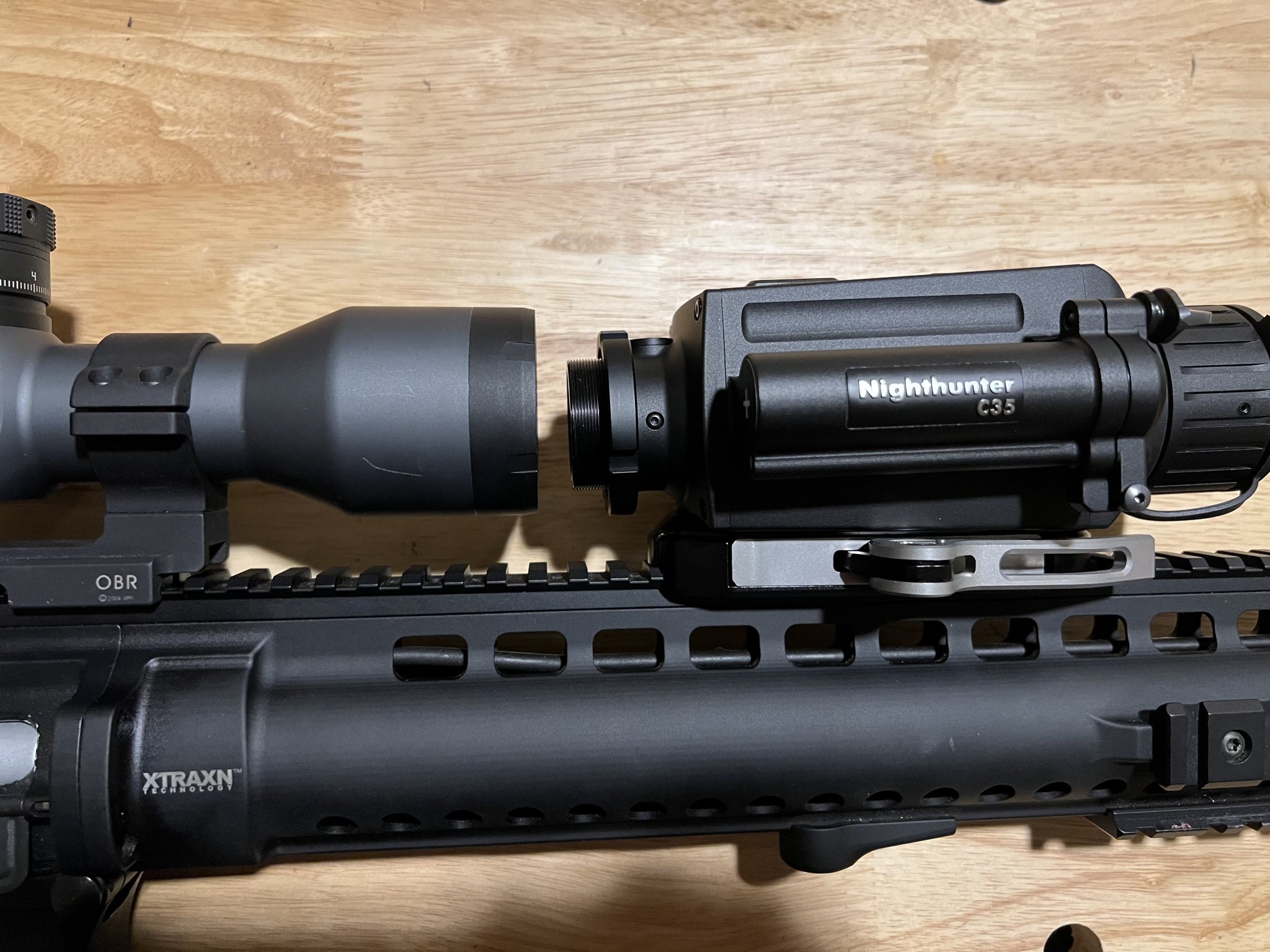

How much rail space do you need for mounting? As in, where the mount actually connects to the rail.
Might be able to get a rough count from this. Just comparing the C35 and the RH25

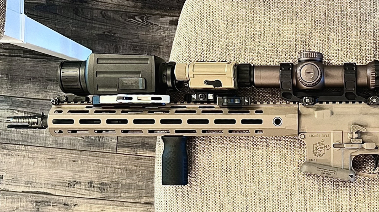

So close. I've been wanting to see one on the MWS, but mine has the shorter rail. I think it will barely fit with my Mk5 25x behind it. If anything, the front objective will hover over the gas block. How did the C35 change the overall feeling of the rifle? Mine currently weighs 15.8lbs unloaded. Adding another 2lbs already makes my shoulders sore thinking about it.

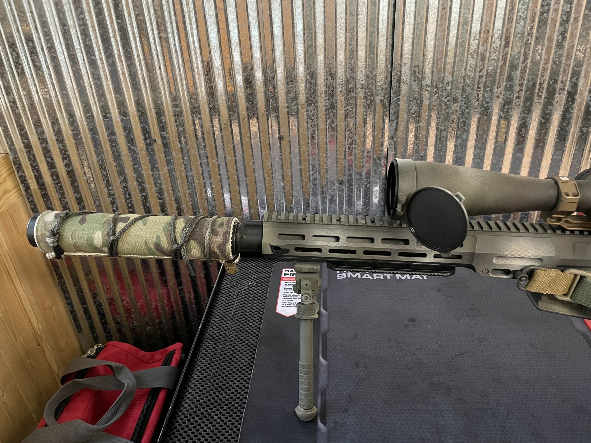

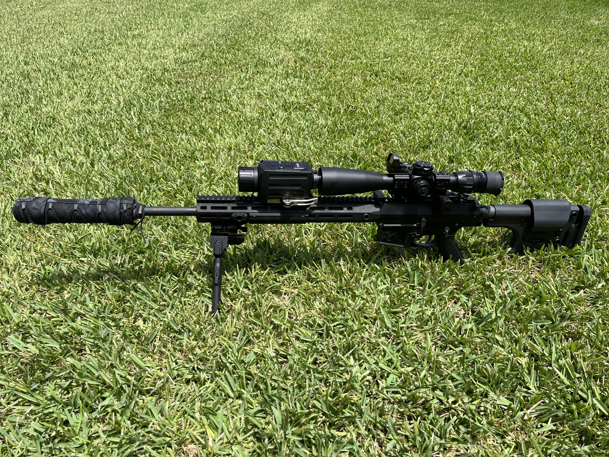

The SR-25 weighs in at 18.9 lbs, unloaded, as shown in the picture with the suppressor. I haven't had a chance to fire it with the C35 on yet. The rifle as is, minus the C35, has a relatively low felt recoil already and it is a smooth impulse. The addition of the C35 will lower the felt recoil even more.
That's surprising. You must have a heavy can, longer rail, and 24" barrel? My MWS is basically the same as yours minus the red dot and not that heavy. I know the SR25 is generally 1lb lighter in equivalent setup according to specs from the factory.
Reactions: DustBun
I weighed the rifle when you asked your initial question because I had not done that since adding the can and the stock and was surprised how much it weighed. Mrs. DustBun has been complaining about the weight every time I make her carry it when we go shoot but I figured she was just complaining about yet one more thing. :ROFLMAO:
The Knights model is the SR-25 E2 PR which has a 20" barrel and it is a somewhat heavy walled barrel. The can is a Knights model 7.62 PRS/QDC and it is listed at 20.8 oz. The scope, a US Optics B-17, is rather heavy at 31.1 oz and then there is the Spuhr mount. The LMT DMR stock is also a bit heavy. The ounces do add up, a little here, a little there. I think the weight problem is because of the DeltaPoint Pro. :LOL:

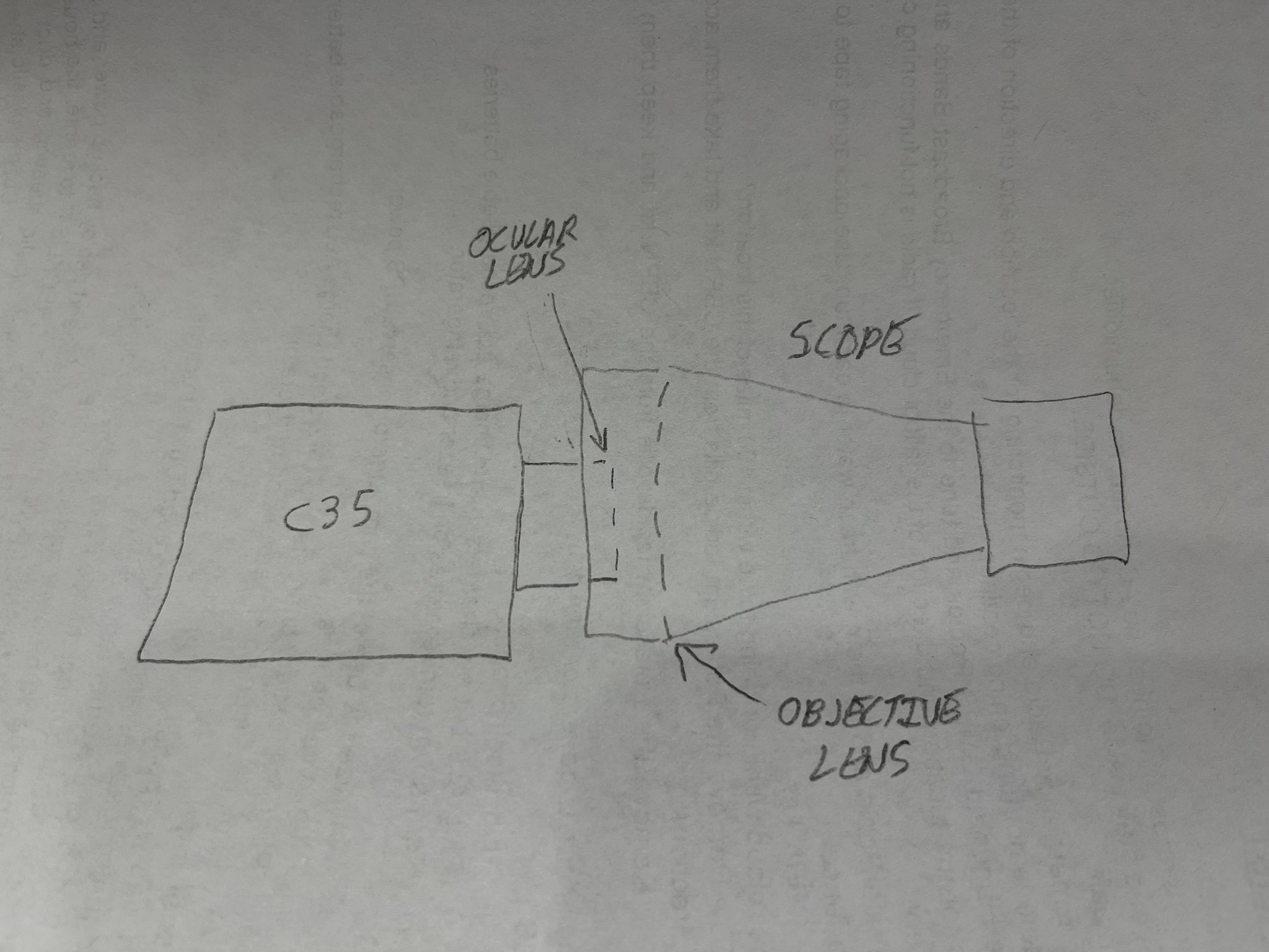

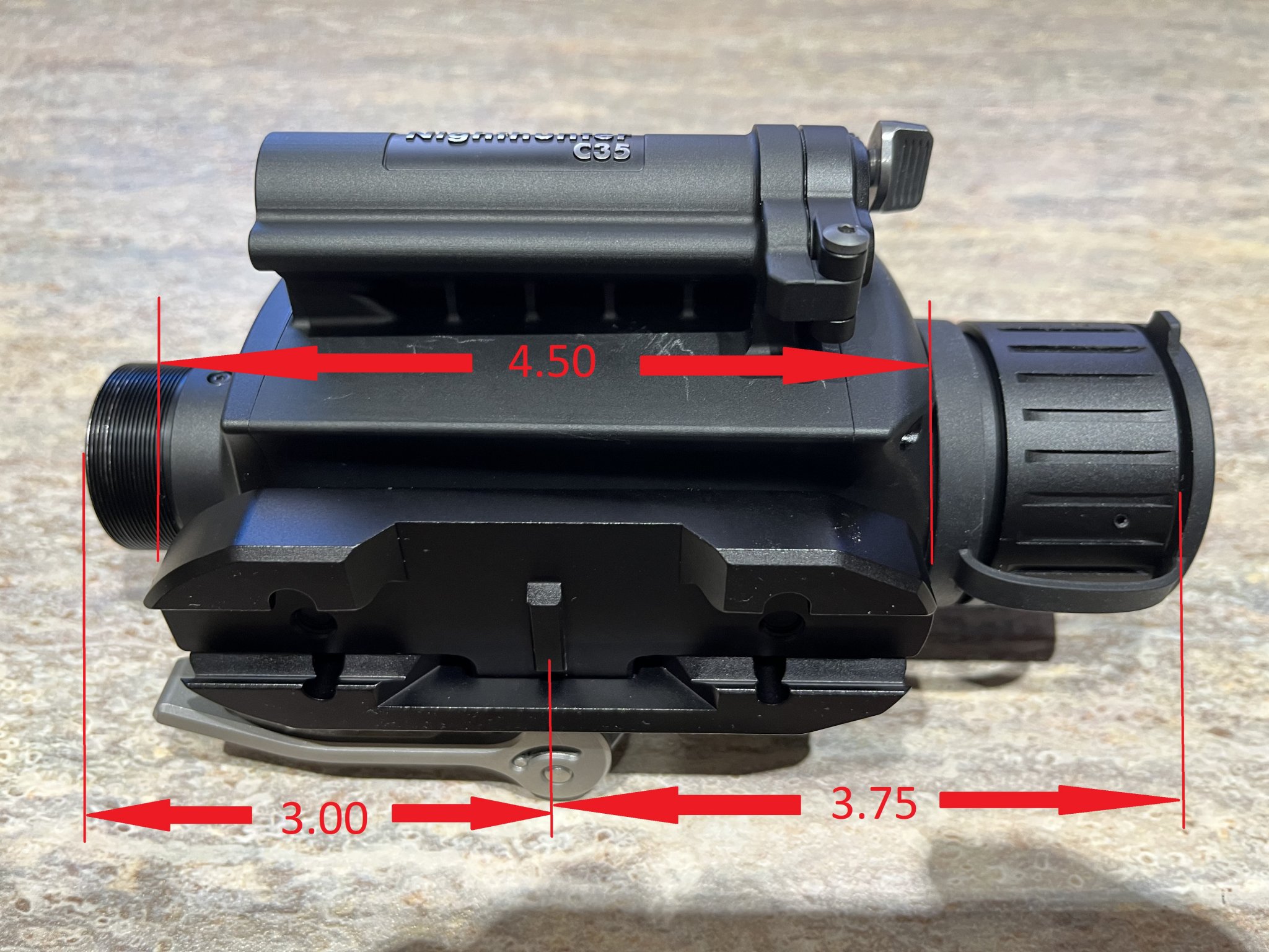

I have 5.5” of room from the end of my scope cover to the last open pic rail spot. Is that enough room?
Reactions: DustBun
Yes, you will have room. I have attached a picture with some dimensions that may help. The distance from the center of the Picatinny rail lug to the end of the ocular is 3.00". From the ocular to the right side of the Picatinny clamp is 3.00"+2.25" = 5.25" so you should get full clamping. The focus ring/objective will extend past the rail as you previously mentioned.
You can also possibly "inset" the C35 ocular into the objective end of the scope to shorten if needed as shown below. Of course being careful not to get too close to the objective lens which could damage it. It will just depend on which slot the Picatinny rail lug on the C35 will work.

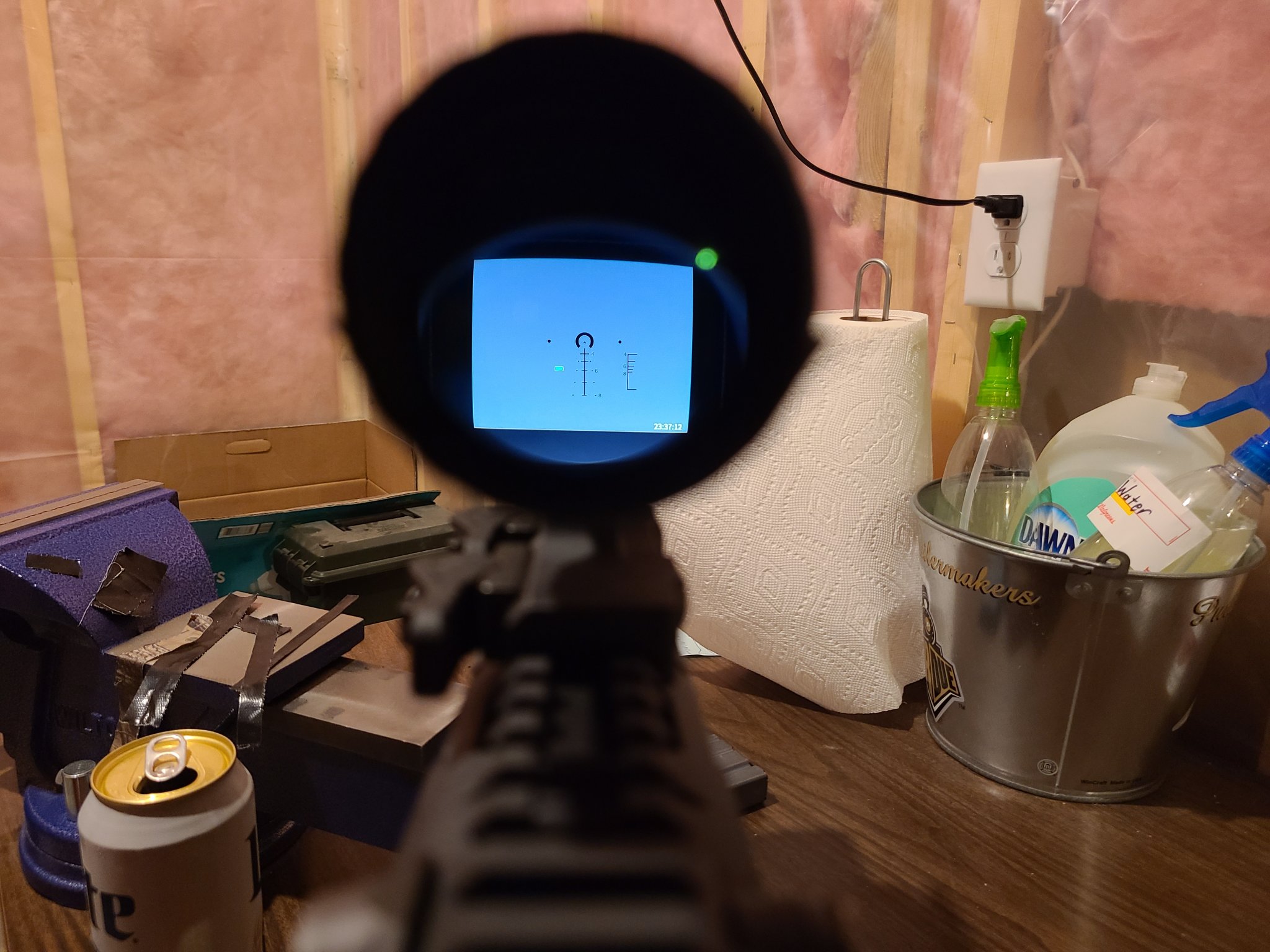

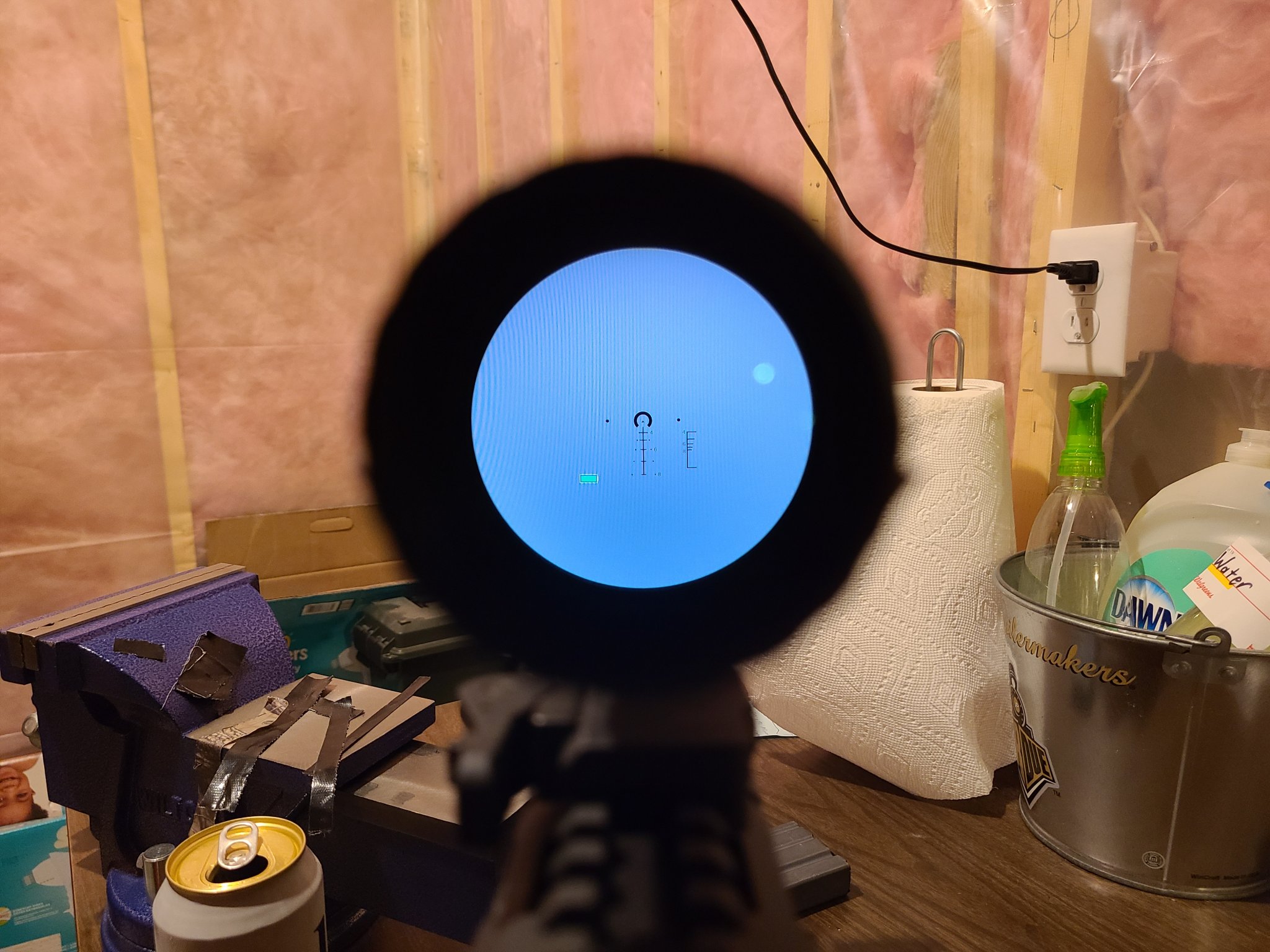

Absolutely. Please consider that this is ONLY IMAGERY. I have NOT fired this on my X95 yet or tried to zero it. I truly did not intend to do so, but may do so now just as an experiment. I doubt it would pose any problems to zero this setup, but have made no effort to do so at this time. See images below taken through LPVO in ADM Recon-H 1.93" mount at 1x and ~2.5x (absolute minimum magnification and lowest magnification where all of LPVO's FOV was w/in thermal output screen, respectively). This is a fairly extreme example of height misalignment, yet the image still presents itself fine. I opted not to glass over the neighborhood with this, so you will have to settle for basement pics :)
I've also started messing with the "enhanced" scene mode and think it potentially holds a great deal of promise for zeroing or aiming in general. We will see if that shakes out practice.
