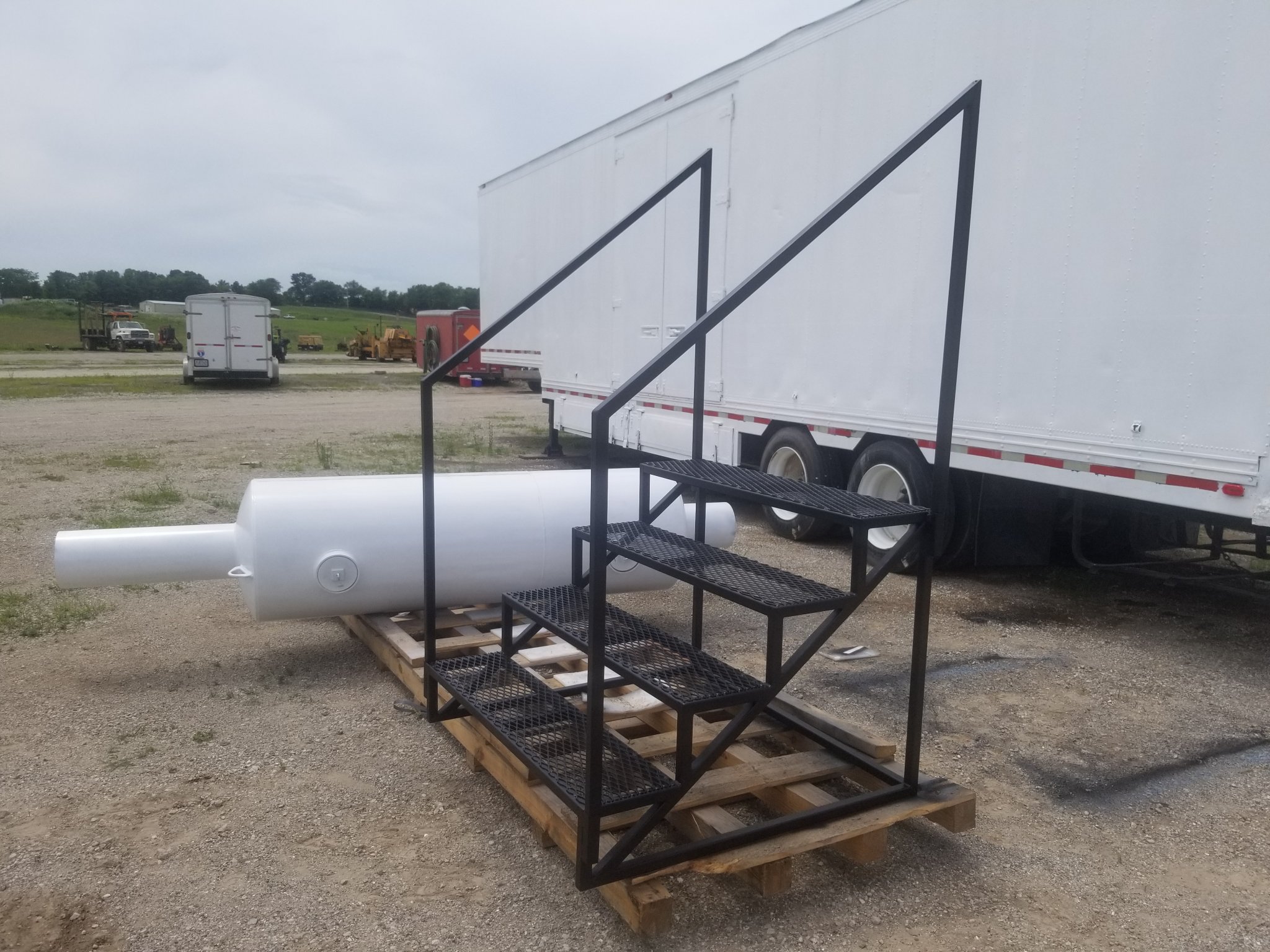

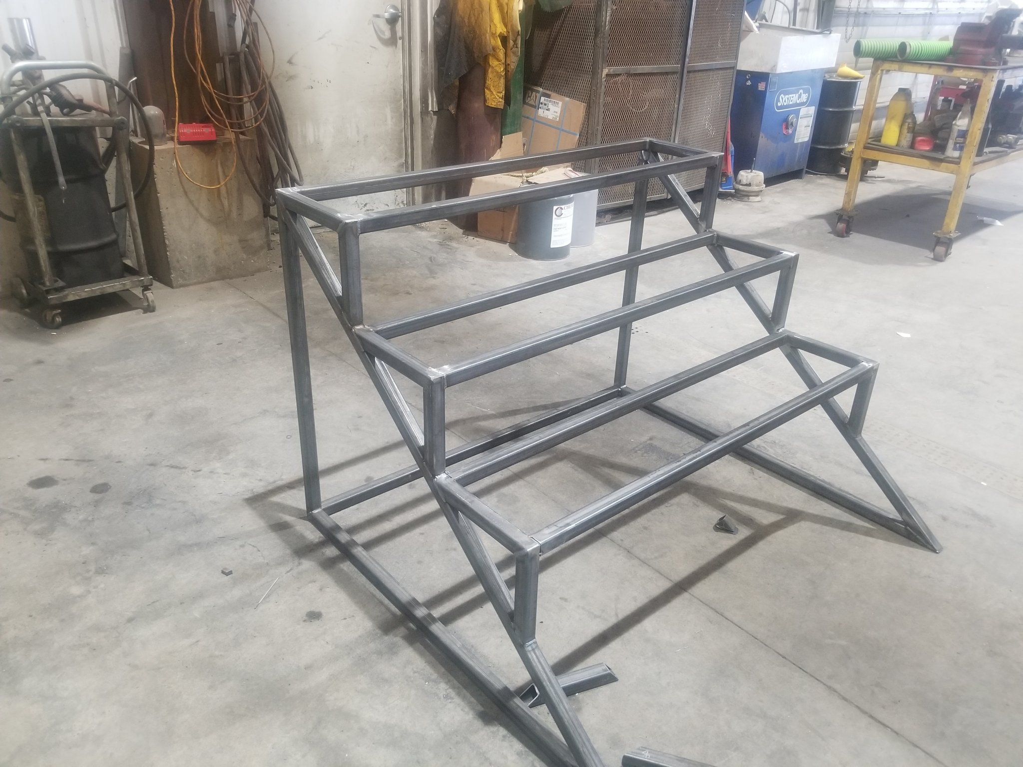

Anyone build steps out of steel? I'm looking for idea on design and material for job trailer steps. They want them light enough that two people can lift them into the trailer. 4' wide and 4 steps total and I have to have removable hand rails.
Reactions: MiniB
Steps out of steel, Yes.
Light enough to move around, not-so-much.
When I built steps years ago, I used those galvanized cat-walk preformed tread section-thingy's..... (I can't for the life of me remember what the hell they're called.) They were strong enough, and light enough, sure. But the real weight is going to be in your stringers.
On a whole different note, there is the 'escalator style' of aluminum steps, if you want to go a completely different tangent. Just being difficult. Hope that helps. ;)
Aluminum prebuilt components you would need to add the rails
What sized men need to lift them? Out of steel is fine for permanent but shitty for portable. They make the perforated treads that are already stamped with grip texture on top. That will be your lightest option
Reactions: Sean the Nailer
This is the stuff that we used to use. "Diamond Grip Stair Tread" though we used to use it for mezzanine and catwalk surface, too.
Oh Yeah: Learn vicariously from one of my co-workers! Do Not walk across a floor made of this stuff, with your hands in your pockets. If (when) you trip and fall, you probably won't have time (again) to pull your hands out of your cover-all pockets. So you don't want to break your nose, scratch the shit out of your face and forehead, and destroy your glasses (again).
HAHAHahahahaahahaaaaaaaaaaaaaa
I'm just sayin'....
They said use steel so that's what I'm doing. The boss said 1 1/4 square tube and expanded metal to cover the steps. It looks like with 14 gauge tube that it will be about 130 lbs. Not ideal but they should be able to tilt it into the trailer. We shall see. I was looking at the bar grating last night thinking it would be better but oh well, I won't be lifting it.
Must not be very big guys using the stairs... 4’ wide with only 14ga 1-1/4 tube will bend in the middle...
We are going to try without a stronger in the .middle but bought enough to build it with one
The ErectaStep units can be easily moved by 2 men. Very light, and very strong.
Bolt together, so no hot work required.
If it was me, I would have bought steps. With material and labor involved, this really doesn't make sense to me. I looked up some that we could have bought pretty reasonable. Not the first time I have seen this by bigger companies.

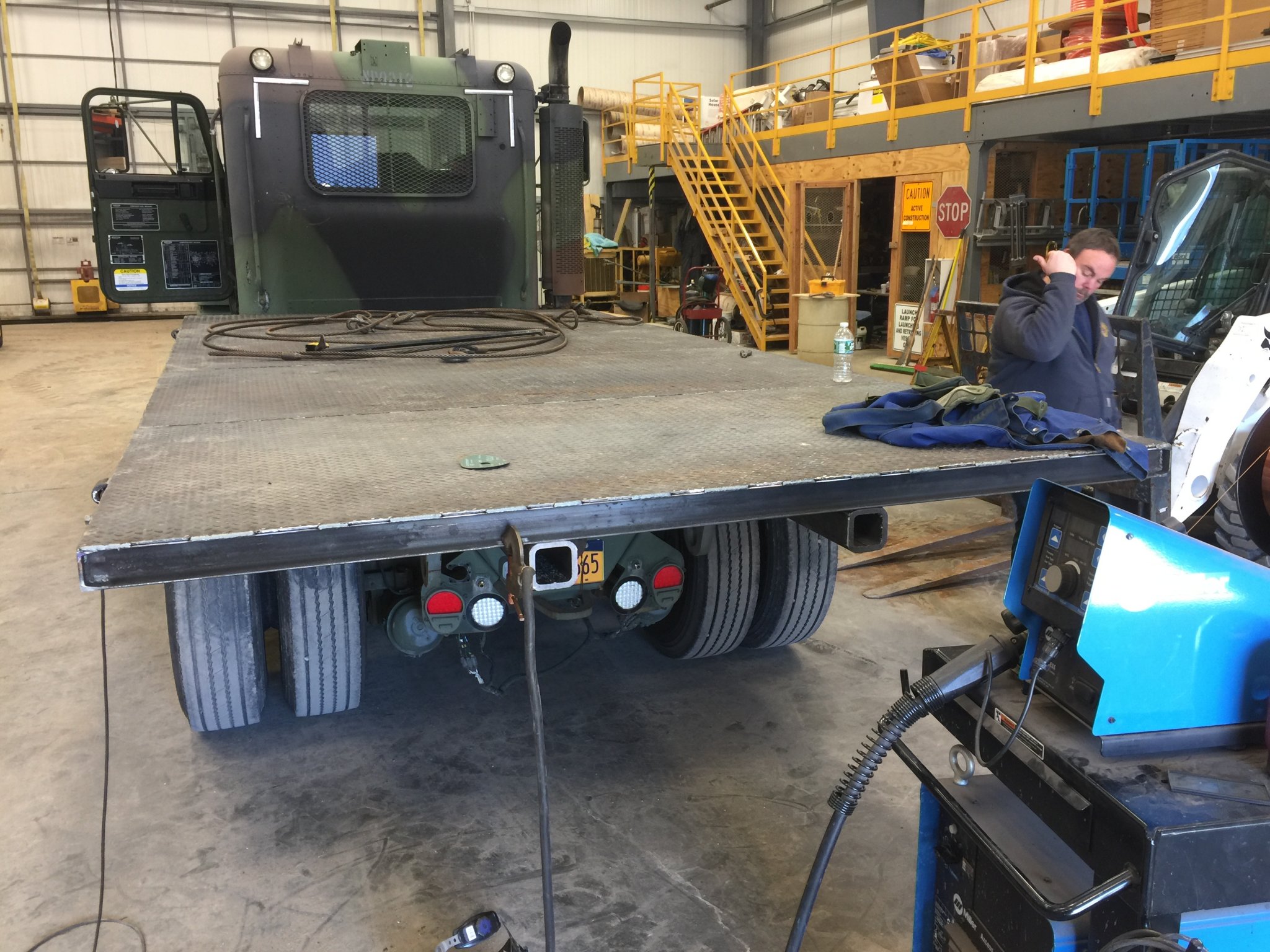

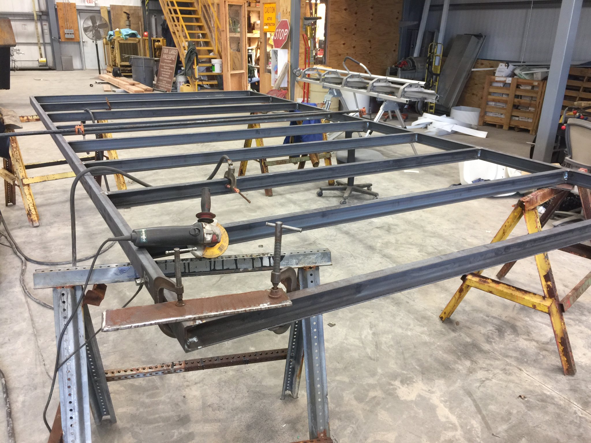

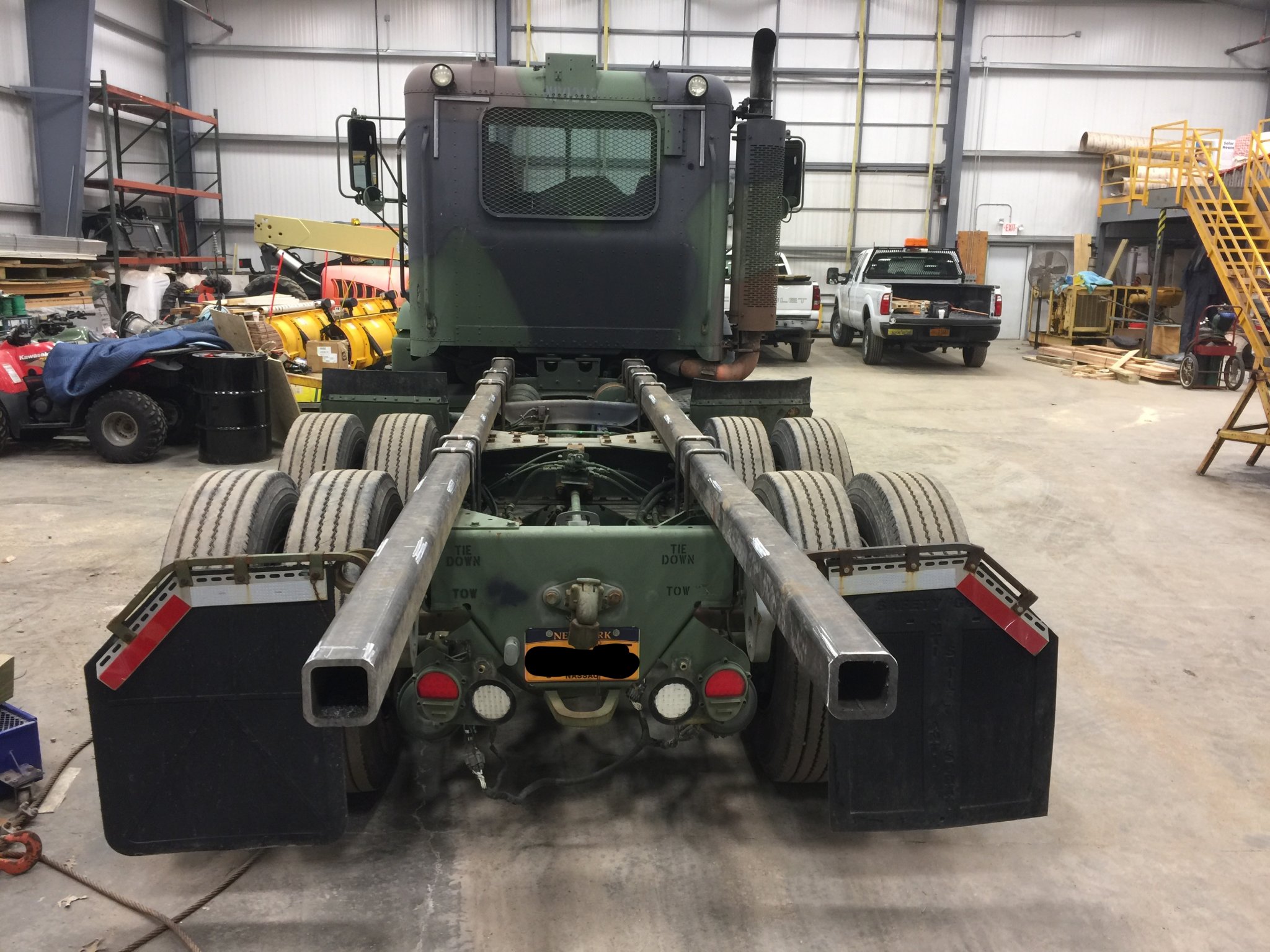

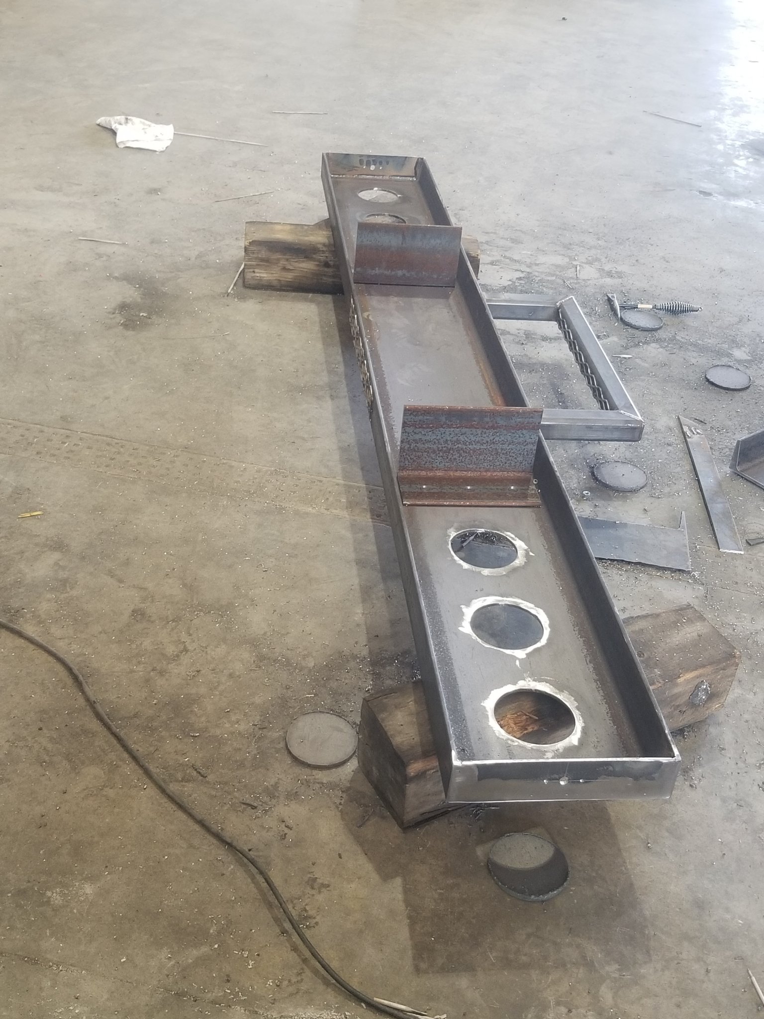

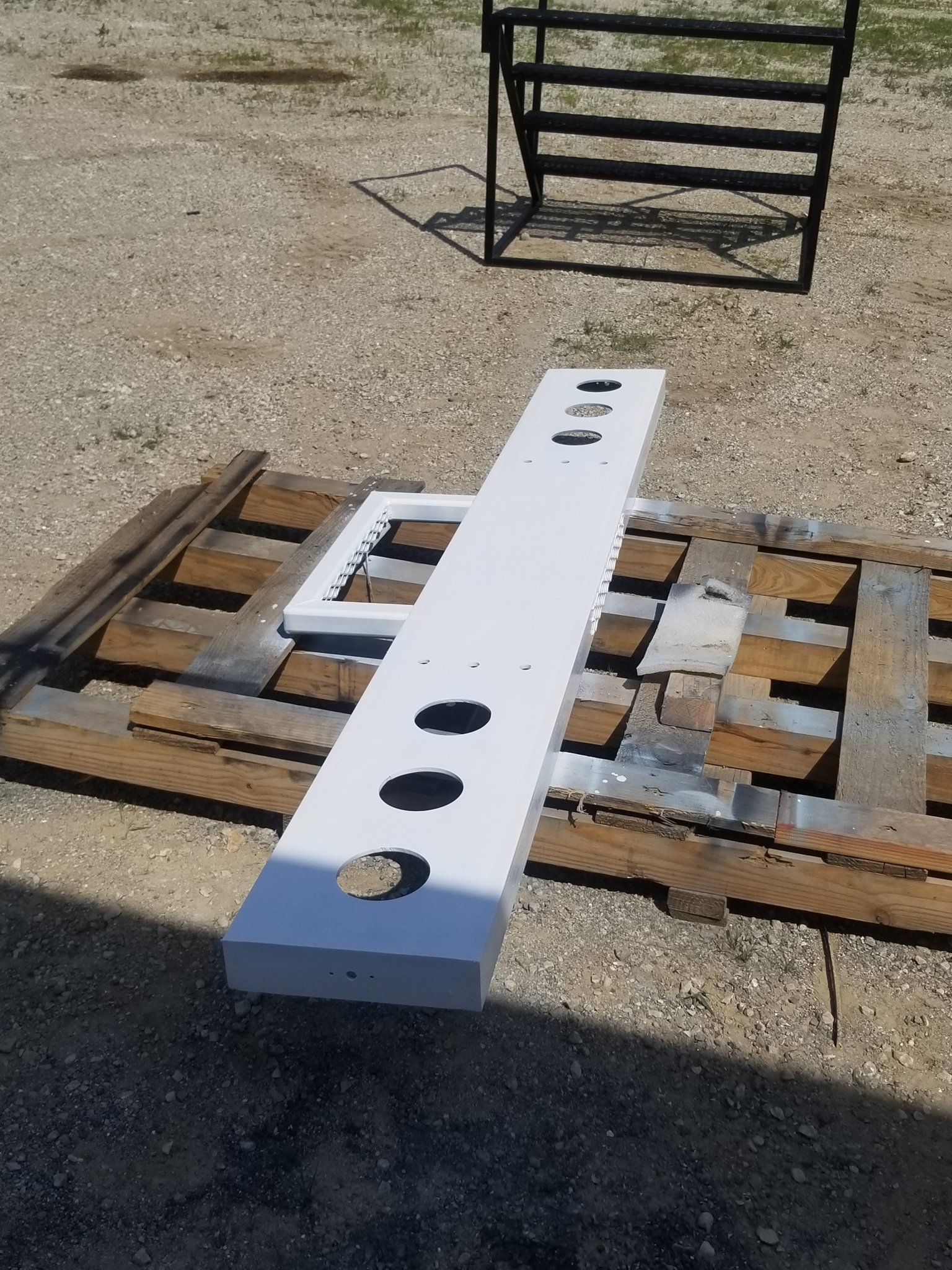

One of my last projects before I retired was to make this tractor a flatbedIMG_8516_LI.jpgIt was one of a pair we had picked up through the surplus program for local governments. It started like this IMG_8423.JPGIMG_8460.JPGit ended up like this
IMG_8519.JPGThe only photos I didn't get was the rear crash bar setup. I also never got any photos of it loaded down. The dockbuilder used it to haul all kinds of material.
Most of my time was spent trying to repair very old tugs, barges and crane barges, nasty smelly shitty work, so I looked forward to these fabrication jobs.

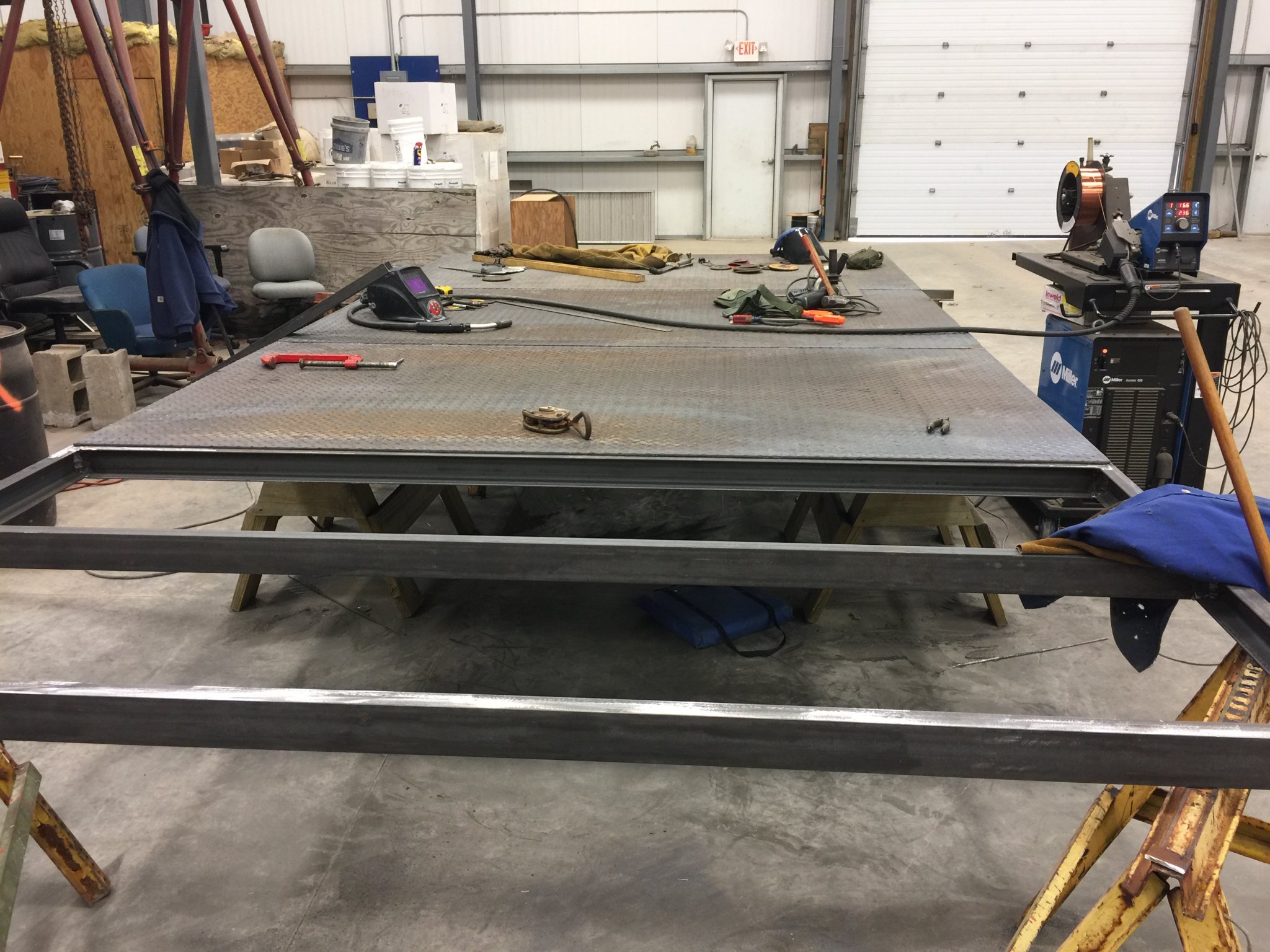

The start of my steps. I think they will be fine without a stringer in the middle. There is very little flex with me bouncing on one bar and I'm 200 lbs. I will test with a couple people tomorrow when I finish it up. I am buying a carbide blade saw after this, finer wheels flex more than I like on the angled cuts even going slow.
The start of my steps. I think they will be fine without a stringer in the middle. There is very little flex with me bouncing on one bar and I'm 200 lbs. I will test with a couple people tomorrow when I finish it up. I am buying a carbide blade saw after this, finer wheels flex more than I like on the angled cuts even going slow.View attachment 7089021
Damn man, those came out great. Very clean job.

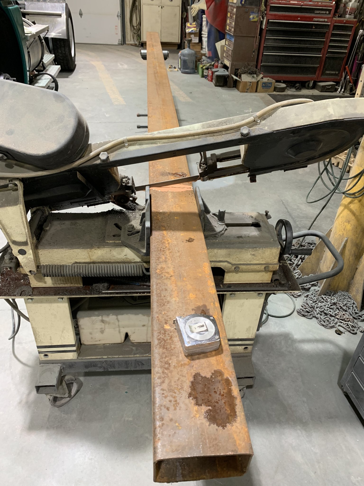

We run a shop Fox. Same as harbor freight and grizzly. I can’t begin to imagine the number of cuts this thing has done in the last 8-10 years. The gear box came empty and the brass gear lasted a 10 hour day of straight cutting before it ate itself up ?
View attachment 7091736We run a shop Fox. Same as harbor freight and grizzly. I can’t begin to imagine the number of cuts this thing has done in the last 8-10 years. The gear box came empty and the brass gear lasted a 10 hour day of straight cutting before it ate itself up ?
Thats 1 hell of a chunk of steel on that! Saddly my projects never require anything that massive.
From what i remember reading, the base model is from the same factory. The price varies on what brand is on it (then if you add hydraulics, feed, etc). I picked mine up on local craigslist for $100. You can get new with the 20% coupon and fathers day is comin up so im sure a sale is too.

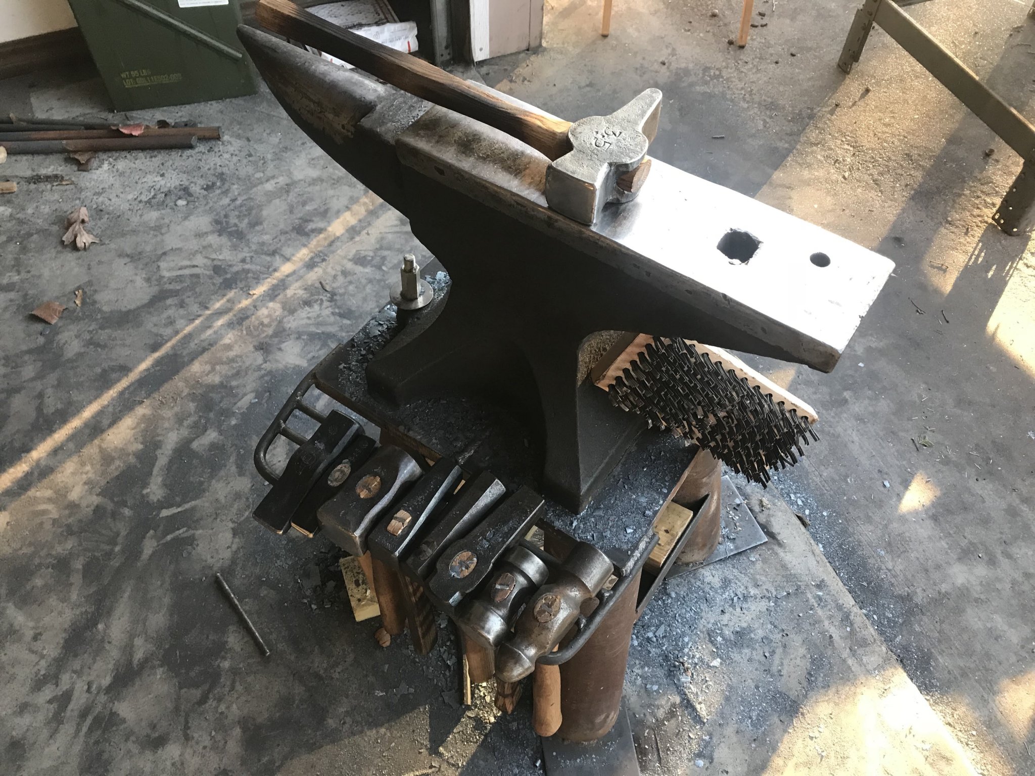

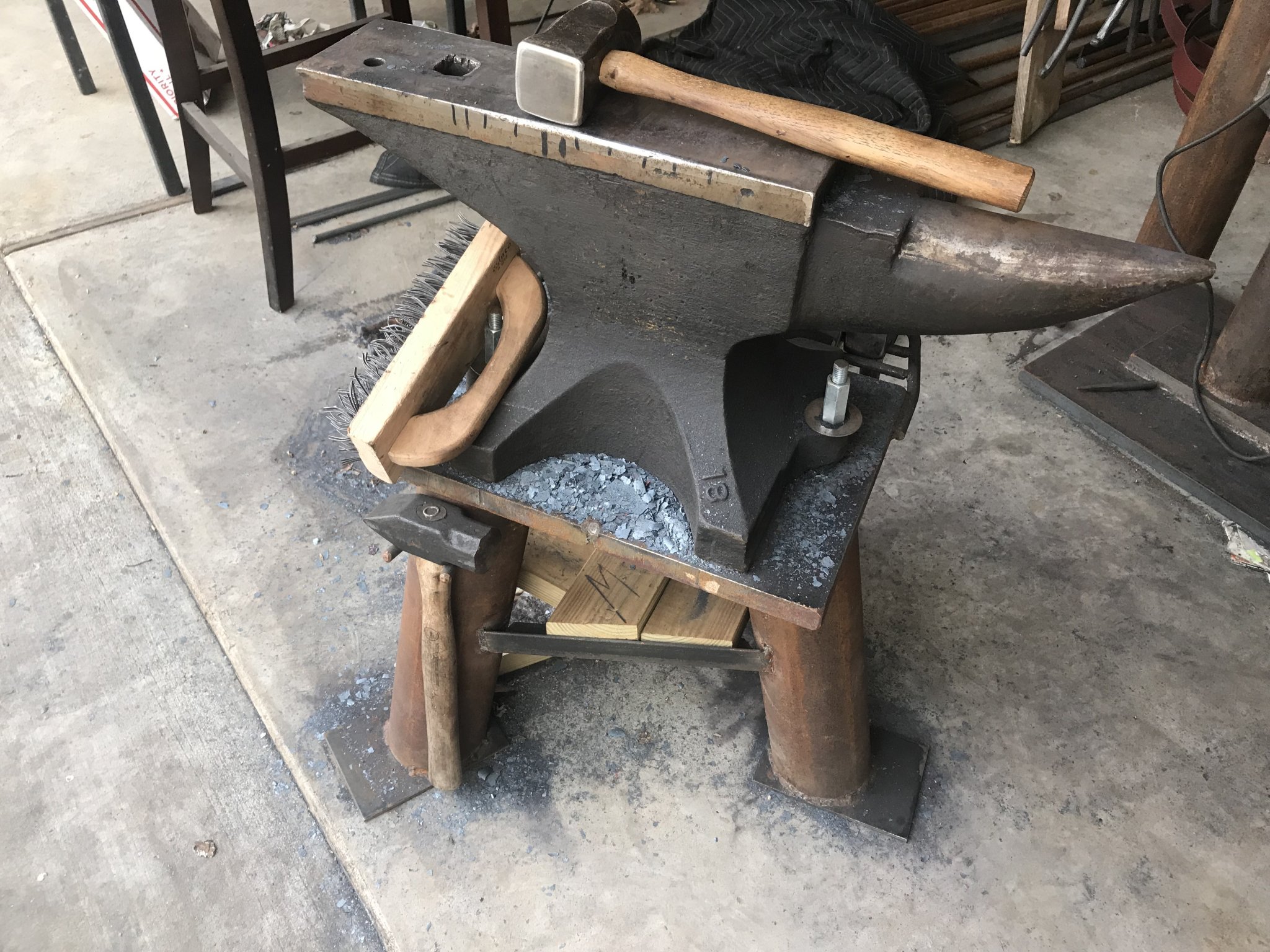

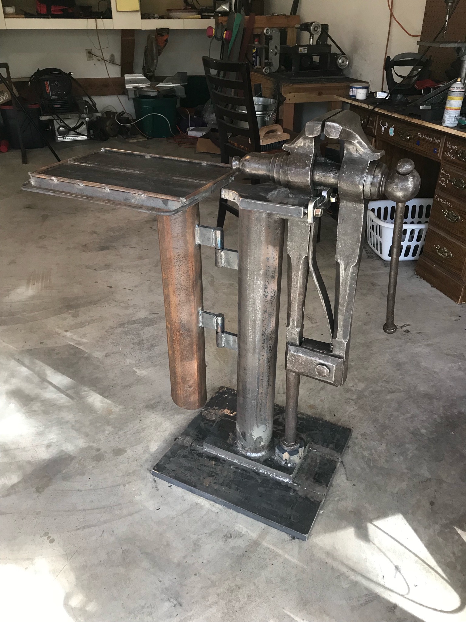

My fab work is now limited to making tooling for myself.
Stand for an old Peter Wright post leg vise:
Tripod anvil stand with a hammer rack on the far side (I forge horn to the right):

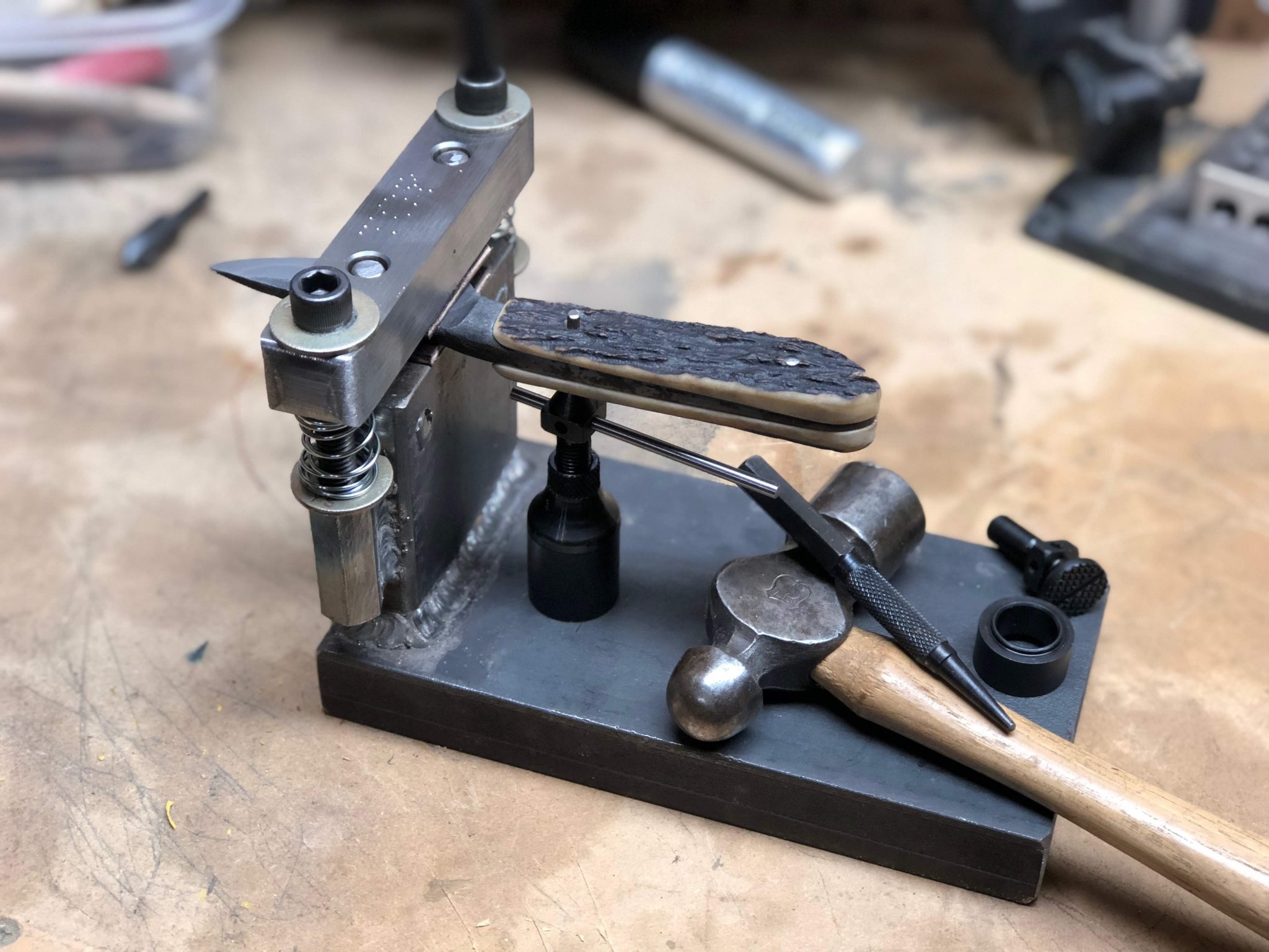

Knife holding fixture, spring loaded with dowels, for drilling holes and doming pin heads, Starrett machinist jack for support:
