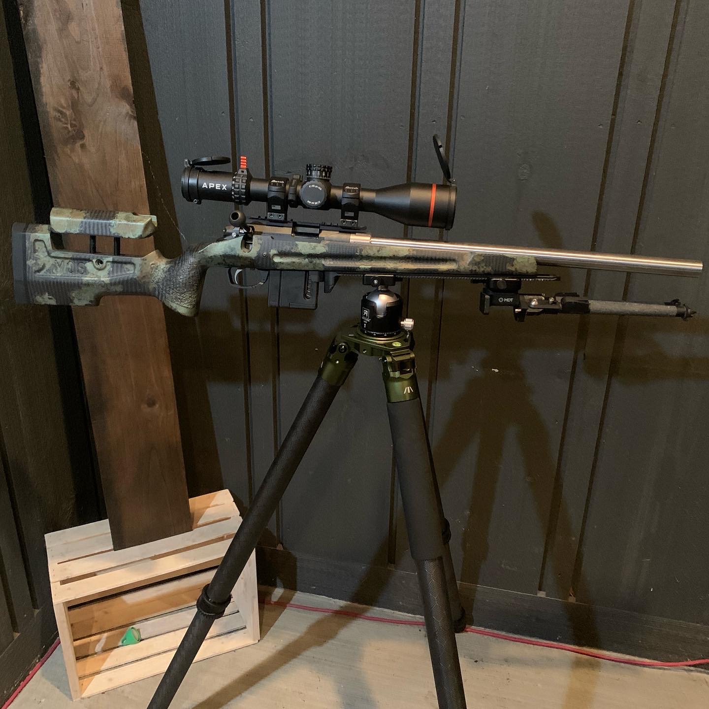

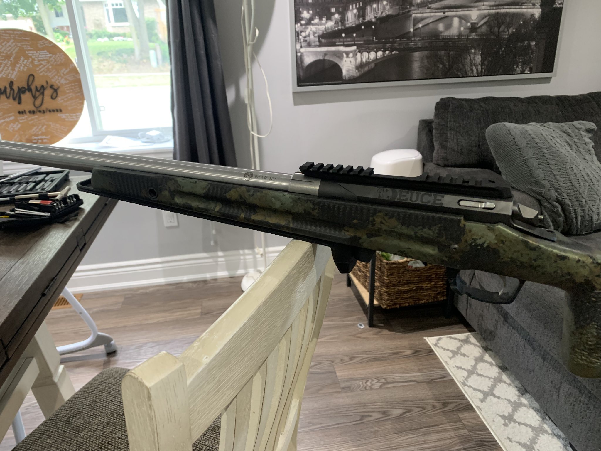

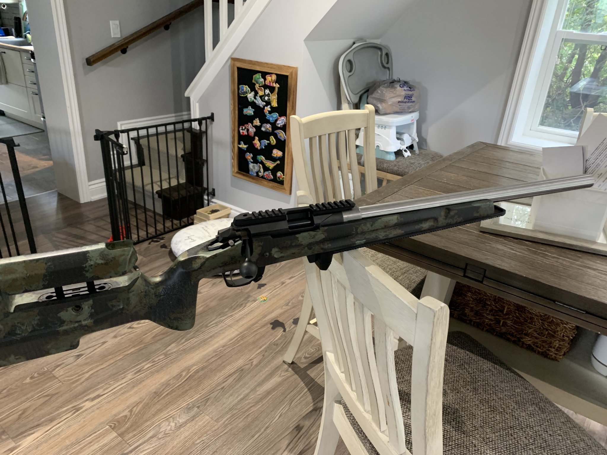

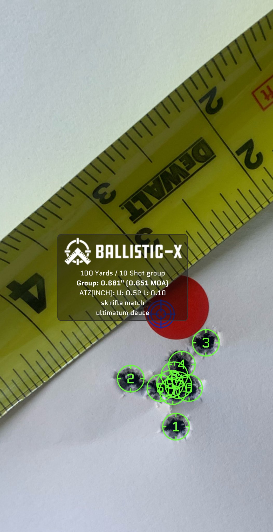

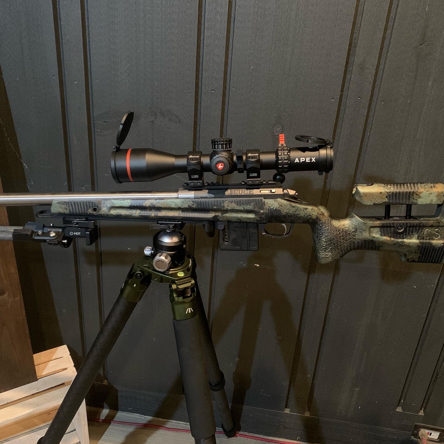

Its here! The Ultimatum Precision Deuce showed up! It has a 1-12 twist straight no taper 22" pipe from International Barrels. I was concerned tha the shorter barrel would make it harder to balance but its perfect in the Modular Driven Technologies ACC. I use the same weight configuration as with my 26" heavy palma balance is the same.
I installed a single stage Triggertech Diamond. The timing is off slightly but Derek let me know they have a fix in the works and will send the part. My understanding is this is a single stage diamond thing.
With the bolt being a one piece and not a mid-lock it is basically impossible to bind the bolt. Bolt lift is incredibly smooth and light. Bolt close was not great. I did a couple of minor tweaks and it is now acceptable. Its a nicer smoother bolt then most but I have a RimX.... 😉 I expect once we have the timing sorted.. ya gonna be nice! I really like the 60⁰ lift and the bolt knob position it suits my technique perfectly.
Mags fed flawless with no hangup's in the 40-50 rounds I cycled through. The mag stack is captured in the action creating a solid lockup with little mag movement when pushed against a barricade. There is lots of adjustment on the mag height and it will work with both the regular and short MDT mag catches.
Fit and finish is very good and overall I am impressed with the action. I may do a couple of posts here and there as I use it but will not comment to much until I have a few thousand rounds through it.View attachment 7696346

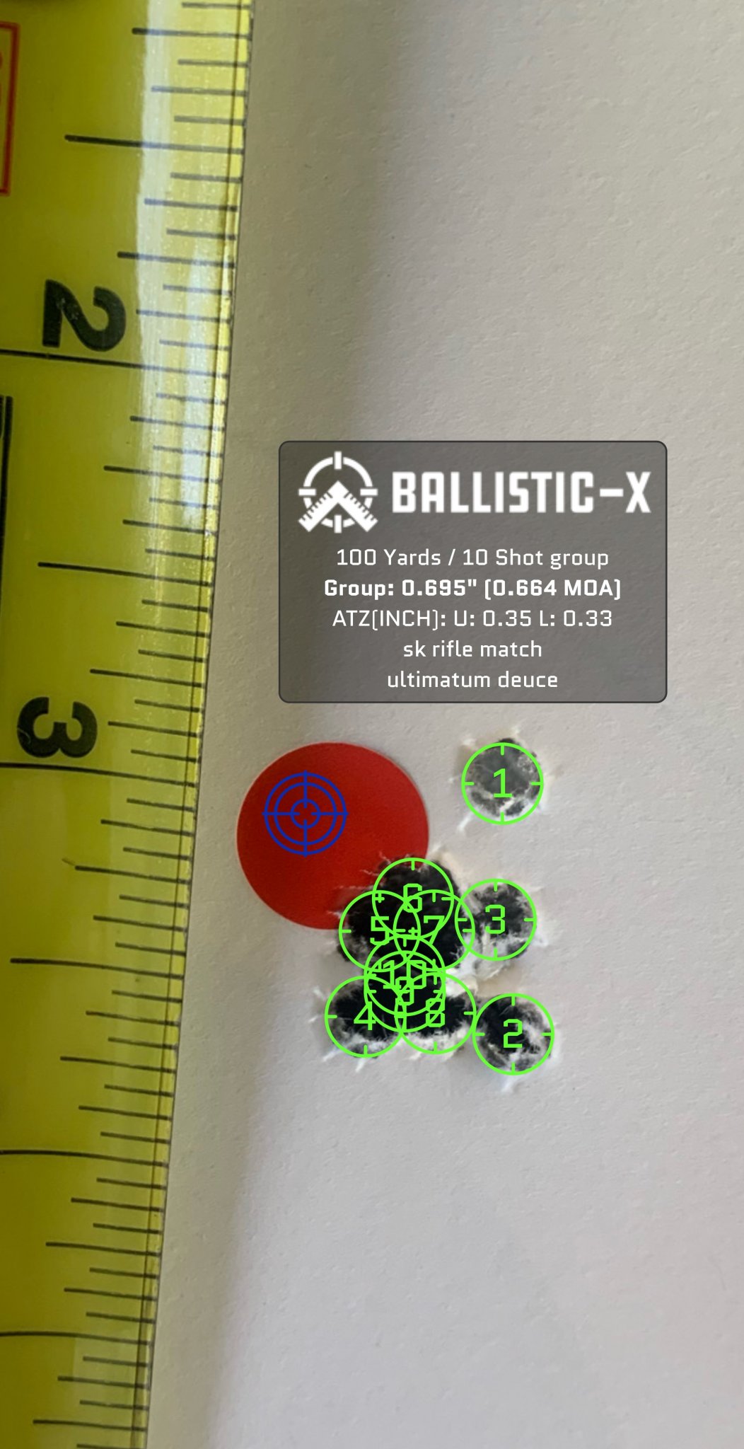

Mine is working well with TT Special. 12 twist, getting some awesome groups at 200m, amazing vertical

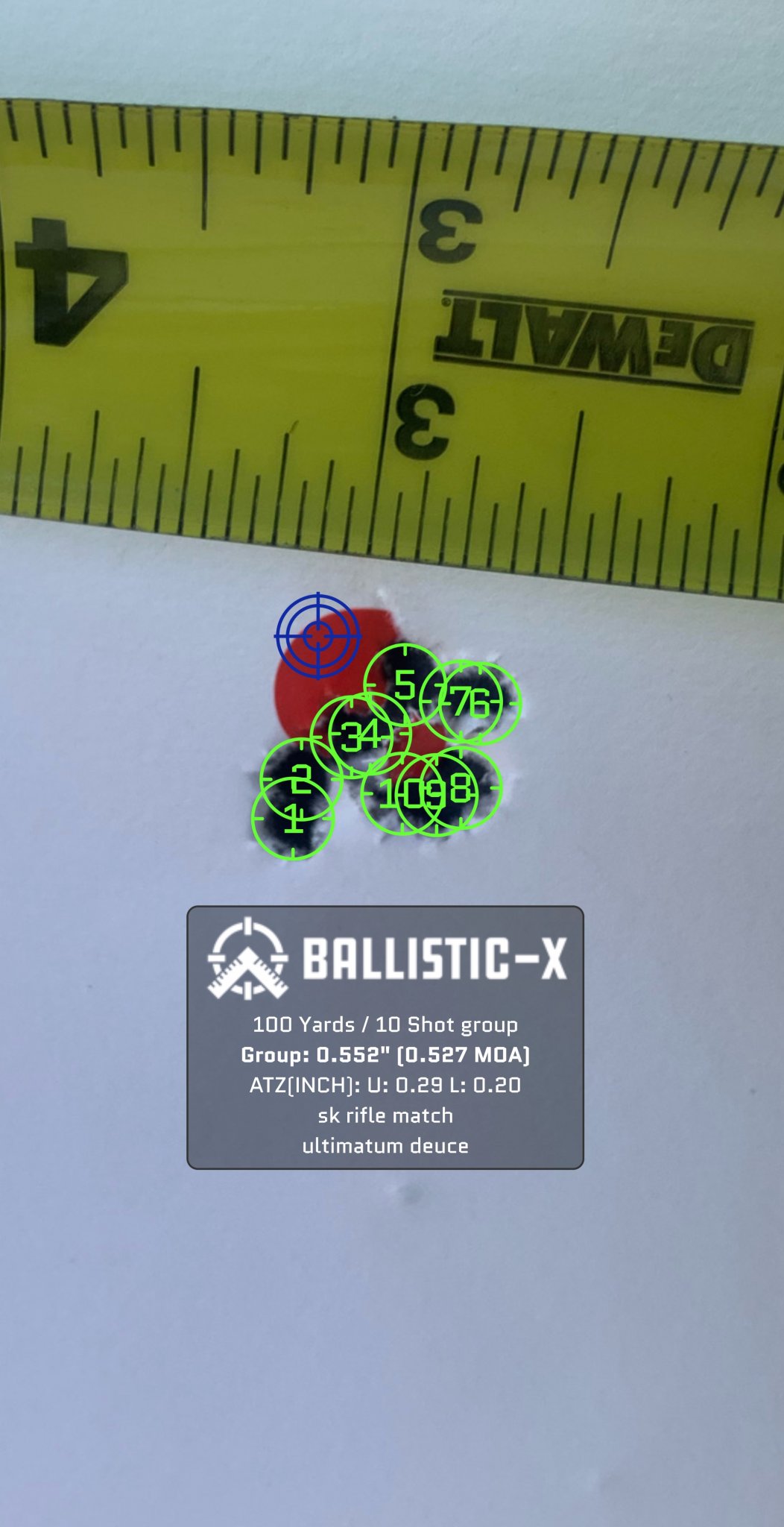

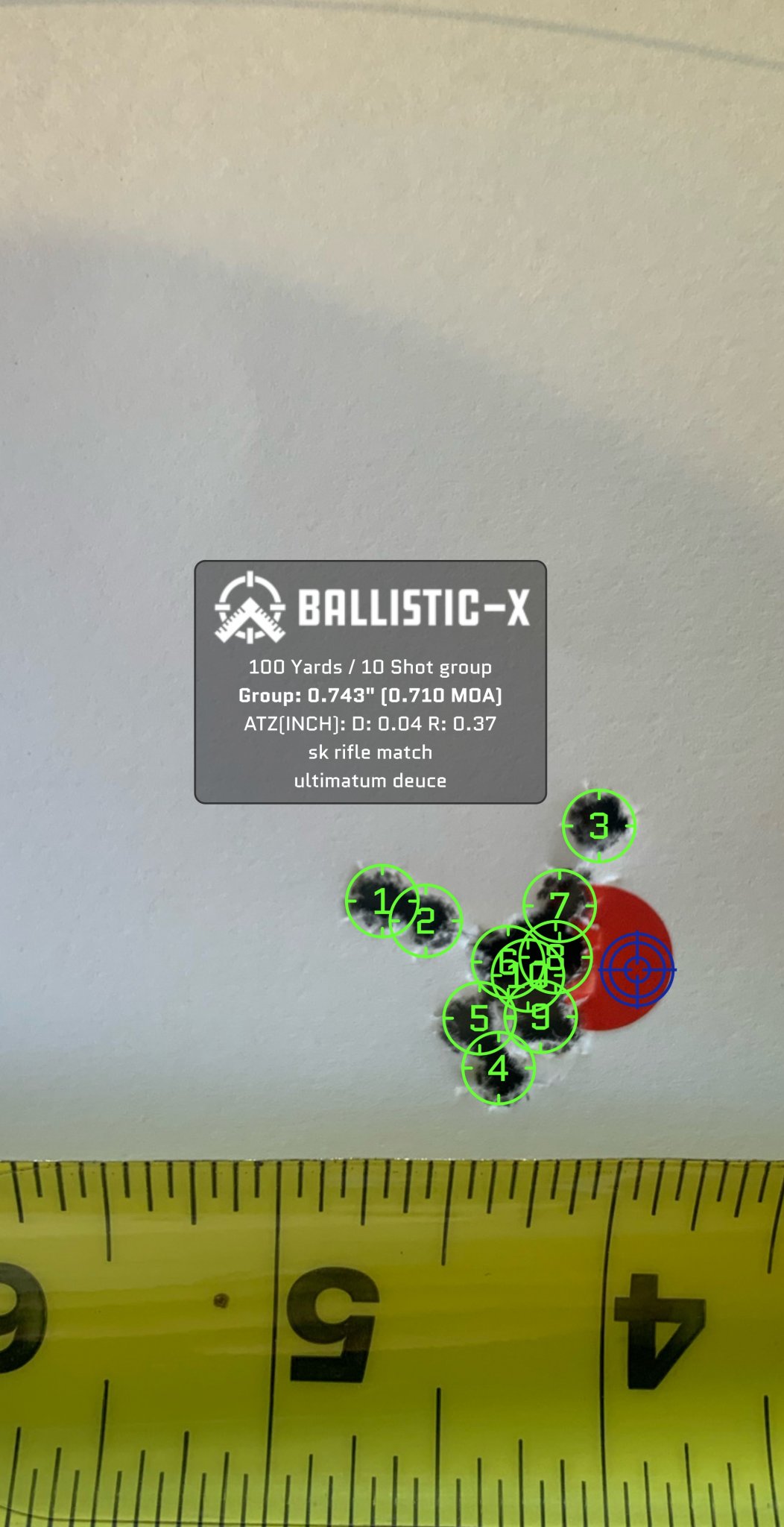

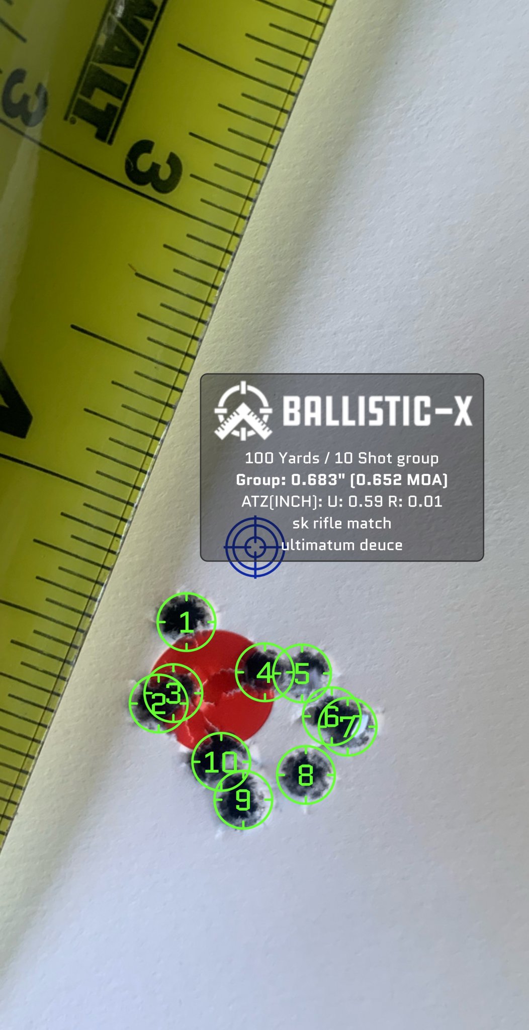

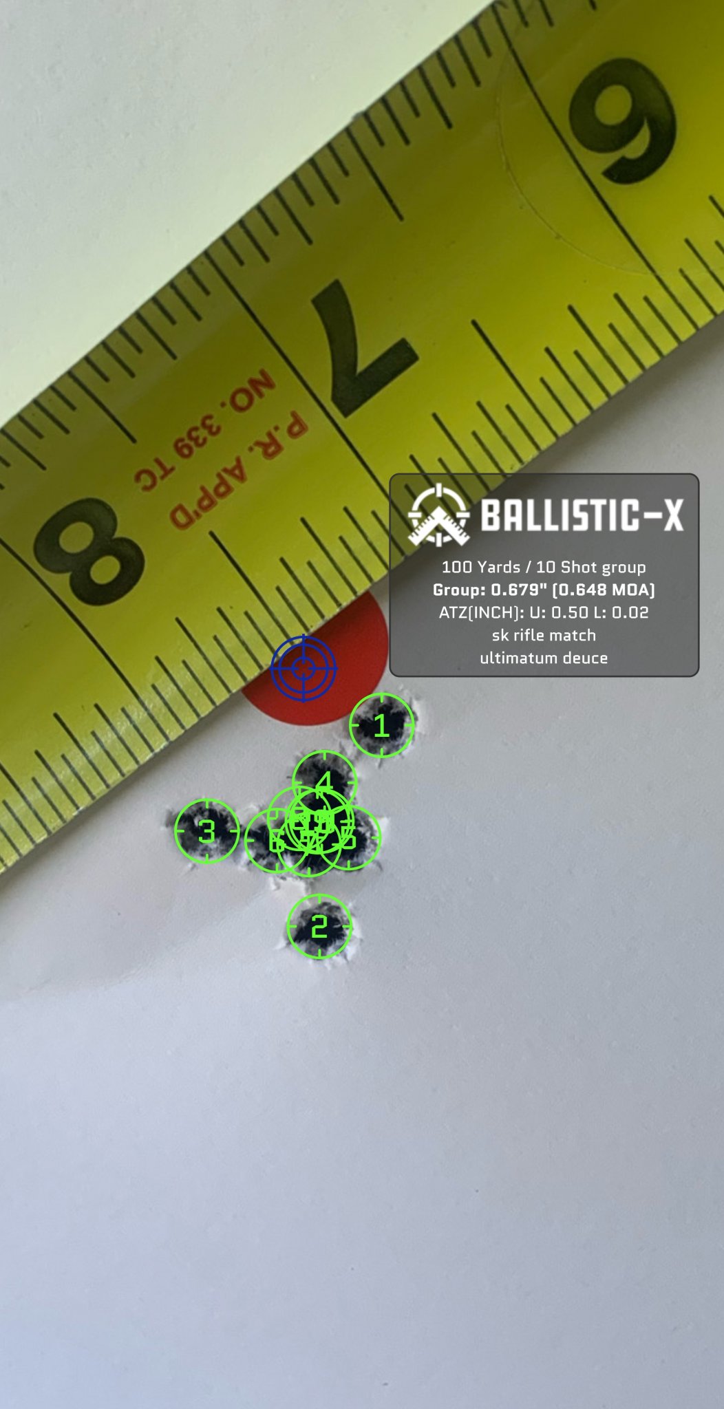

Well with 1000 rounds through the barrel it seems to be shooting great at 50 and 100 on paper and no problems smacking steel at 200-300. I did do a little group testing at 200-300 but with the winds this afternoon it was proving challenging so I will retest in a week or so early when the winds are low. 1000 rounds with only 1 jam today. Using modified vudoo mags.
Reactions: Dawhit and FWoo45
Matt
I posted on accurate shooter , give us some build specs , impressive

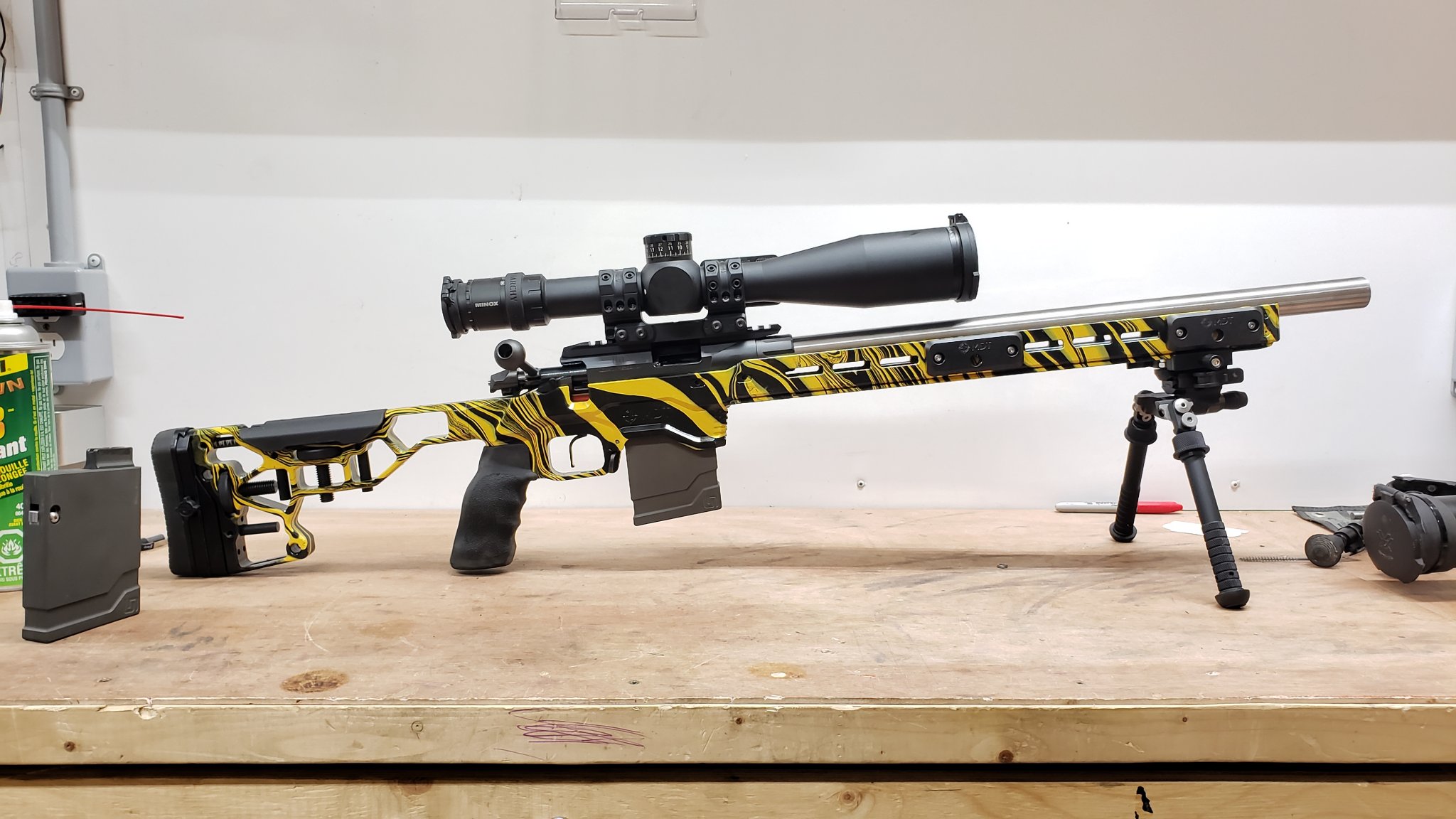

I worked with Ryan over at international barrels on my vudoo 360 build and while building tbat one we planned this one. So with Ryan’s help he put together an ultimatum deuce action, ibi 1:12 twist 22” straight. It’s bouncing back and fourth between an mdt acc and manners prs1t, trigger tech diamond, apex rival 4-32x56mm.
