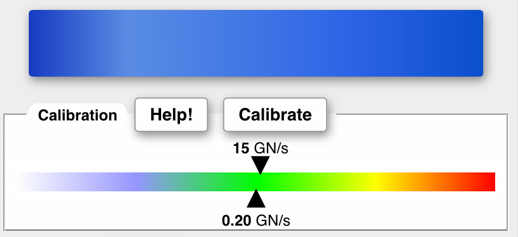

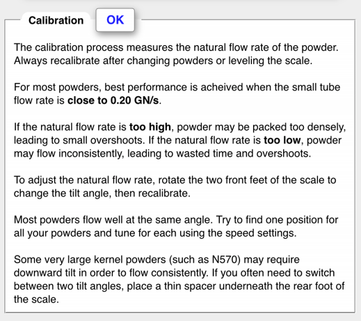

Here is a screenshot from the app which shows the measured flow rate and the explanation within the app about what this means and how important it is. In order to help anyone tune V4 the first thing is to understand that the flow rate has to be in the right window or else it will not be able to run both quickly and precisely.
If anyone is having trouble with V4 and feels it is slow or overshooting but they have not been using the new app with the calibrated flow rate in this range, please try again, and email me for help if it's still not working perfectly.
The original ramp down algorithm in V4 was similar to V3 and generally fairly conservative and slow. There was more potential for sub 10 second cycle times with the V4 mechanics so with the new version of the app I improved the performance, however it is more important than ever to ensure the flow rate is in the right window for this to be beneficial.
Make sure the flow rate is 0.20, adjust tilt as necessary to reach this, put all the sliders in the middle of their ranges, run a few cycles to let it settle in, and then make small adjustments from there, and I promise it will work as well as anyone could ever need from a powder dispenser.
Unless there is something wrong with your setup specifically, which would require some troubleshooting, by email.

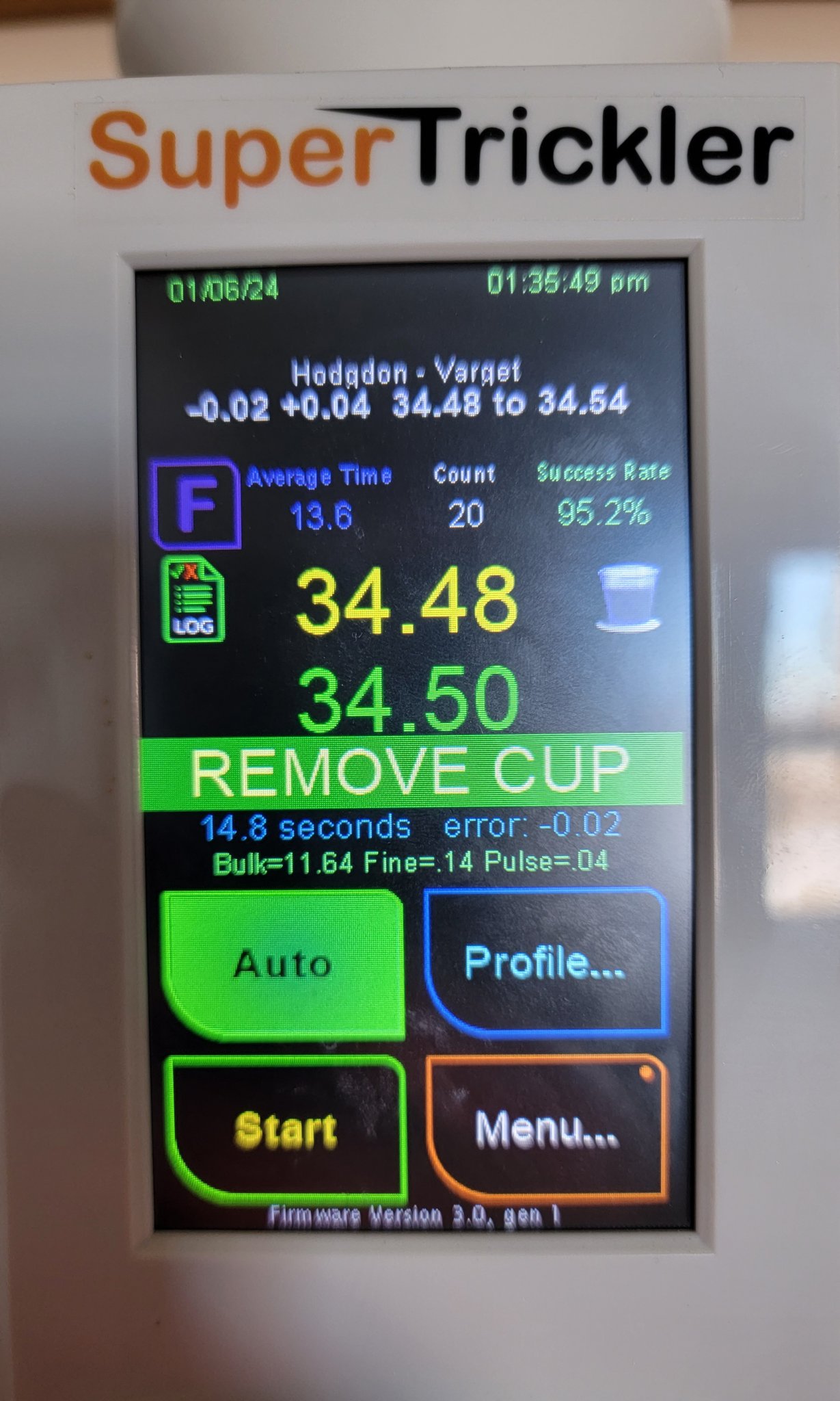

ST gen 1 with aluminum tubes, F/W 3.0, H4831SC, 50gn SP, AI only...25 throws, 8.9 seconds, 83% success. most overs were +.04gn

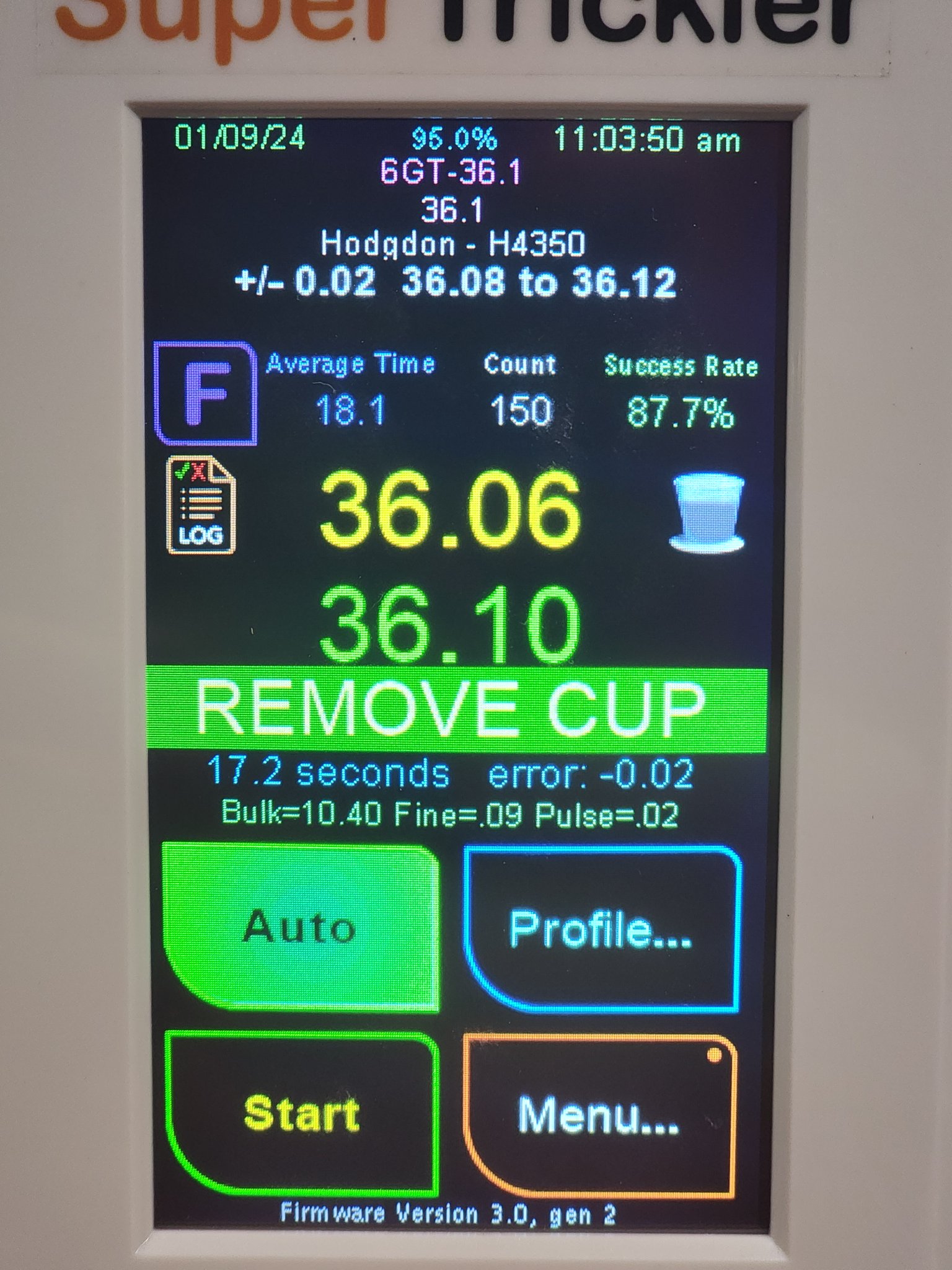

Here is the first 150 after firmware update. I haven't played with the settings because I am in middle of loading 800 rounds for matches but so far its MUCH more accurate than pre-update. I was right around 60-65% success. Now hovering around 90%. Of the remaining 10%, like 8% of that is .04 over. Every once in a while bulk drop will go over but way less with the 3.0 update.

This is EXACTLY what I would expect from the ST: 18 seconds average, 80% range (meaning 80-90% success over long stretches), with 150 drops and +/-0.02 for H4350 or VARGET.
Each can decide for himself if these results are acceptable and make an informed choice.
