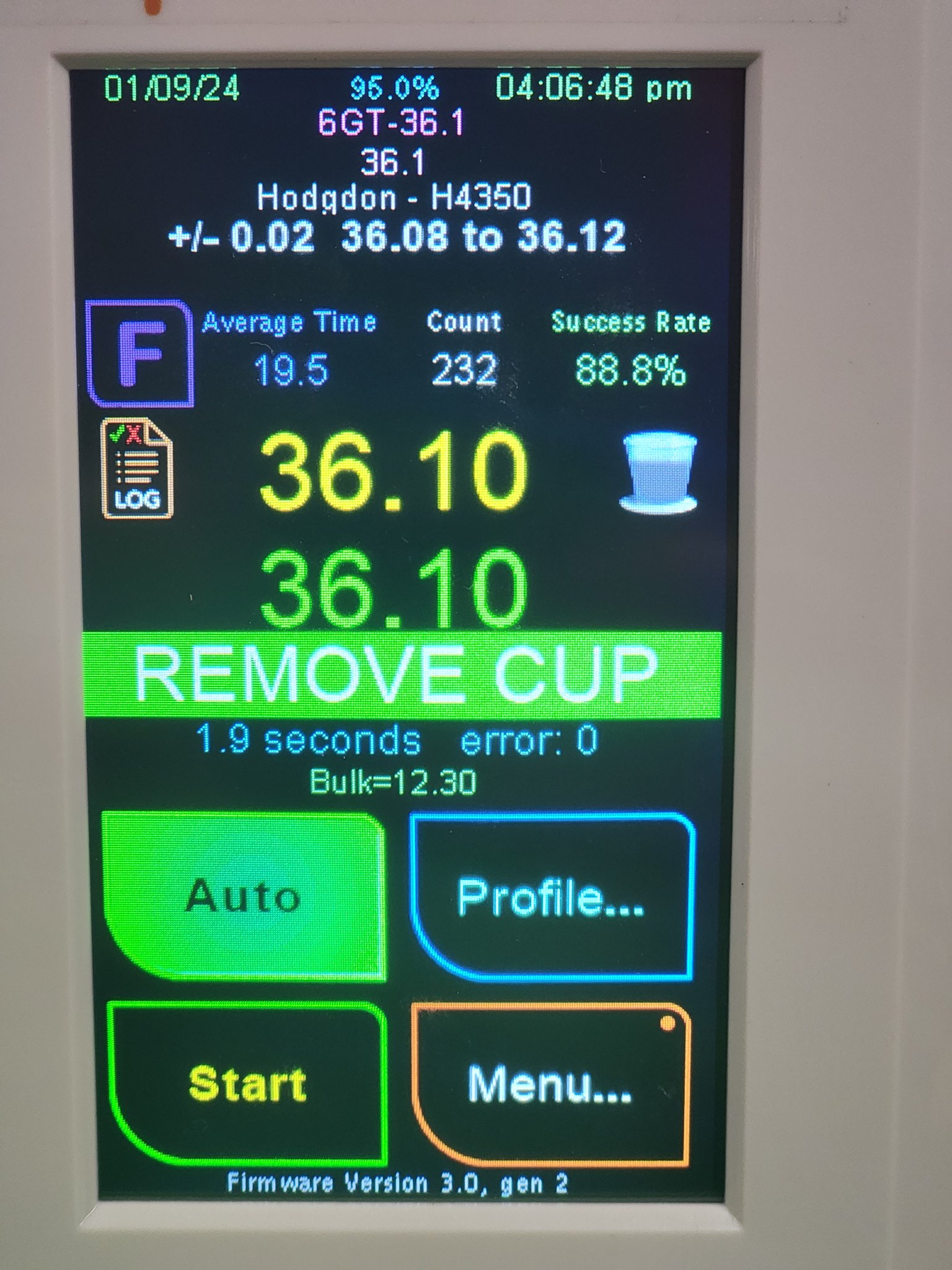

Just got another 1.9 Second throw. Could get used to these.....
Yes, those are satisfying but rare. It was bulk drop which landed on the target, scale shows vibrator did not engage.
Which means it was a bulk overage. Because it's *trying* to stop sooner, whether you have a "bulk offset" programmed in or not.
So, it will be a rare occurrence. Better a measure of bulk tube speed than system speed.
