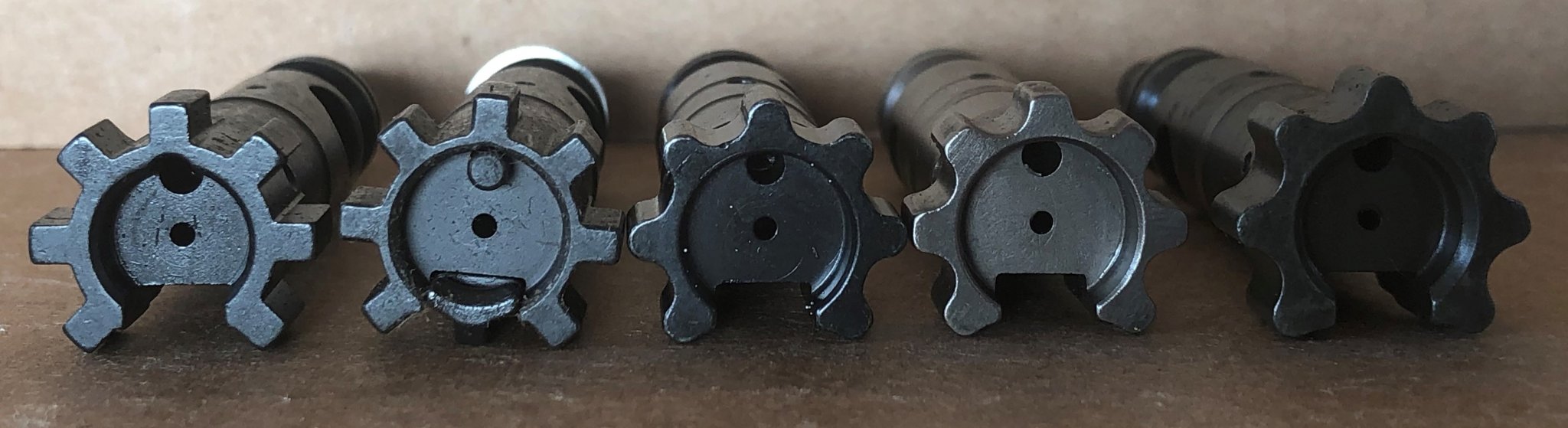

Would the Titan be only for bolt action rifles? Do they make one for the AR-15 ?
EDIT -- Didn't see the variety of bolts until I opened my laptop, sorry. Question: Then which of the two on the right would be best for the 6 ARC? And what might the difference be between them? And thanks for offering this info up.
The one on the far right is the 800 series and even though I was making them in 2007, a guy (Kramer) filed for and received a patent in 2015. He threatened to sue me if I made any more, no Kramer has never made a single bolt. I could have gone to court but at $500 an hour it wasn't worth it.
The 750XD second from right is .750 Dia so it could be made and not infringe on Kramer's fake patent. The Titan just has a little better tolerances and is plenty strong enough for Grendle and ARC sized cartridges limited to 55000 psi. I explained more in the PM. I retired in 2017 and no longer make any of those big bolts.
Interesting. Very reminiscent of Knight’s E3 bolt.
Stronger than your average bolt. The bolt on the far right is the 800 series was designed to allow shooting a 6BRX(308 diameter) in and AR15, it came first around 2007 there were also Grendel and 6.8 versions. The second from the right and second design is the 750XD also works with 308 sized, Grendel, 6.8 sized cartridges. third from the right is the Titan, I designed it for Grendel/7.62x39 sized cartridges, never made those for the 6.8. 2 bolts on the left are 5.56 and 6.8 I believe.

The Grendel with a .136 recess is weaker than the bolt with the .124 recess 7-8% but still weaker, any engineer can explain that in about 30 seconds. The bolts below are the Titan, quite a bit stronger than the type 1 or 2.

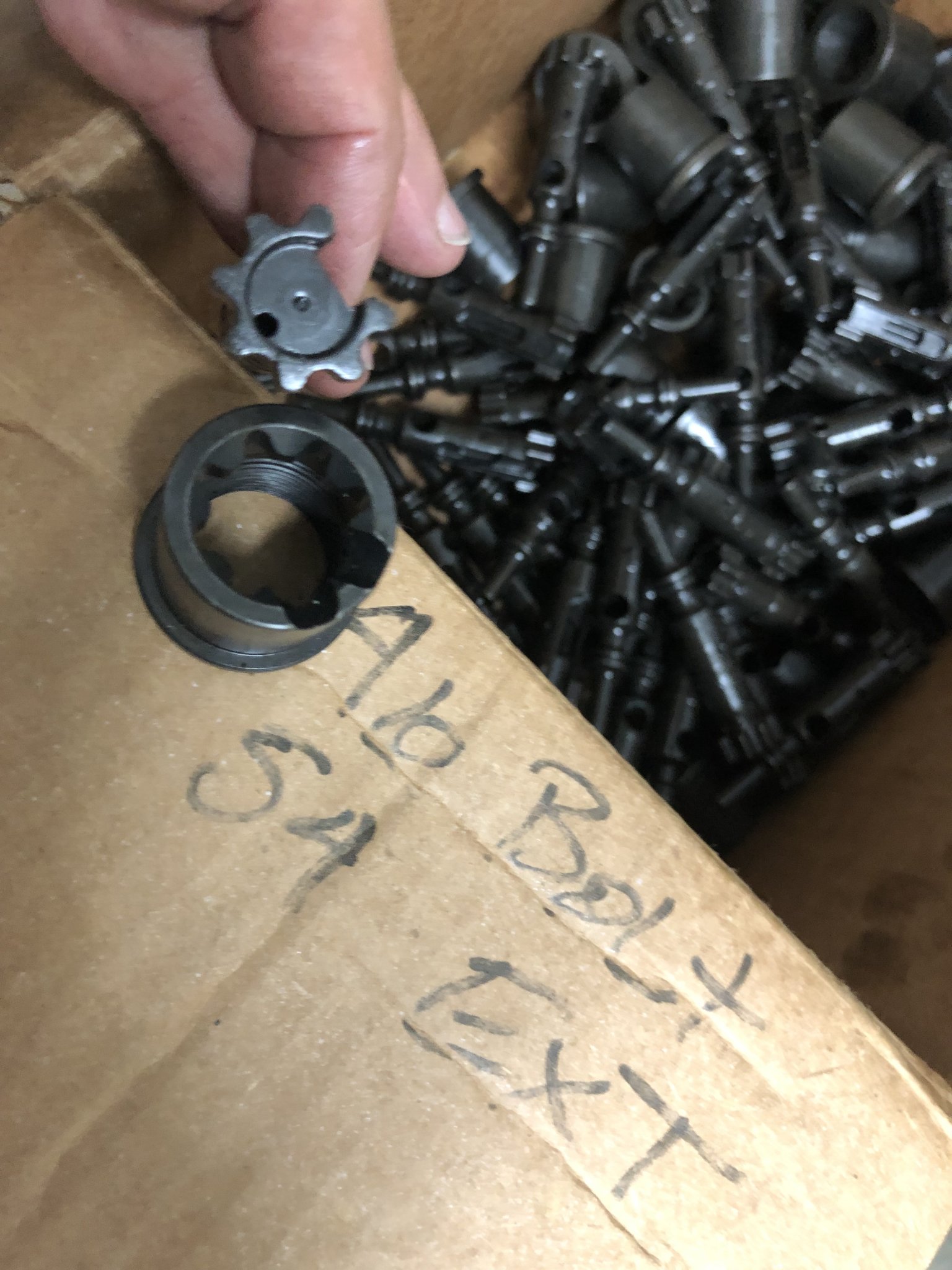

I’m about to tear apart a KAC barrel for the extension and open up a SR-15e3 bolt to try to run higher pressures.
Where can I get one of these?
The only thing left on ARP website is a box of 40-some 7.62x39 barrels + extensions for $2K 😂. The bolt face depth on x39 is incorrect for factory 6mm ARC though.
Actually its 40something Titan barrel extensions and Titan bolts at about $100 a set so $4000.
for a gunsmith that wants to make a batch of barrels, I don't sell those to the public.

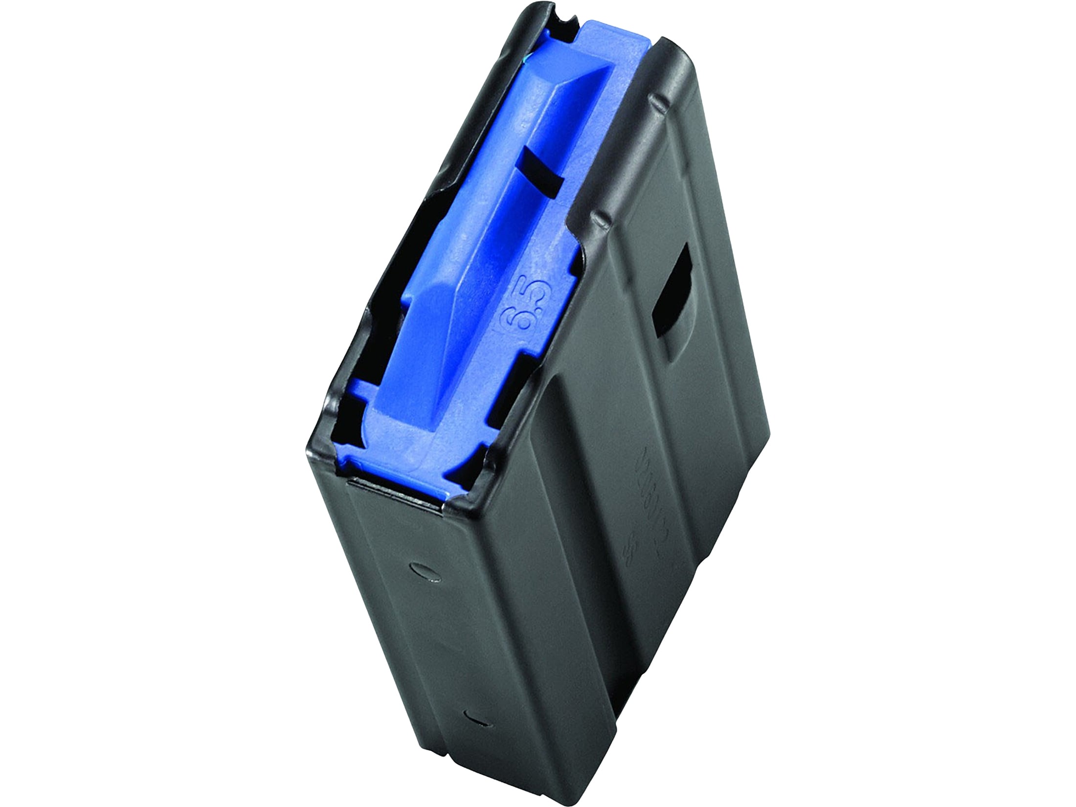

Agreed. I emailed lancer magpul and a couple others asking about a 6 arc mag for this reason.
When you stack cartridges in a mag the top of the first cartridge should touch the bottom of the 3rd and the second should be to the side and between the 1st and third. if you look close from the rear you can see space between them top to bottom. The magwel of an AR15 is not wide enough to allow that proper stacking and the thickness of the mag. It has been like that since 2005 when I purchased my first 6.5CSS(Grendel). The thin mag adds extra pressure to the cartridges and makes them drag as the move up. They either need to make a larger magwel like the did for the SIX8 or the guys making the mags need to make the ribs a little thinner. Not sure if that will decrease side strength and allow the mag to bulge but this has been going on for over 15 years, seems like some company would have figured it out before they sent them to the DOD. The dies to bend the mags cost 100K or that is the price everyone throws out.
ETA- On top of that the Grendel/6ARC cases are larger diameter so the bullet tips sit lower below the centerline of the bore and must travel up further to align and enter the chamber. They can't raise the feed lip of the mag because they will contact the bottom of the carrier.
They could design a carrier like the Armalite AR10 which would allow the bullets to sit higher but then all G mags would need to be redesigned or the square mag catch hole would need to be lowered on the mag to raise the feed lips. Neither is really a big deal but no one ever does anything about it.

Seems like the reviews are similar to every other 6.5G mag out there. They work for 70-80% of the folks, and the other 20-30% have failures. E-Landers, ASC, Cprod, etc all seem to do the same thing with regards to working for some but not others. It's a real shame nobody has cracked the perfect mag code for rounds based off this case, as they're a phenomenal step up in BC compared to 5.56 and let more folks hunt with ARs in states where .243 or some other "not .22 diameter bullets" are the minimum required caliber for some game species.
I wonder if the mag/feeding issues are actually indicative of a wider tolerance margin when it comes to bolts, barrels, etc for 6.5G/6ARC and how they interact with the magwell/lower receiver. Just seems odd folks have had such a varied experience with different magazines, some even using uppers built by the same shop. For instance, my 6.5G upper is a Larue UU kit, assembled by them. The E-Lander 24rd mags wouldn't work for shit, but others with UU uppers sing their praises. Is something off in the magazine QC process which allows for a lack of consistency, or is it an issue derived from the lower they're put in or the upper they're trying to feed?
If 6ARC really is going to some folks in uniform, it would be interesting to see what magazines they are no shit using...
I'm wondering if the gas system / components and adjustments some people have just don't work well with any particular mag or any of them.
If you just stuff a 6.5g / 6arc upper on your old 223 lower you should lower your expectations of reliable functionality.
Normally anything you buy from a vendor is grossly over gassed to begin with in any caliber. Quick allert, trigger all the vendors to defend their shit.
Fact remains a heavier buffer, flat wire spring and agb will probably get any of the mags to work.

The quality really seems to be batch dependent, is why you will find reports of every brand working and not.
E-Lander has been the bulk of mine and things vary wildly depending when I bought them. Some were perfect and required no adjusment out of the bag. I've seen the mag catch slot cut so low it would jam the feed lips into the bottom of the BCG. The height of the front of the mag body has needed ground down or ramped depending where it was. I've had to reverse the springs in others to correct follower tilt. Word is the springs are made in Italy and the rest Israel and assembled there. They clearly do not have consistency.
IME I've had the best luck with these...
Bolt gun: MDT BR or ARC magazine, especially the new follower type (injection molded).
Gas gun: E-lander 17 rounders.
Reactions: padfoot 37
