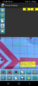

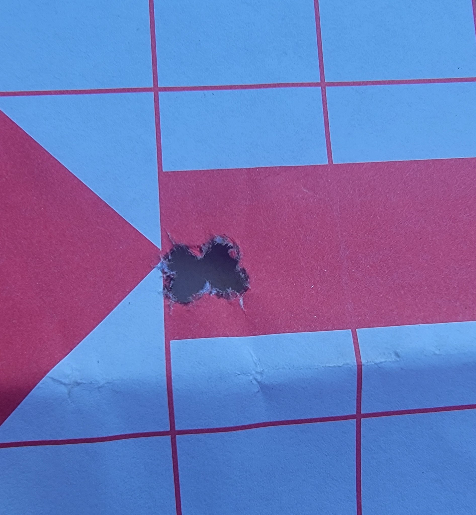

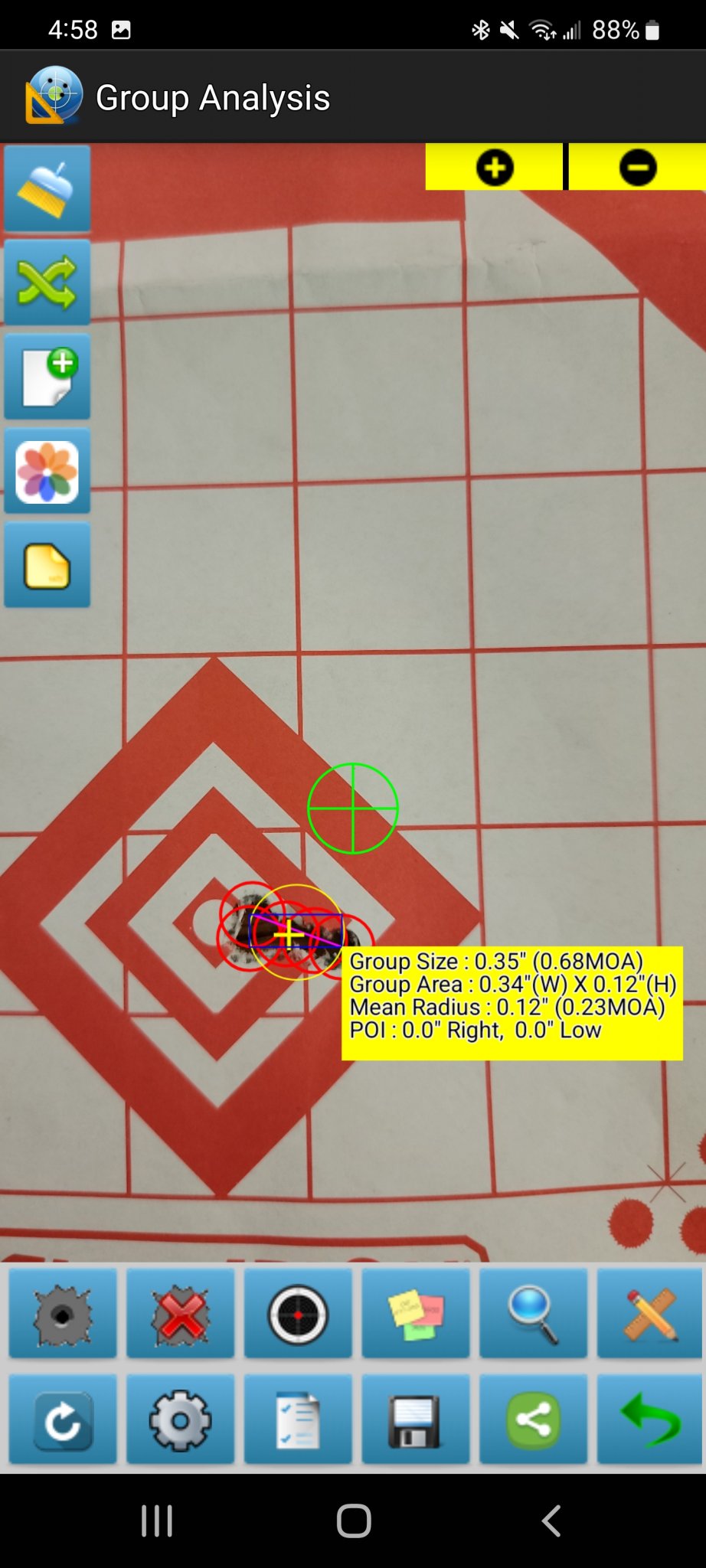

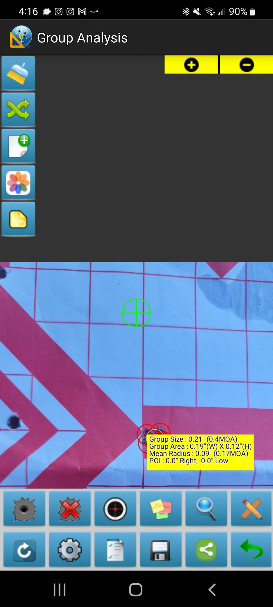

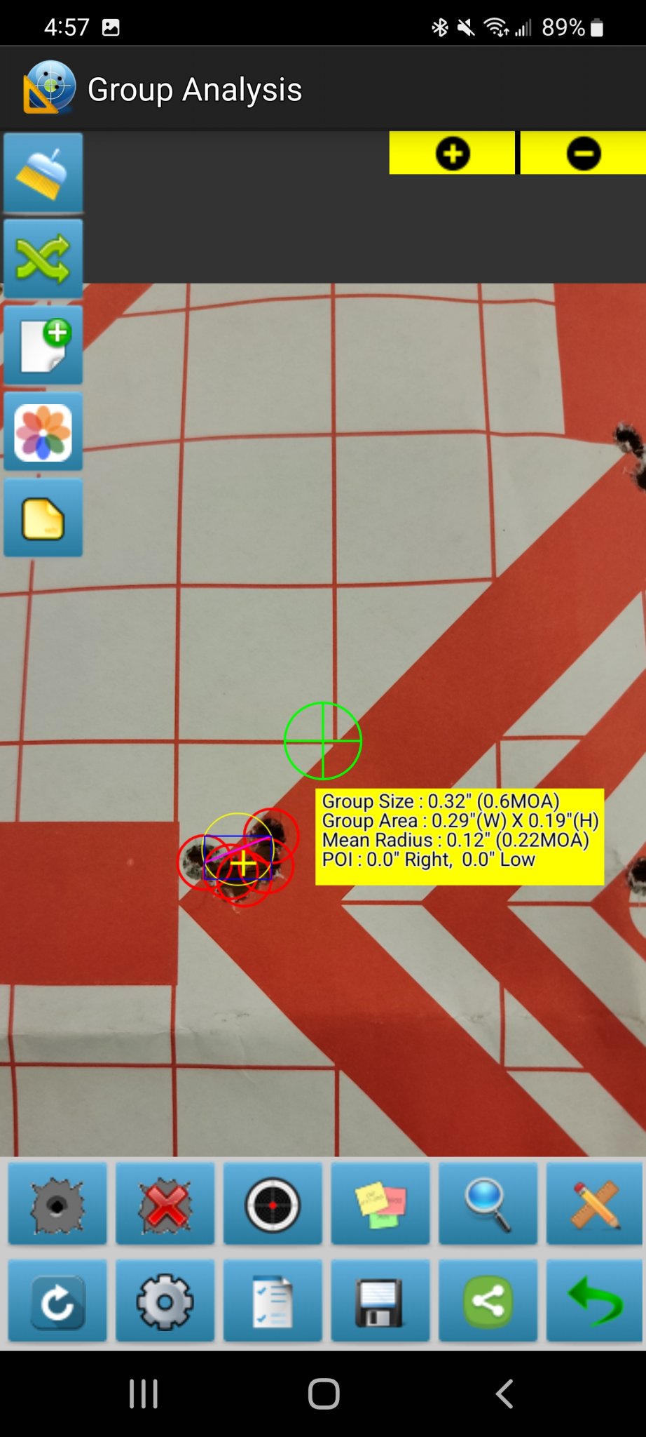

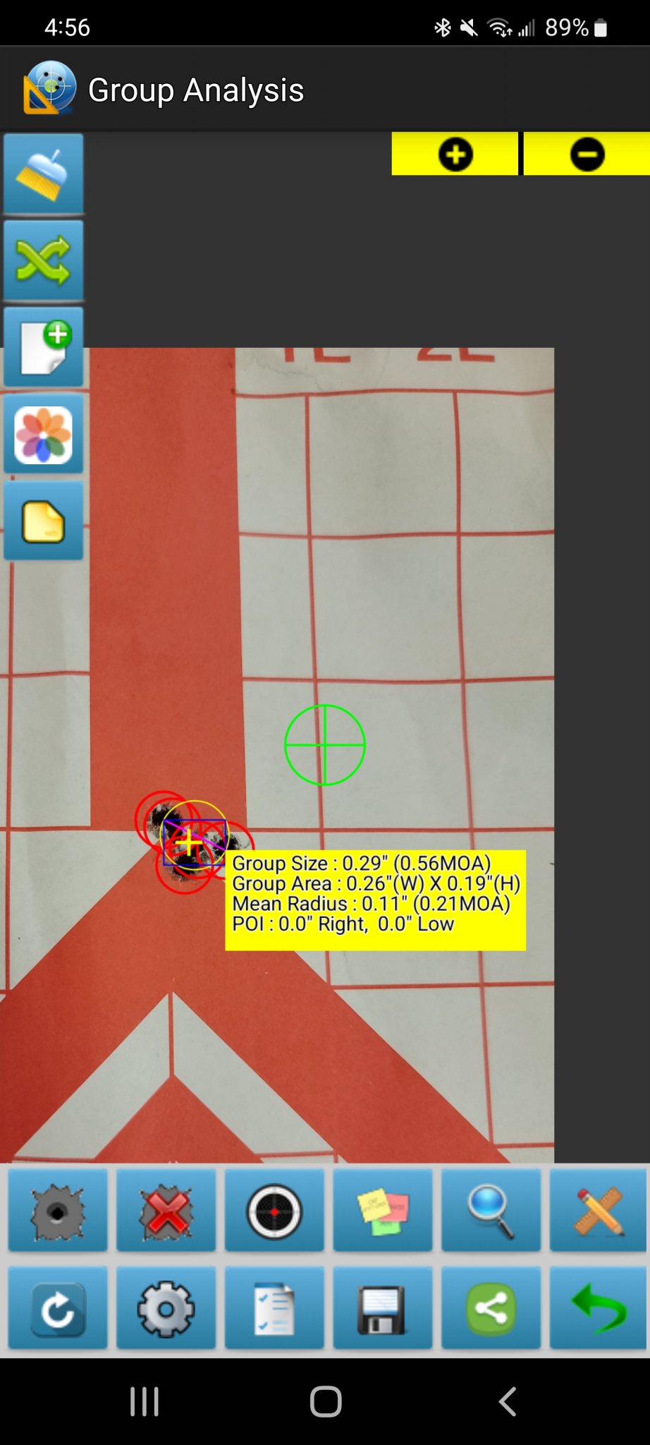

More updates on my build, this CLE bartline barrel likes the 108 eldm factory load better than thr 105 black. Shot at 50yds, in good weather, prone with a new trigger tech diamond trigger im getting used to.

I hit to 1031yds last week averaging .6moa in groups with the 108 eldm factory ammo. Really liking this cartridge and rifle.

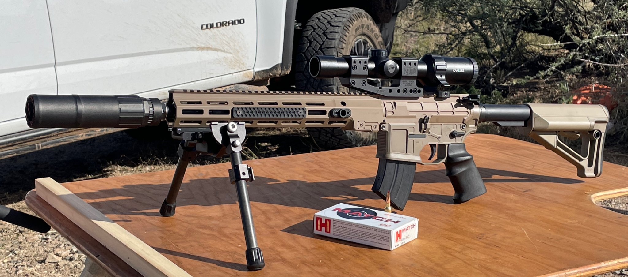

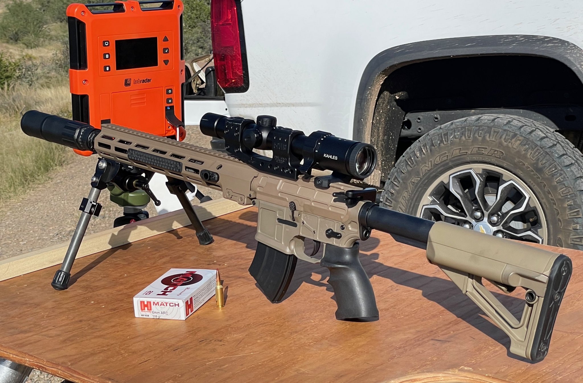

I just finished yesterday a 6mm ARC rifle for a customer with 18" Proof CF barrel and Kahles K18i scope. The customer wanted it sighted in at 100 yards with Hornady 103 ELD-X.
Off a bipod with a 75 YO wearing trifocals:
Two shots to get on paper.
The first five shot group was 1.5".
The second was 0.80".
The third was under 0.50".

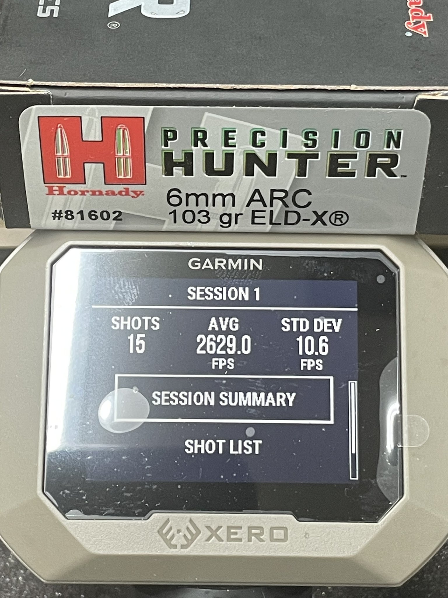

Nice SD! I expect this barrel will get at least 30-40 FPS faster with use. Temperature yesterday was 40 degrees F, which may have played a role in the velocity. The Hornady 6mm ARC ammo seems to pick up 2 FPS for every degree F.
This was, as you can see, the first time out with the new Garmin Xero. Set up on this jewel is easier than opening a new box of ammo.
