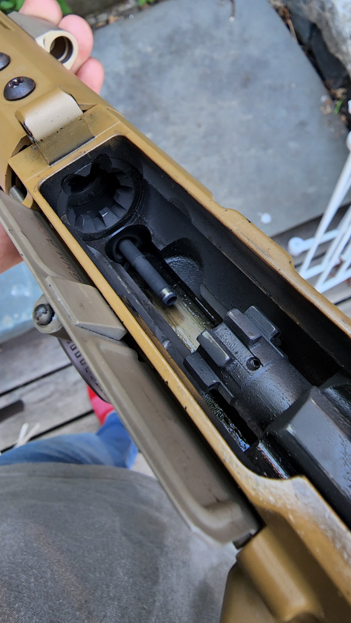

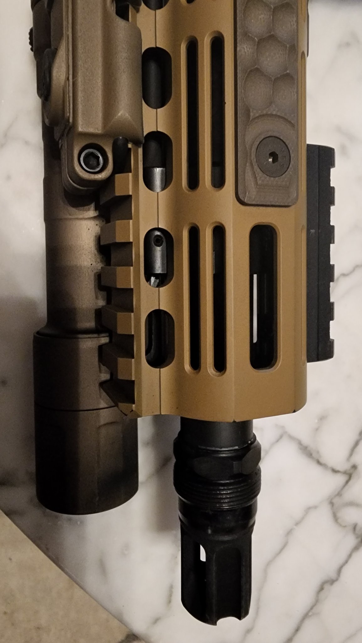

My 14.5 Proof CF today after 100 rounds suppressed. 103 ELDX. To make matters worse, it's running a Superlative Arms bleed off too, should be sending minimal gas back. It does function fine, but it sure does get filthy fast.

Yeah, the bleed off has block isn't doing what you think. The schmutz in your receiver is coming back down the barrel as the gun unlocks, because of the suppressor. Itā€™s not coming from the gas tube.
I understand that, but it's still far less gas in the action than a standard gas block. Adjustable or not.
What does your hand guard and barrel beyond the gasblock look like?
It's got some carbon on it but nothing crazy. It is extremely close to the end of the handguard since it's the "Intermediate" length. There isnt much handgaurd there for carbon to build up on.
Comparing the barrel bore diameter to a gas port diameter, then accounting for the fact that the majority of the gas in the gas tube is supposed to go down the tube into the action; suggesting that the small amount of gas that is vented in bleed-off mode will substantially affect the dirtiness of the receiver is a fallacy.
Reactions: lennyo3034

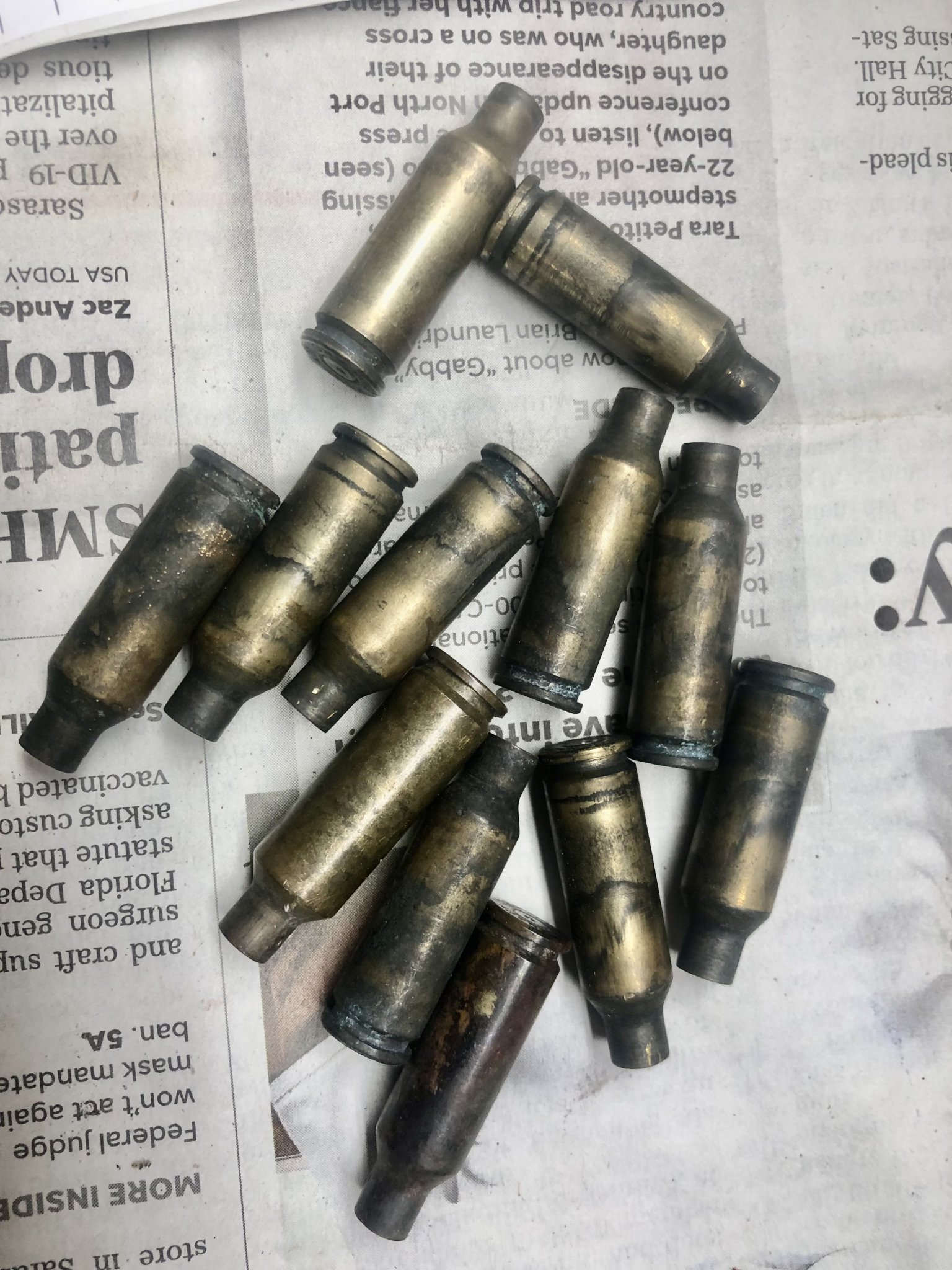

Interesting find at the range. These are just a few of the many left here by the person who fired them. By any standard I use, these are extraordinarily dirty, even for a gas gun. And yes, they are 6mm ARC.
ETA: when I see cases like this, I have to wonder if: A. They are too low pressure to seal in the chamber upon firing, our B. The upper is over gassed and ejecting then too early.

They are shooting suppressed.
Interestingly enough, i recently start to do a little surface research on the round and it seems interesting. It seems like most of these longer range/ alternate rounds has its own quirks but overall are pretty efficient cartridges.
The odd ball mags, bolt face and heavy fouling sorta of give me pause. I wouldn't call any of these things show stoppers, but something to consider before jumping head first into the 6 ARC game.

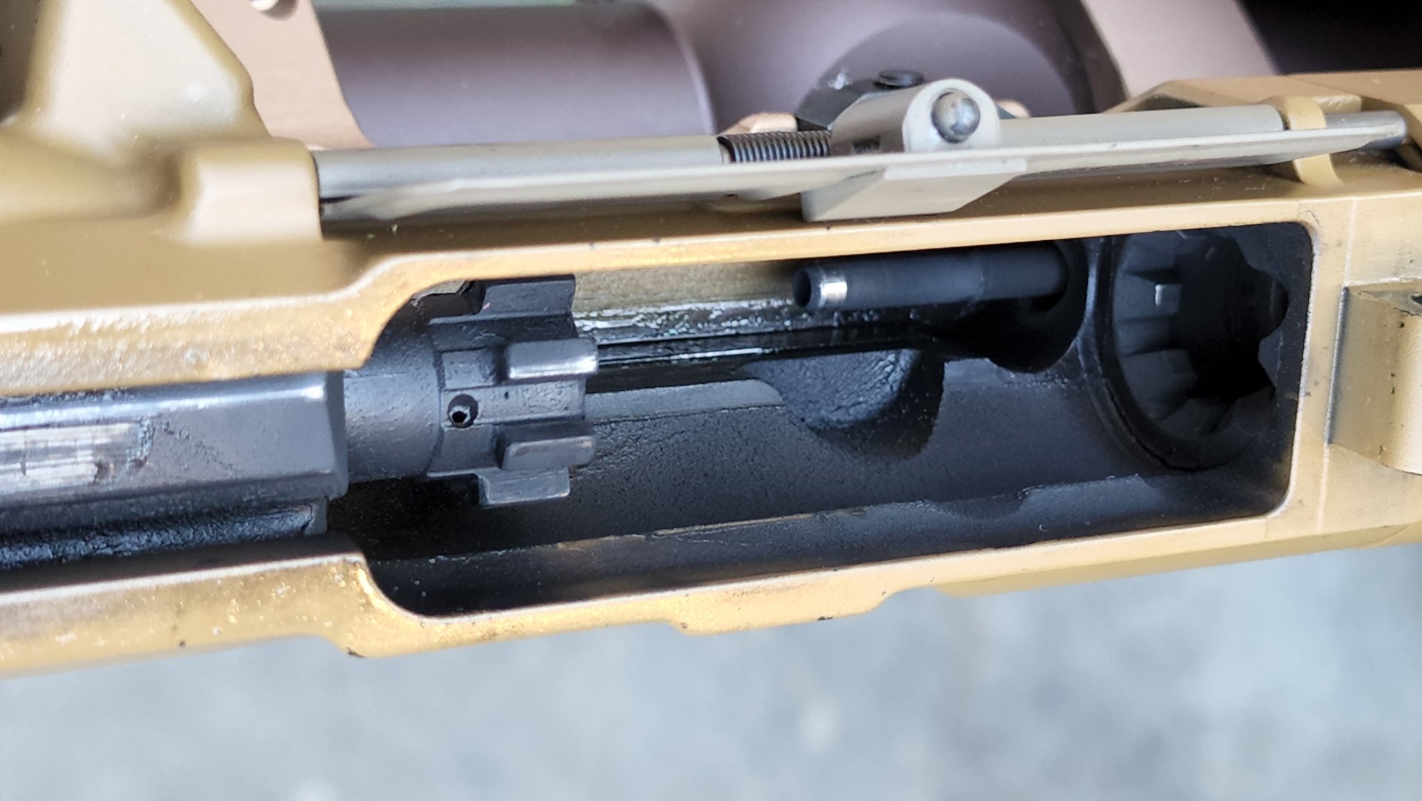

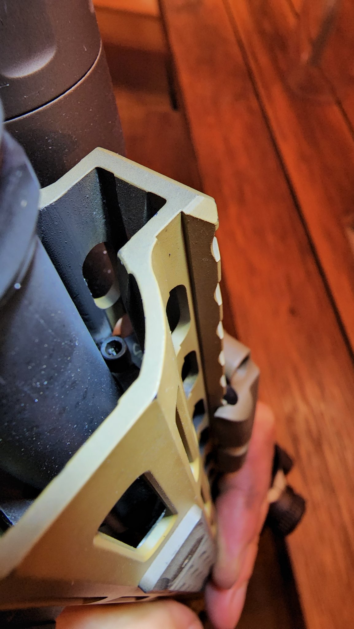

@MSTN - what gas block are you running under the G handguard? Getting ready to order same proof CF barrel and have same HG laying around. Ive had issues with some adjustable blocks making contact with G handguards. Thanks!
SLR.
It appears Geissele has for some time chamfered the corners of the gas tube channel, correcting this previous issue.
Those are like gold. Cartridge is so new that new brass is very hard to find. Pick ā€˜em up

I am not shooting suppressed since my shitty state doesn't allow them. My cases look like normal AR 556 with a little carbon on the neck, but nothing on the body of the cases. I am running an adjustable gas block and the Proof has a rifle +1 gas system.

ARC is definitely a little bit sootier than 5.56, but I agree the most of the difference in how the cases and upper receiver look is from suppressed vs. unsuppressed, not cartridge.
My match 6mm ARC AR-15 that runs a Hellfire Match brake all the time and never a suppressor has 500 rounds through it and I don't know if I've ever cleaned inside the upper yet. No undue filth.
I think I have ~5 rounds of 6ARC downrange without a suppressor; the cases come out nice and clean (function test). I have ~5000 downrange suppressed and the cases are dirty. They clean up and reload just fine. The upper fouls like any suppressed AR15 upper, but cleans up just as easily as any other upper. I don't tend to go more than 500-1000 rounds without cleaning (I clean after every range trip, and don't often do days with that many rounds), but I haven't had a stoppage at the range yet.

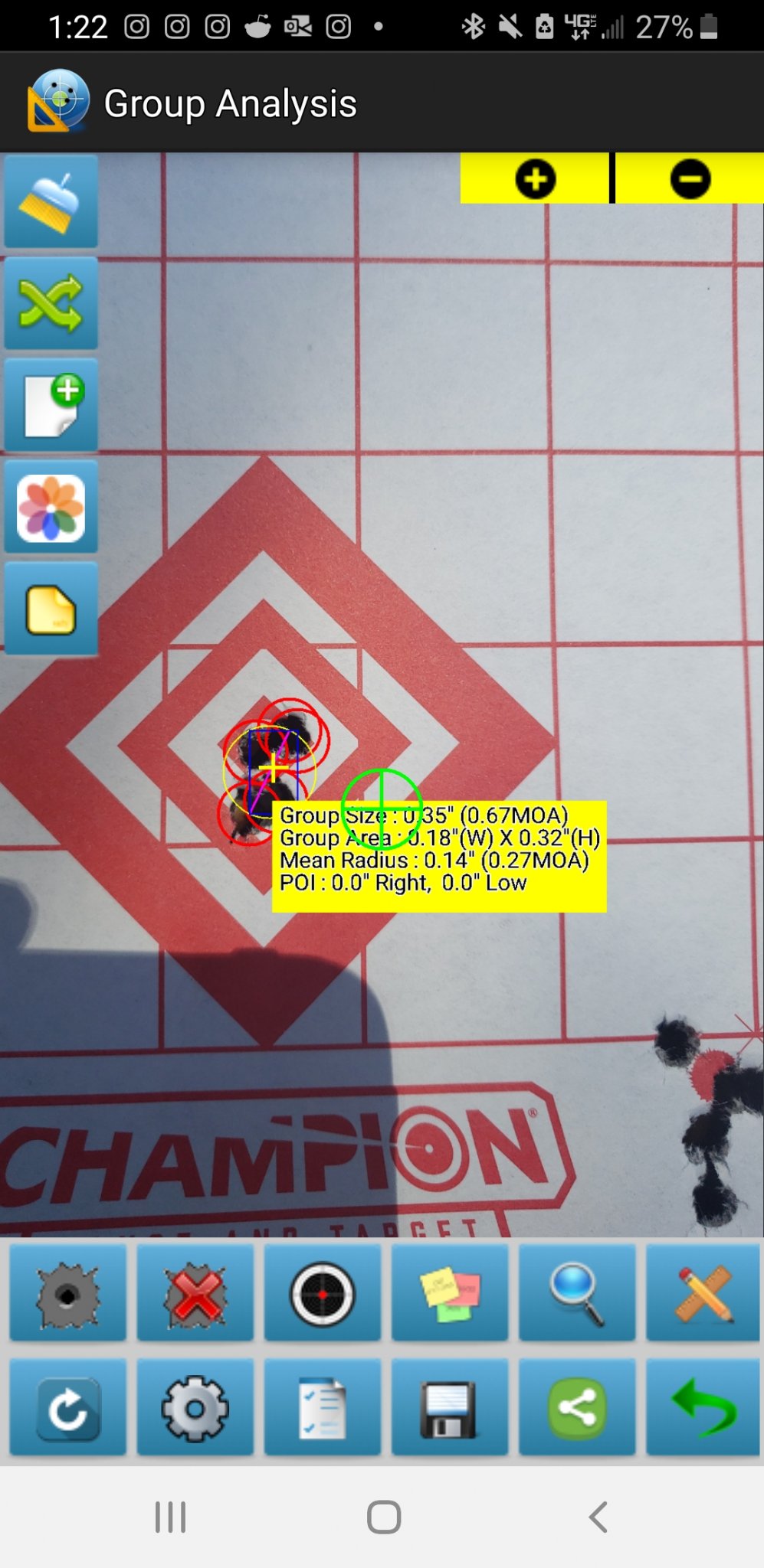

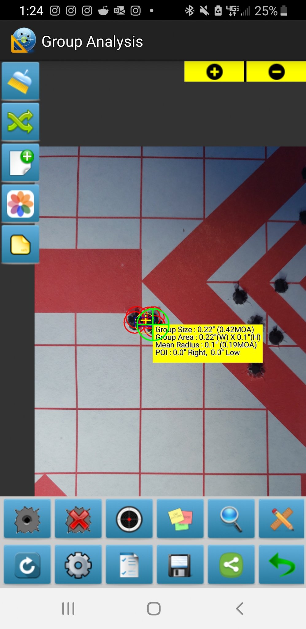

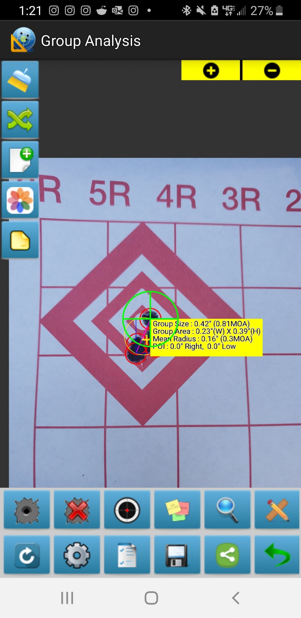

Broke in the 6mm arc barrel from CLE cleaning every round like the instructions suggested that came with the barrel. Then shot these 3, 5round groups. Factory 105gr hornady black ammo chronod an average of 2693fps out of my 20in barrel. Sweet groups, excited to see what else it can do.
I run all of my AR's (except my 3 gun AR) suppressed and it naturally dirty but for some unknown reason my buddy's 6 ARC ar is STUPID dirty. I don't know if it's the powder used in factory 108 eldm ammo or a larger case volume. He will stop using factory ammo once he accumulates 500 pieces of Hornady brass. Once that happens he'll be using LeveRevolution or CFE 223 which we'll keep an eye out for how dirty it is.
CFE is pretty dirty and worse when suppressed. That's the case with my Grendel, haven't finished my 6 ARC yet
