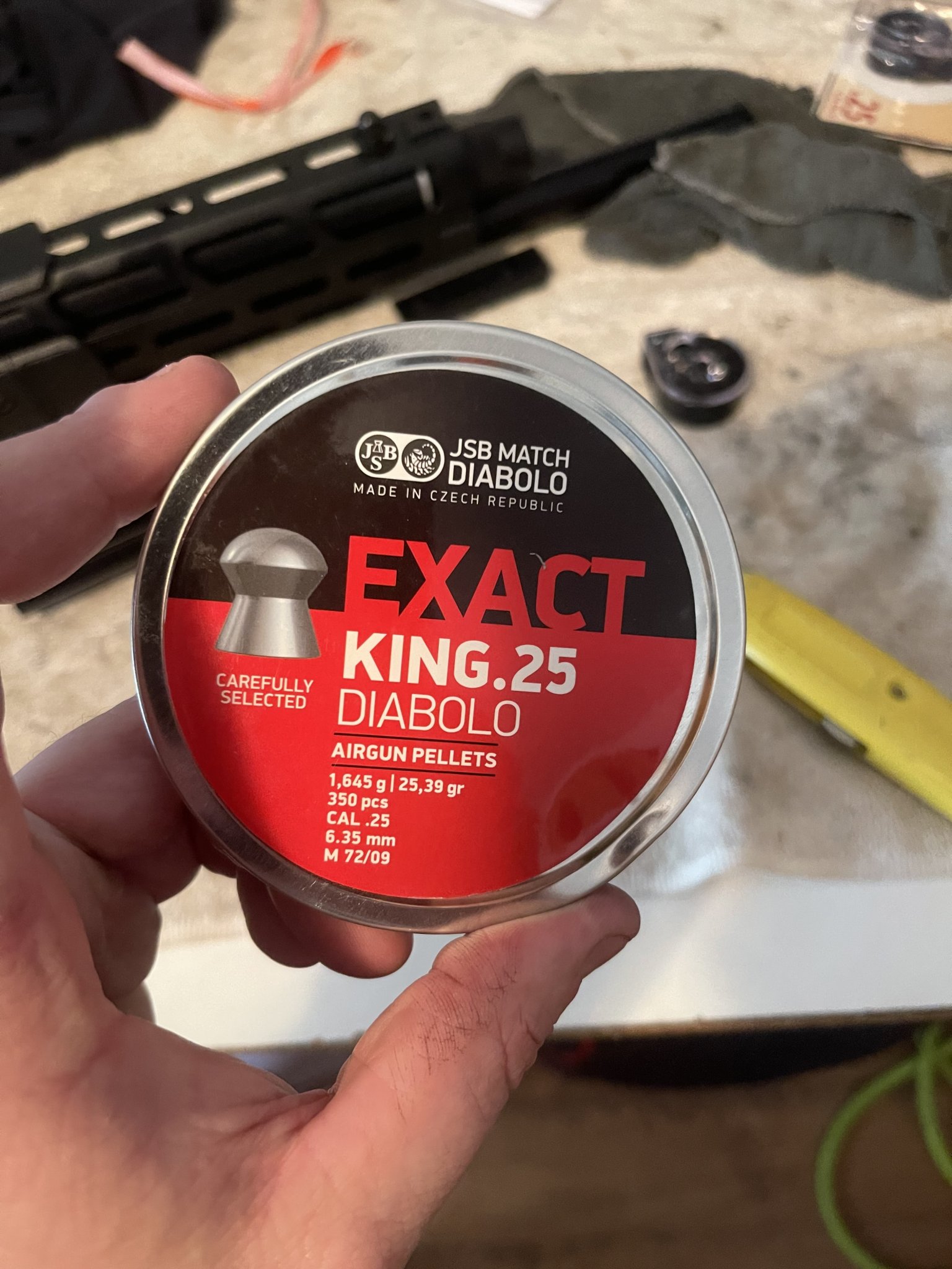

Last box of 10.5 CP's I got were awful in my Marauder. Even after doing some sorting they still shot like crap. Was a shame since previous boxes of 7.9 CP's shot great in my HW77. I've switched to JSB for all my ag's.
I’ve found the JSB and H&N pellets to be extremely accurate.

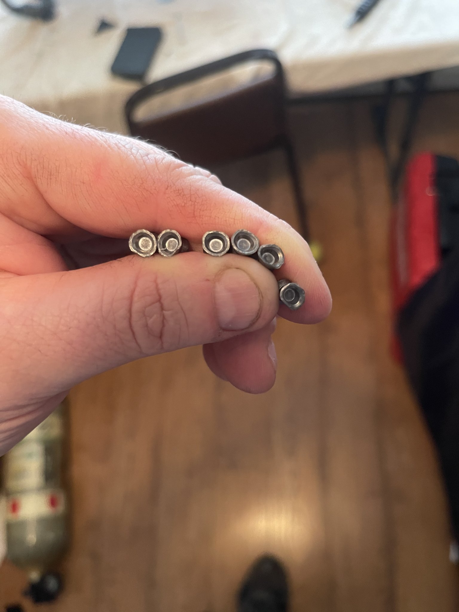

Also what is the opinions on slugs vs pellets?
I just saw this thread a few days ago and have been busy but here's my .02 on slugs vs pellets.
Inside 50Y a "good" pellet, from a good batch, out of a good gun, will often have smaller vertical but blow in the wind more. The higher the BC of the pellet or slug the less they will blow but slugs are most often a higher BC than pellets.
At 100Y you'll start to see a bigger difference in wind drift of the higher BC slugs compared to any pellet.
Past 100Y pellets will begin to falter rapidly because of the shape. Low BC and High drag.
No contest past 100Y, slugs will outdo pellets """if""" the slug is precise in your gun to begin with which usually means the twist rate and other factors are correct for slugs.
Also the airgun community has not figured out why commercial slugs can give big flyers. The good ones are swaged and are very consistent but still send a flyer off a great group. This happens more often than with say good rimfires using good ammo.
Finding a slug to work in your gun "can be challenging" but sometimes not. And sometimes tuning your airgun to the slug is required.
It's kinda like finding a type and lot number of 22rf ammo for your 22rf.

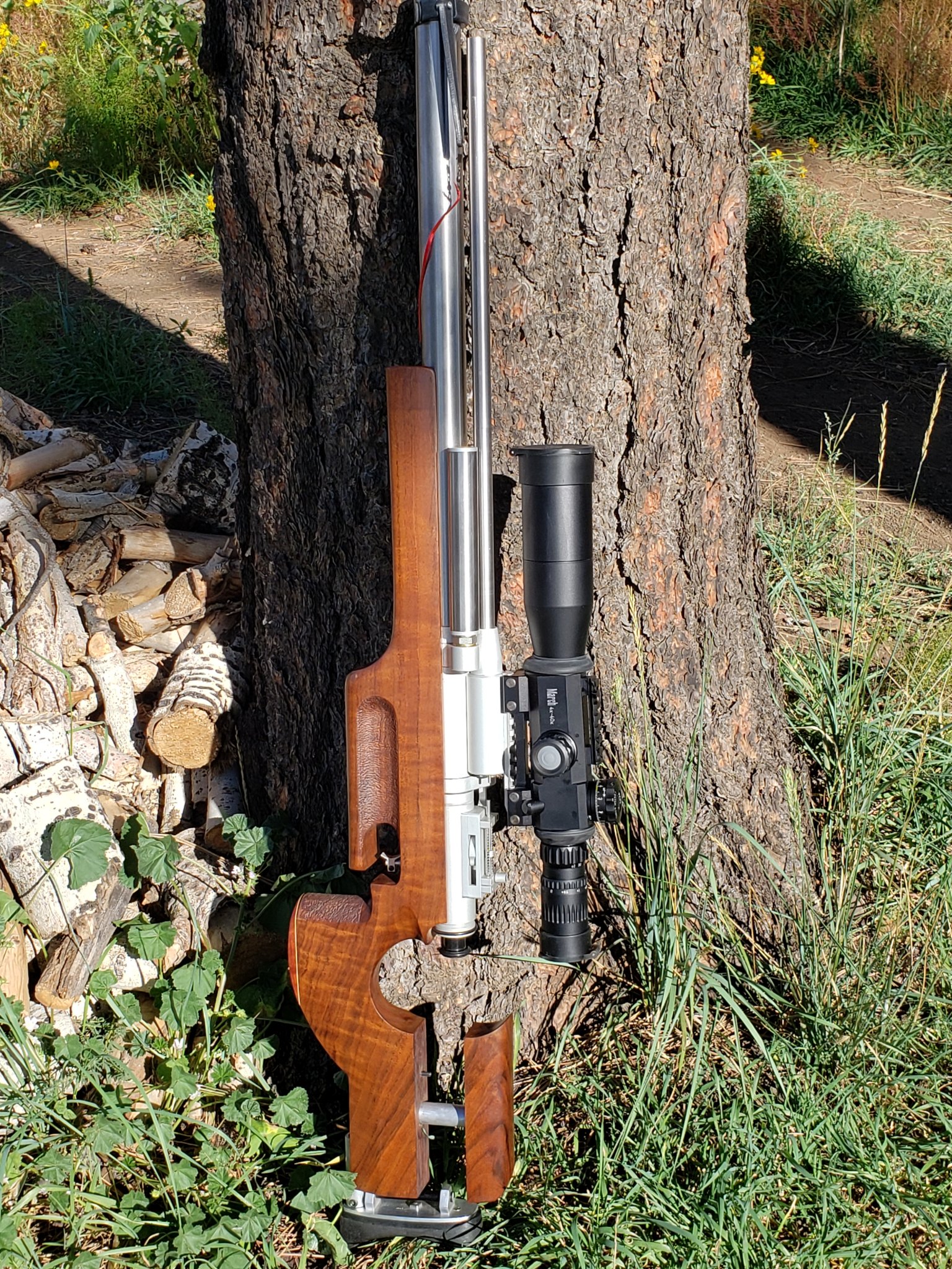

My two Thomas single shot pcp rifles.
This one is his HPX model, I named it SURELY. I have one barrel for custom swaged 42 gr 22 cal lead slugs going 780 fps and another barrel for heavy 22 cal 25.4 gr pellets going 965 fps/52 fpe. Those are 100Y groups with the pellet barrel. It's really hard shooting good groups at 100Y with pellets!!! It's way, way, way easier to shoot good groups at 100Y with a good 22rf vs a good air rifle.
This one is designed for Field Target air rifle comps, I named it Purple Reign. It's 19.5 fpe in 17 cal. It can also be converted to a 12fpe pistol for the same sport in PFT division.
It's won or tied the only 3 FT matches its been in. Except my daughter was the one that won the last match using it to shoot a perfect score. The brat beat me, lol!!!

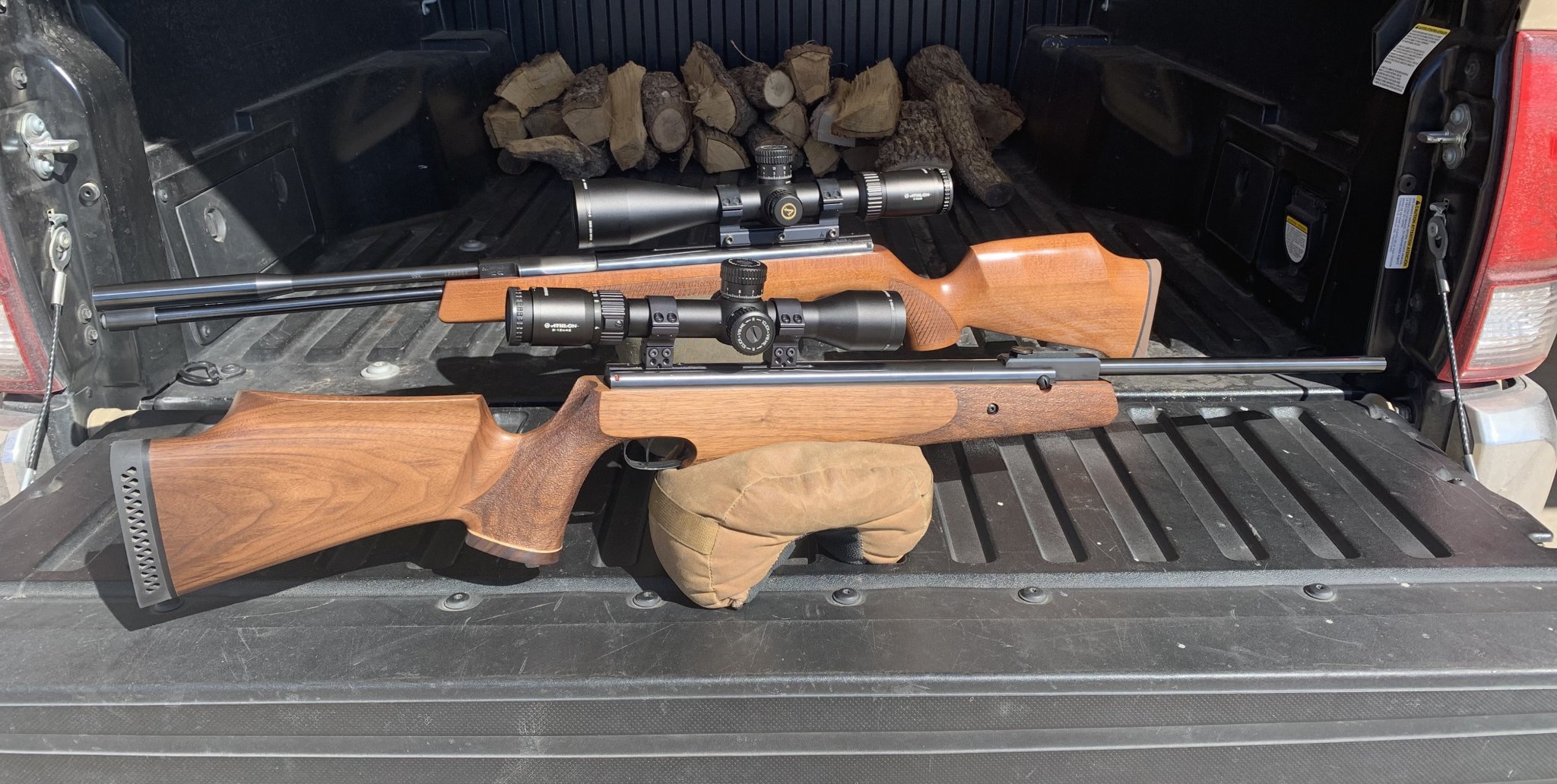

Break barrels are all I shoot, love the simplicity of them. HW97 .177, HW95 .25 and not pictured is my R7 .177. All three have been tuned. The HW97 is stupid accurate.

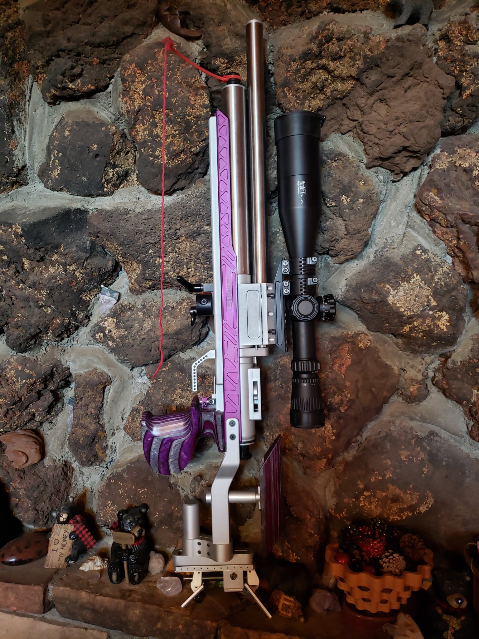

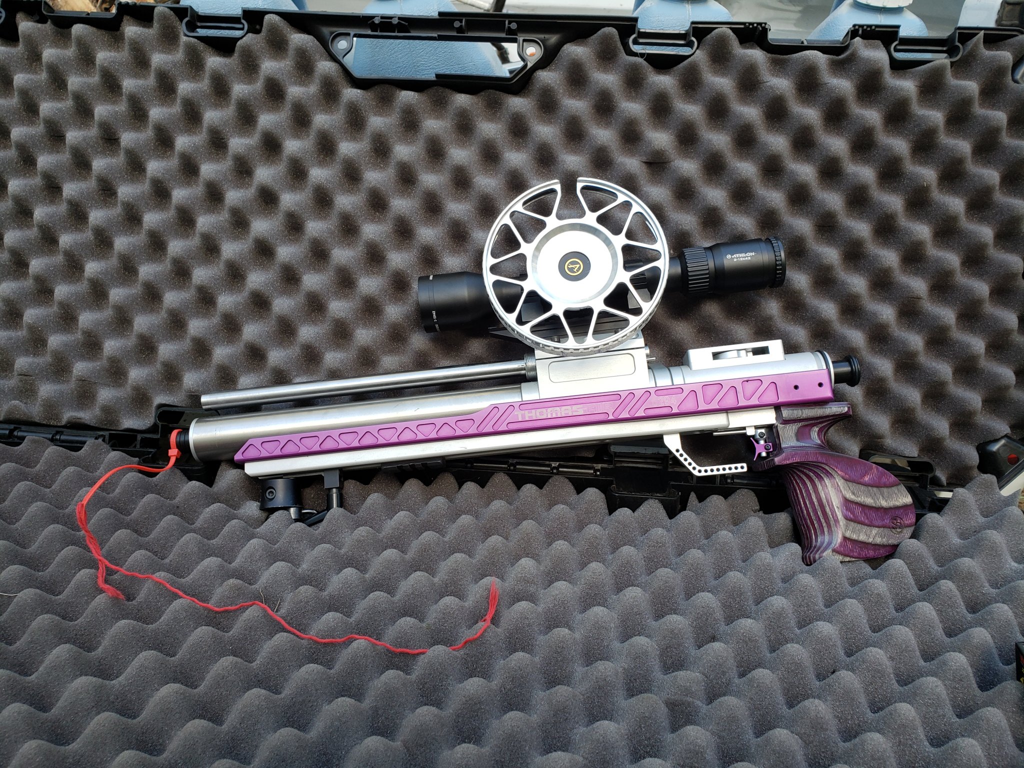

Just thought I would post a pic of Purple Reign converted over to a pistol for Pistol Field Target competition.
This included abiding by the rules for the PFT division;
No more than a 12x scope is allowed so I put my Athlon Helos G2 2-12x42 DMR scope on. I also dug up a large side wheel I found in my airgun extras drawer to attach to the side focus of the scope. A large wheel helps with determining the distance by using the clearest focus at each distance and marking that distance on tape stuck to the face of the wheel.
No more than 12 fpe of energy so I took the 20 fpe jet out and put the 12 fpe jet in so instead of 820 fps for 13.4gr pellets/20 fpe in rifle form, its 720 fps for 10.3 gr pellets in pistol form.
Can't have more than a 15" barrel which it already had anyway so I didn't need to change that.
Can't be more than 25" so all I had to do was remove the butt stock assembly with 4 screws and the barrel shroud as well.
I spent a few afternoons getting my dope down and calibrating the wheel for distance.
How'd that go...Results... I won PFT Hunter division in our AZ state match on Friday with 37/40.
Ha, I had some odd inspiration as I thought about names for the PFT version as I lay in bed that night processing the day - Let's see there's Purp which is close to purple and then it hit me, hey call it Perp which is short for perpetrator. So it became "The Perp" LOL??? which is close to PRP or Purple Reign Pistol.
Then I put it back to the rifle version and won Unlimited division with Purple Reign by Sunday afternoon. Though I don't consider it much since there were only two of us in this non AAFTA recognized division and I really let myself down as well the rifle because I didn't shoot as good as I do normally.

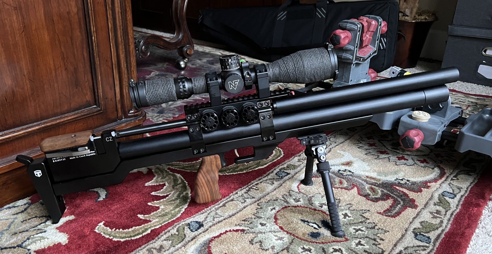

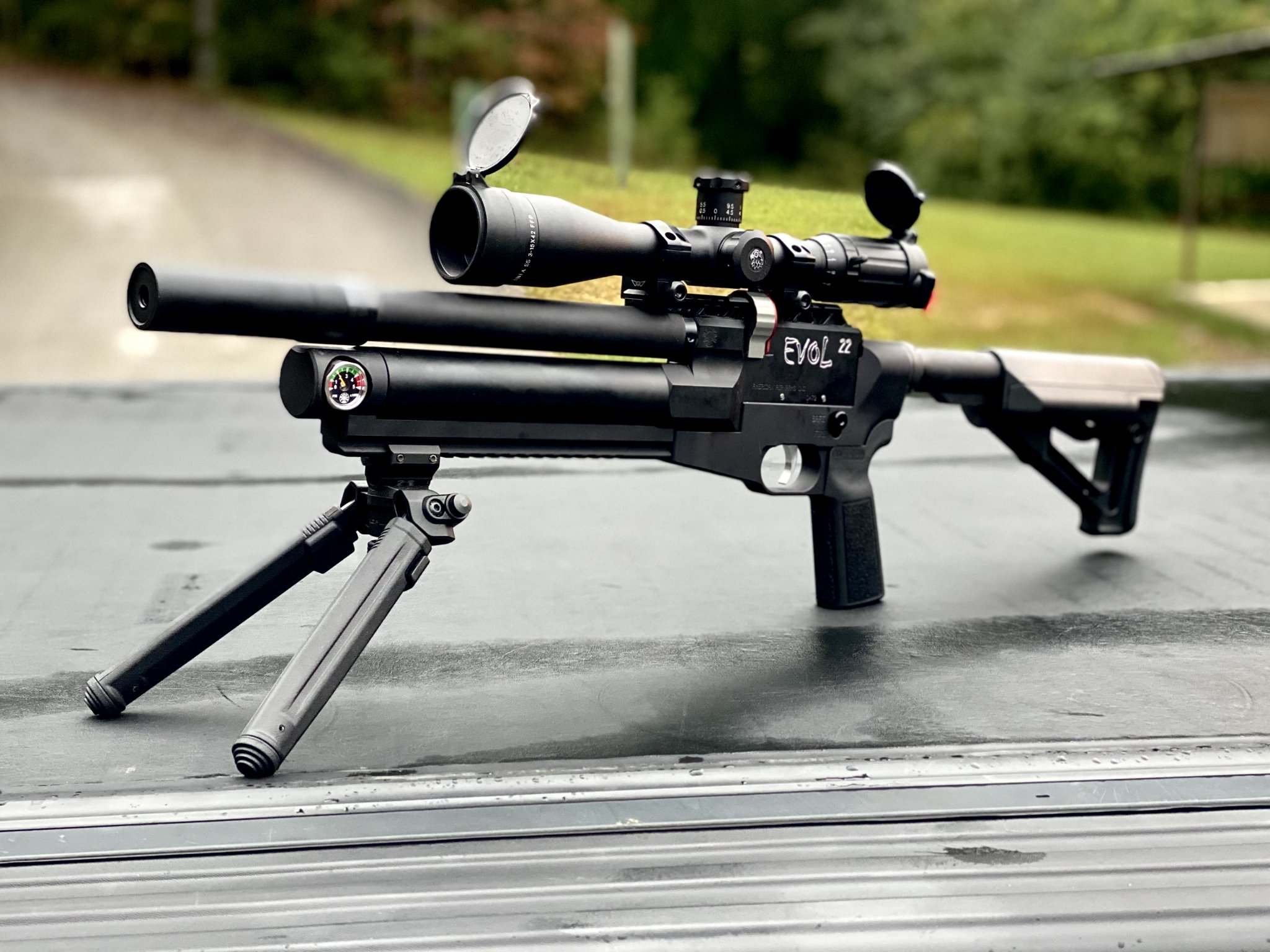

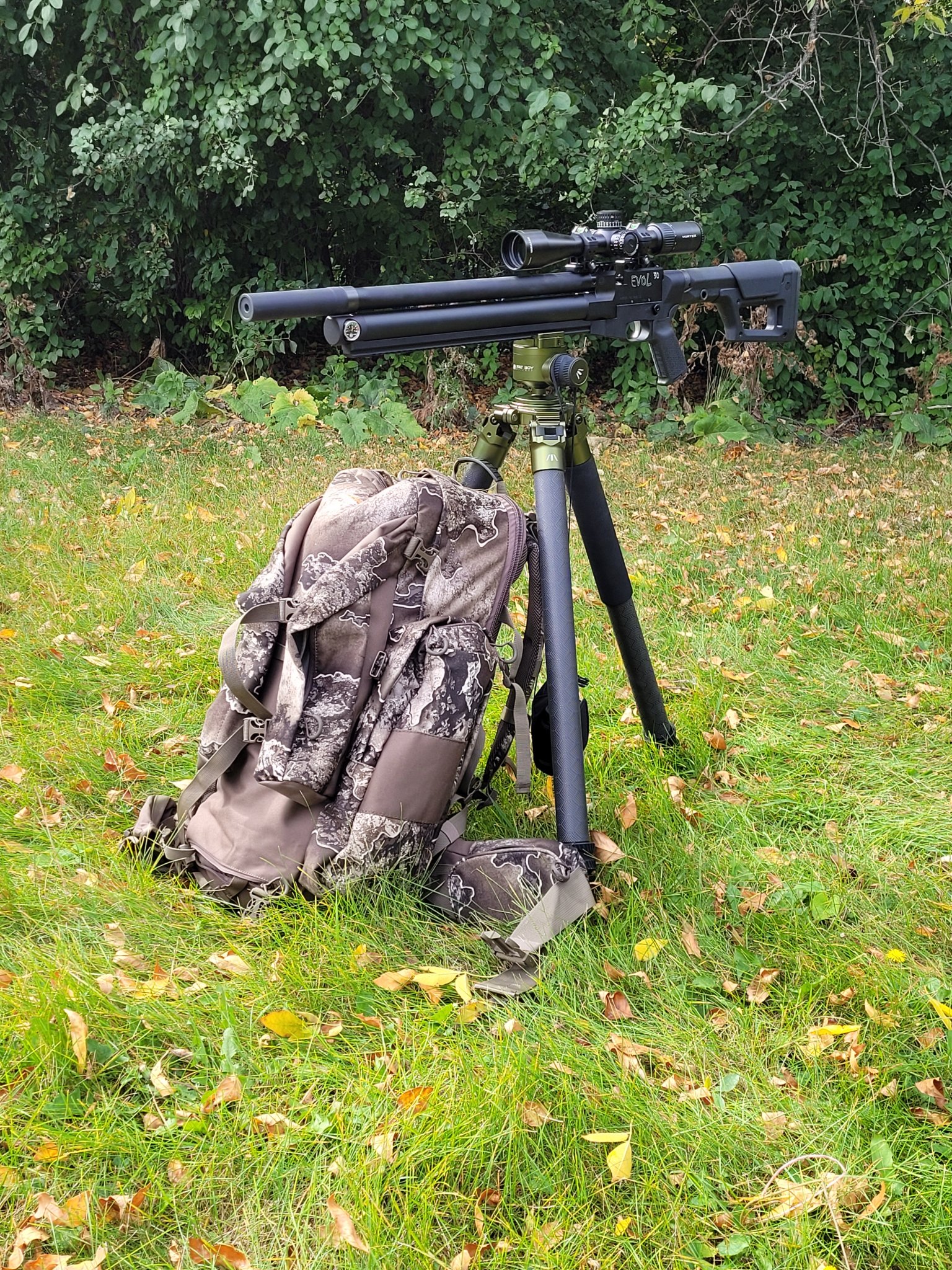

No love for the Evol? I have two, this one and a 30. Not a huge shot capacity, but very trim and crazy accurate.
These are well built and rugged, especially for an airgun. I know Tom personally and he is a nice person. I've shot a few of his prototypes and personal airguns.
I had the EVOL full size in 30 cal for a while that was 80 fpe. While a guy a know had one in Texas that was a very precise rifle, the one I had wasn't as precise as I expected from it. I didn't like the extra effort it took to cock it was the other thing.
Your 22 cal is the one I'd want if I got another and since its 30-ish fpe the cocking effort is normal. A friend has that same caliber and length, it's sweet.

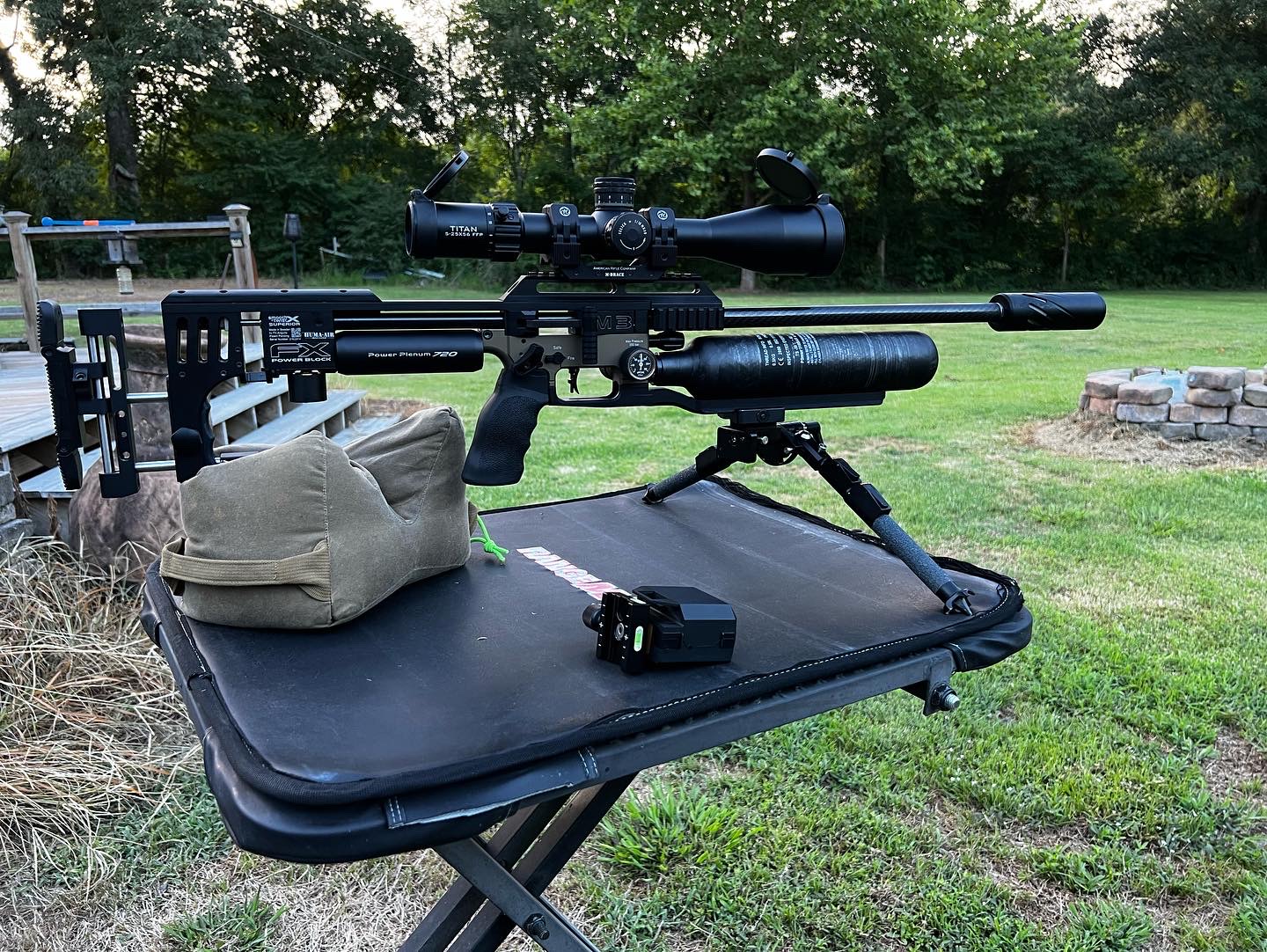

I shoot the FX Impact M3 in .22 & .25 700mm w/ slug liners and tensioned barrels. I am only shooting the PCP for Local NRL22 matches and getting the RimX out for NRL-X Matches.
*** Caliber ***
The .22 & .25 with Varmint Knocker slugs are phenomenal for whatever you are looking to do. I shoot both calibers out to 350 yards and they hold their own if I am doing my part.
* .22 in a 32.8g HP Slug I'm pushing a 1035 average. 16 ES. 6 SD.
* .25 in a 34g HP Slug I'm pushing 1055 average. 12 ES. 4 SD.
**** Dealers ****
Utah Aur Guns is a HUGE company that is there to support and help the end user as much as possible. They are just the biggest name. SPAW( Southern Precision Air Weapons ) is the second largest name. Either one of these companies can pre tune and set the rifle of your choosing up for you.
***** Brand ****
FX is probably the busiest name in the business right now due to a lot of reasons. The Impact M3 and Dreamline will do what you are looking to do. It comes down to the tuning process and how much you want to do and feel like doing. Then you have the RAW brand with a few different options in their lineup as well.
I would look at magazine capacity as most shooting stages are 10 + rounds, so that puts the Ed Guns Leshy with an 8 round magazine OUT of that game.
Look at the ability to add ARCA Rails and such as well. Krayford & Lypt, Saber Tactical & Air Marksman does that well for the FX lineup of rifles. I am not sure on the other brands.
When you get into the PCP world you can tie up a lot of money real quick. I have more in it than my RimX. I also have 3 SCBA Tanks for air.
FX Impact M3 .22 700mm Sniper
* Heavy Slug Liner
* Barrel tension system
* Hugget Mini Magna Air Moderator
* Tungston Hammer Weight
* Heavy Spring kit
* Huma Air 2nd stage reg
* Huma Air Gen2 Slug Port
* Huma Air Slug Probe
* Fully polished internals
* Krayford & Lypt ARCA Rail and Butt Stock w. bag rider
* Element Optics Titan 5-25/56 34mm tube Mil Reticle
* ARC M-Brace 20moa 1.26 mount

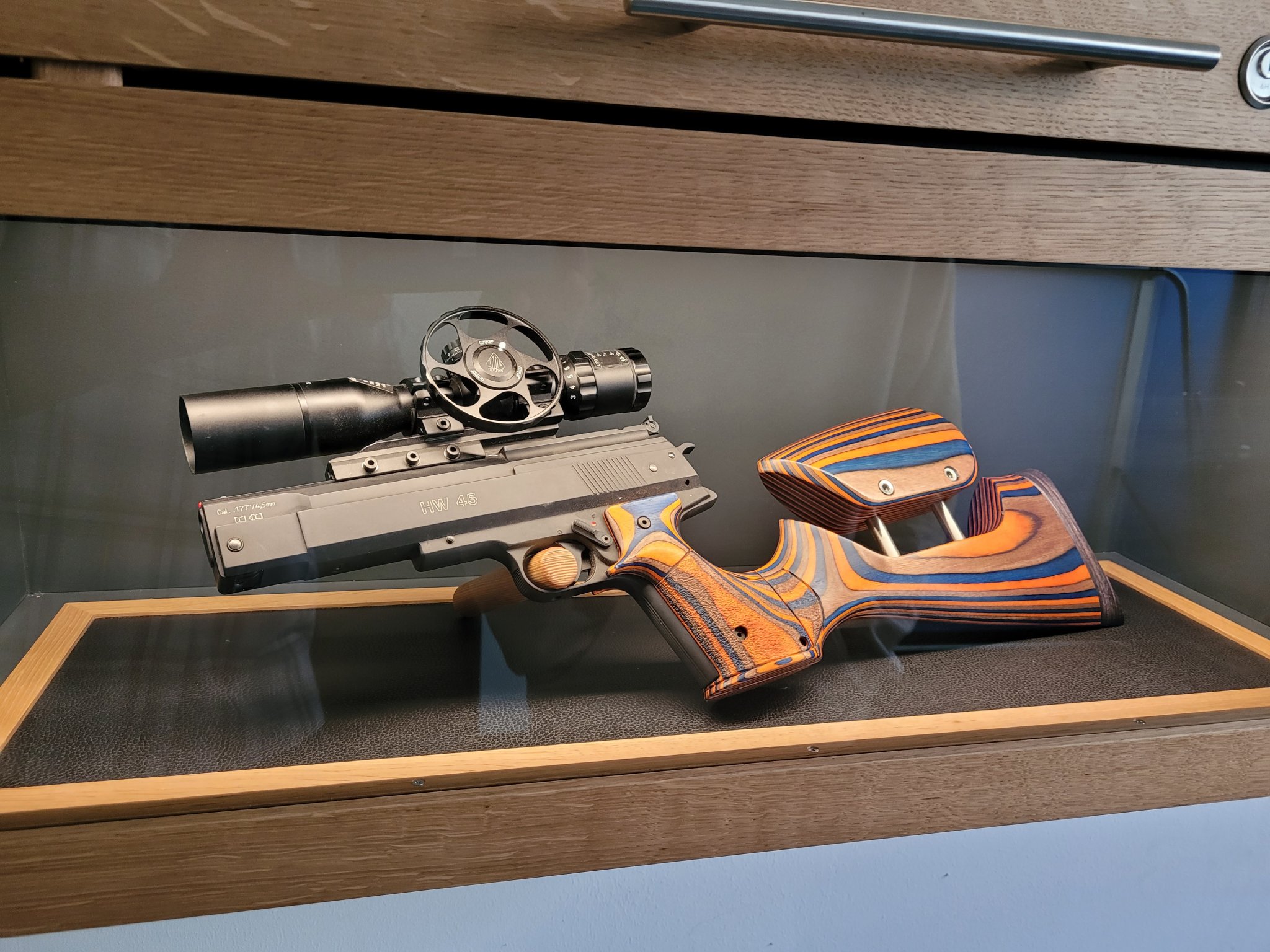

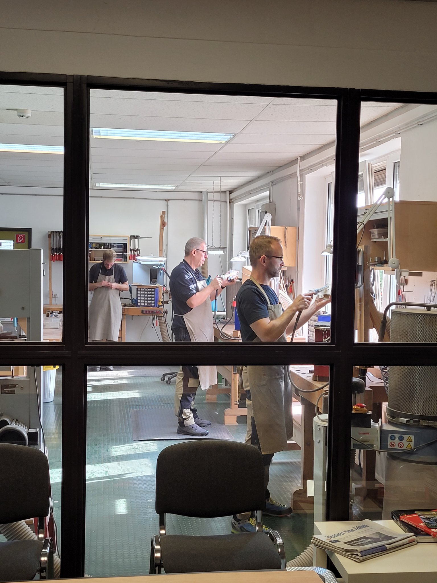

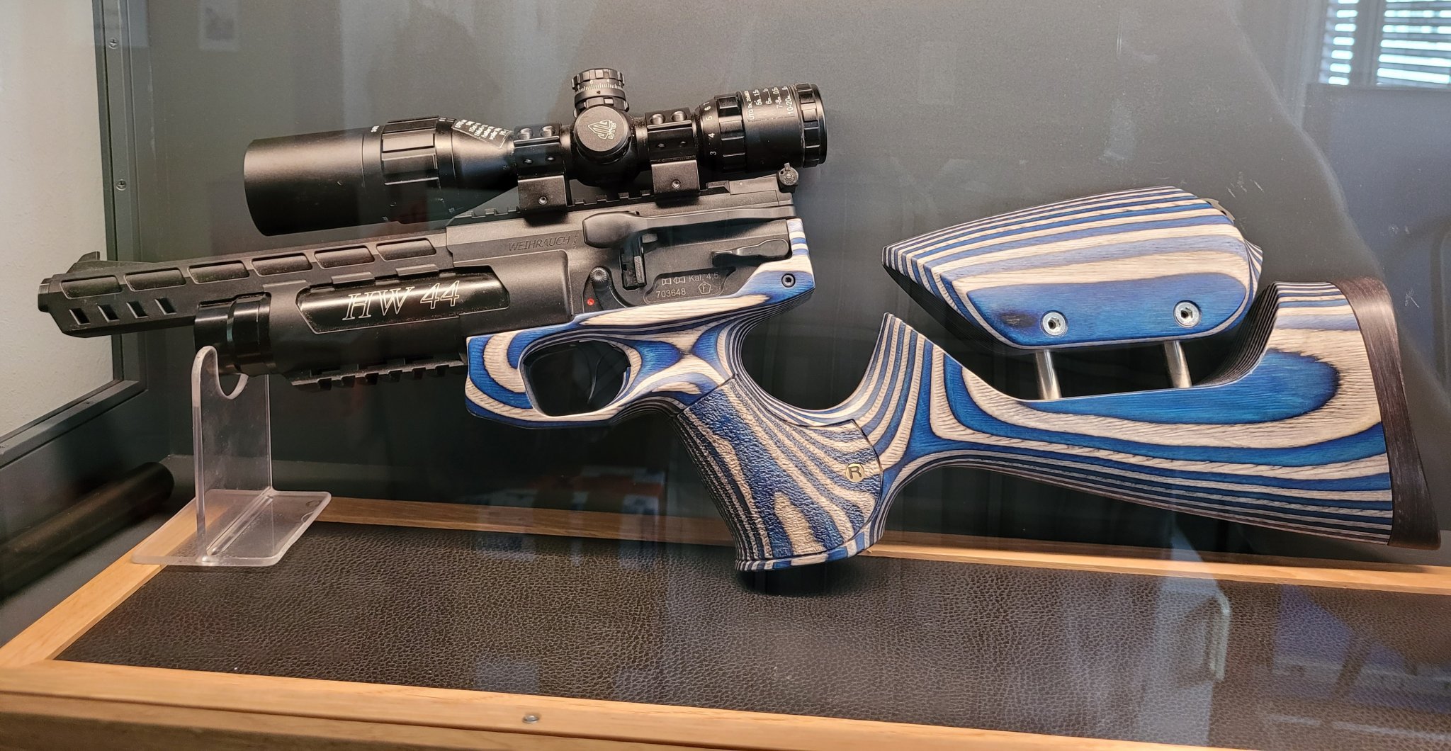

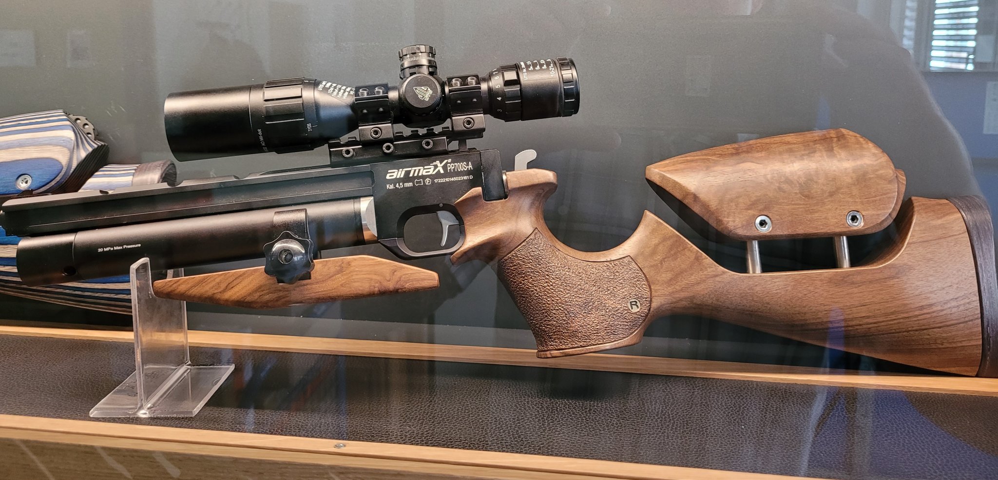

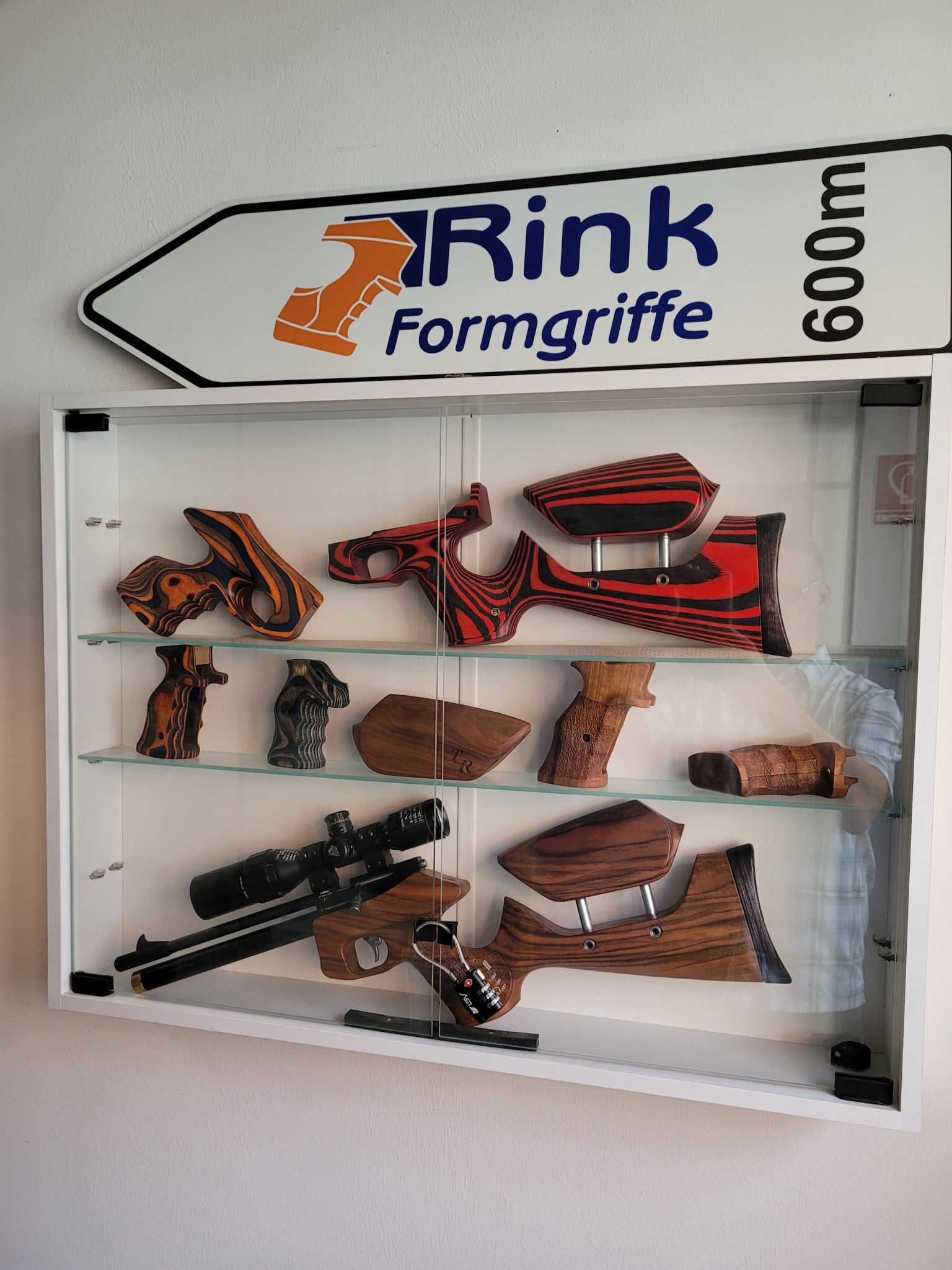

A few pics from Rink.
Super nice guy. Neat process. A set of fitted grips for my EVO cost the same as a factory set, well minus the plane ticket of course.
Also having a set made for my Model 41.

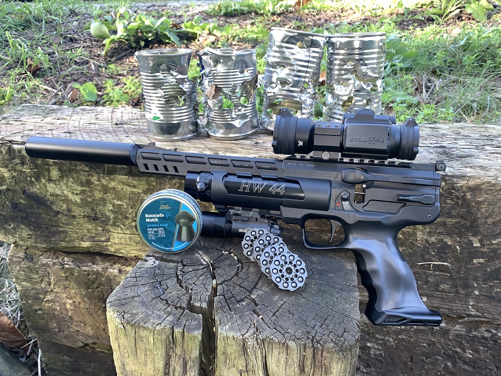

I like the stock for the HW44. I started off with a Vortex sight. These are soup cans shot at 50 yards.

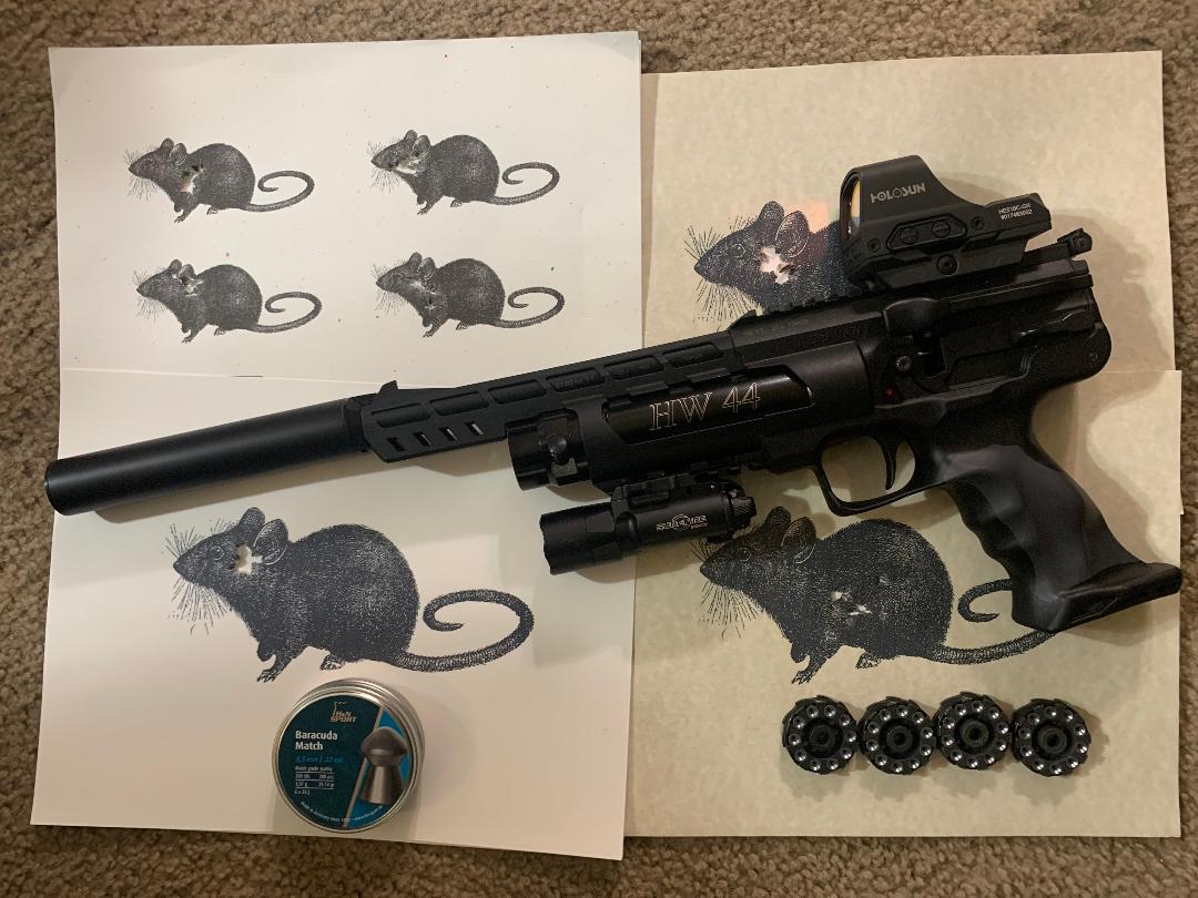

Then I switched to a Holosun sight. Targets shot at 25 yards.

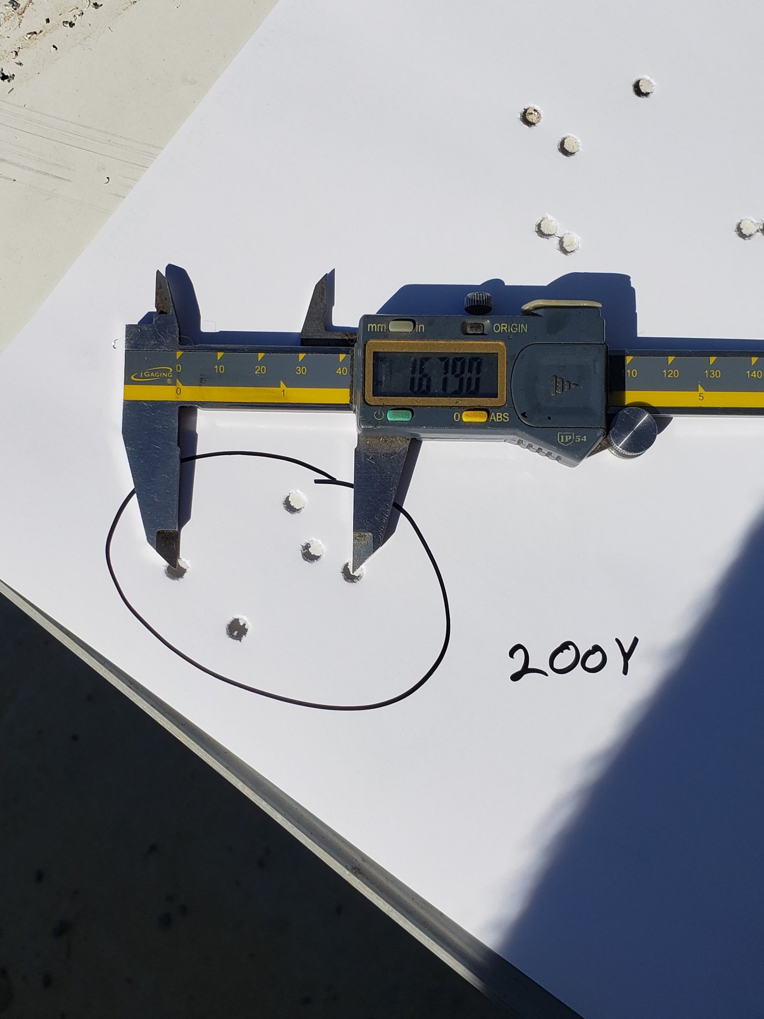

I bought a March Genesis 4-40x52 and put it on my BB gun, JK, but I did put it on SLUGSURELY the Thomas HPX that shoots 42gr slugs.
Yesterday I was having fun hitting a 6" tall and 1 foot wide rock at 391Y with it using 31.2 mils dialed on.

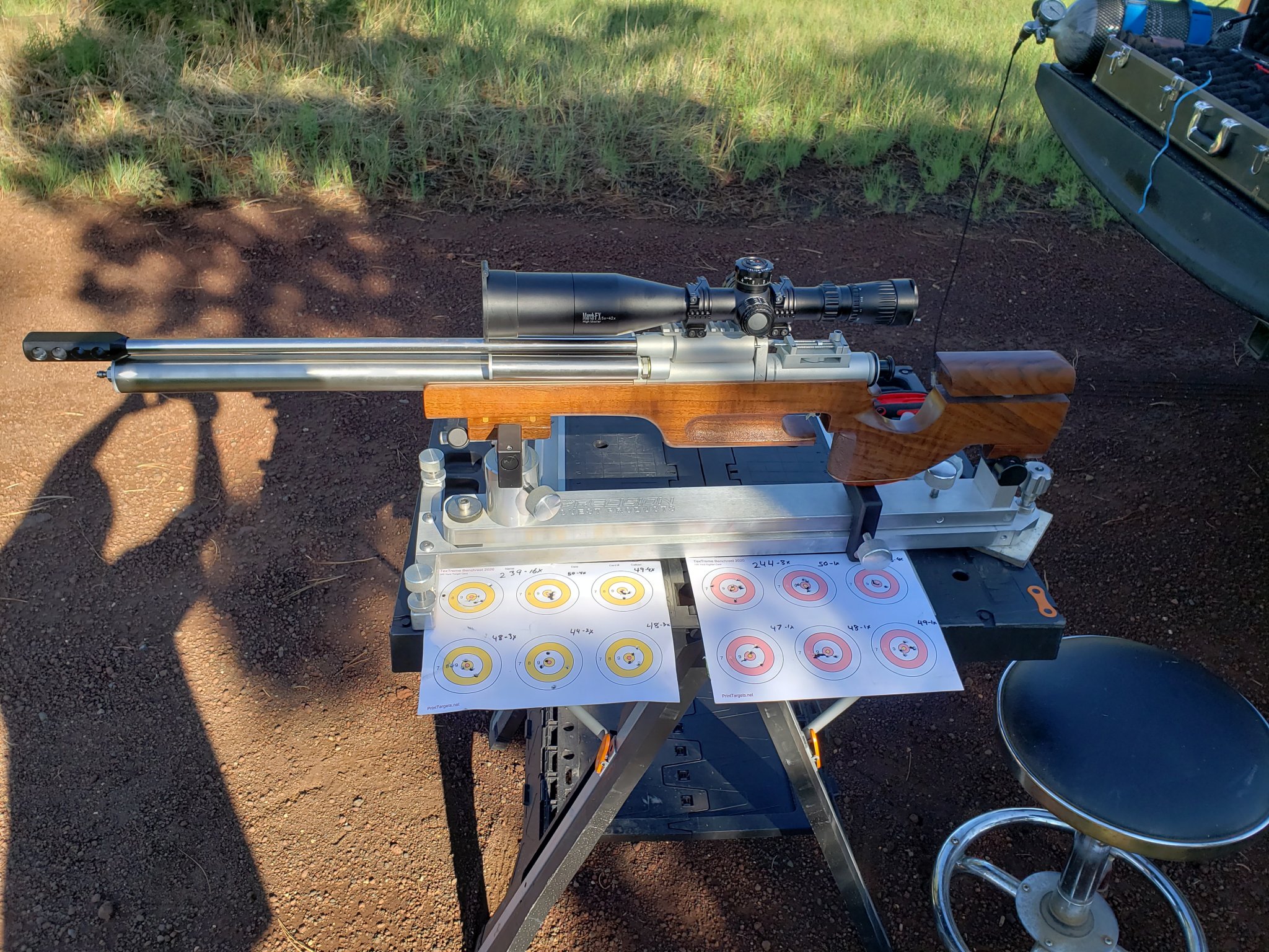

On Wednedsay I visited Mike N the guy that owns Thomas Rifles. I think he is now on his 3rd iteration of the HPX platform of his pcp rifle. Mine is the 1st Gen BTW.
His new BR rifle is totally amazing! He can literally shoot sub 1" groups at 200Y. Here's a link to some of his groups.
https://www.airgunnation.com/thread...-n50-pro-class-slug-gun.1274990/#post-1335125

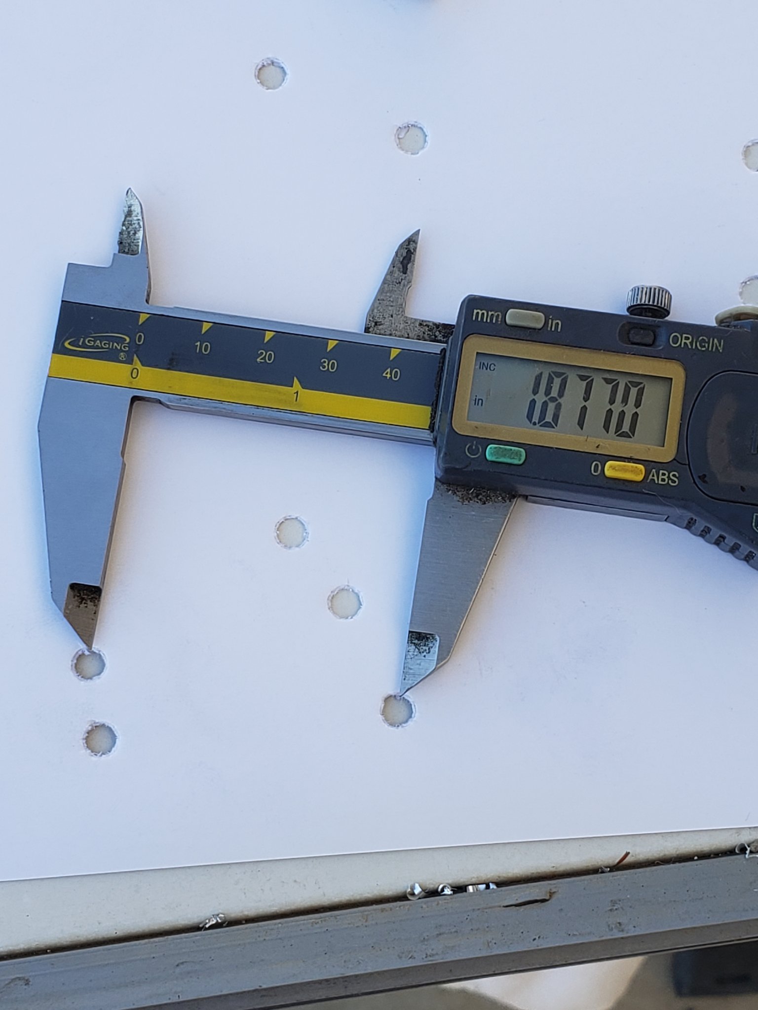

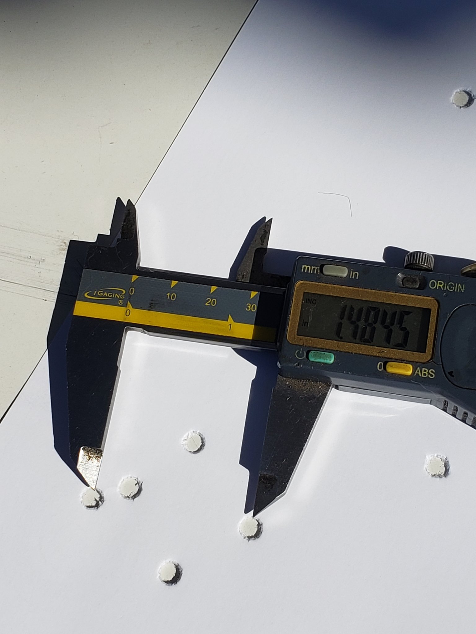

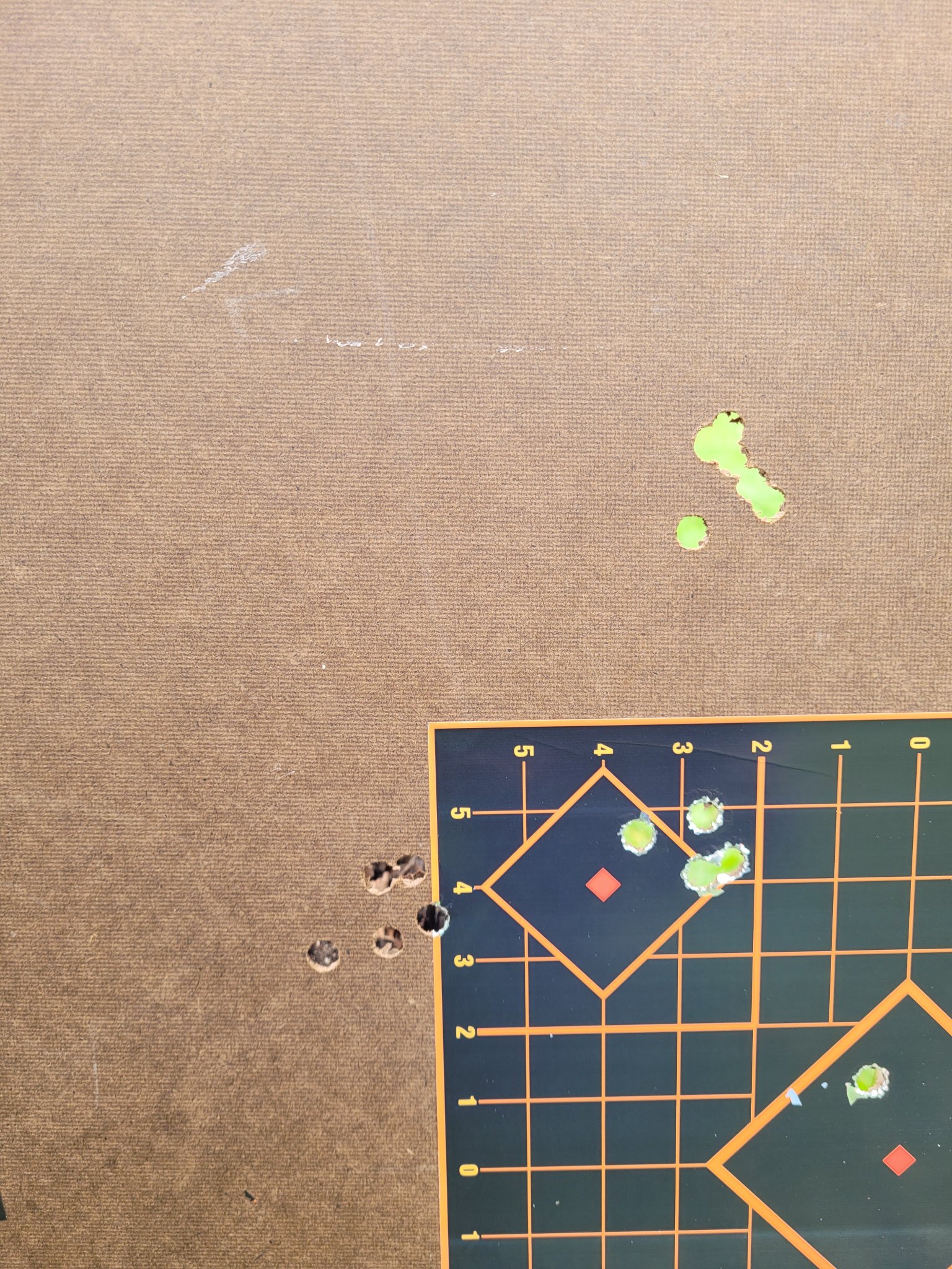

My pcp rifle named SURELY isn't quite that good but not bad either. Here's some 5 shot groups I shot at 200Y. I couldn't make out the bullet holes all the time so I kept shooting until I thought I had a handle on where to aim to shoot a group. As a result there wasn't much room on the white card stock to shoot a group or for that matter an exact place to aim. Eh it is what it is, very unofficial, but here they are, lol.

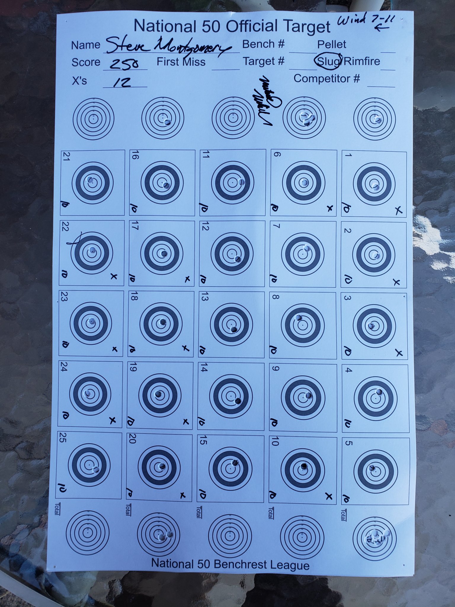

Have read through your Surely thread on the airgun forum a few times. And what you have accomplished with that rifle is nothing short of amazing!
Thanks man!
It's been a fun journey and I've learned a lot.
I found out SURELY needs pillar bedding "REALLY" bad.
Actually Mike's aluminum BR stock is a must for the BR game if I were to get serious.
I shot my first 250 on a N50 card when I was at Mike's place.
That frigging rifle of Mike's is insane how well it shoots, especially if I can get a 250 with it! 7-11mph from 8-9 o'clock too.
I'll post a pic of it hopefully tomorrow.

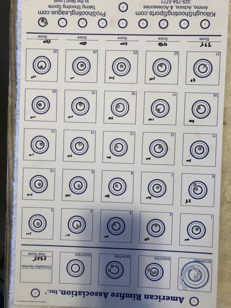

Edit, kinda late posting this pic. Mike N pluged the one on #11 and it touched the black line but barely. That's his signature too.
Now look at Mike's "practice"card, its a different game than N50 from months back, its the one that's upside down, he took a 2nd shot just because of that flyer out of spite, lol. That's the difference between a master like him and someone like me. He knows how much and which way to aim either up or down or for windage needed. Yes the wind affects the vertical too.

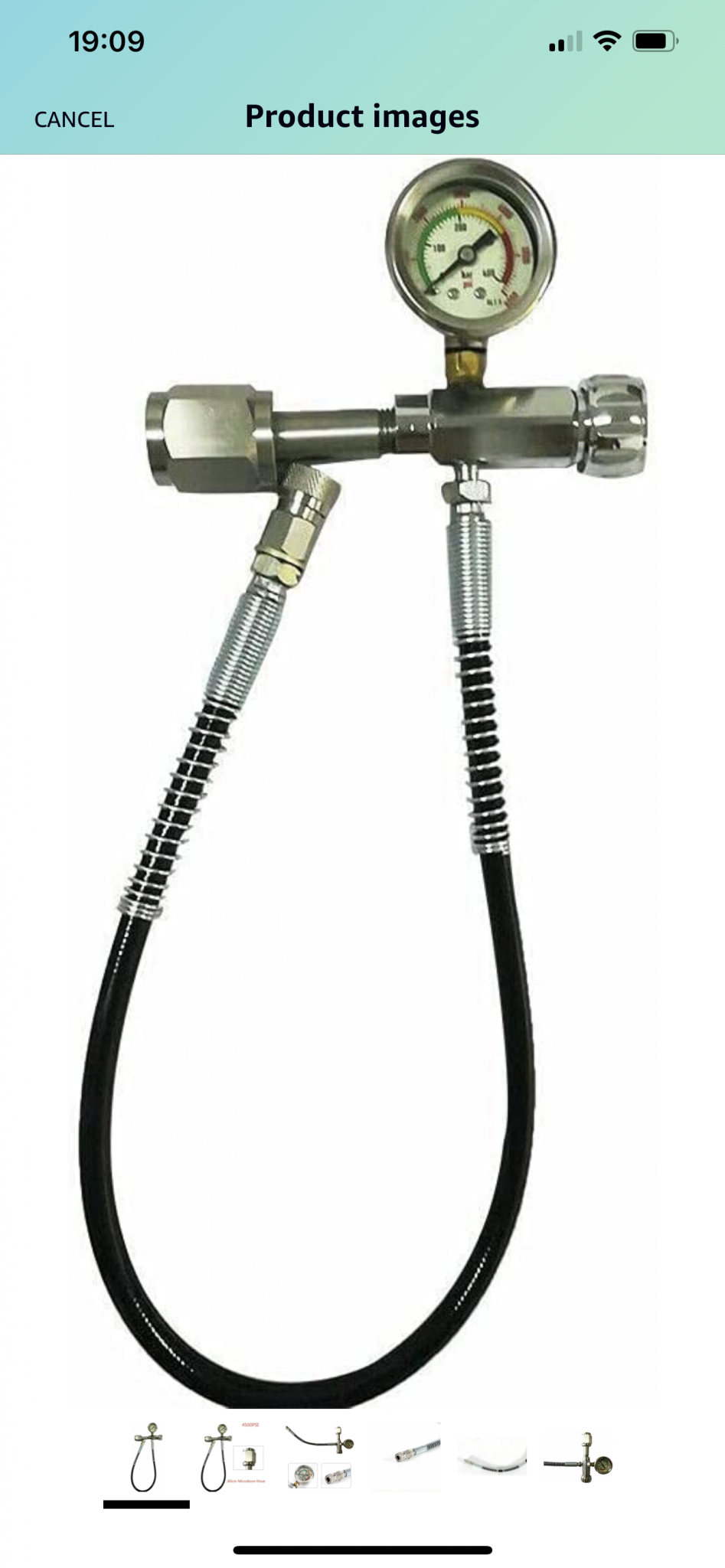

What would you guys recommend for a scba (firefighting) tank to pcp air gun
I looked at a bunch on Amazon. All seem to be in the same price range around $40-$100.
Basically same pics for different brand names. Which tells you there made by the same company. Some have 5 star reviews but most have poor reviews. Even though the appear exactly the same
Anyone know of a reliable fill valve? 4500 bottle
This is what I’m looking for. But reliable

air tanks plus website. A little pricey but everything works and fits without drama. No chinesium crap. Their adapters are what I use to service my FX Dreamline.
*** Caliber ***
**** Dealers ****
***** Brand ****
* Heavy Slug Liner
* Heavy Spring kit
That is bad ass!!
I've lately been seriously looking at air rifles. I have gravitated toward the PCP but am still undecided which direction to go.
I'll likely shoot more grasshoppers off the fence than anything but also want to able to kill varmints or hunt squirrels.
Are your numbers correct...the 25 shoots a little faster even with heavier slugs?
How much does that set up weigh? Balanced? Able to shoot off hand easily?

Is this normal to have a decent amount of damaged skirting on jsb pellets? By decent amount I mean 20/100 seem out of round

No, not in my experience. That is the same pellet I have been using and I don't recall seeing any that looked like that. Maybe that dent in your tin indicates rough handling.

I shoot those same pellets. I get them from Pyramid Air. They pack them up really well. So far they've all looked pretty good.
On the other hand, I get a lot more leading in my barrels than what I'd like.
So, I have another tin used for lubricating the pellets with a few drops of Ballistol. Problem solved.
That’s what I’m figuring to. I tried some jsb for my .22 marauder. The gun actually prefers crossman pellets. The jsb had a few more damaged skirting in those than the crossman in that case as well. Just wondering what is normal.

I ordered this tin off Amazon….I know 😞
Just ordered the same from air guns of Utah and I’ll send these back. Some won’t even insert in a mag
My .22 crossman pellets have about a dozen in the tin that are questionable. The skirting seems softer on the jsb. Maybe not though. Assuming they’ll seal a bit when fired but these seem a bit excessive
I just looked at the photo again. The lid looks dented at about the 4 O'clock position. That's why you have some dented pellets.
Yup I see that. There was foam in the tin. Just wanted to make sure it wasn’t normal before I reorder some
I get a lot of JSB and H&N pellets in .22 and .25 caliber. So far, there have been no problems.

I see air guns of Utah has the same for 4 or something. I was questioning wether this damage was normal. But just jumped on utahs site and bought a new tin. When I see they work good I’ll order a bunch for either one

Even with undamaged runs you will have bent skirts. I honestly have seen no accuracy difference. I assume that the blast of air straightens them out when you fire.

Not what I was looking for but the link above seems to be similar to what I was searching for.
No experience at all with the above linked company.
