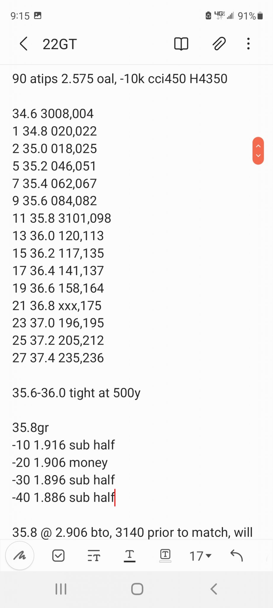

Here's my data, broke the rifle in with 100 rounds of 88eldm 34.5gr H4350. Then shot a ladder with 90 atips. 3085-3110 had like an inch of vert at 500y. Loades up at 3100fps 20k off lands was 3 shots touching at 300y. Prob easiest load development ever.

what the hell do those number reflect....what the hell does
1 34.8,020,022 mean????

lots of data but I have no idea what you are telling us....
