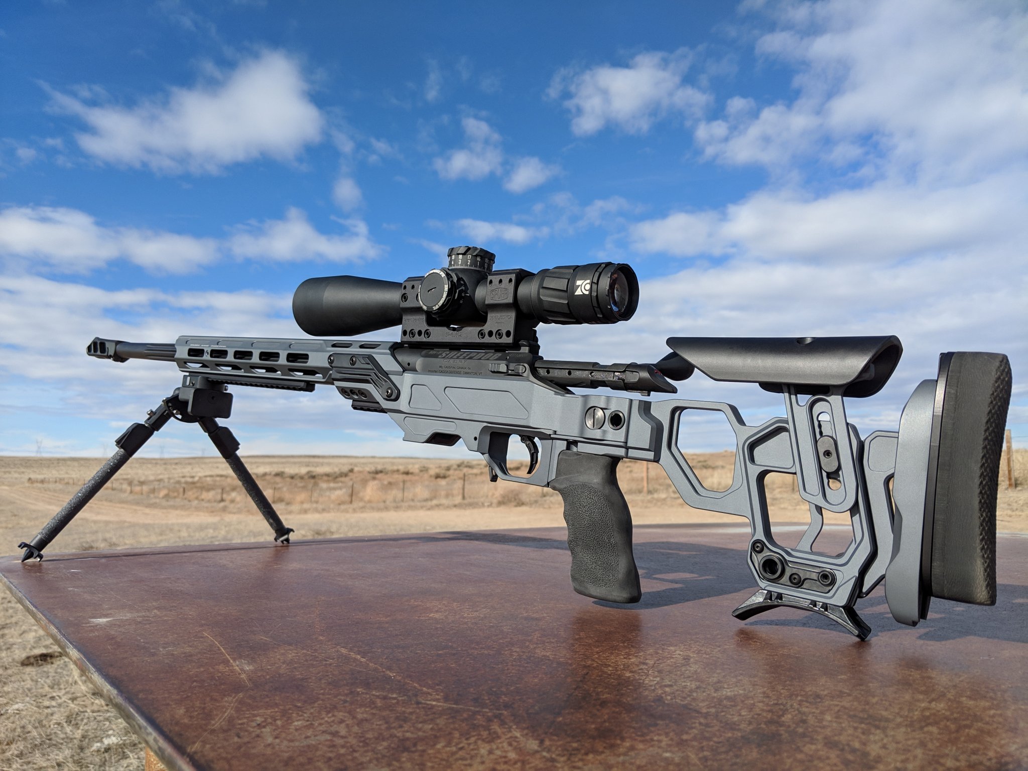

Mounted on a manners T2 if anyone is curious.

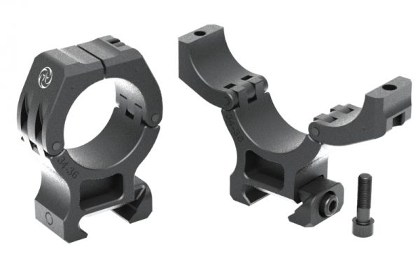

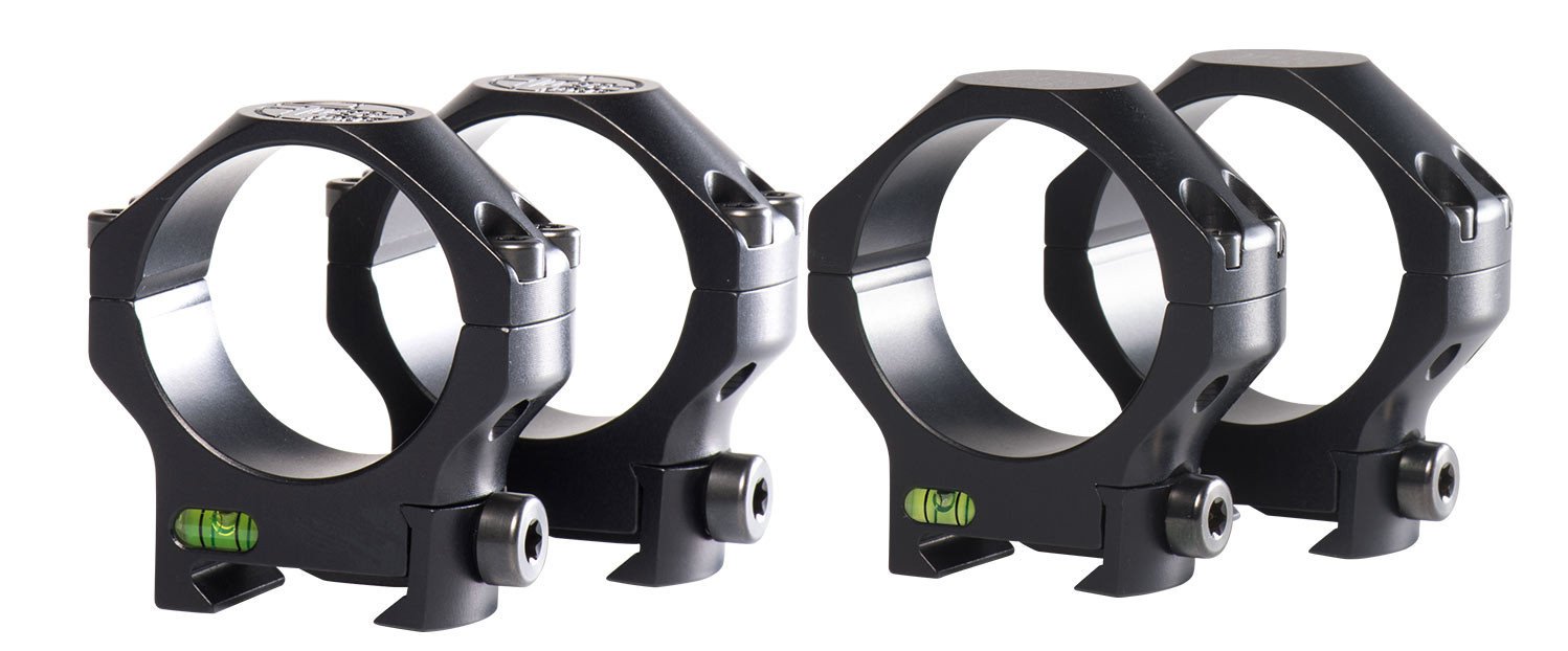

Sorry if I missed it, but besides Spuhr(?), who is making 36mm rings? I really like ARC m10's! Thanks
I haven't tried a "Tier One" mount yet nor have I tried the Era Tac, but hope to check these out soon.
Mounting options I am personally aware of and use that come in 36mm are MasterPiece Arms, Spuhr, and American Rifle Co., in no specific order. All of these options are very high quality.
MK Machining is making scope mounted bubble levels in 36mm for those that want a scope mounted level.
Another Tier One scope ring.
I bought the Spuhr however I’ve used the ARC rings and wouldn’t hesitate for a second to use them...
