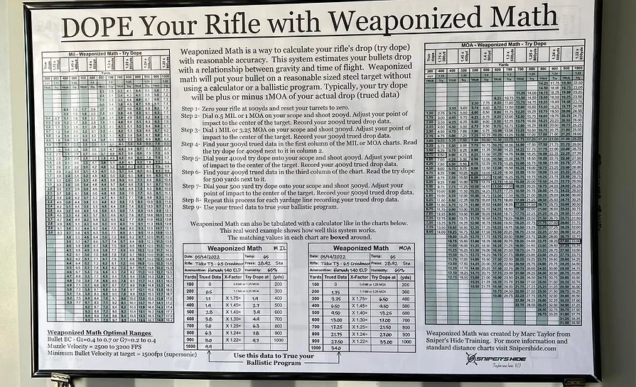

I will refer you to Marc Taylor’s Weaponized Math. This is the absolute best method to dope any rifle, from .22 to .50 cal with minimal effort. The chart listed is an entire ballistic calculator on a single page; think that about that a minute—an entire calculator in one image.
 There is no sight height, no bullet weight, and no muzzle velocity because Marc doped gravity, not a set of specific conditions. There is nothing to look at except for the last yard line. Gravity pulls a .22 the same as it does a 338, so having put a value to gravity gives us a more flexible and easier to manage tool. We deal with one factor, not several conflicting ones. We call the value assigned to the drop the X-Factor.
 The simplicity of weaponized math is, there is nothing to get wrong. We start at 100 yards zeroing the scope; we want point of aim, point of impact. Get your groups aligned to the rifle, so you have a concrete 100 yard zero. Once that is established, we can shoot from 200 to 1000 yards using our charts.

Frank, Marc and I put together a post of this system for your range or gun room.
Here is a link to purchase it - Weaponized Math Poster
24x36 poster
