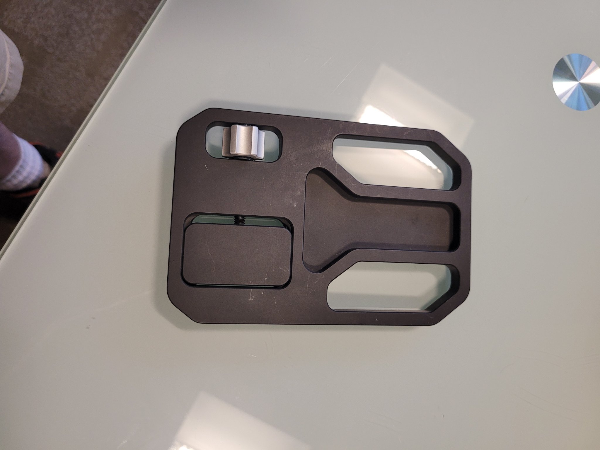

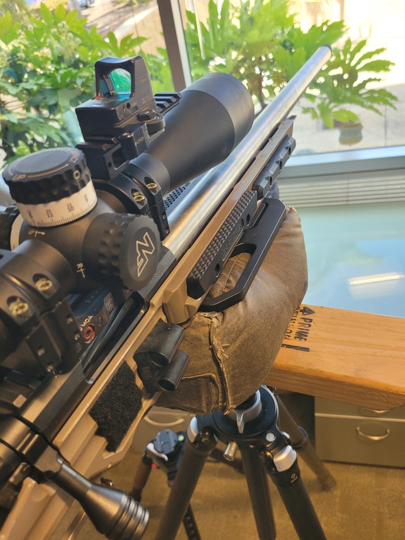

Accessories MDT ACC R700 S/A $650.00 SOLD
SOLD
Chassis only. $650.00 SOLD
This was on a spare Vudoo. I sold the B/A and dont have any need for this chassis.
was used in the field and at local matches for a year. Has normal wear as pictured.
MDT adjustable vertical grip available with chassis only for $40.00
