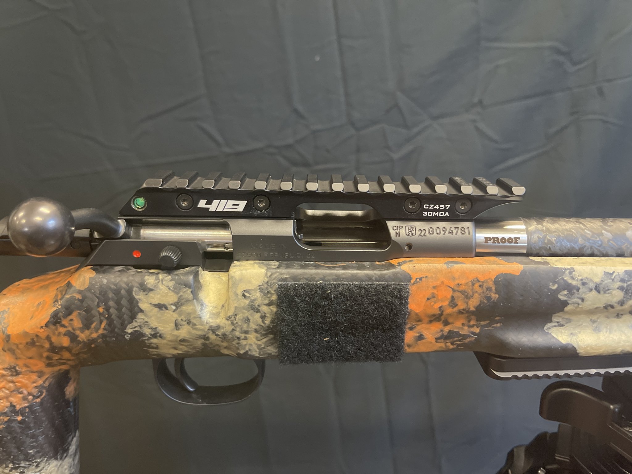

Firearms Proof research elevation. 6.5 CM custom rifle*motivated to sell*
Up for sale is my precision rifle. Has about 150-200 rounds through the barrel
Proof research 6.5 creedmoor barrel
Bighorn origin action
Krg X-ray chassis
Accuracy international 5 rd mag
Atlas bipod with adm mount
Area 419 hellfire brake
Arken epl4 6-24 MOA scope
Triggertech trigger
Asking $3000 cash
Trade $3200
Trades I’d be interested in are H&K sp5. Spear LT staccato c2 or cs
Will separate action and barrel for fair offer

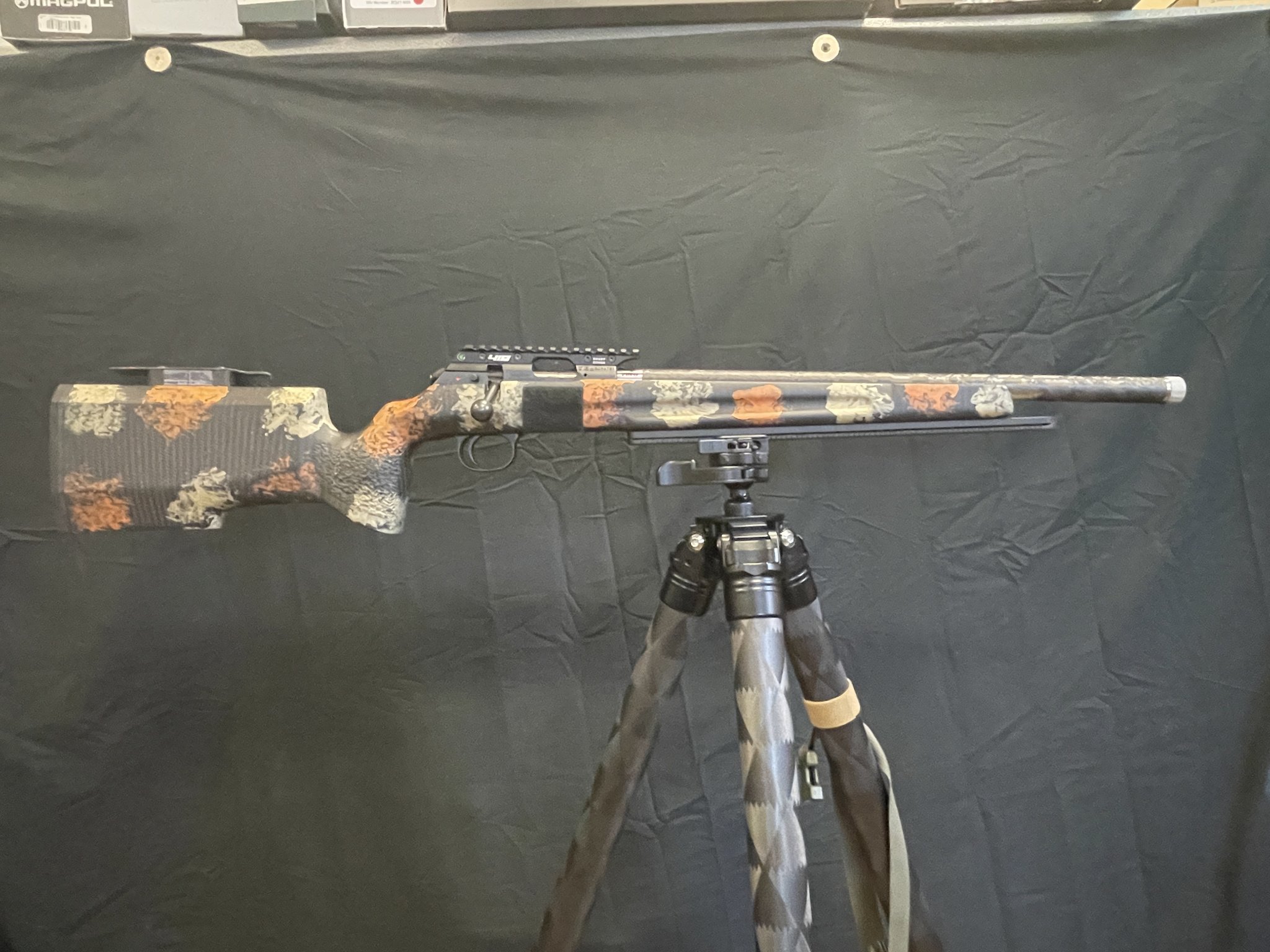

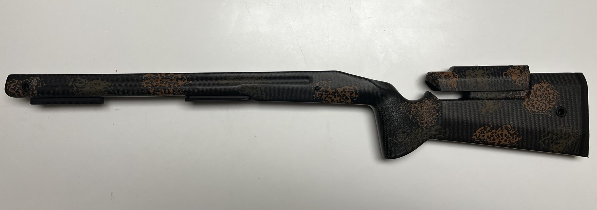

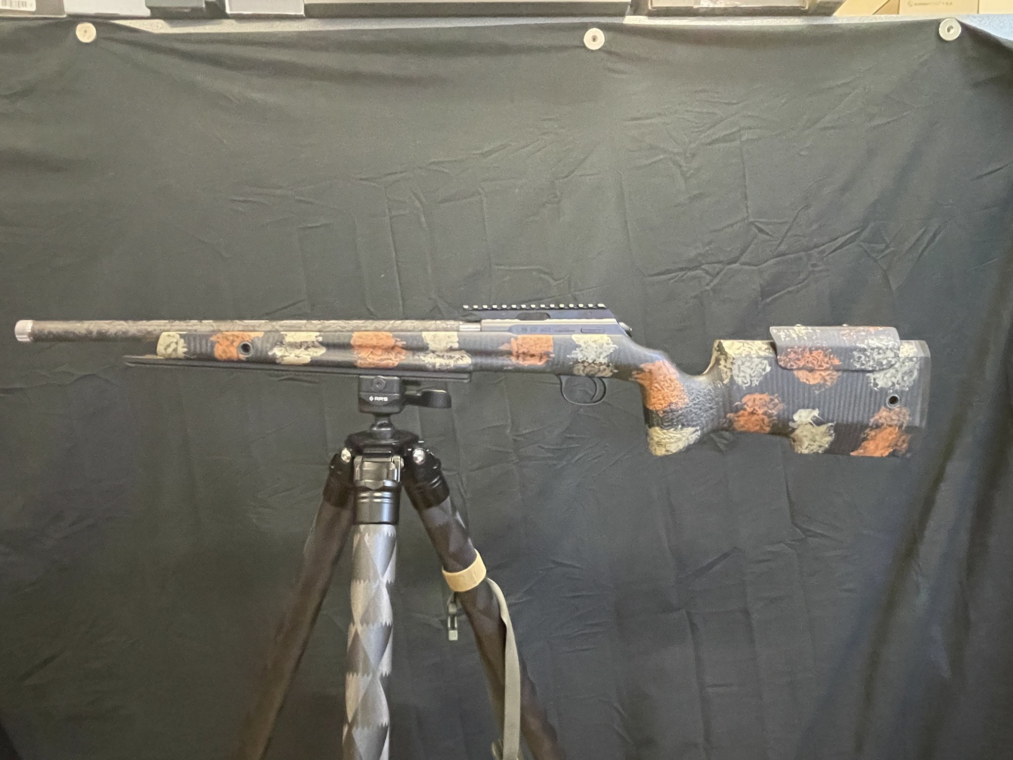

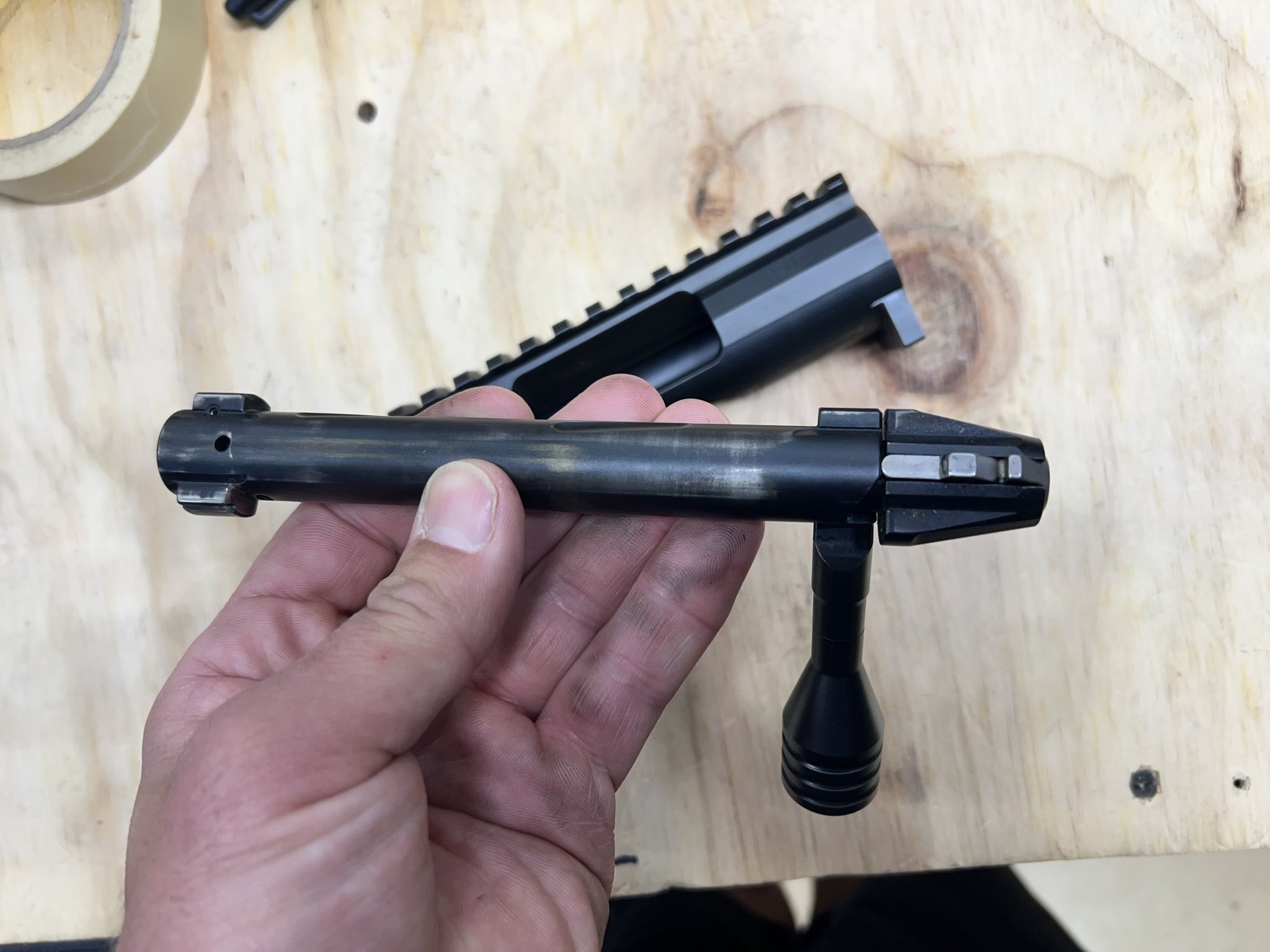

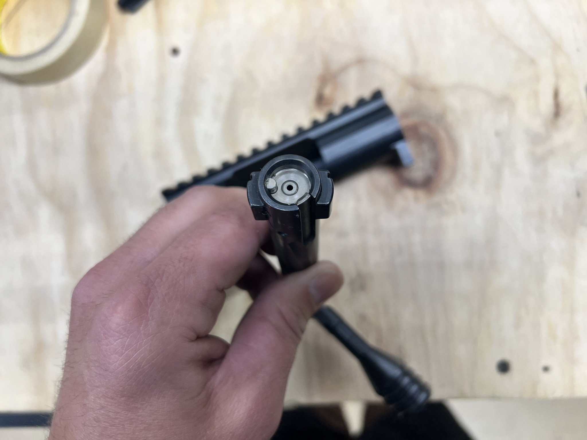

Firearms 6mm GT Rifle Complete with Components!
Guess I'll part it out... No problem....

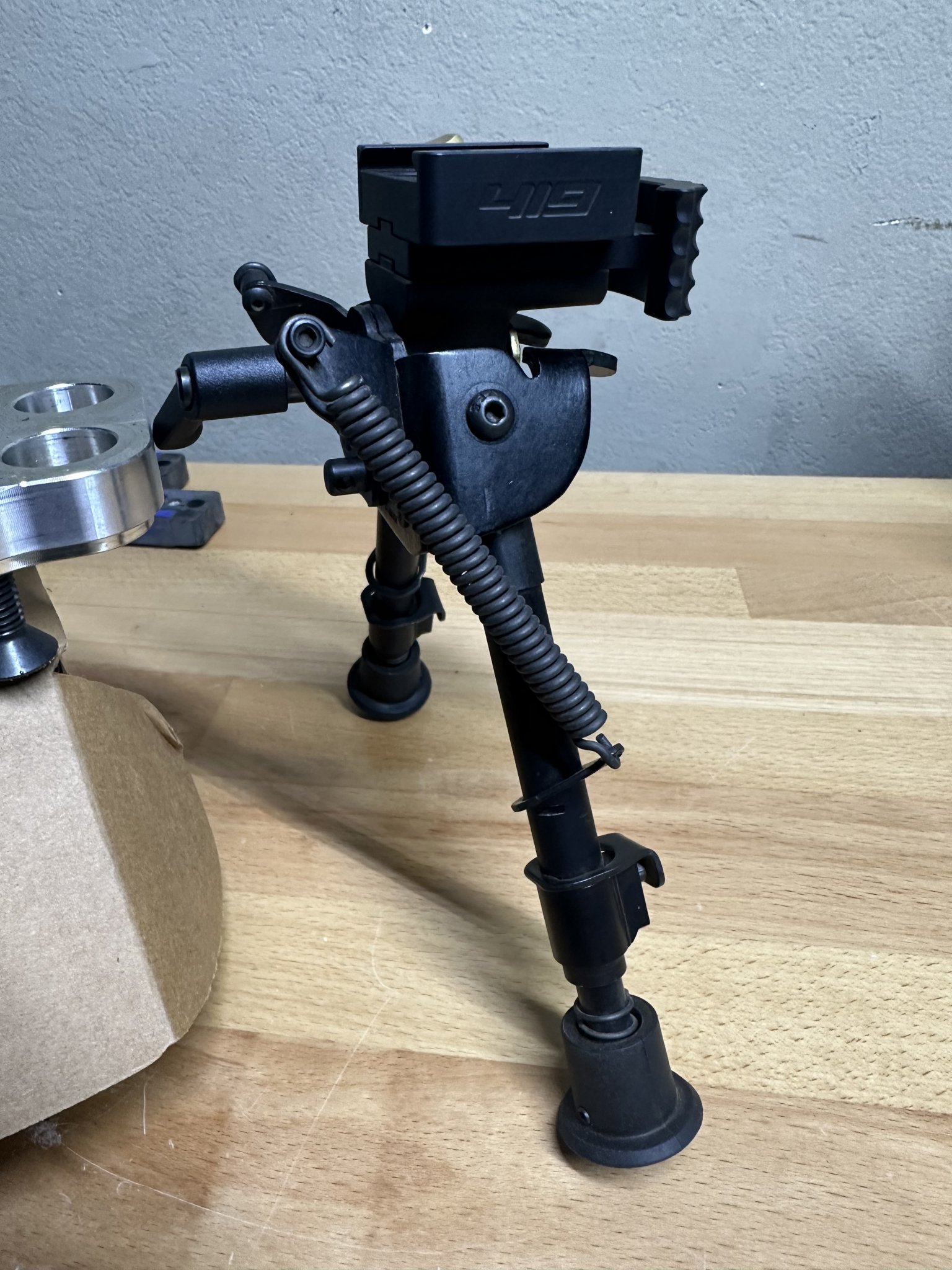

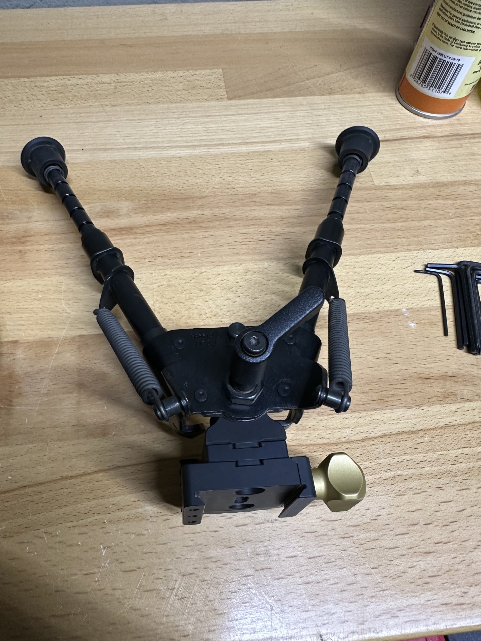

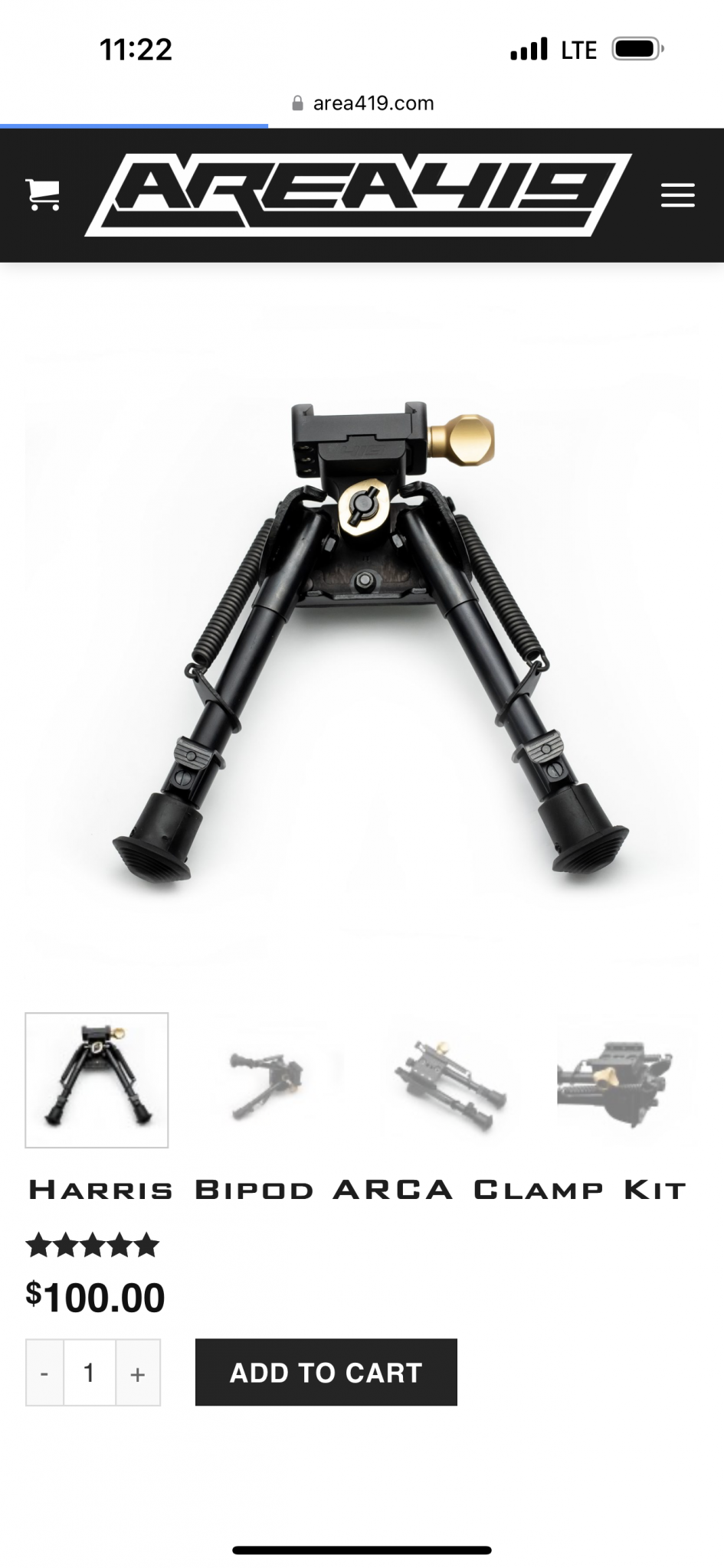

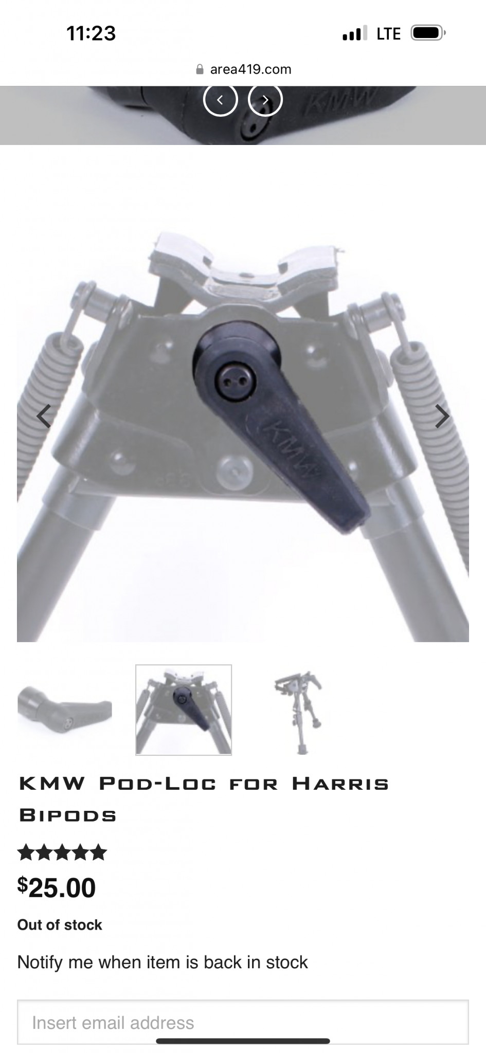

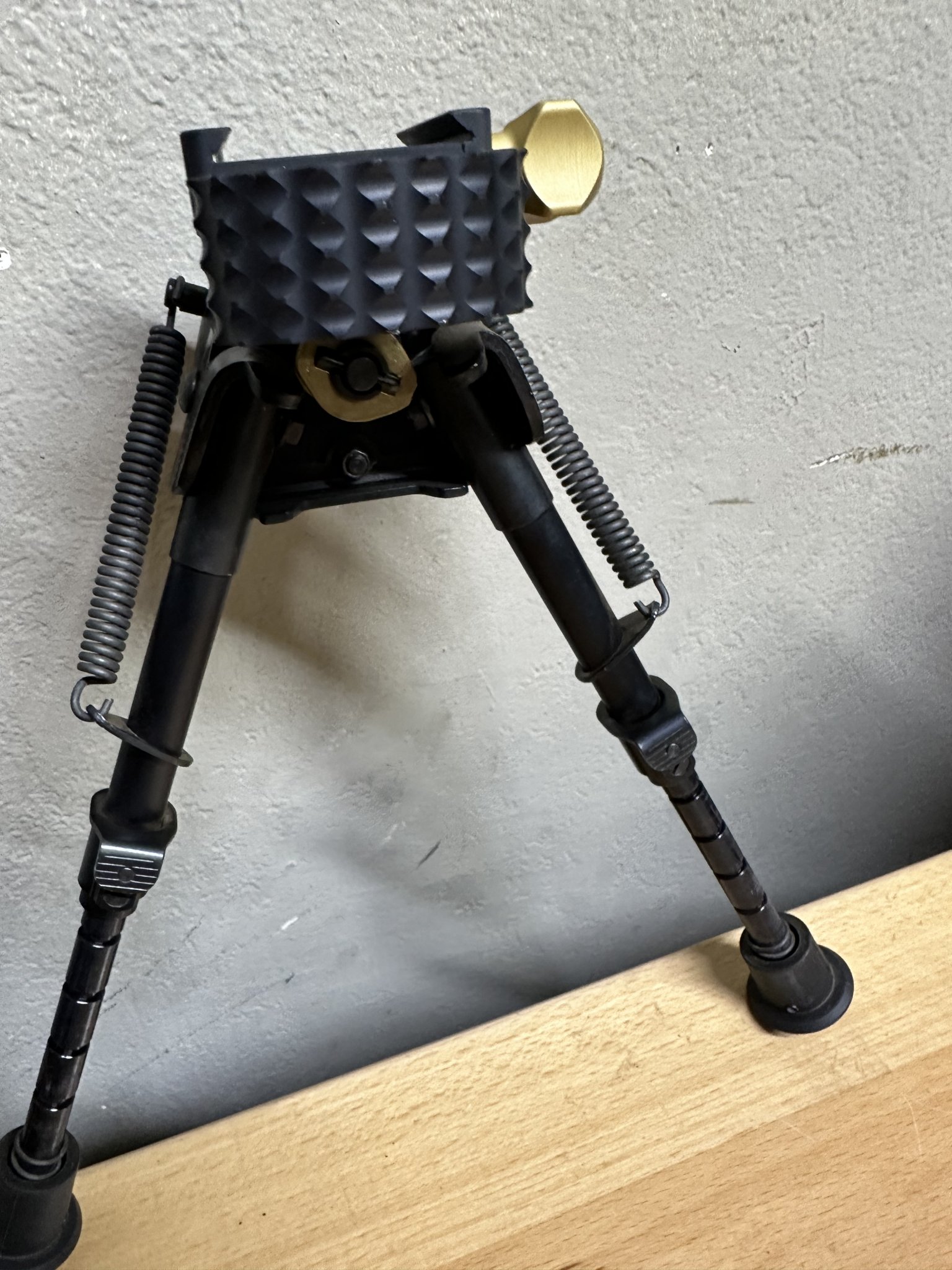

SOLD Harris bipod with 419 goodies
Harris bipod with area 419 arcs rail adapter and barricade stop
Quick throw lock lever would like $195
