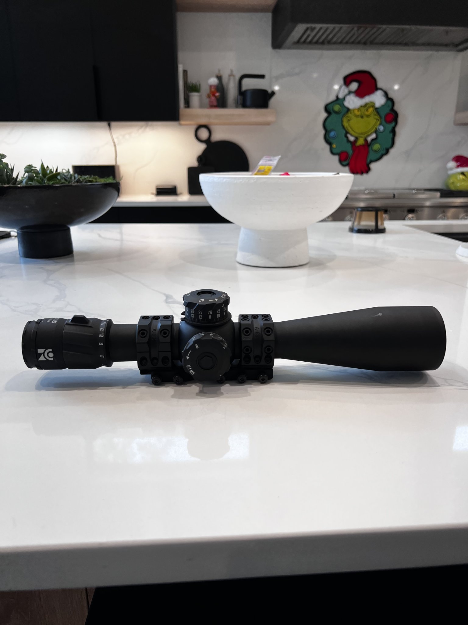

Optics Nightforce ATACR 5-25x56 f2 MIL-R mint condition
The scope is a Nightforce ATACR 5-25x56 f2 MIL-R and is less than a year old and in mint condition. I got it to get into long range shooting only to discover I'm really a hand gun guy. Expensive discovery a little too late. I also have a Wilson combat 6.5 Super Sniper with a 24" barrel for sale but this post is for the scope and mount. The mount is a Vortex cantilever. I paid $3,200 new and am asking $2,500 obo for the scope and mount.
