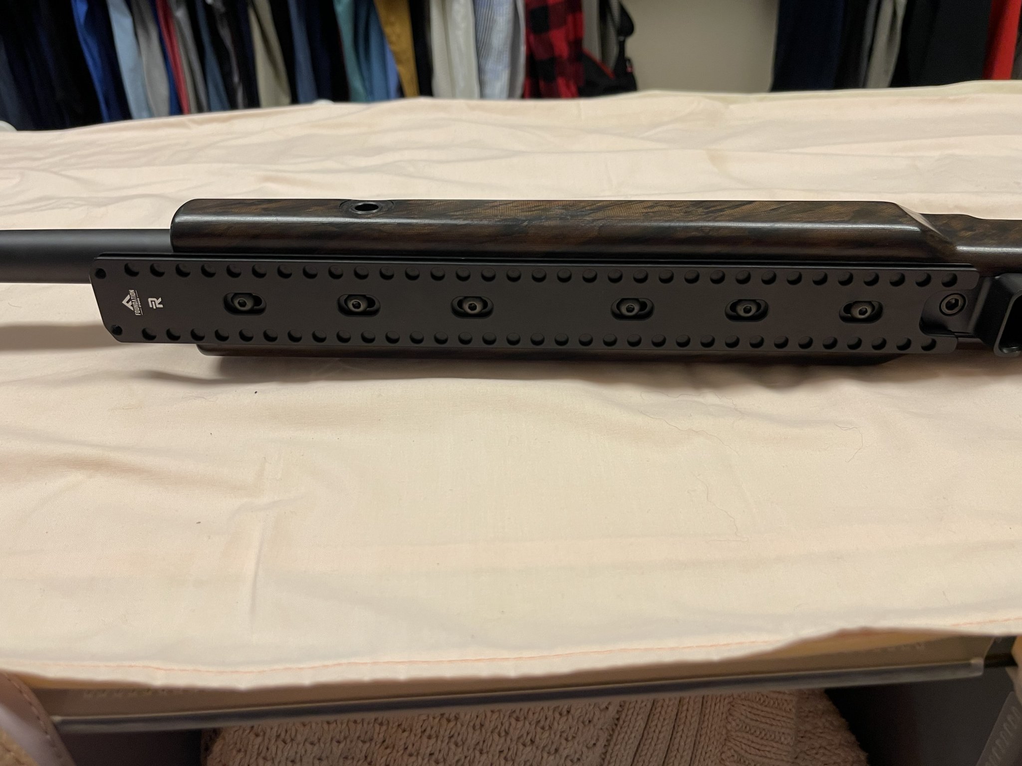

SOLD Vudoo G2 barreled action. 20” MTU. TRADE added
Vudoo G2 barreled action. 20” MTU. SPIRAL CUT AND CERAKOTED DONE BY AREA419. Approx 500 rounds on it. Pics for reference. Barreled action only. $1850 shipped with 2 mags. 1 small rub on bolt handle otherwise perfect condition. More pics upon request. TCS already traded
Will consider custom barreled action in new or excellent condition with 0 or low round count for trade. Interested in many different calibers
