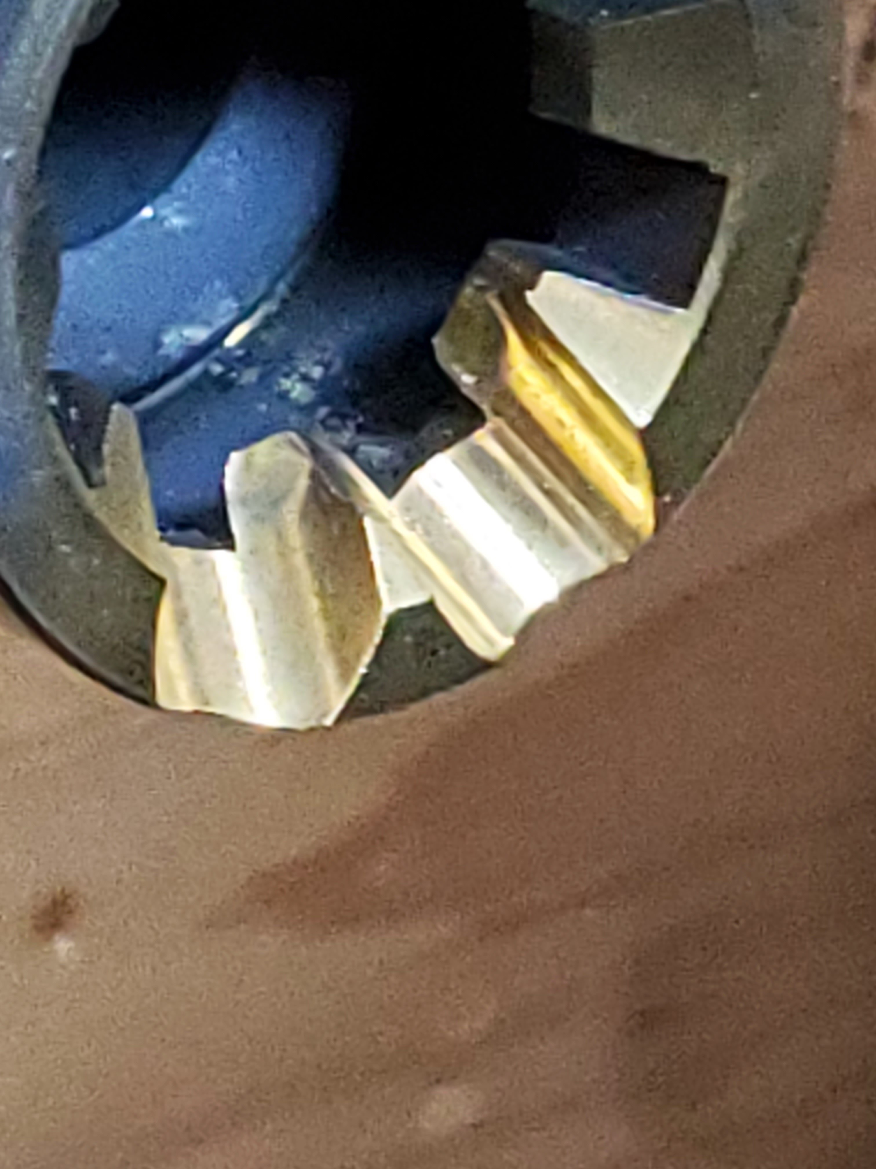

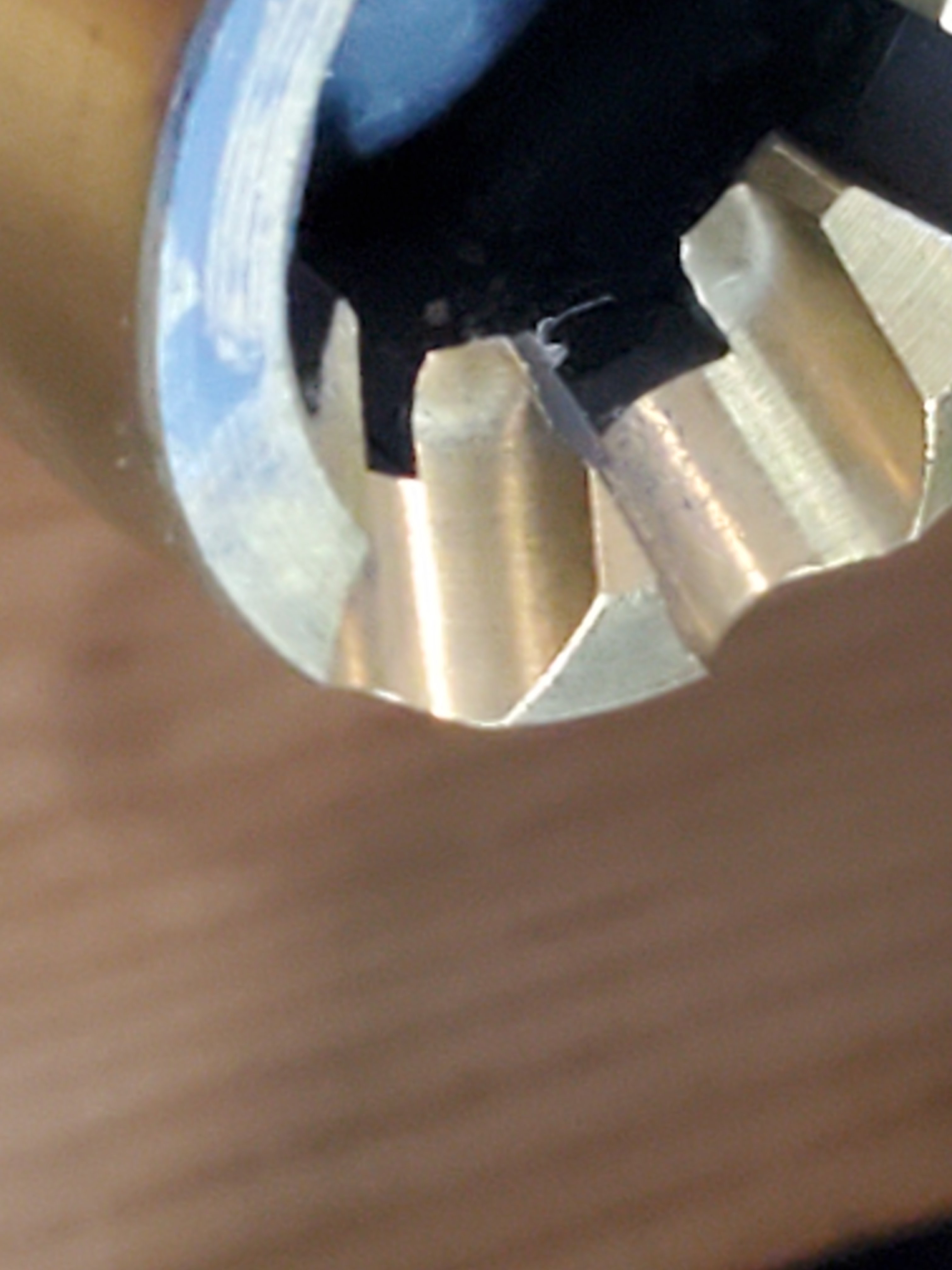

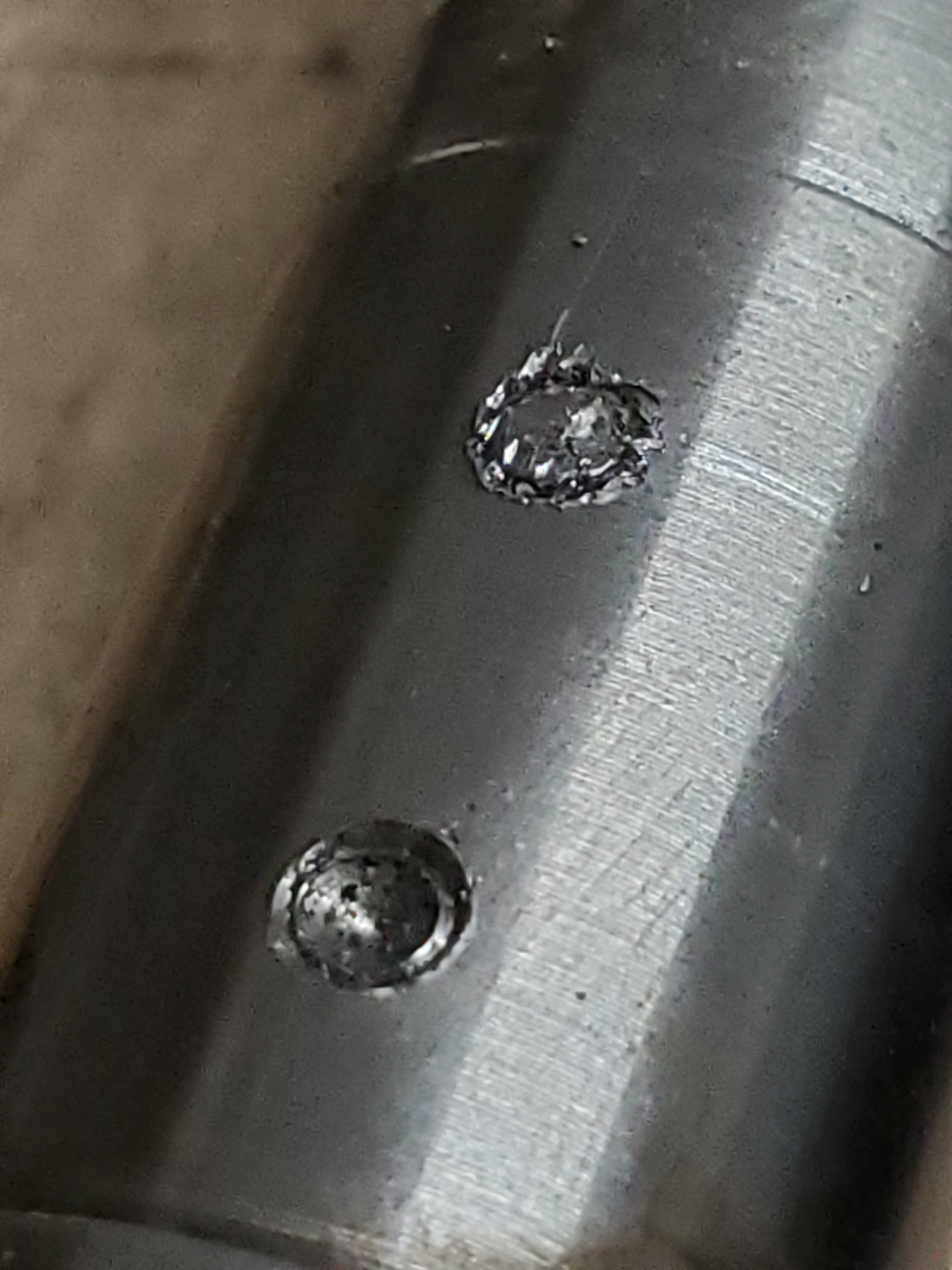

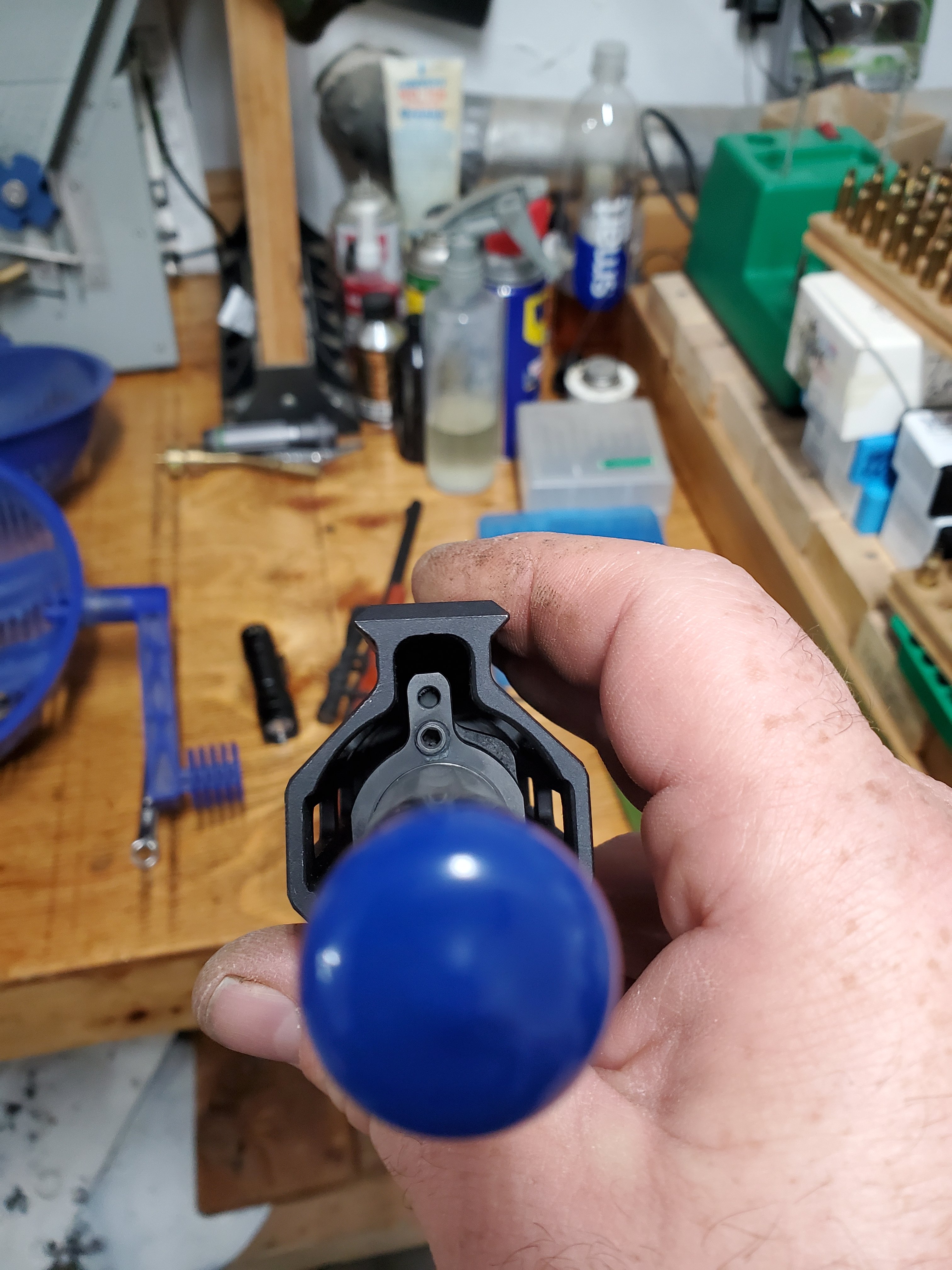

Help me diagnose popping primers
Pulled the barrel last night and took some pics of how deep the case is in the chamber. Also took some better pics of the blown cases.
Primers are not pierced, they're blown to pieces. The primer holes are hugely enlarged.
The load may be too hot, but on every shot fired that doesn't blow a primer, the brass and primer look great. Nice round edges on the primers, no signs of "ejector swipe" type marking of the case head. I know it doesn't have a spring loaded ejector, and I'm hoping you know what I mean. No obvious signs of pressure.
I only neck sized for the first few cycles. Switched to full length sizing just on general principals. The bolt was still closing easily on neck sized rounds. I don't think bumping the shoulder back farther is necessary unless I don't understand the concern. Remember, it's a bolt gun, not a gasser.
Here are the pics:

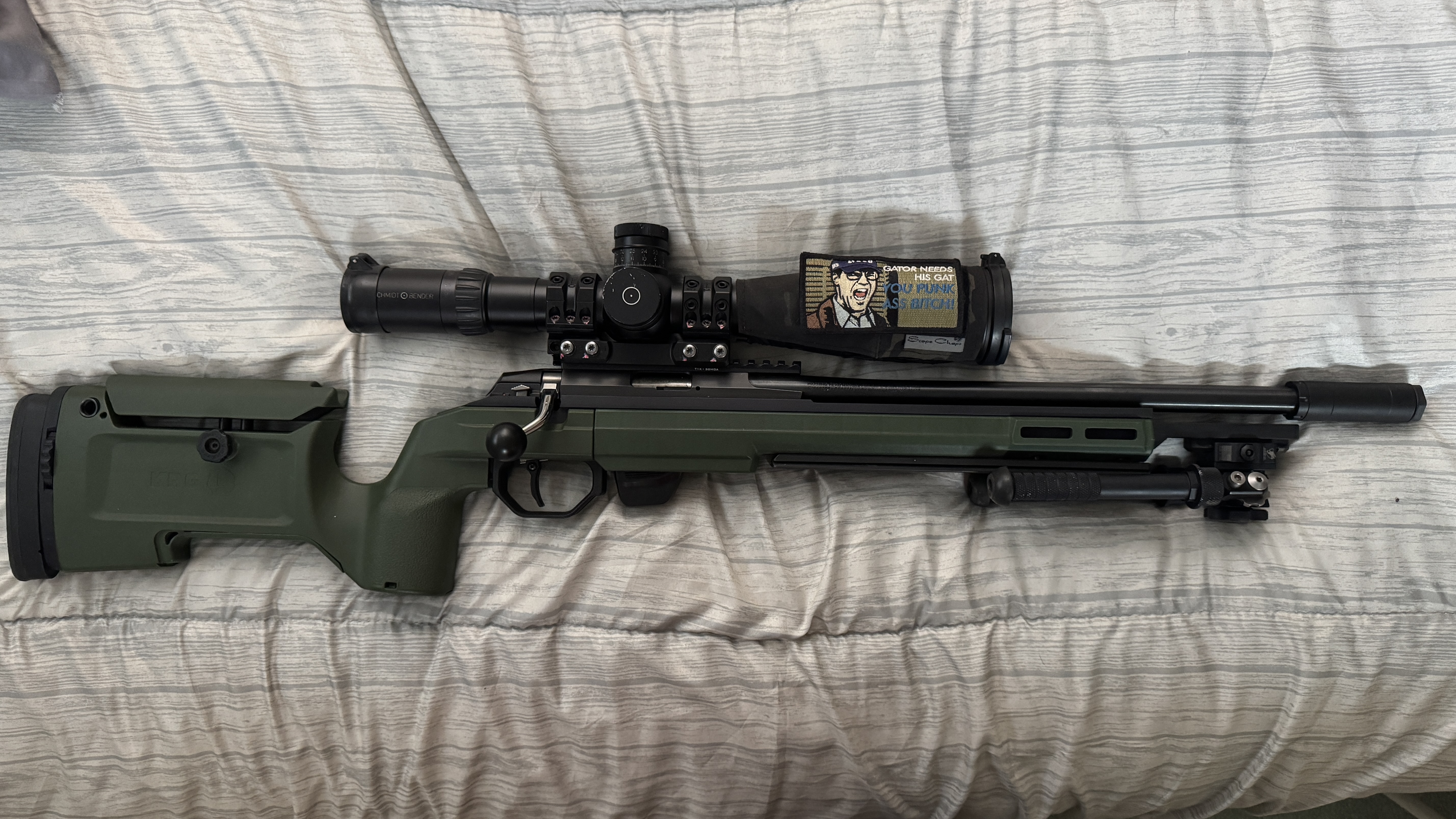

New to the site and new to long range shooting. I could not have imagined how fun and the extent of the learning involved. Here are my two recent purchases and in the mist of taking long distance training. I reached 1770 yards with the AR10 and had the MPA bolt action made this week to compare. Both are fun....
AR10
MPA
