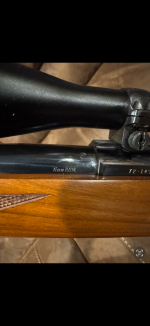

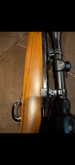

Having feeding issues with Hunter magazine running 7-08. 308 feeds fine from this mag but the 7-08 is a no go. The first round feeds but all the others are taking a sharp nose dive into the front of the mag. Contacted Hawkins and sent mags back for evaluation to have them say that they are within spec and found no issues but also told me they did not have 7-08 to test with. FWIW, AICS mags feed flawlessly. What you guys think? https://share.icloud.com/photos/06dRwPA89VX4gD8toIsfxWiSg

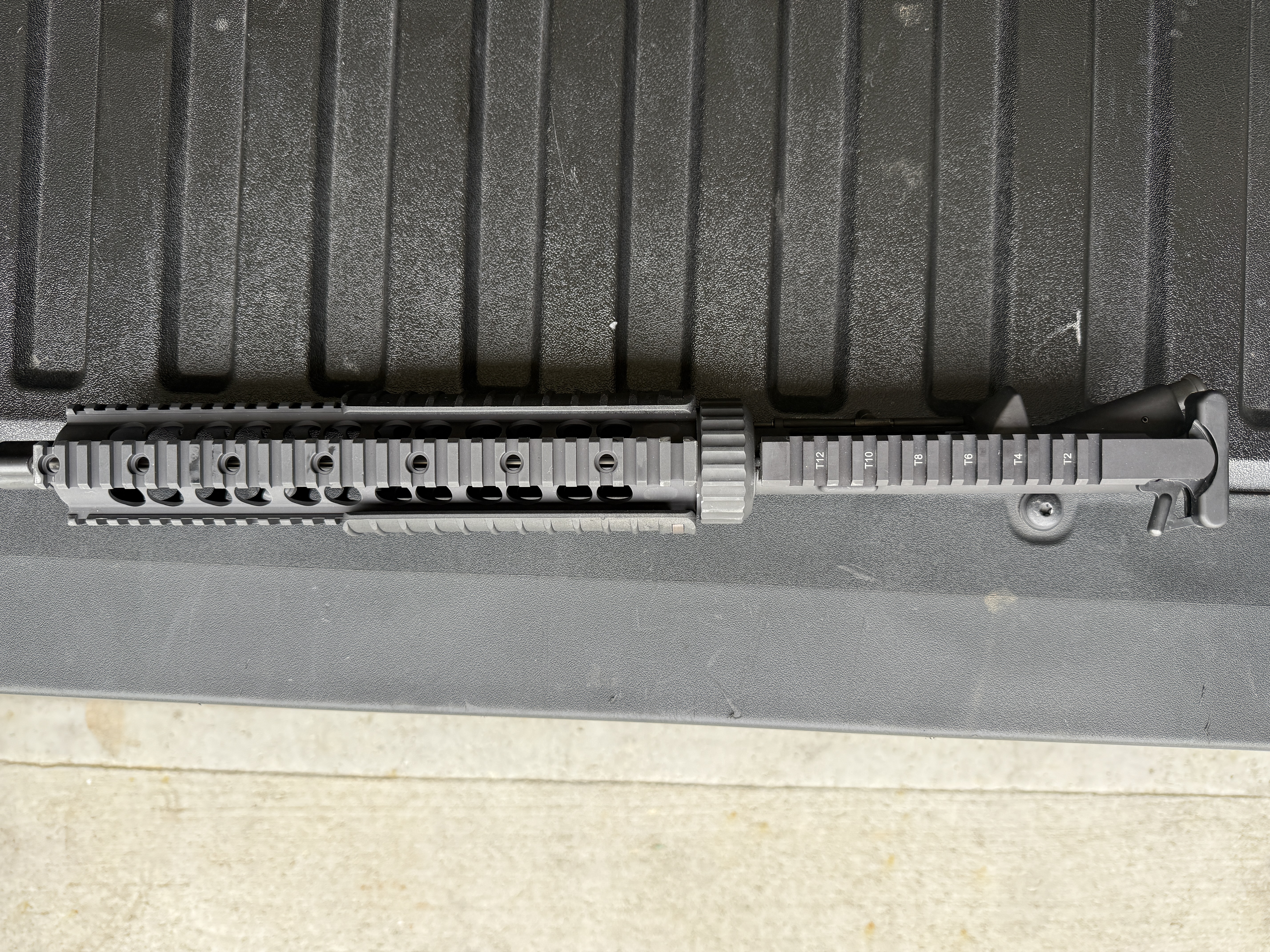

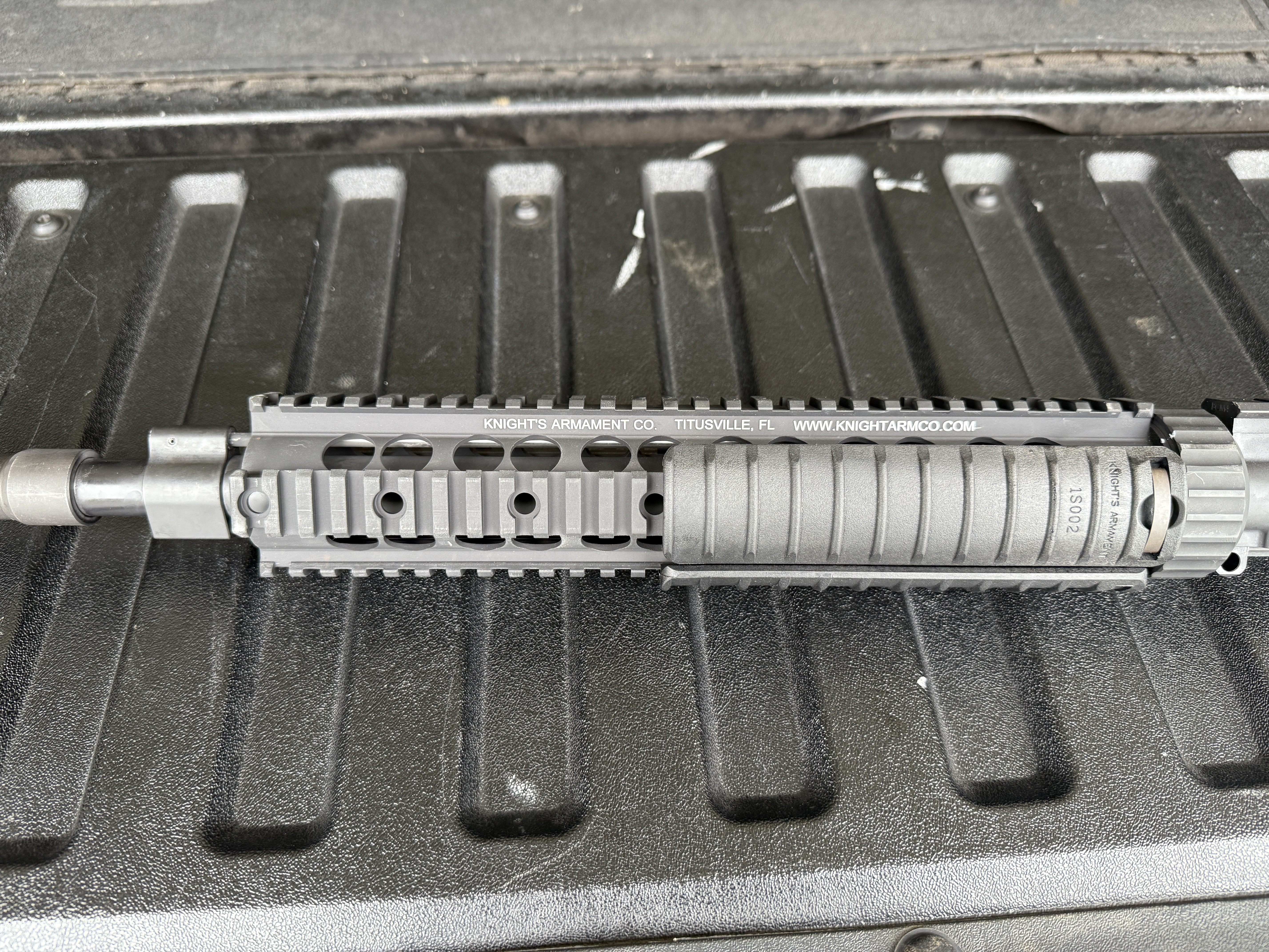

SOLD Mk12 Mod 1 complete upper
Used, about 600 rounds on the barrel. Some scratches on flat side of upper receiver. 100% malfunction free upper.
BCM blem upper receiver
BCM SS410 18" Mk12 barrel (rattle canned black)
KAC FF RAS long
BCM rifle gas tube
Badger Ordnance gas block
SOLGW BCG
PRI Gas Buster charging handle
AE brake and SPR collar
$1100 shipped CONUS
