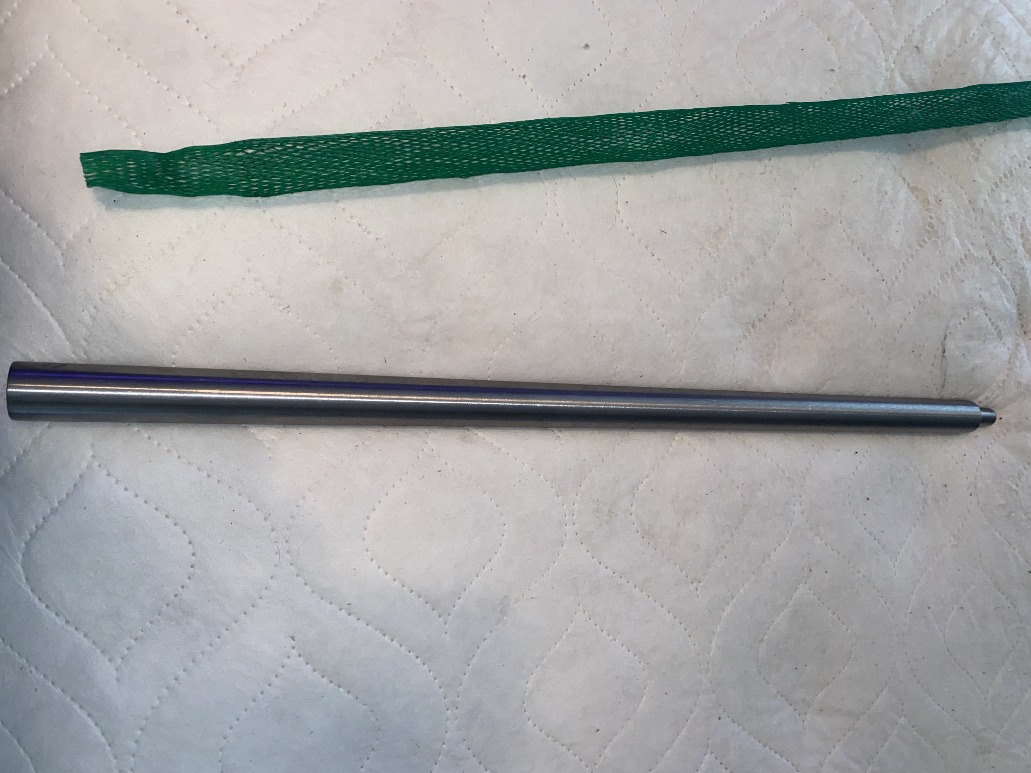

SOLD $400 - .260 REM Berger 140 gr Ammo & .260 REM AI Barrel
Selling 120 rounds of loaded Berger 140 gr. ammo and Accuracy International .260 Remington barrel.
Ammo / Brass
-120 rounds of 140 gr. Berger ammo
- 60 casing of once fired brass
-Lapua brass with LRP
Barrel
-Accuracy International AX/AT .260 Remington
-5R Bartlein barrel verified with Win Tactical
$400 shipped and insured for all.
Please PM if interested or if you have more questions. Happy to FaceTime for verification. Venmo preferred.
