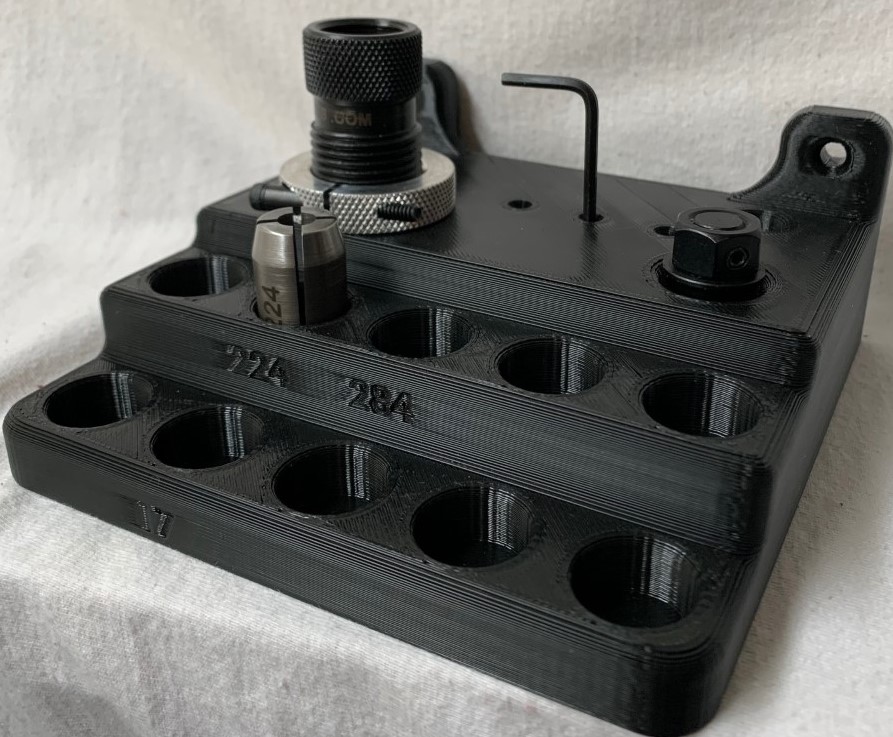

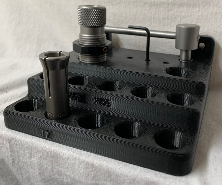

Reloading Equipment Bullet Puller Organizers
Please let me know if you have the RCBS cam (die type) bullet puller. The collets are a little smaller than others and I use a smaller hole diameter for those.
I printed these bullet puller organizers for a few people and they worked well. If anybody could use one PM me.
Red or black. If not specified I will ship what I have on hand. Can do custom colors on request but it might be a few dollars extra.
$20 TYD Inertia Style puller: Holds 6 of the collets and the handle. This works with all the most common inertia driven bullet pullers. Lyman, Frankford arsenal, RCBS and the knock offs of this type. This can just sit on top of the bench or be mounted to a wall via two #8 screws. To use the handle holder it needs to be mounted to a wall or side of bench as shown in the images.
$28 TYD Cam lock Style bullet puller: This will work with the most common die type bullet pullers such as Hornady, RCBS and Forester. This will hold 10 collets along with the dies and their respective components and allen key. I can add the custom labeling to the collet holder like in the image for $5 extra. You would have to include what you need them to say and in what order. Given the depth of the collet holder hole, most collets can still be identified with the factory stampings. This can just sit on top of the bench or be mounted to a wall via two #8 screws
$38 TYD Cam lock Style bullet puller with lid: This option will include a lid to cover the cam lock style pullers only. See image for how it sits on top. This can still be wall mounted or sit on the bench.
If you have any questions or other custom requests please let me know and we can figure it out. Thanks.

Reloading Equipment WTS: Hornady Comparator Rack (small and large set + more)
3/6/2022****** Update****** The covered models of the following will not be able to mount to the wall or sit on a shelf with the cover on:
$30 Small comparator set with cover
$40 Comparator full set with cover
$50Hornady comparator Large with cover
Updated with changes per requests!! Also have covers for the full set and large now if anybody wants one that previously got one without a cover. $15 for full set cover (old version) $20 for large cover (old version)
*please send me a PM if interested* Little rack worked out well. Decided if anyone could use one (PM me). Red Or Black. Rack only no inserts, not meant to confuse. If no color is specified I will ship what's on hand.
Added a few popular options to this lineup. Price is shipped TYD
Black Or Red

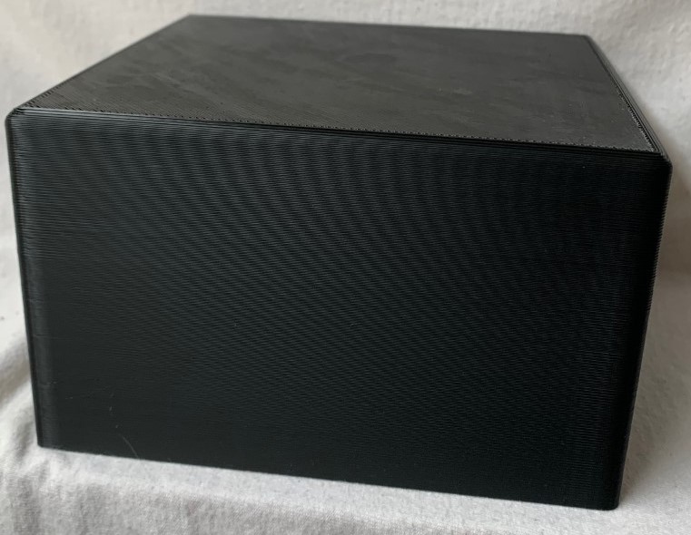

$18 Small comparator set: Organizer holds the basic hornady comparator set and required allen wrench plus a few extra holes. Can be sat on top of a shelf/bench or can be mounted to the wall via 2 #8 screws.
$30 Small comparator set with cover: Organizer holds the basic hornady comparator set and required allen wrench plus a few extra holes with a travel cover that is placed atop the container to keep items in place during transit. Cover can be placed on top or secured with a rubber band. This can be wall mounted or sat on a shelf.
$28 Comparator full set: Holds the full set of or hornady comparators plus a few extra holes and required allen wrench. Can be sat on top of a shelf/bench or can be mounted to the wall via 2 #8 screws.
$40 Comparator full set with cover: Holds the full set of or hornady comparators plus a few extra holes and required allen wrench. Comes with a travel cover that is placed atop the container to keep items in place during transit. Cover can be placed on top or secured with a rubber band. This can be wall mounted or sat on a shelf.
$35 Comparator full set with shellholders: Holds the full set of or hornady comparators plus 8 shell holders and required allen wrench. Can be sat on top of a shelf/bench or can be mounted to the wall via 2 #8 screws. No cover option currently for this model.
$ 33Hornady comparator large: Organizer holds the basic hornady comparator set and required allen wrench plus a few extra holes. There are three 1" diameter holes for case gauges or weights, etc... This also holds shell holders along the front. Can be sat on top of a bench/shelf or attached to the wall via 2 #8 screws.
$50Hornady comparator Large with cover:Organizer holds the basic hornady comparator set and required allen wrench plus a few extra holes. There are three 1" diameter holes for case gauges or weights, etc... This also holds shell holders along the front. Comes with a travel cover that is placed atop the container to keep items in place during transit. Cover can be placed on top or secured with a rubber band. This can be wall mounted or sat on a shelf.
The holes for the bullet comparators can be used for shell holders and vice versa if so desired on the large model.
If anybody has any questions let me know. If you would like other customization send me a PM and we can probably make it happen.
Other items people have requested:
