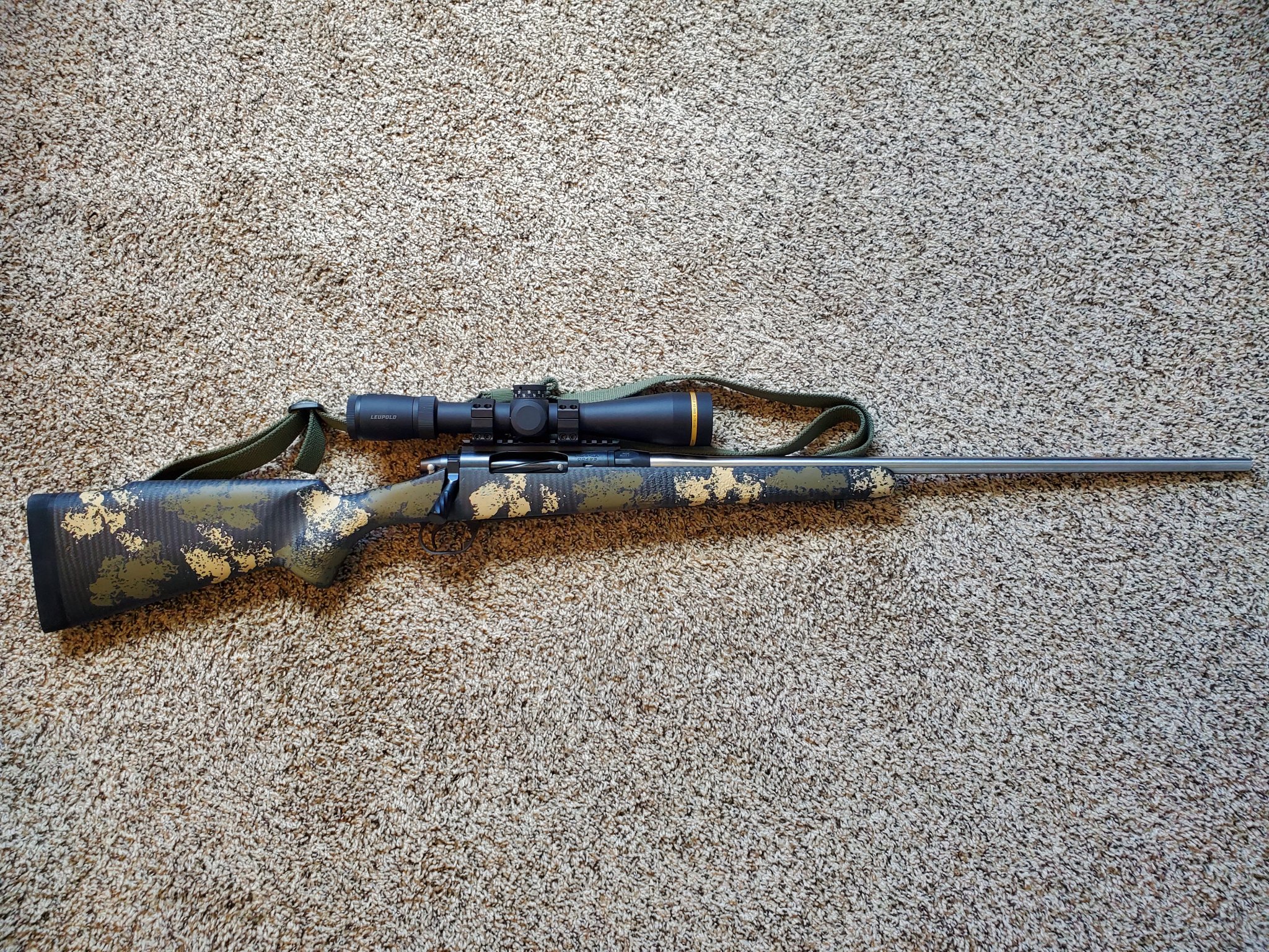

I'd second the big horn origin with a prefit mentioned above, but they're only in short action. Here's my build with similar goals below, give or take:
Big Horn Origin $825
PVA #2 prefit $450
Manners EH6 $535
Wyatt's mag w. action modification $130
Hawkins BDL $125
Geiselle trigger $200
Headspace gauges $70
$2,335.00 (give or take with sales, etc)
Whole thing weighs in at 8.125 lbs with a Leupold VX-5HD in seekins low 30mm rings on top. Gun without optics is around 6.6875 lbs. So, yes. You can definitely piece together a custom in your price range and make weight. Bonus of being able to swap calibers or rebarrel right in your basement.
If you're set on 280AI (as I originally was), you'll have to swap out for a different action. Some good options around the $1,000 mark, take your pick. In the end I wanted to have the same action across 2 guns and the origin was right for the price. Factor in some savings on not having the action opened up for the extended magazine depending on your action/caliber selection and if you reload or not. $80, in my case.
