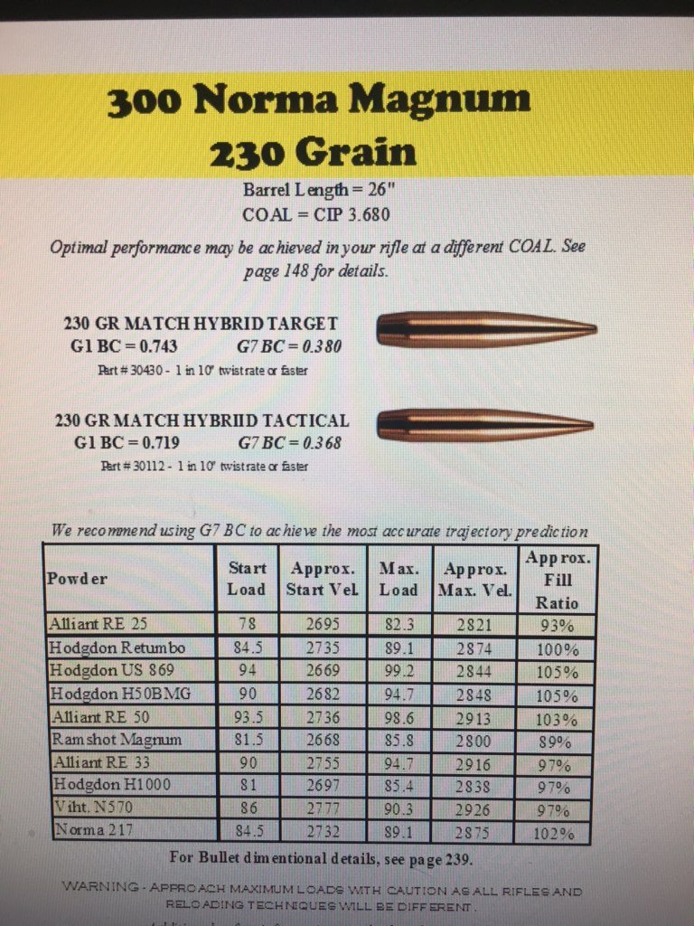

I’ve already got all the components I listed above so I’m just going to run with it. I found the following data so I’ll probably use this (even though it’s a different bullet it’s at least the same weight), work myself up slowly to find max charge, then work up to that charge in small increments to find the OCW.
Have you done any loads yet? I’m really excited about the 230 SMK.
With my 28” running 230 smk Norma brass and H1000 I started at 81 and it was too hot to continue at 82.0 so I would be careful there. I think that load sheet you posted is known to be very hot if it’s the same one in the reloading depot. I switched to retumbo getting better velocity and accuracy.
Have you done any loads yet? I’m really excited about the 230 SMK.View attachment 6998056
I looked at many responses and found many people shooting this Bullet and the 225gr Hornady with 92.6gr. I started with it tried up and down a couple tenths and had good luck. When my bbl broke in the pressures got too high and I am going to try 88grs today.

Is that with H1000? If so, that is completely different than what @Gilly what experiencing. Now I’m even more confused.

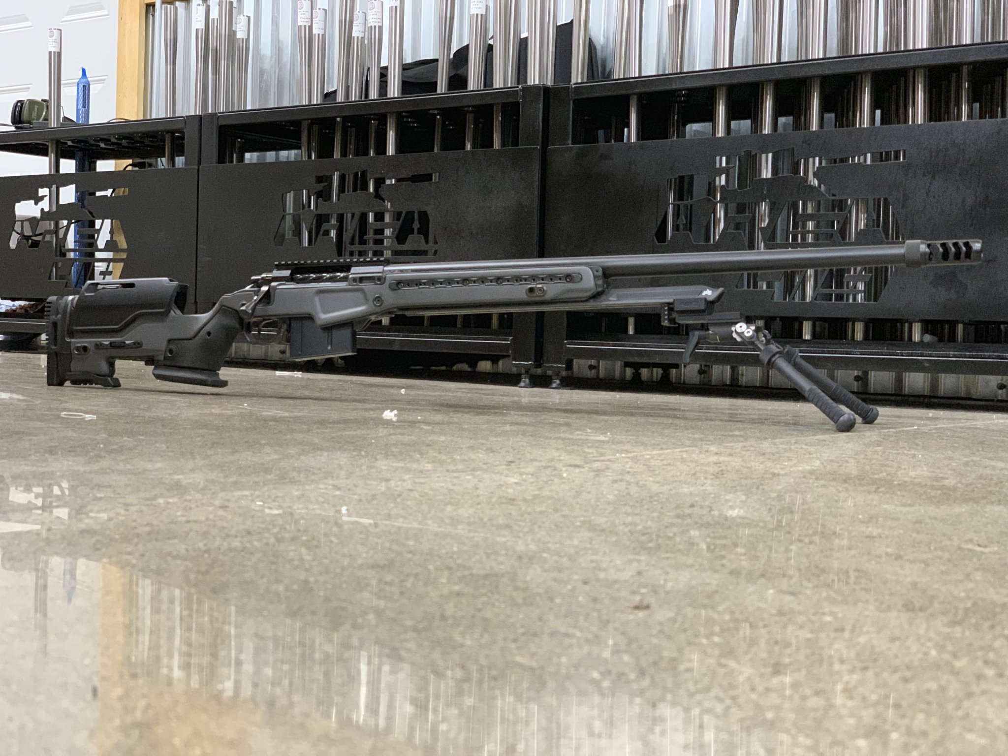

I’m running a custom build. Gets here in a couple days.

I would imagine 92.6 would be Rl33 or N570 as you’d be way over pressure with H1000. I’ve seen H1000 loads to 84 or so and similar velocity to my 82 so I do believe there is some lot to lot variability there. 83.7 retumbo is my current load and just seeing early pressure signs on warmer days.
