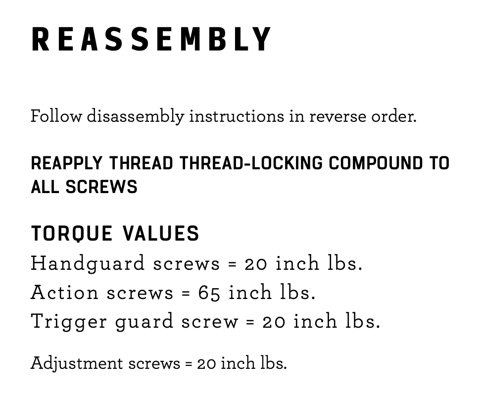

I just pulled it completely apart and disassembled the whole chassis. I cleaned all the gunk out of it (surprising on a new gun to have rusty-colored thick gunk all inside it), and properly retorqued everything to spec. The front action screw seemed to be installed lighter than 65 in-lbs. So, hopefully that will fix it. We'll give it a try next weekend.
JIC anyone else is wondering what torque specs are for the Christensen Arms MPR chassis, here you go... Straight out of the manual.

It's actually a pretty ingenious design... I like how it assembles and disassembles. I might get a couple for some of my other non-CA rifles. It's ridiculously strong and lightweight. 🤔

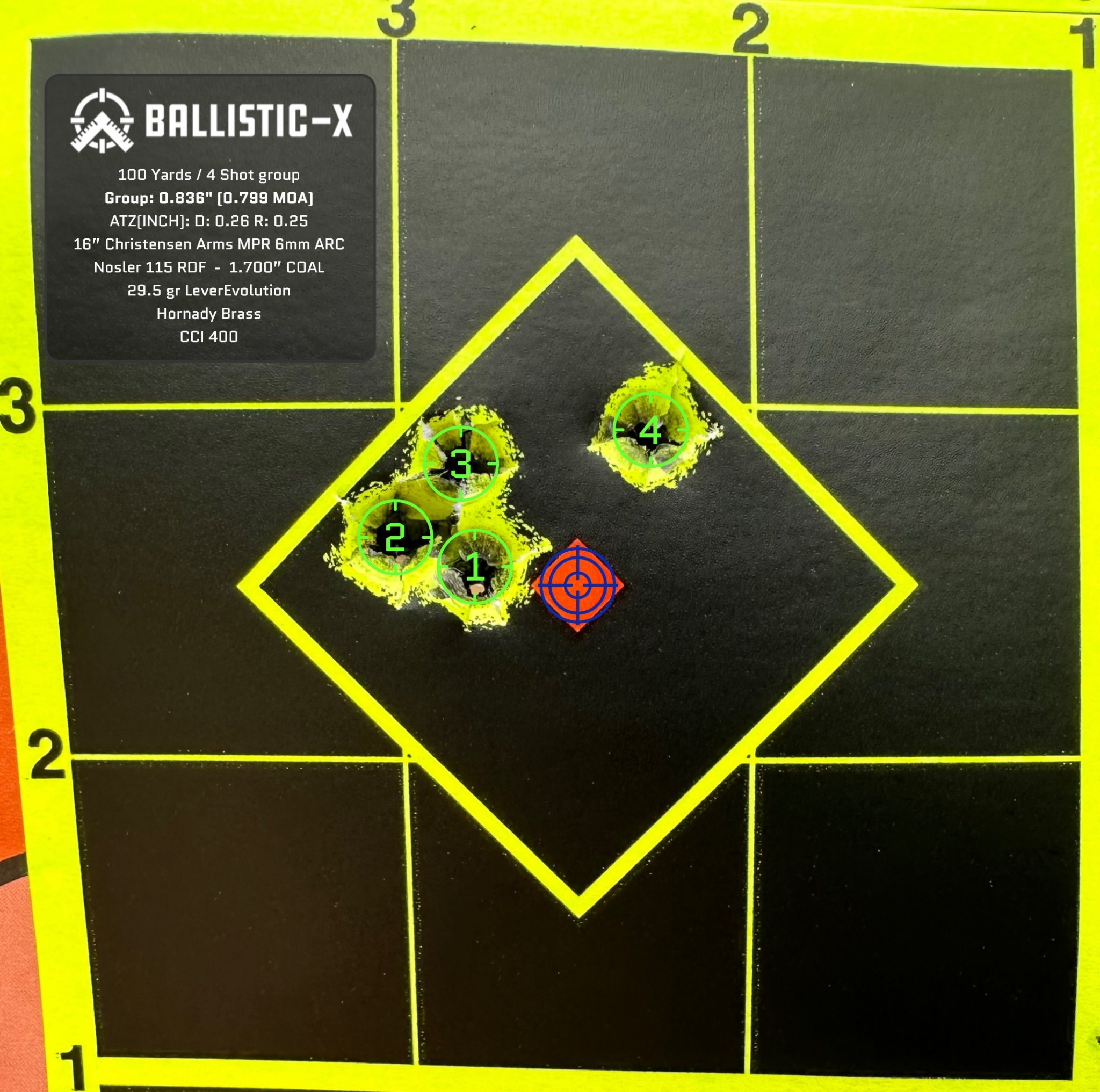

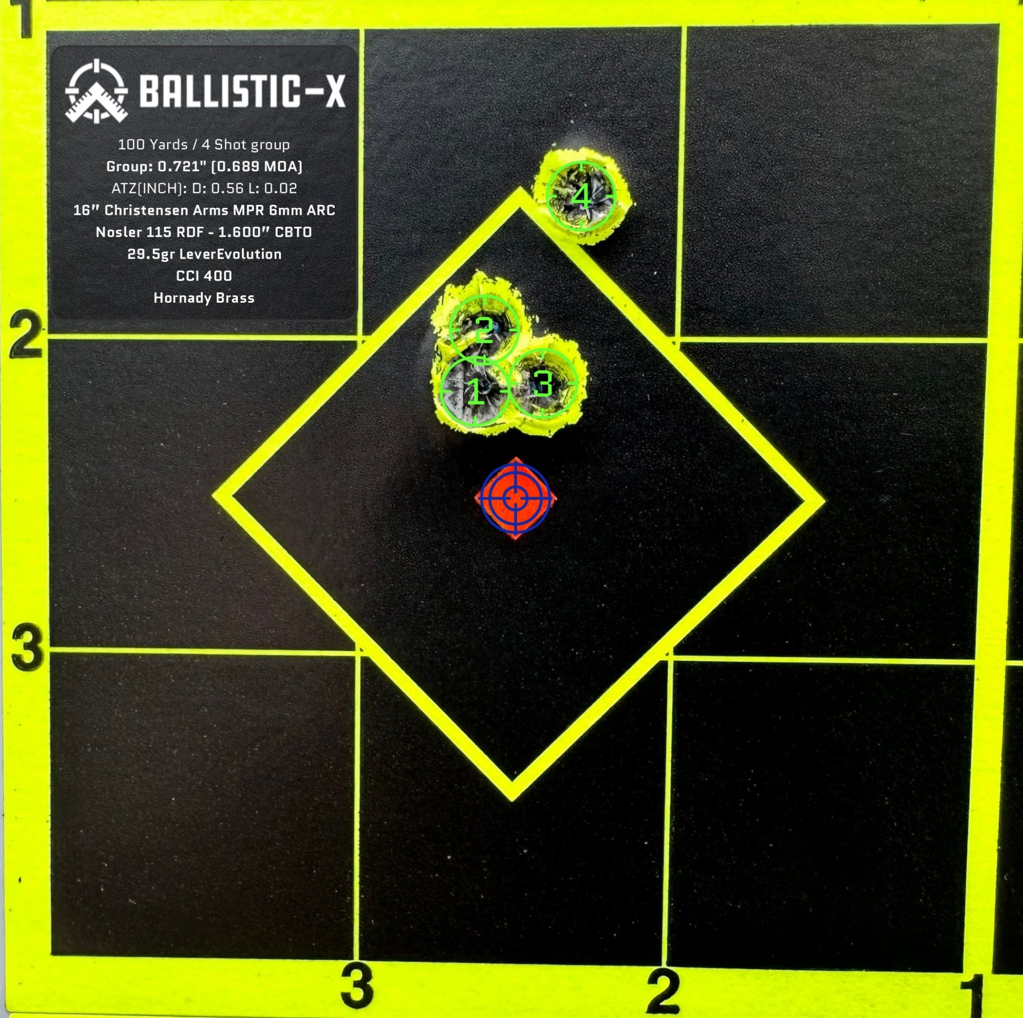

Well... Went to the range today. I decided to test things and shoot suppressed, since the suppressor has never interfered with my load development before on any other rifles... So, after re-torquing all the action screws to 65 in-lbs. it did seem to help somewhat. I think I found a good node that was similar to one I found before. It would have been an amazing 5-shot group, if I hadn't fucked up the 4th shot, and pulled it... The flier was my fault. I'll claim it. So, we'll continue testing this load in the future. This will be my baseline. Testing it today was good, because it was hot at balls, and sweating like a MF'er out there. So, as long as it's good above 90ºF, it should definitely be safe at lower temps...As long as it stays together and consistent at lower temps. We'll see this fall/winter. 👍🏼
I counted the 5th shot, but excluded it from the group size, luckily you can do that in Ballistic-X software. Handy feature to have. So, I decided to just go ahead and block it off with a black dot on the edit. 👍🏼
Ballistic-X-Export-2023-05-21 17:59:48.110676.jpeg
Here was another ok group from today. Not great, but I’ll take 3/4” over 0.8xx + any day of the week. Also, it shows there’s a node around 29.0 to 29.5 gr. of Lever with this load. Because I’m my other tests, I was getting similar results between 28.5-29.5.

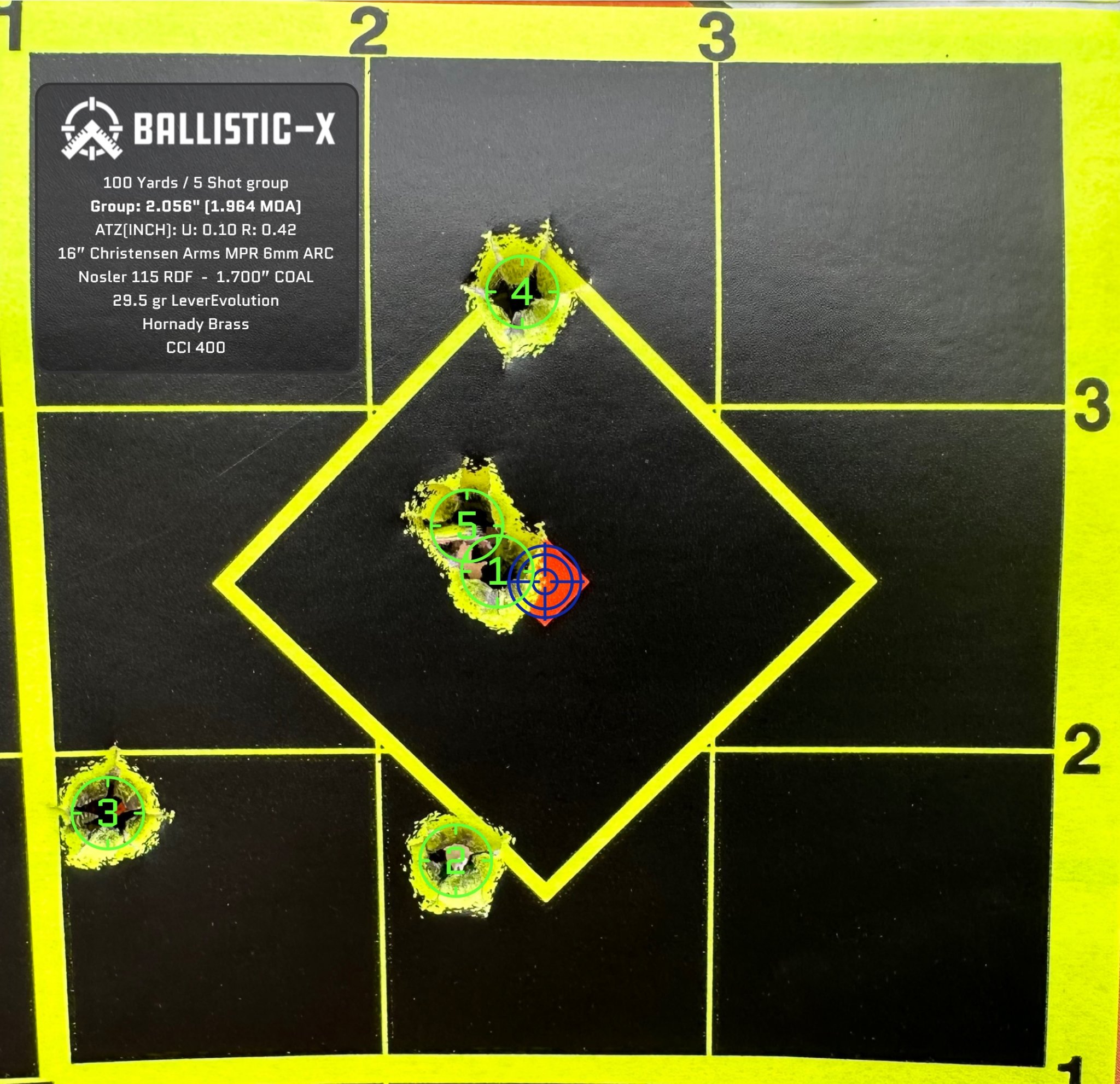

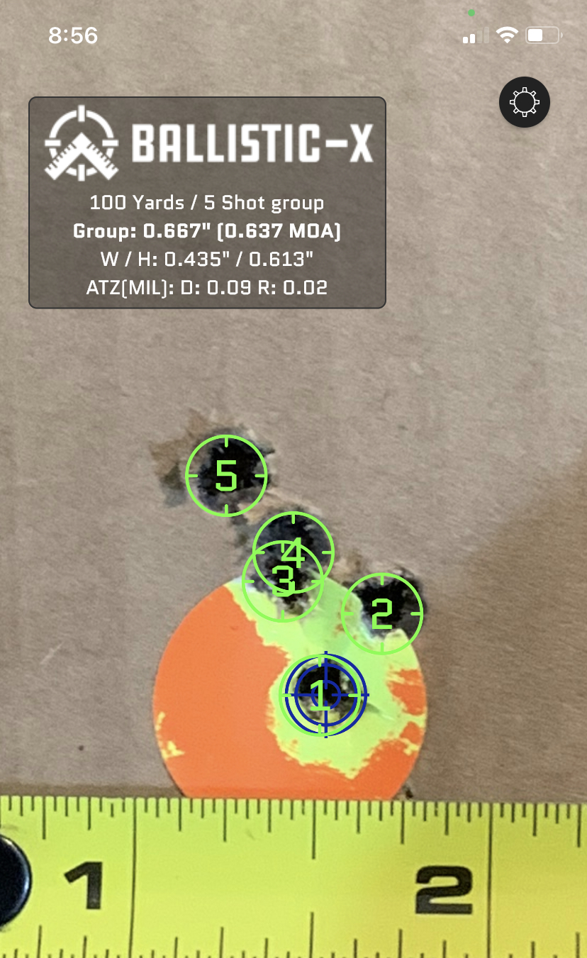

I’m about done with this fucking rifle… It always shoots 1 good group (1st group of each session), then immediately goes to shit… Could it be the scope having some internal issues?
Group 1 (with & without the shot I pulled because the bag shifted right as I shot)…

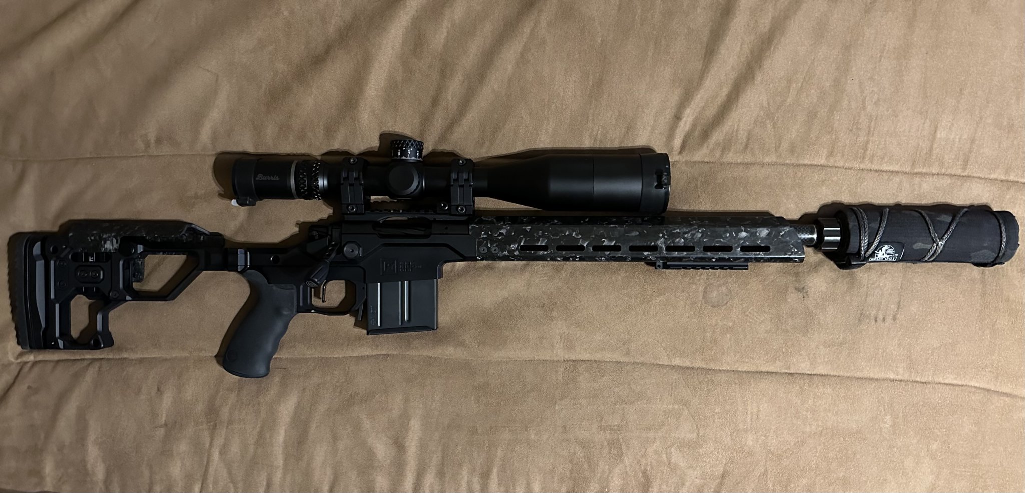

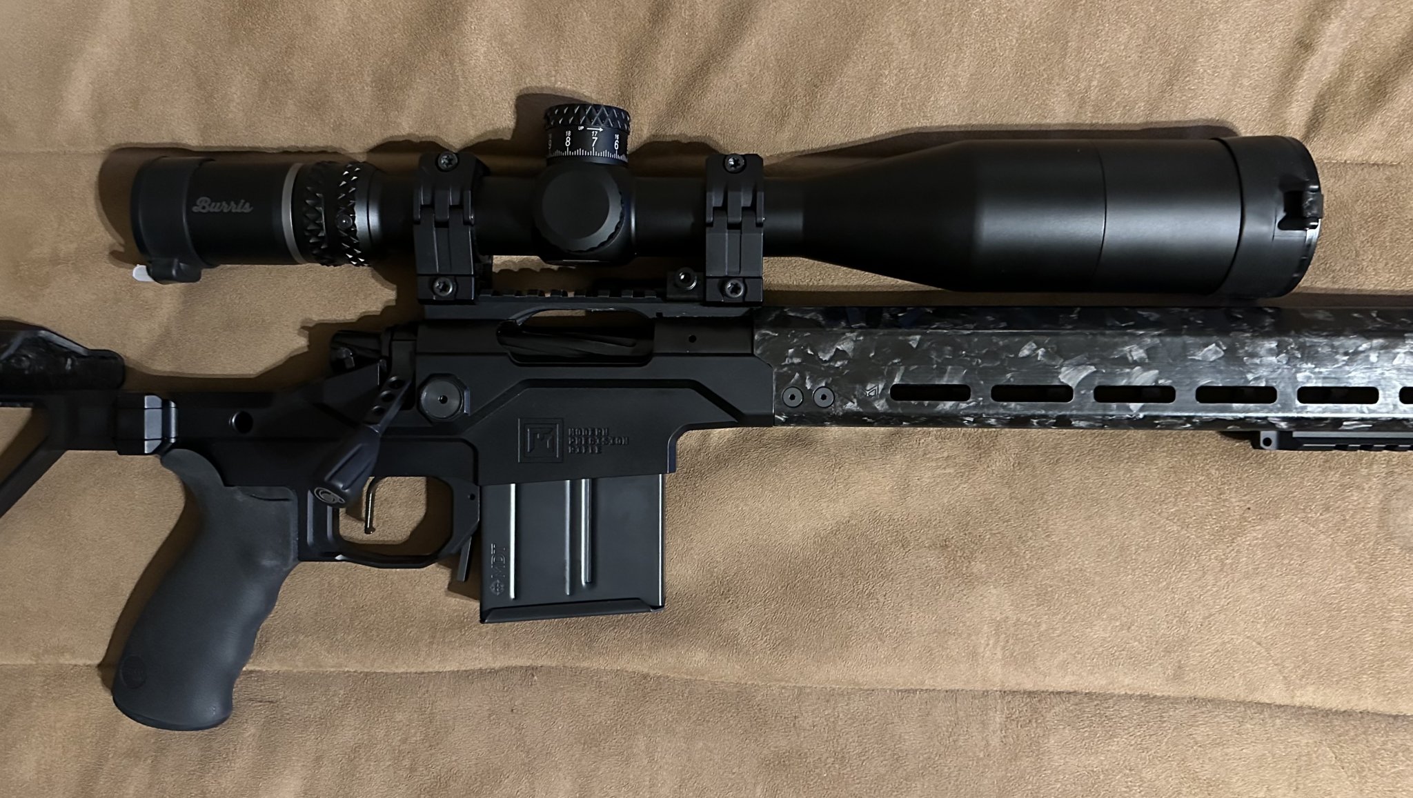

Updated pics with the new XTR-IIIi 5.5-30x56… Looks pretty good on there, huh? 😏
The same exact rings and base that the Kahles K624i was in…The Kahles only had 16.8 MILs to dial, but the XTR-III has 18.6 MILs. 👍🏼

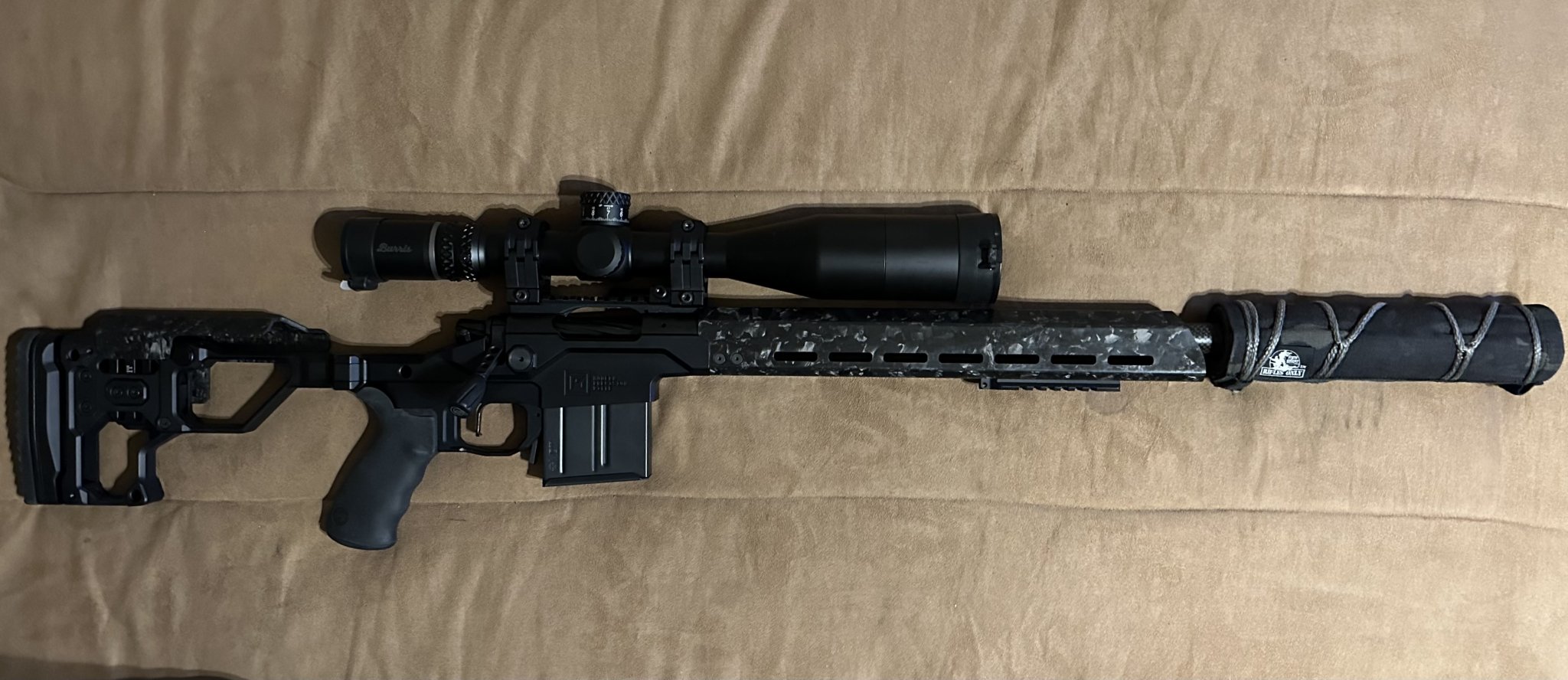

Alright... Another factor eliminated... I removed the KeyMo off the end, and will be running my newly released from jail Otter Creek Hydrogen-L 7.62 with their ZR0-DTA direct-thread mount on it for the testing. This will alleviate any chance of the KeyMo having caused any off-centered gas displacement upon exiting the muzzle, and causing the bullets to fly weird. So, another factor eliminated for this final set of testing. Plus, I can shoot a group or 2 unsuppressed with a bare crown and muzzle just to see if the cans are causing any issue from crooked muzzle threads, or anything like that. We're going to beat this horse one last time to see if she's really dead. And if it is...It's getting sent back. And if it's not, we're sending back whatever WAS causing the issue, and NOT reinstalling it. 👍🏼
Man, this thing just gets sexier every time I swap something out on it. 😏

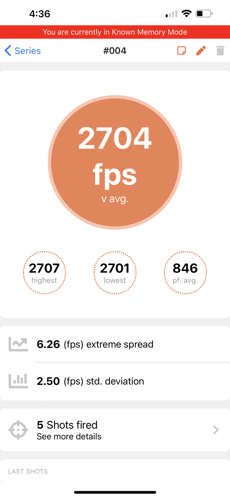

Loaded up some Hornady 110 grain A Tip's that were given to me for my Proof SS 26" barreled Origin MPA chassis.
Crazy good accuracy in the sub quarter MOA range. I don't test velocity when testing grouping so I loaded a few more rounds of the powder combo it shot really well to test velocity and holy crap I wasn't expecting that kind of speed! Anyone with experience with a bolt action 6mm ARC getting anywhere near these velocities out of a 26" barrel with the 110 grain class bullets? No pressure signs at all, easy bolt lift etc...

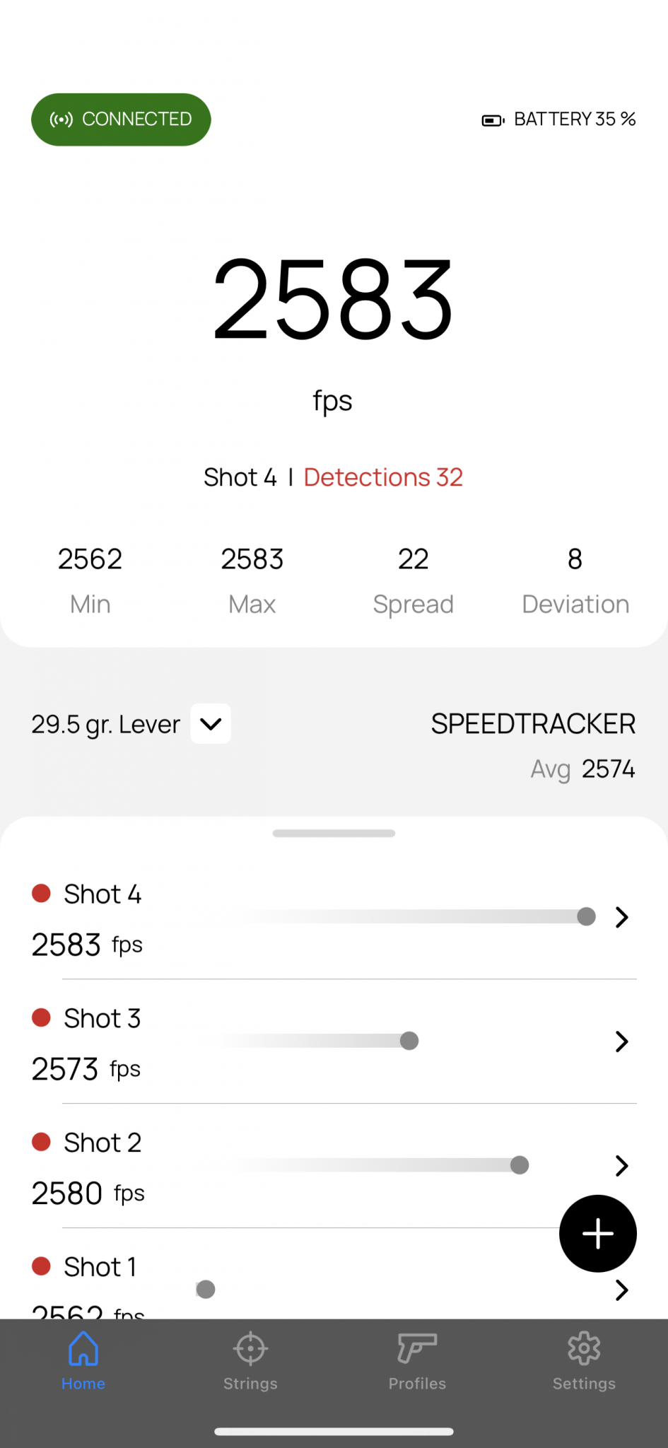

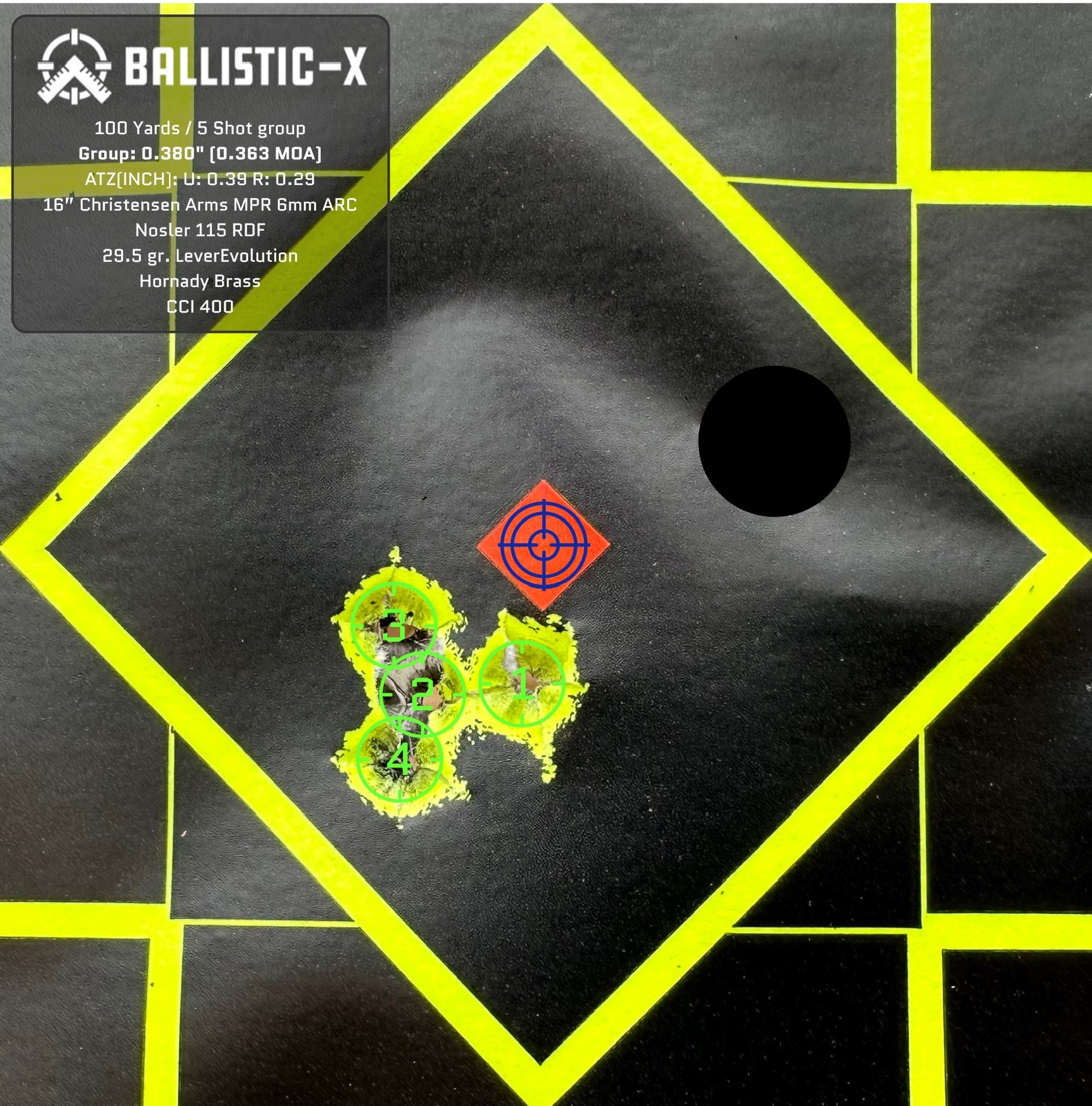

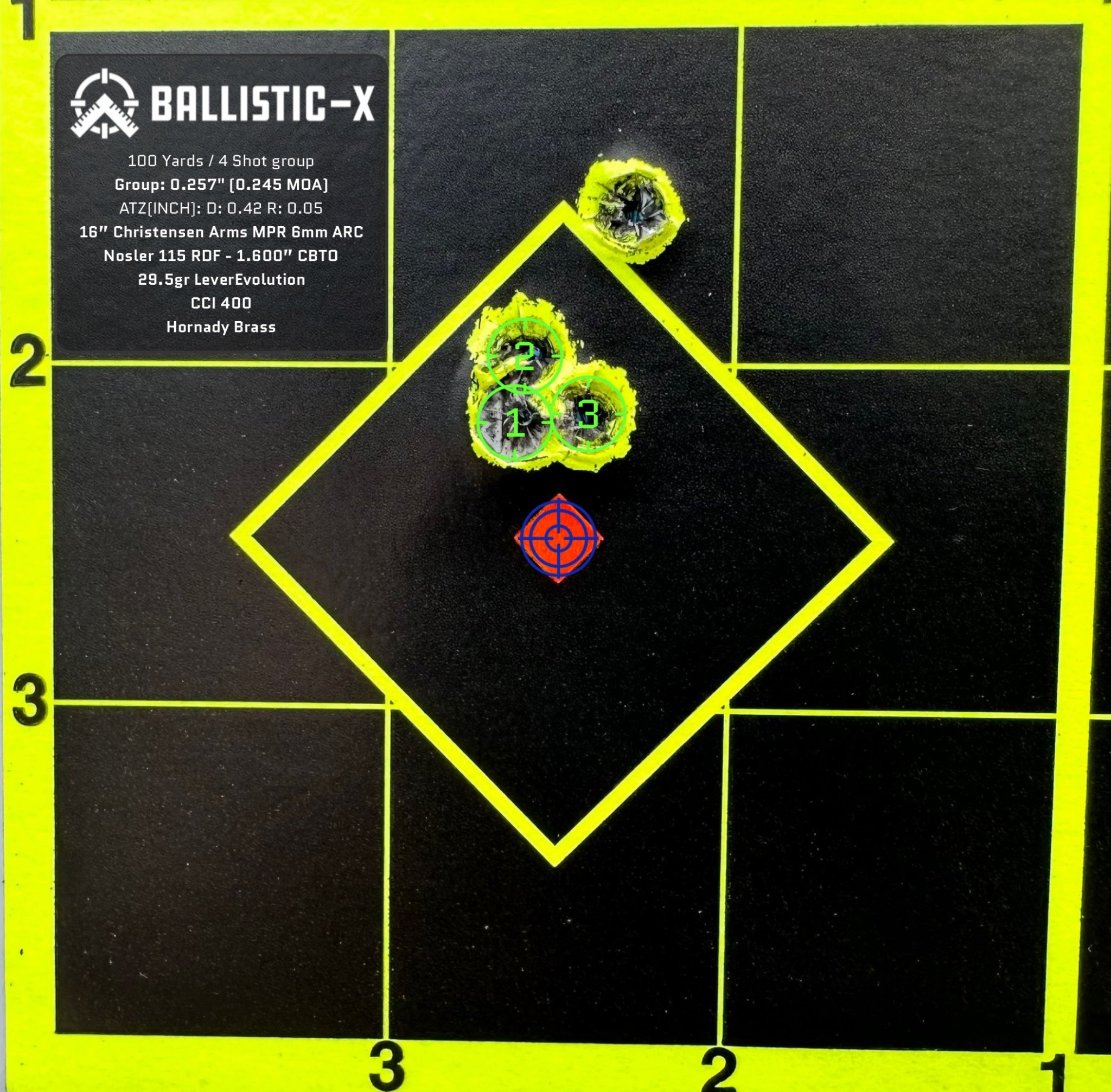

Well…. The new rifle from @christensenarms arrived Friday… So, I did the full inspection, made sure everything was torqued properly, scrubbed-out the barrel just to be sure, and re-mounted the XTR-III 5.5-30x56…
I reloaded some handloads based on my last rifle, and ironically, it loved the exact same load. I’m guessing there must be a Velocity node around there that their barrels likes.
It shot MUCH better than the other one.
I shot 5 sight-in shots to zero the scope. Then 4-shot groups. There is an apparent node between 29-30 grains of LeverEvolution with the 115 RDF’s.
28.5
Ballistic-X-Export-2023-08-20 19:57:42.557297.jpg
29.0
Ballistic-X-Export-2023-08-20 20:01:00.547836.jpg
29.5 (with and without my pulled shot - that was me, not the gun)
Ballistic-X-Export-2023-08-20 20:04:01.499027.jpgBallistic-X-Export-2023-08-20 20:04:40.495123.jpg
Needless to say, I’m extremely happy with the customer service, and the replacement rifle, so far. This bodes very well for future load development.
