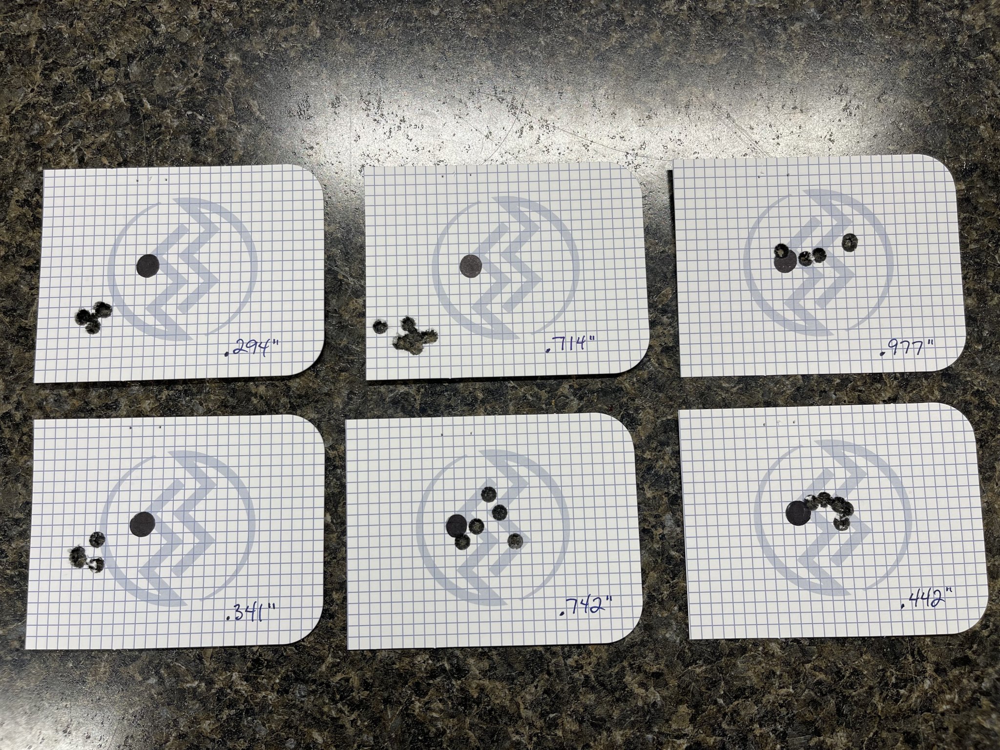

@FuhQ your rifle took a bit longer because I didn't like the groups coming from those 6 ARC barrels which made them go back to the drawing board and toss some barrels in the trash. I know you are happy with your accuracy now so it was worth it. No point putting another barrel that will give you issues on your rifle just to kick it out the door.

@FuhQ I got with production to find out the status of the replacement 6mm Arc barrels. They expect to have them out and ready no later than a week and a half, to two weeks. The reorganization of the shop machines to create a smoother workflow and QC flow set us behind a little further than we intended. Thanks for your understanding.

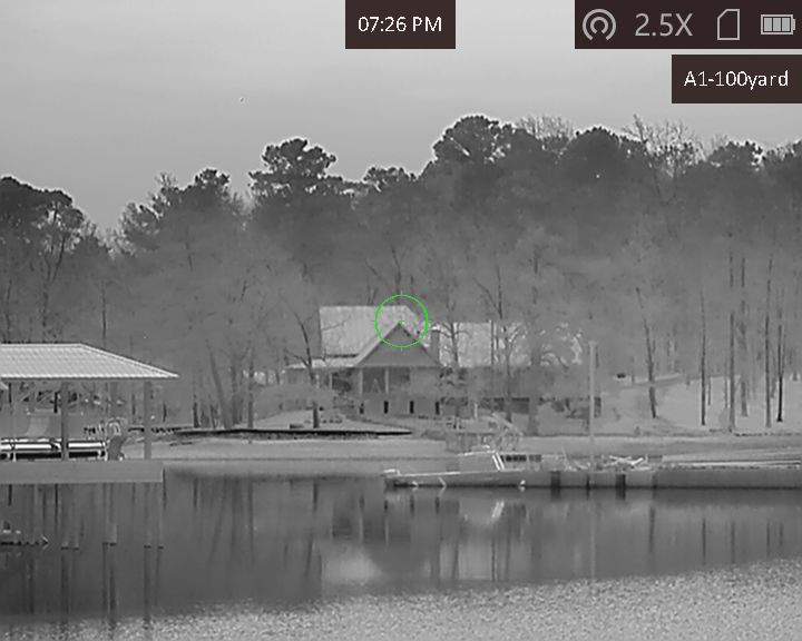

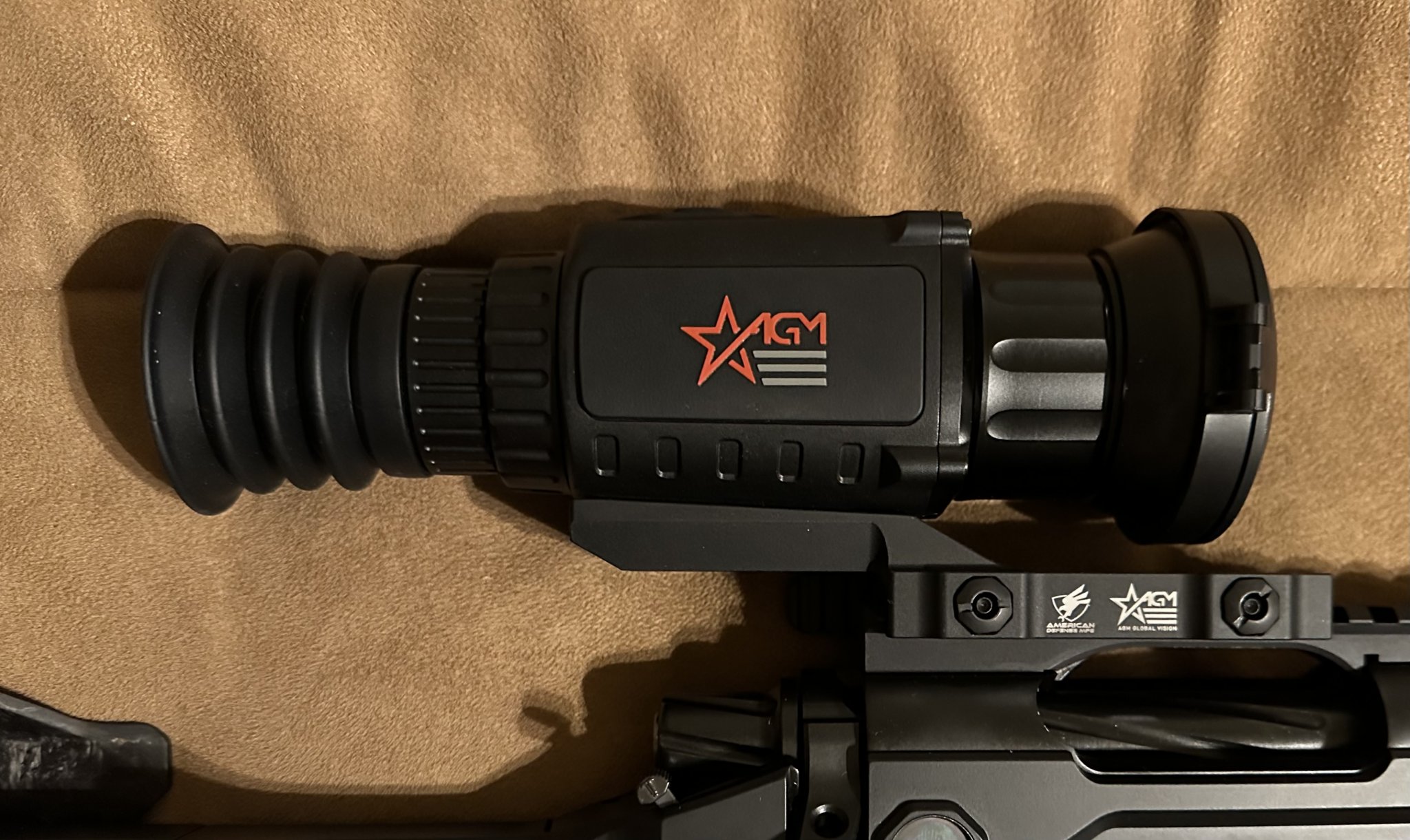

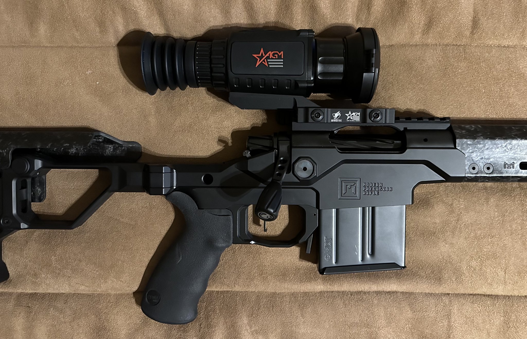

Threw the new AGM Rattler TS50-640 thermal on the @christensenarms MPR 6mm ARC and did a rough bore-sight. I'll zero it one day this weekend, maybe tomorrow or Sunday, depending on the weather, or if I get to go to the range. Looks right at home on there... 😏
Also, a very interesting tidbit, I am now even MORE impressed with the ARC M-Brace rings. I removed and reinstalled my XTR-III several times using my Fix-It-Sticks 55 in-lbs limiter and the scope was still dead-on zero each time. That gives me faith that I can swap from my XTR-III to my AGM Rattler TS50-640 for coyote hunting. 👍🏼
Reactions: christensenarms

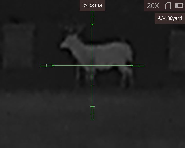

Well, it's zero'd...Dead-on the money, too. Like an idiot, I didn't buy any thermal targets to zero it. So, I had a buddy with a scope spot for me, so we really dialed this thing in precise like a regular scope, using MILs and math and converting it over to the digital X/Y axis.
Here's a pic at 200 yards, at max magnification (20x), and NOT a thermal target (AR500 steel)... I'm surprised the image is that clear based on how little heat signature the cold steel target puts off. But it's clear enough to take heart-shots at 200 on a cold steel deer in the middle of a cloudy afternoon. I'm happy. Can't wait to get it out into the woods and see some wildlife with it. When I do, I'll get some nice clear images and videos. 👍🏼

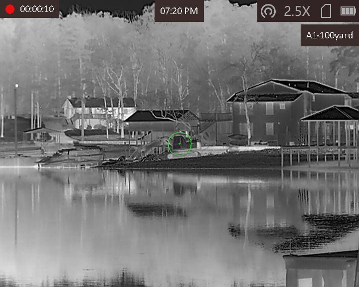

2.5x black-hot mode… 400-500 yards away.
2.5x white-hot mode… 700-800 users away.
