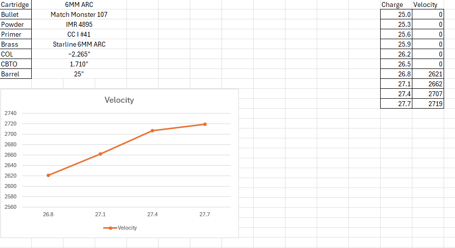

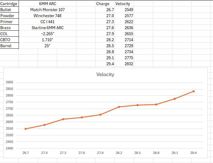

Digging up an old post, but Sierra posted some data around SHOT that included H4895. IMR4895 is a bit slower than H4895 but it is not as slow as CFE223. It should be just fine for the cartridge. I'm going to be trying it with some 107 Match Monster (bulk Nosler 107 purportedly).
IMR 4895 burned too fast with the big heavy. Saw pressure earlier than I wanted. It would probably be fine with like 85 ish grain bullets. I'm currently running Win748 with the last of my 107s and will use it when I switch to Hornady 105s. Barrel really seems to like those in the pressure ladder I ran.

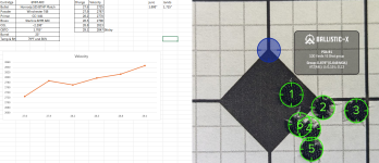

I ran some initial velocity ladder testing with Alpha Brass, CCI BR4 primers and Hornady 108gr eld-m bullets. Results are out of a 20" 1:7.5 Benchmark barrel attached to a Zermatt Origin action.
Trim Length: 1.480"
Neck Tension: 0.003"
CBTO: 1.699" (zero'd on Hornady ogive gauge)
COAL: 2.250"
Powder: LeverEvolution
Results with 5 round groups:
29.2gr: mv 2699fps, sd 7.3
29.7gr: mv 2758fps, sd 3.5
30.2gr: mv 2806fps, sd 8.5
30.7gr: mv 2842fps, sd 12.1
31.2gr: mv 2890fps, sd 5.8
I was mostly just ballparking velocity and not chasing precision, but fwiw they all shot 0.5moa or below, which the 31.2gr load coming in at 0.3moa. These groups are too small to really conclude anything about precision so take that as you will.
I did have some consistent extractor shine marks on even the mild loads which I'm pretty sure are due to the headspace being a bit too roomy on this virgin brass. No other pressure signs, cases and primers look fine.
EDIT: went down the rabbit hole trying to figure what could be causing the extractor marks and turns out my freebore is seemingly very short (0.090") which is causing even Hornady factory COAL ammo to jam into the lands, which probably explains the higher than expected velocities and mild pressure signs I'm seeing on this 20" even with moderate loads. It shoots fine, but going to reach out to my barrel provider to get something spun up with some more freebore breathing room because I usually stay at least 0.020" off the lands and don't want to play pressure games with already temp sensitive powder.
Trim Length: 1.480"
COAL: 2.250"
Charges over 30gr in your setup are over pressure... And if your jammed into the lands your even more over pressure than QL shows. your 31.2gr load @ 2890 is over 70,000psi... 6 ARC max sammi bolt gun pressure is 62,000 psi.. These numbers are are confirmed and trued from my 6 ARC testing.
The problem we are facing today is such good brass isnt showing the typical pressure signs we were used to. And Alpha OCD brass masks those signs even more.
You are WAY over pressure with Lever in your setup. Just an fyi. 31.2gr is right at 71,000psi.. and probably higher in your case being jammed..
Ive said this before, those that want to shoot 6 ARC in a bolt gun need to use a bolt gun specific reamer with a much longer freebore to get that bullet up out the case... Or use the sammi reamer and then throat it out longer... The reamers being used right now were designed for AR's to fit 105/108 in an AR mag. This isnt an issue with bolt guns and leaves a lot of bullet jammed down in the case eating up capacity.
I did all of this with 224V when it came out. I designed and had a 224V bolt gun specific reamer made to shoot 90smk's with the bullet boattail/bearing surface junction above the case neck/shoulder junction...
Heard yeah the pressure signs were bothering me to the point of going down the rabbit hole. My Lever powder charges came from the Hornady manual (31.2 max for a bolt gun) but I was surprised at the velocities out of the short barrel. Hornady brass and Alpha brass with the same loads ran damn near the same velocities FWIW.
For sure I'm way over pressure and glad I caught it in time. Actually just ordered the QL disc last night so I can run the pressure calcs myself going forward before going out and trusting anything I didn't calculate or measure first.
My initial mistake was skipping the OAL gauge check and blindly following factory ammo measurements assuming those were GTG with a SAAMI spec chamber and then rolling with Hornady max loads from the book.
I'm going to drop the bullets down off the lands and do an entirely new workup, probably will land around 2750fps for a safe and consistent load guessing around the 30.2gr mark.
Thanks for sharing... I'm going to contact Northland shooter's supply to check what chamber specs they are using and confirm the measurement with a Hornady Comparitor when the barrel is delivered.

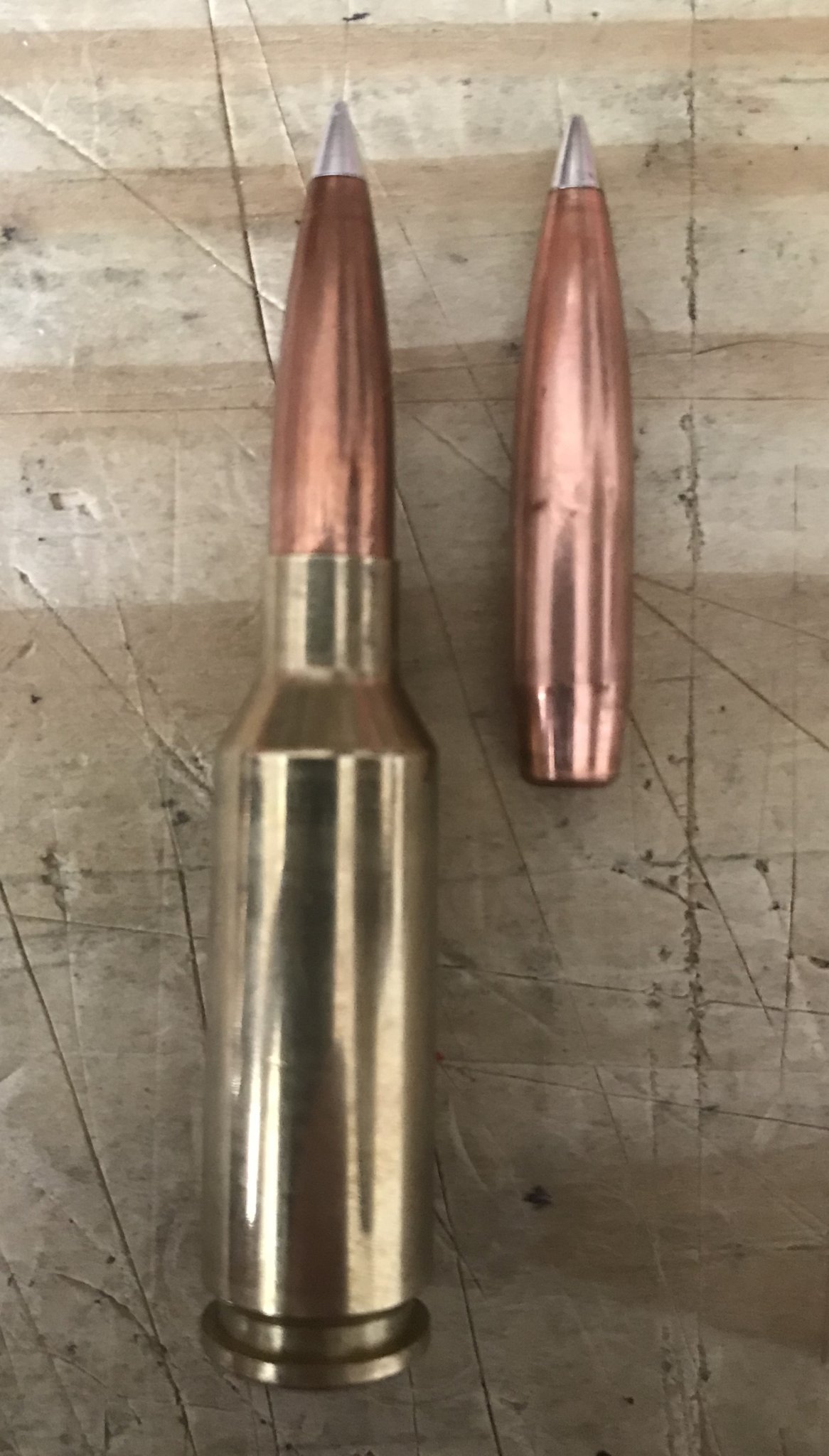

So I just took a bunch of measurements in my 6 ARC with SAAMI 0.089" freebore chamber using the 108 ELD you asked about...
I hit the lands in my chamber with a 108ELD @ 2.30" COAL.. So, first, if your jammed at 2.25" then something is off there...
I marked the boattail/bearing surface junction of the 108 ELD and laid it next to the 2.30" COAL round right out of my gun touching the lands. You can see where the junction is. Its WAY down in the case eating up capacity and giving you pressure much earlier than it would if we had an optimal bolt gun 6 ARC chamber/Reamer. Shit its down at the shoulder/body junction.
Now, I took another round and I moved that 108 ELD boattail/bearing surface junction out to just above the donut area neck/shoulder junction which is your optimal location for round. Rule is you always want to be above the donut.
Thats now 2.40" COAL and look how much more room you have in the case to optimize this round for a bolt gun.. Im talking to Manson right now and gonna have one made to test in my TL3 then Ill give my reamer to a smith to chamber barrels with just like I did with my 224V 85-90gr bolt gun reamer I designed... Optimal bolt gun 6 ARC freebore for 108 ELD measures about 0.180-0.190" fb

Is that from Josh? He used a 0.089" fb saami reamer? Not throated at all? If so, thats way better than the 108 ELD, 105 Hybrid and 107 SMK I measured in my Saami chamber Craddock used on my 22" 6 ARC RTR barrel.
Yup that's from Josh. I assumed he used a SAAMI chamber. I didn't ask.
They are 1.310" long. The loaded round is 2.355".
Gotcha. So it looks like a shorter boattail, and long bearing surface.
Must just be the design of the A-Tips and the 108 ELD is just a really long bullet....
I just measured my 106 A-Tips and they are 2.38" COAL to the lands and my bullet boattail/bearing surface junction is almost in the same exact spot yours is in your picture with your 110 A-Tips.. just below the neck/shoulder junction.
I guess these 106-Atips are long. 1.321" long...

Rifle is a 25" X-Caliber blank on an Origin action with a SAAMI spec 6MM ARC chamber. Through a baffled suppressor.
