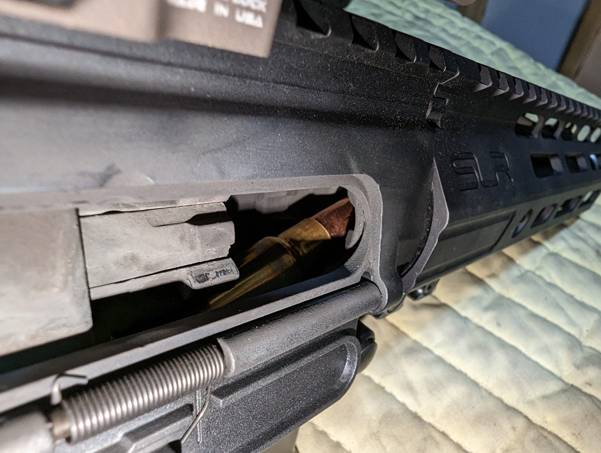

So, I'm having a really shit time with Firehole Arms (aka: Black Ammo Matters) hunting subsonics. The first round I chambered in my bolt gun was tight, but not alarmingly so. When I pulled the trigger, the shot was very clearly NOT SUBSONIC and I heard that hair-raising "Wiizzzzzz" sound of what I thought was a ricochet. I thought, A: Weird that it was tight chamber; B: not subsonic; C: my backstop is a 10' x 8' x 4' dirt mound, so why the ricohet. Minding my thoughts, I went to eject the case . . . stuck! After several vain attempts, I just let it cool off and then got out the shell. The firing pin dent was perfect, but the base of the case had clear bolt lift signs.
Fast forward 3 weeks, I run out of the Gorilla Hunt rounds, so I chamber one of the Firehole Arms hunting subs again. This goes in fine, and was actually subsonic, but on trying to eject the round, the bolt won't budge at all. "Well, you're an idiot!" I think as I remember the previous incident, and let it cool off. 30 minutes later, after sitting in a 68F room for half an hour, the bolt still won't budge. It took me 10 minutes and a resin mallet to open up the chamber. The case would not eject from the bolt face, so I had to take the bolt out. After about 30 minutes of trying various methods (edge of counter, vice and mallet, vice-grips, torch), I concluded the case had fire-formed to my bolt face. It is currently at a gunsmith. See pics below.
Has anyone else had issue with this ammo? It appears the first round was supersonic and spun apart, resulting in the "wiz" sound (there was no hole on paper and no dent in the dirt mound). My barrel is a Faxon barrel, so I would think it was the standard chamber. Any ideas what happened? Sorry if this seems like an elementary question, but if this is a round manufacturing issue (other people have similar experiences), Firehole needs to be aware (I emailed them pictures and the above story yesterday).

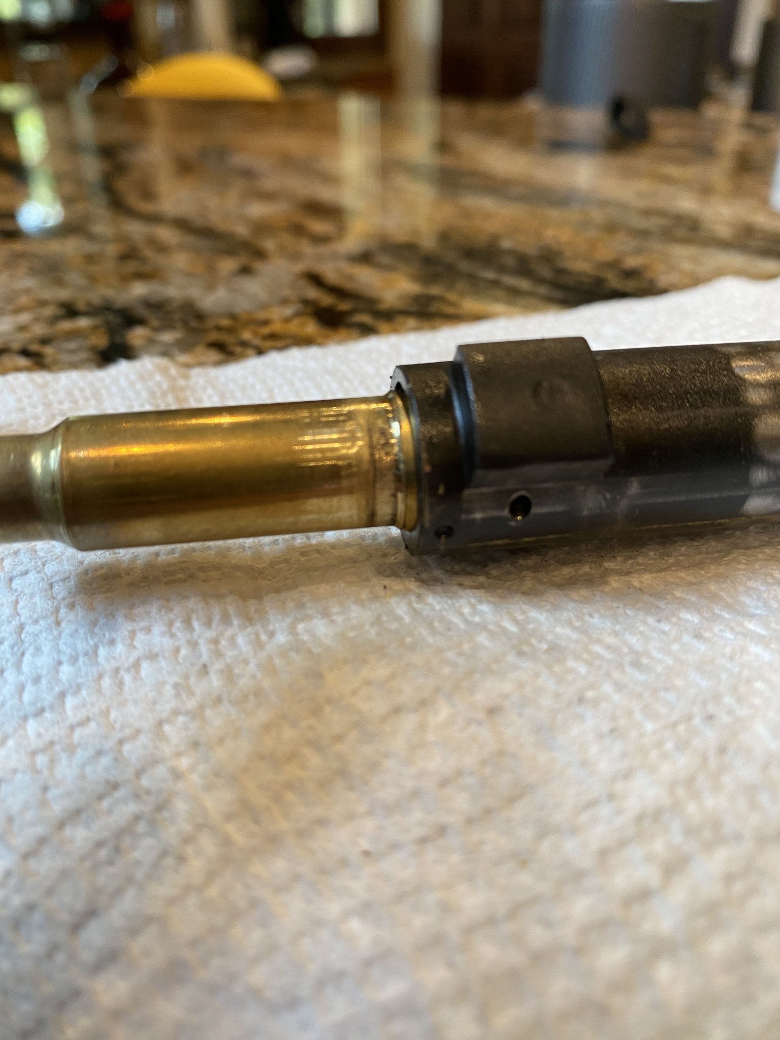

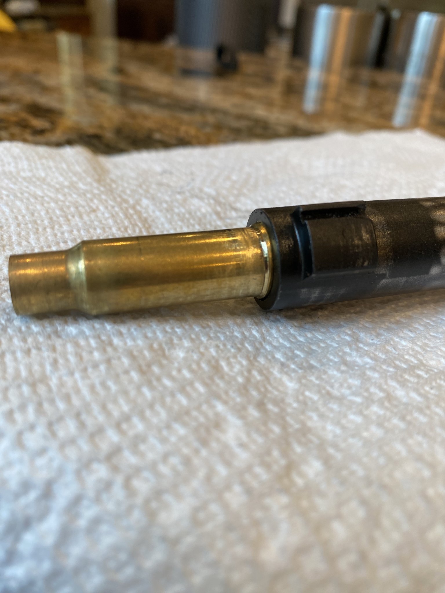

Firehole uses converted brass. This is why i dont offer that anymore and only offer new brass. You still have to neck turn even the Hornady 6.5 Creedmoor brass because neck wall thickness should still be no more than .012” to give enough clearance. A loaded round’s neck should measure .362 for the Q spec .366” neck in the chamber. Also converted brass doesn't have the fireformed shoulder so its slightly rounded. They’re still trying to figure it out, but converted brass isnt what I would recommend unless it's properly prepped by someone who has all the right equipment to anneal, size with at least a .004” shoulder bump, trim, and chamfer. I also check every single round in a ammo checker before its sent out.

Thanks for the info, and advice. I have a mixed bag of brass. I bought some off the internet. I have neck turned all that I have worked on. The Hornady is the only one I have that did not require turning. All the specs you listed are on par. I am hesitant to get into the shoulder, due to some having the case separate there! I was doing some checking and marked a few pieces of brass with black marker. I put them in the chamber and turned them back and forth. They all left marks where the shoulder meets the neck! So I believe that getting into the shoulder may be the ticket. I also checked the depth of different cases in the chamber, and found them as much as .025” difference. I am measuring off the end of the chamber to a straight edge across the top of the barrel. The brass seems to be very inconsistent. I am using Lee dies to do a final sizing after neck turning and aneling. Not sure why the depth is so different!?!
Springback. its more obvious with the Lee sizing die than the Hornady sizing die because of the shape of the expander. Just give it a little more shoulder bump and after a few firings it should fireform. Maybe skim with the neck turner slightly to take off the excess that flows up the case towards the case mouth. After about the 3rd or 4th firing (if its loaded subsonic) it should be fireformed.

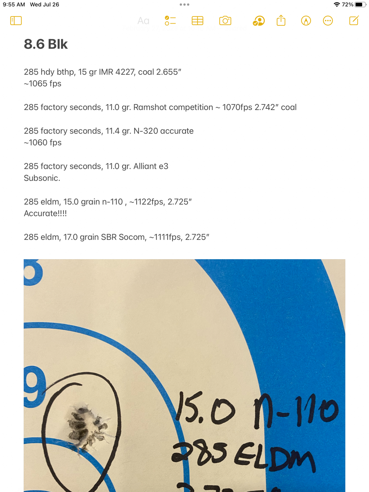

Finally getting around to working up some loads. I have Maker Bullets 220gr T-rex bullets I'm trying to figure a starting load to work some supers up.
I see a lot of sub data for the round(i know that's what it was made for). i have AA1680, varget and CFEBLK on hand. rifle is a 16" faxon barrel/1:3 T/ unsuppressed
would prefer to use cfe blk or varget as it seems to be the most temp stable powder that I've read of being used in 8.6 loads. I'm not apposed to the 1680.
I'll be using the rifle to hunt coyotes over the winter. Don't want to have to mess around with load adjustment and stuff during hunting season.
Scrolled the thread and seen some good info but really no update on performance or data
any guidance would greatly be appreciated.

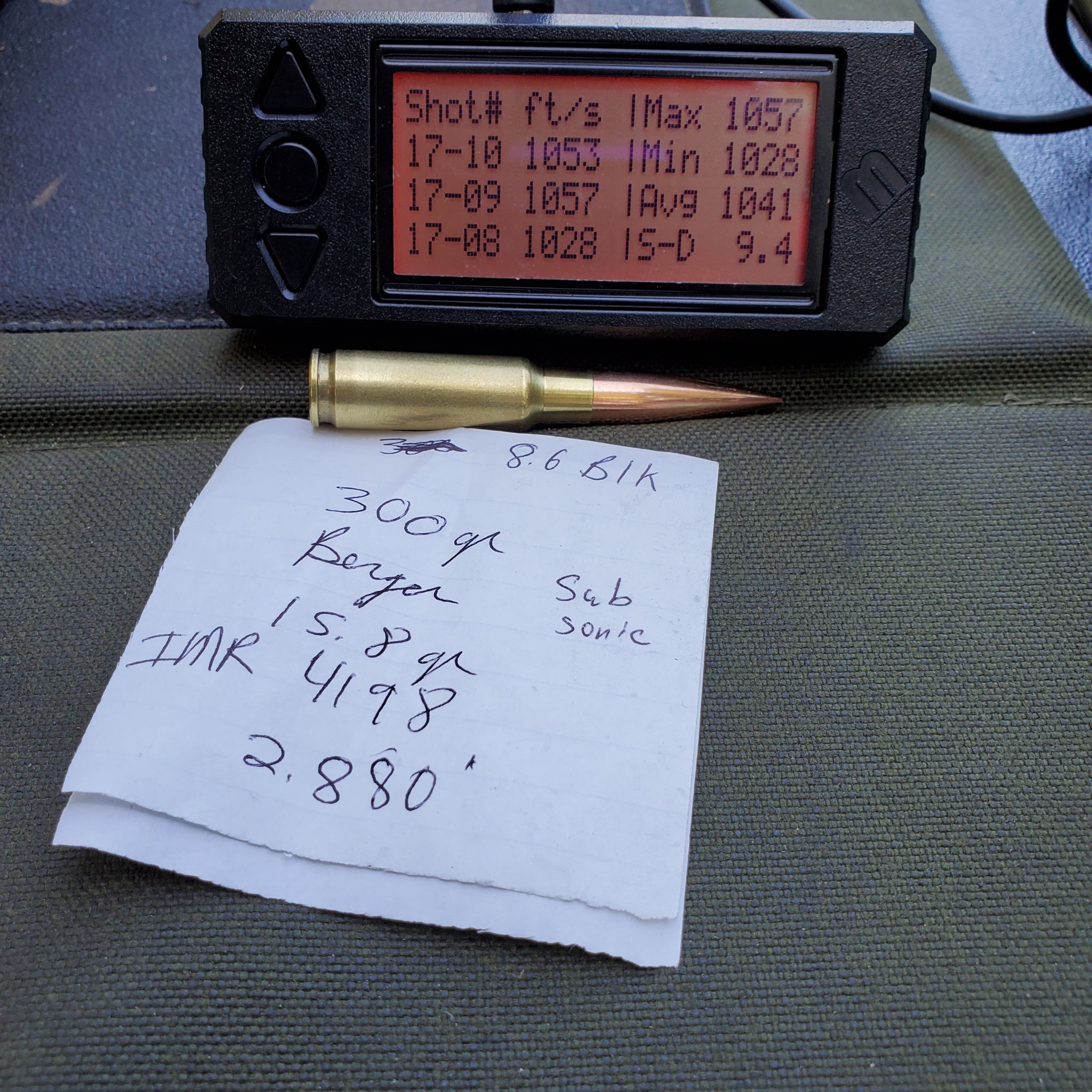

No, if kept subsonic, the 300 gr Berger and 300 SMK were the most accurate in my 16" barrel...keep 285 ELDM below 1400 fps ...at 1400fps they did not make it to the 50 yd target.
Shoot without a muzzle device as they blow up as soon as they leave the confines of the barrel and destroy the muzzle device and the magneto speed bayonet.

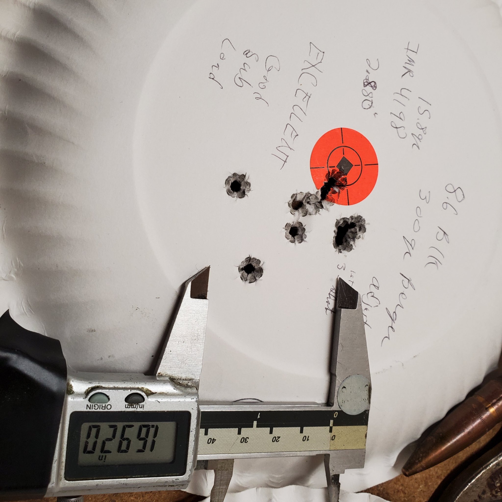

My two best loads are 300 gr Berger 15.8 gr imr 4189 very consistent, and 300 gr SMK 15.8 gr Accurate 1680 are both accurate. And just about the only ones worth considering as this is a subsonic caliber, with too much capacity for subs and too little for high velocity. Plus lighter lead bullets blow up and copper too slow be of any use and inaccurate in the 3 twist. IMO...the 8 6 Blackout is a fun expensive 300 gr 338 Sub plinker.

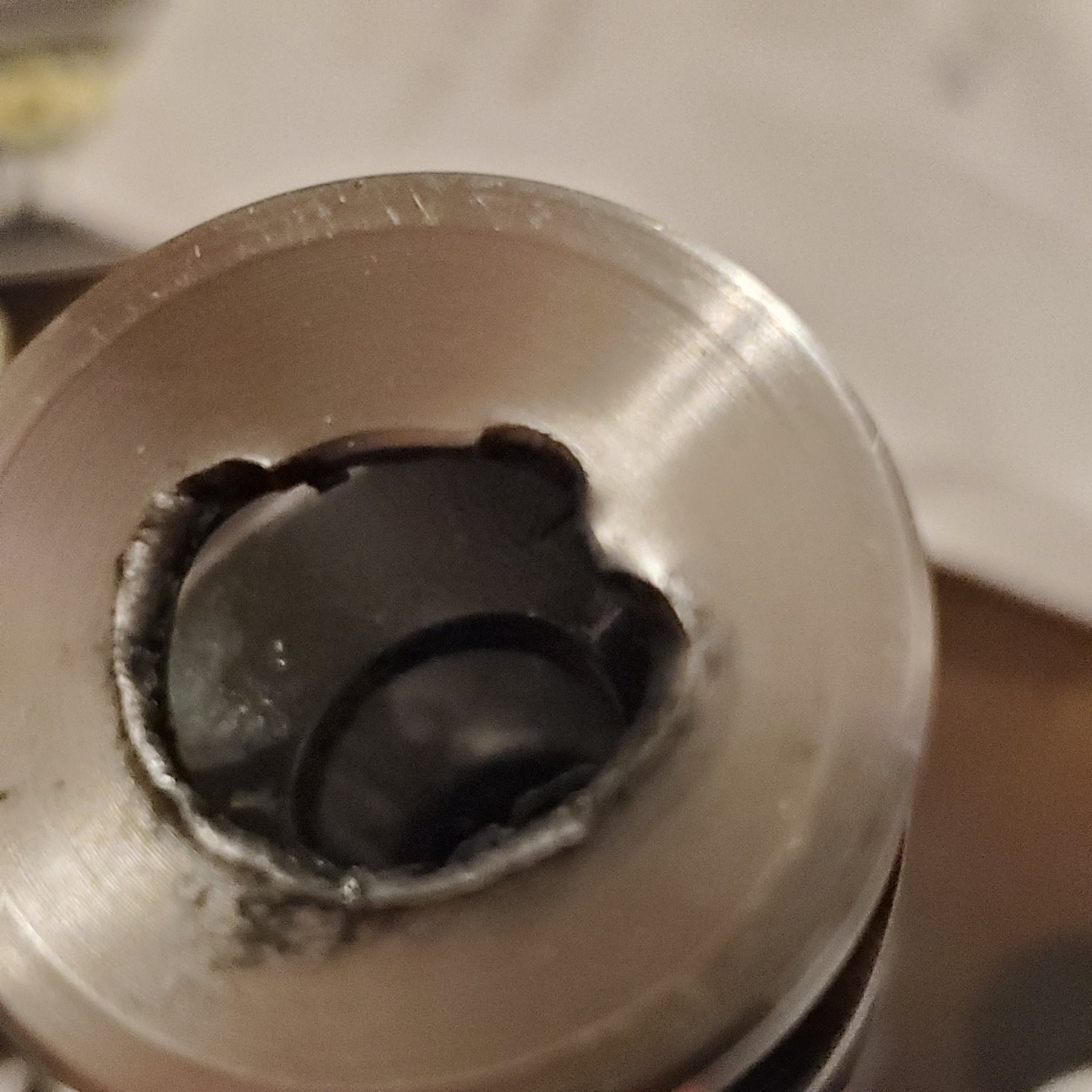

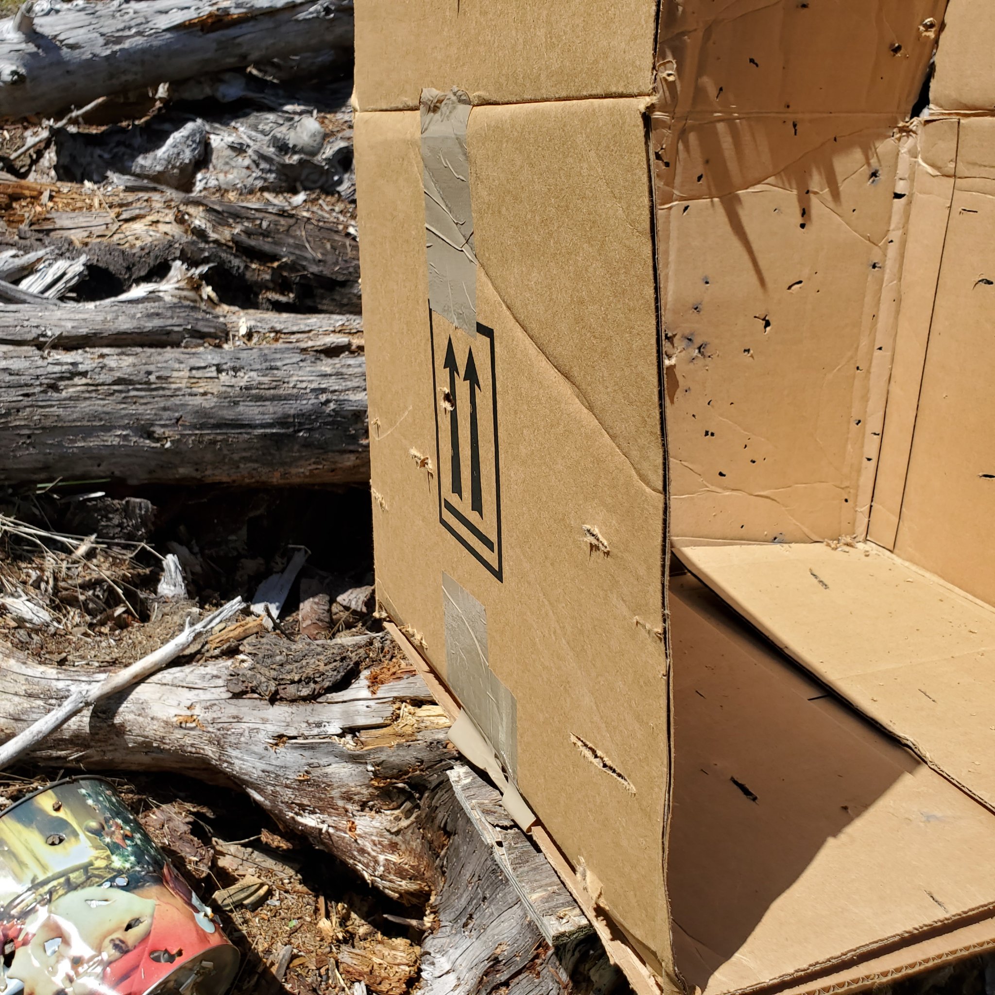

Fired a high velocity 2000 fps lead 225 gr bullet about 18" to 24" from a big cardboard box aiming for the center...not only did the bullet explode the throw bullet fragments into the center but both outsides of the large box were hit with bullet fragments. Dangerous for anyone standing slightly in front of the muzzle.
Reactions: Huckleberry75
The 3 twist 8.6 can be very be dangerous, and why I say stay subsonic mostly, only venture into supers with solid copper. Test with out the muzzle device attached. As this is what happened on the first super sonic load from the Faxon Web site with lead bullets they recommend with Accurate 1680...a few hundred dollars in damage in one shot...had to buy a new MagnetoSpeed bayonet too.

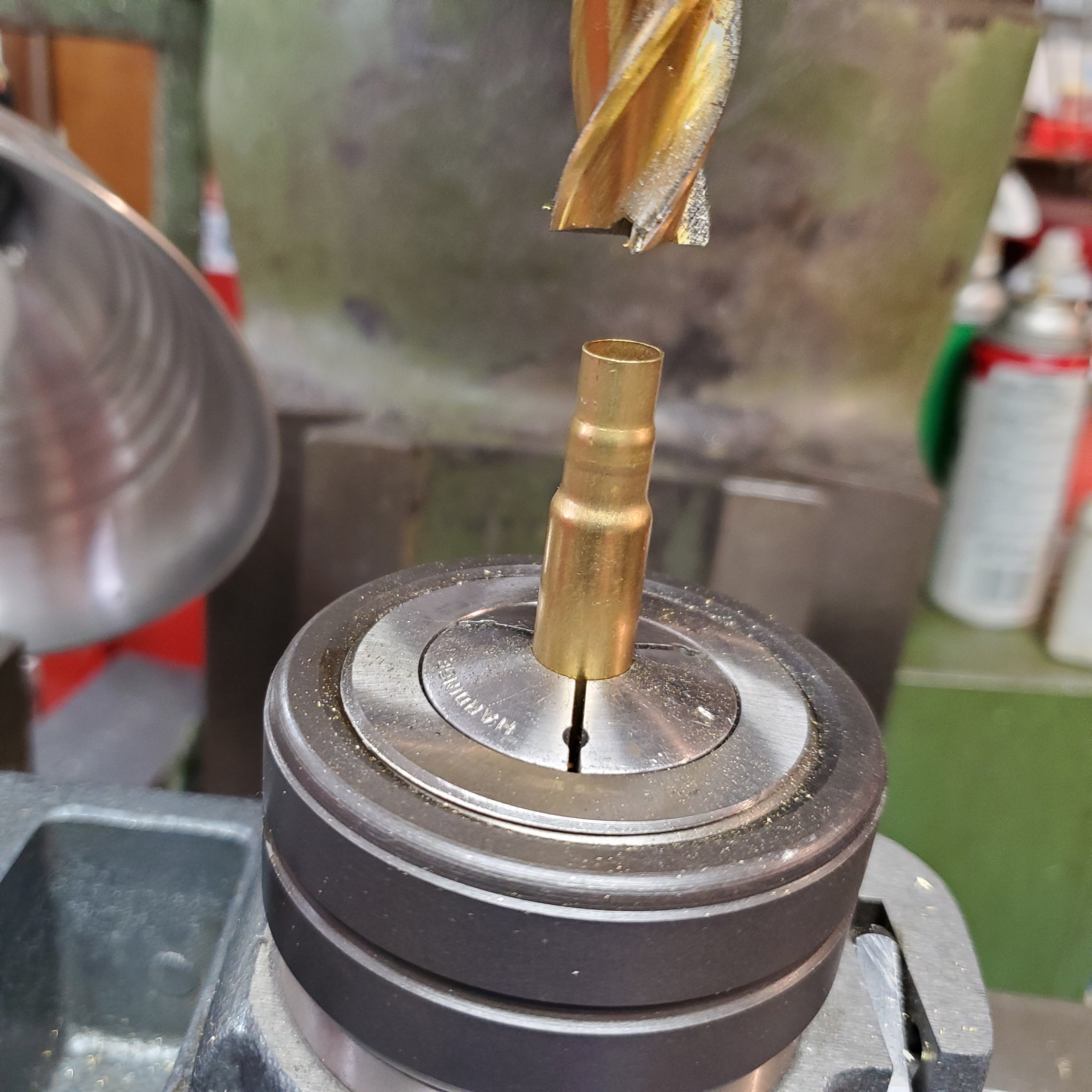

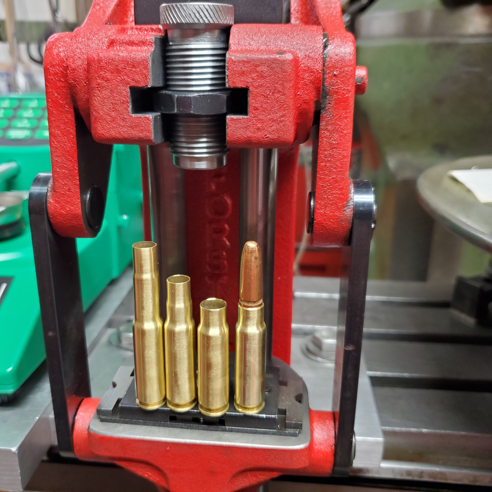

I make 8.6 blackout out of every 308 based case , 30-06, 25-06. 270, 308, 6.5 Creedmoor, but 300 Savage was easiest. I have trimming down to one second cutting time on any length case and home built sizing die takes the brass down in one quick pass. And the necks must be turned into the shoulder and sometimes, .008" off the shoulder at 30°. And each checked for headspace. Then absolutely no problems with the brass.
Reactions: dnchrist

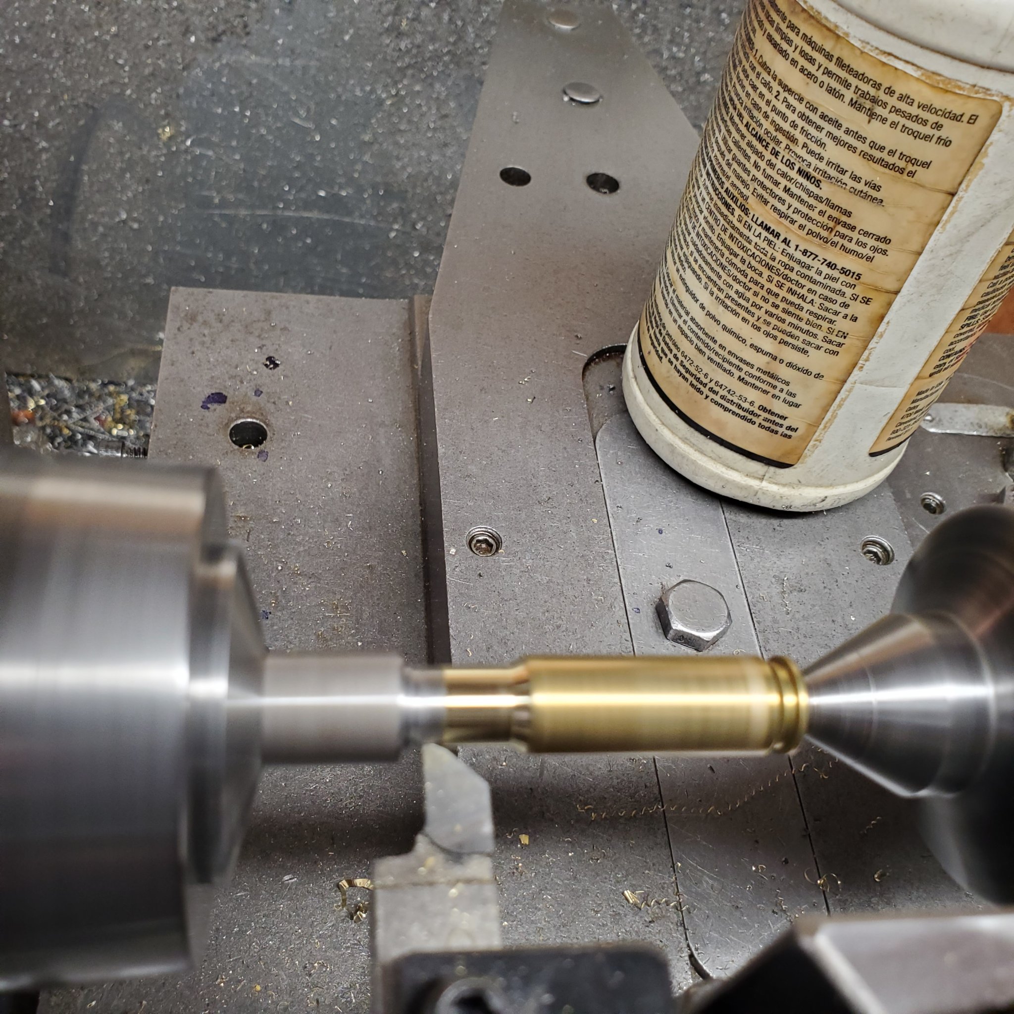

This is the into the neck turning process, nice and fast...for those who have access to a lathe.

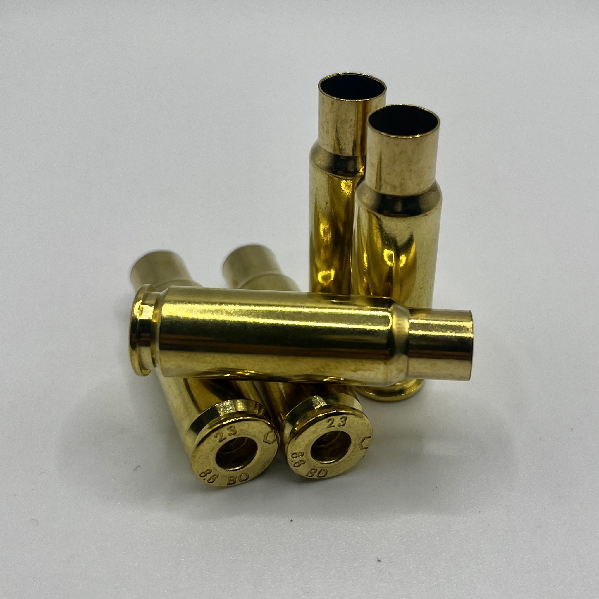

8.6 blackout Converted brass from any cartridge 308, 270, 30-06, 6.5 Creedmoor all need to be neck turned into the shoulder. 300 Savage is the easiest.
The 30-06 & longer cartridges about .008" must be cut into the shoulder, because the brass is thicker and must be checked & gauged 100% so no spring back of thick brass plus necks are also thinned at the same time.
Then they work great even in an auto loader.
I do the cases with machine tools by the hundreds from all manner of 308 head sized brass, so it's much faster, but hand tools are available, just a lot of work.

What kind of accuracy were you getting with that load? Do you have a method for testing the subsonic expanding projectiles? Interested in how the slower twist is going to compare. I’m going to wait to order a Mos-Tek 8.6 barrel if it works out well with subsonic expanding projectiles.
Reactions: DRWilson
This is at 75 yds with a 27X scope, so about a 2" 100 yd 10 shot group is the very best I achieved out of all the bullets tried ...the 300 Sierra MK was about the same but with AA 1680, but higher S/D at 75 yds. So IMR 4198 300 gr Berger was the winner. I do not have an expansion test medium, other than simple water jugs...but I doubt any of these expand, as is. The 225 gr tipped GMX copper bullets tried had double the group size at 50 yds and 5 shots... velocity a bit too high into 1150 fps ave the high velocity was also disappointing with about 1900 fps. According to Hornady the minimum muzzle velocity is 2500 fps for reliable expansion...so they won't work even at maximum effort from the 8.6 in a 16" barrel...according to the manufacturer.
"The bullet" would be the Hornady FTX Marlin express 200 gr 338 at maximum effort (super sonic) in the 8.6 blackout it has a minimum expansion velocity of 1800 fps...But Not in a 3 twist! The 3 twist limits the killing power as it confines bullets to low nonexpanding velocities...subs are fun, but I want to be able to shoot the supers too...where the real performance is at for hunting.
