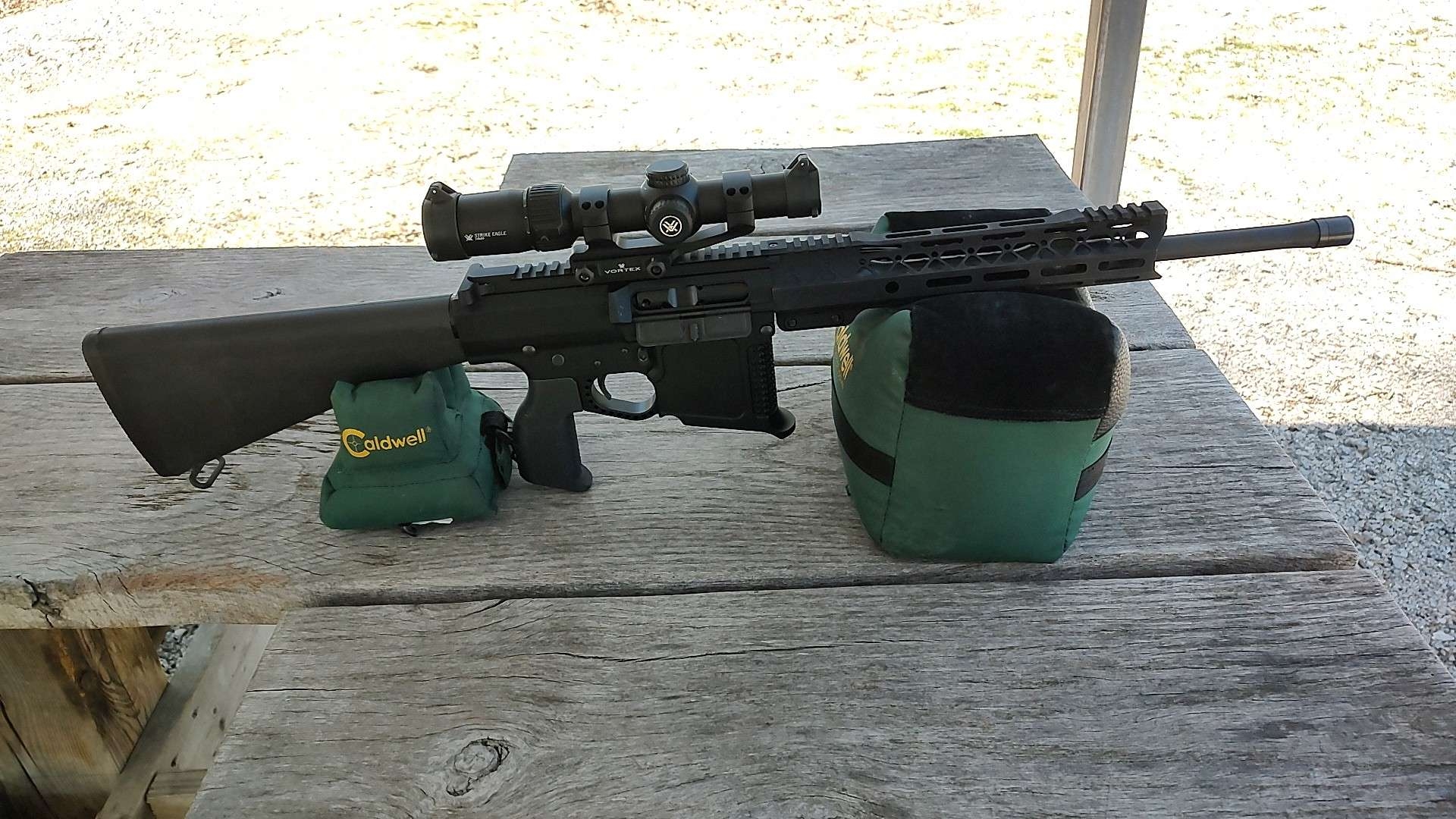

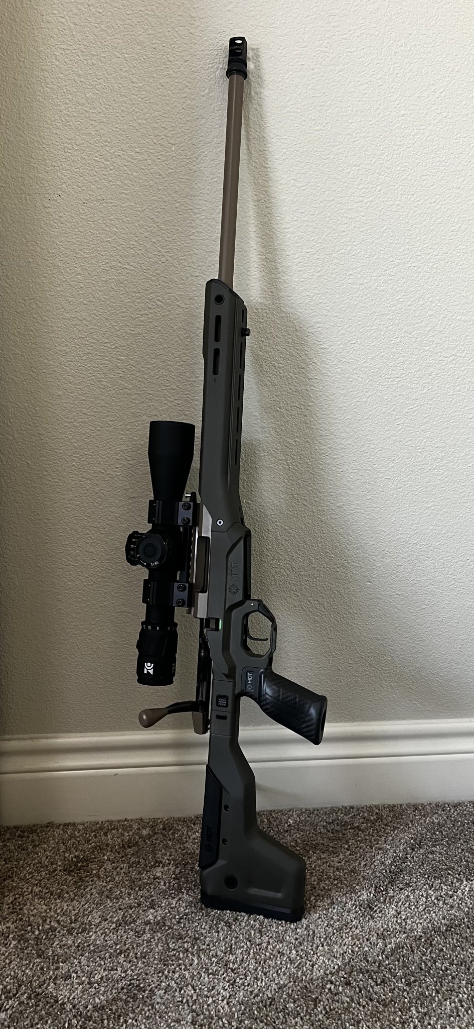

I just tried a load of 17gr CFEBlk with the 285gr ELDM, it was running 1190 out of my 16" rifle. I had only loaded a few to test, will drop it down to 16.5 and 16.2 for next test, only doing 5 of each for the tests.
I also have H110, and Little Gun, but haven't tried them yet.
Any idea what the case fill rate is on your data? Estimate with the eye is cool too.
It was approximately 45-50% on the unfired gorilla brass. They ended up at 1190fps in my 16" AR10, so I need to drop the charge some more. I have Lil'gun, H110 and Trail Boss if anyone has data for them?

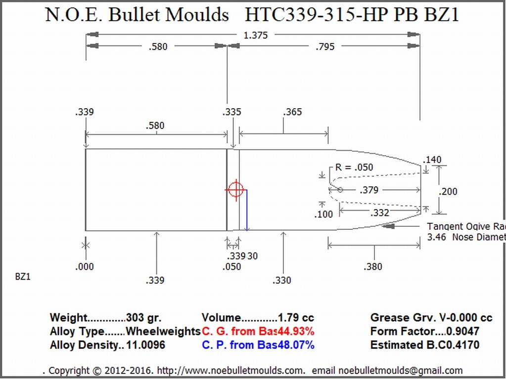

Question, I am looking at cast bullets for the bolt action, do you think a hollow point would hold up or just go for a solid? This is a drawing of the bullet I am looking at.
Greg
Greg
Ive actually tried the NOE 315gr without the nose cavity and it all depends on your lead/alloy mixture. You can have a really hard BHN22 hollow point that doesnt expand and you can have a really soft BHN10 solid that will mushroom like plado thrown against a wall. You want to be slightly soft for subs so they can expand at subsonic velocities if I’m assuming correct about your intended use…maybe 14-16. I’m still playing with lead cast bullets for a cheaper alternative to copper bullets but they don’t shoot as well yet for me.
Yes I am looking at water quenched WW, then powder coated and that should draw it back to about 16bnh after the coating. I shoot cast in quite a few guns, I am just thinking about the 1-3 twist making the HP start to open in the barrel. I can get the mold with pins to make it a solid point if needed. I just wonder if it will spin open, or if I will have to go even harder to keep it from doing that, which them makes the HP not worth using since it would be too hard to open, just fracture. I have till tomorrow before the discount expires that I can use.
As for yours not shooting well, what are you sizing the base to? .339 would be what I would do so it is slightly over barrel diameter. I don't know if your expanding the case mouth or not, but be sure to do that so it doesn't scrape off any of your coating when seating.
Greg
Reactions: DacianMH
Doing all those except swaging the bullet to .339 because the NOE Mold i have casts them to .339 to begin with…unless maybe the cast isn’t consistent. I may be too critical with the accuracy because i haven’t settled on a seating depth just yet. Also accuracy is roughly 2-3 moa at 50y. HTC339-315-FN-BZ1-61

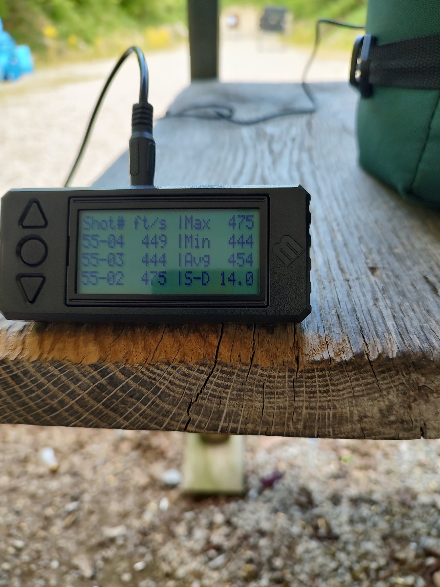

Well I went back out today with 5 loaded up with 9.5gr of trail boss, that is to the base of the bullet, and you don't want to compress trail boss or it gets really spiky as to pressure. Yea, 600fps isn't going to do it lol, unless someone is going to make a fracturing bullet that will open up at that speed.

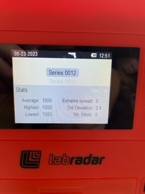

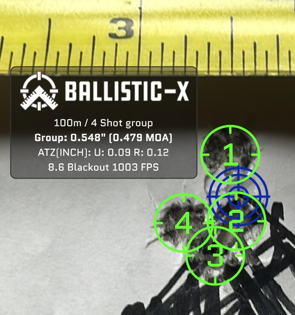

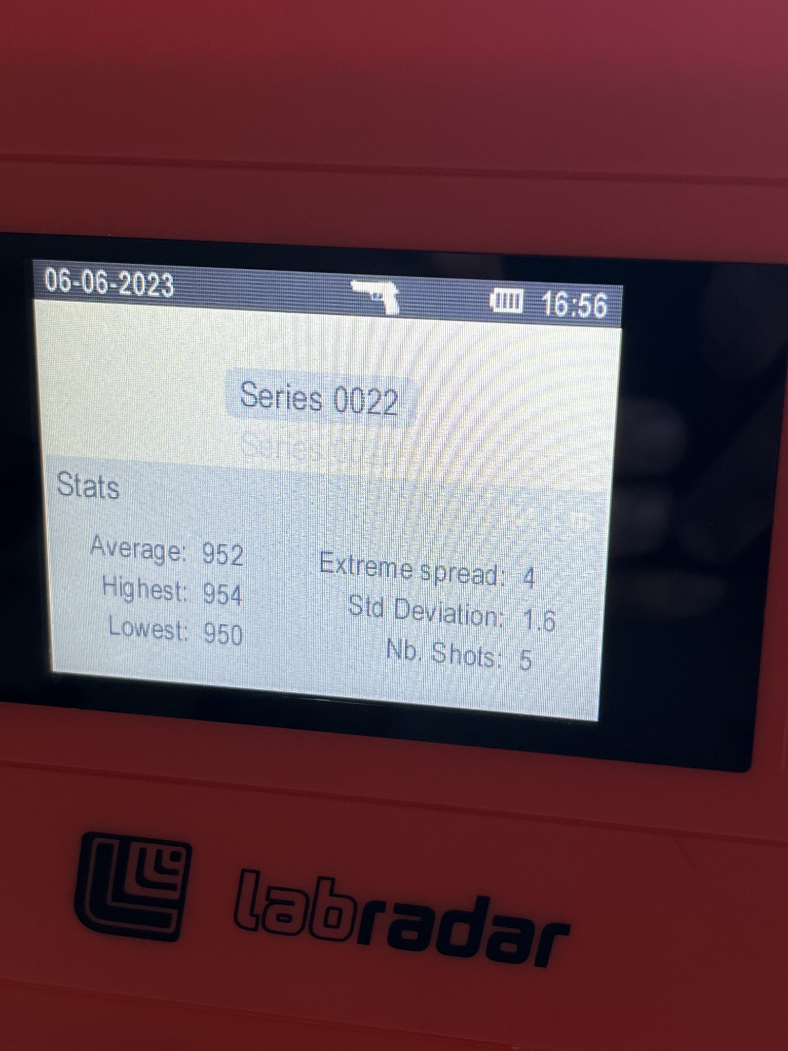

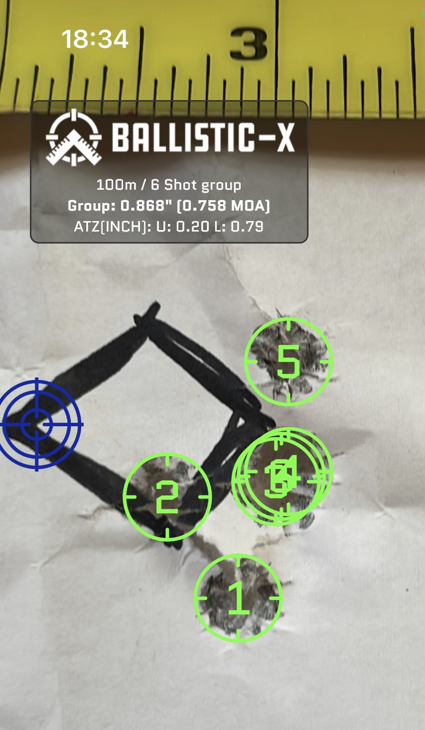

Some load data for supers in the 8.6 blk. I see a lot of people saying the twist is all marketing hype and it does suck that bullet selection is so slim but I've never seen a mono bullet expand this much at this velocity (whatever that may be 100 yds out). The coolest and most compelling thing by far is the screw shape created by the twist while expanding

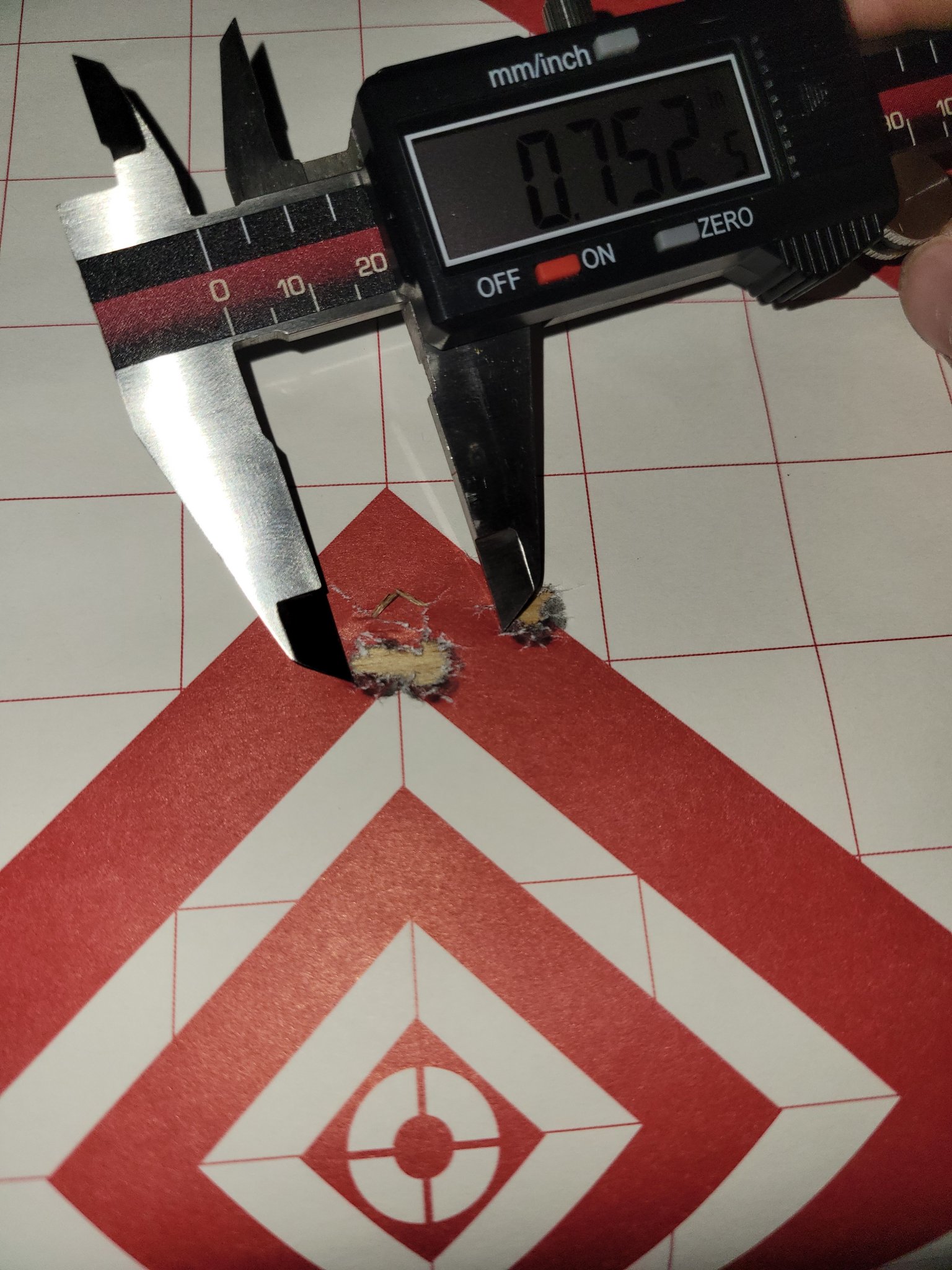

So I set lmt target up on a thin sheet of plywood and recovered the bullets from a dirt mound. Switched to a 16 in barrel because I refuse to register a pistol (this is an AR).

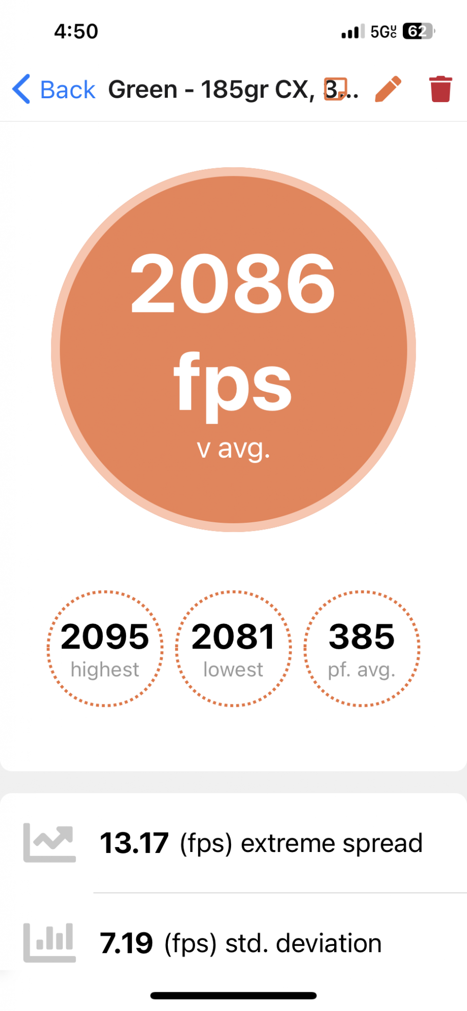

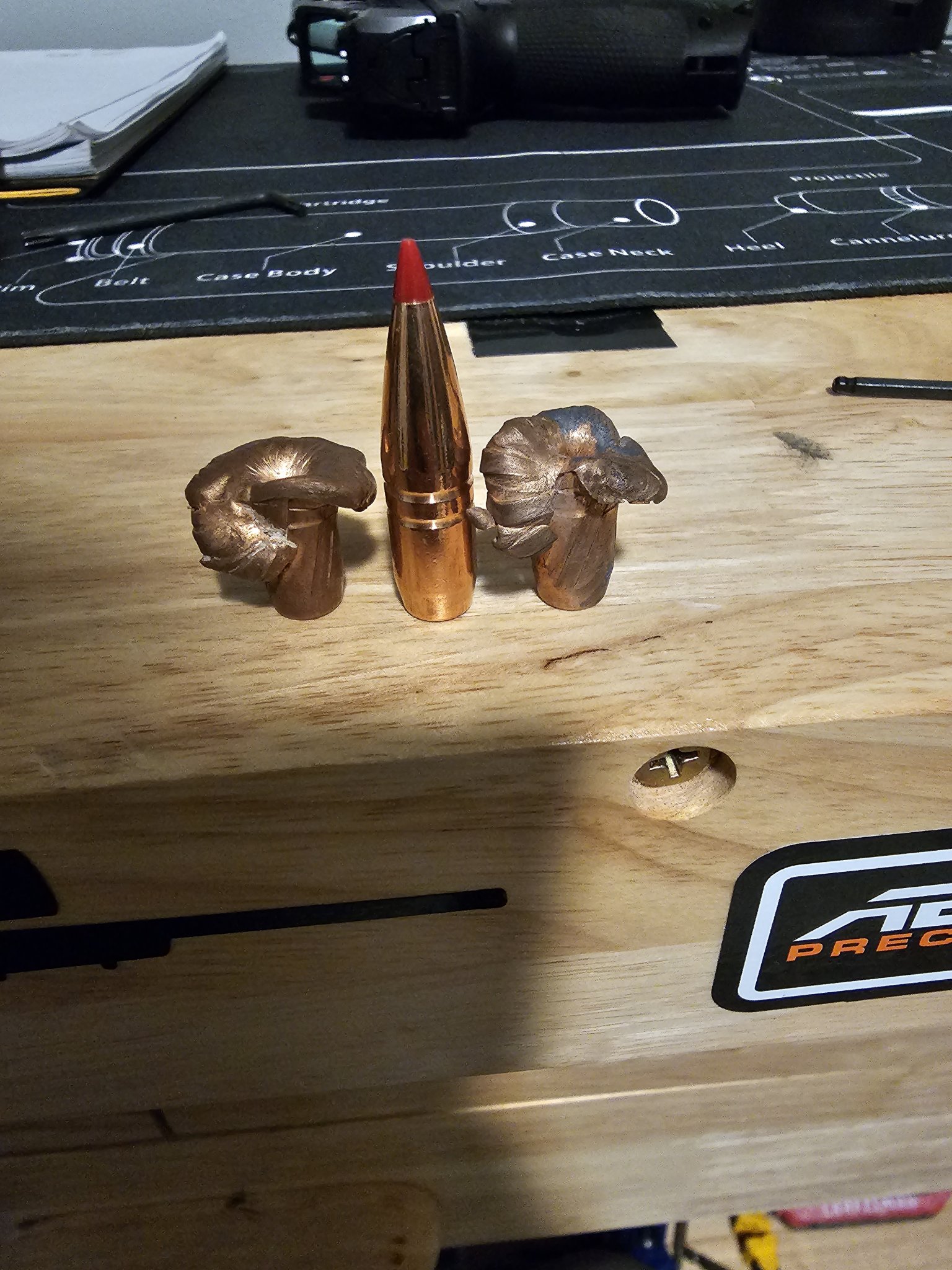

I’m curious if it would have similar results in gelatin, or better yet a game animal. That 185gr CX load might just be universal. Out of my 12.5” its very accurate at 100y.

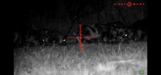

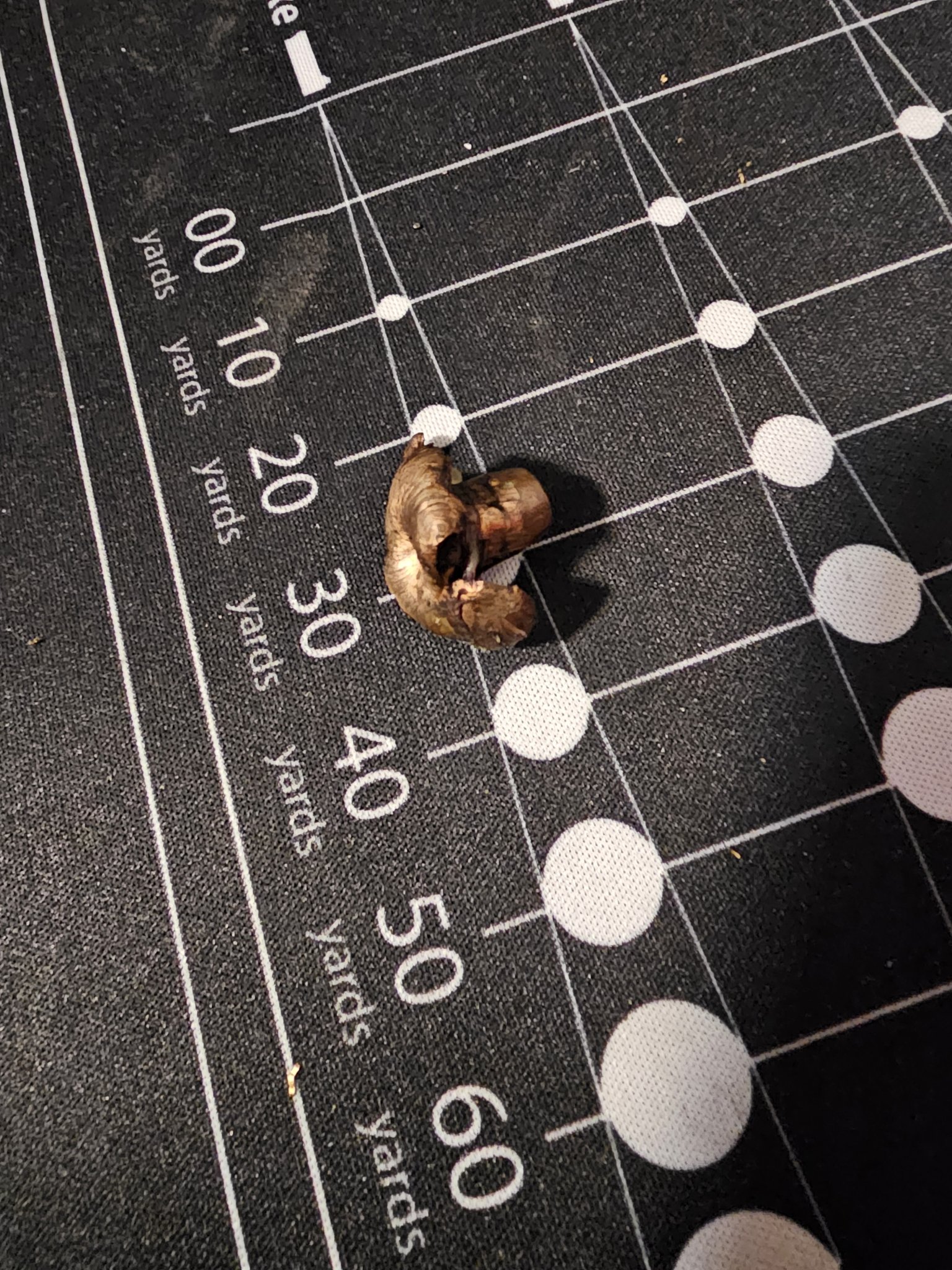

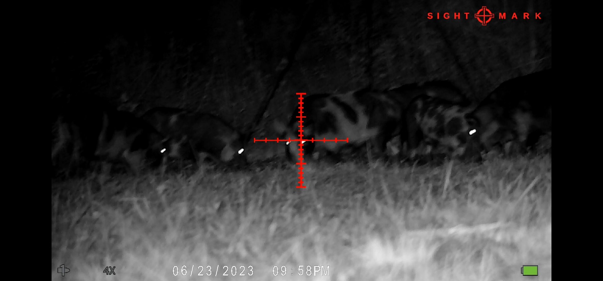

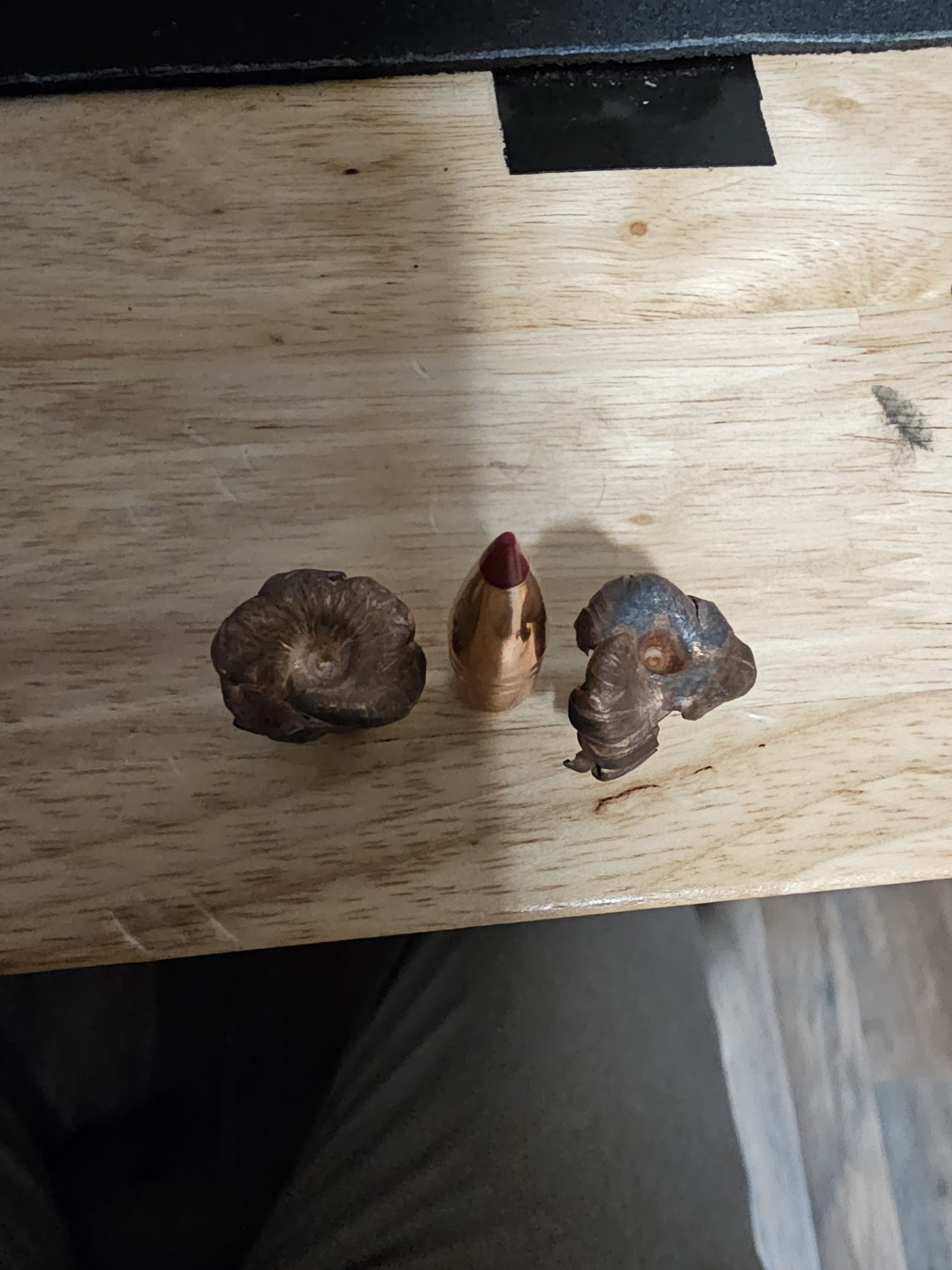

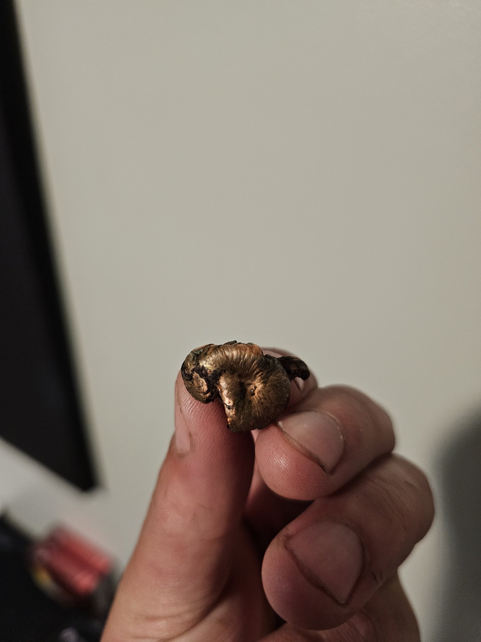

I do have a bullet I recovered out of my last hog and the expansion was still very impressive. Went into the skull just above the left eye and found it right behind the right shoulder just under the skin. The CX is my favorite bullet no matter what I'm shooting
Nice shooting. Does your barrel have the 1:3 twist? AR or bolt and what length? Apologies if you posted that info up thread and I missed it.
I had absolute shit luck with the 185CX on the two pigs I shot. First one was right in the head at 65 yards and still went 10 yards. Second one took one at 155 yards, rolled it and then I put 4 more into it.
Coyote on the other hand, it puffed it’s head up
Hogs are very resilient and they have a small brain cavity, large heavy structured faces encapsulate that small brain and deflection is always a concern when hitting bone with a spire point bullet design…I’m not sure what happened but it definitely wasn't a central nervous system shot because people have done it with smaller calibers on pigs before. Here’s several I took with a 5.56mm. You have a super nice setup those MDT chassis setups are clean.
