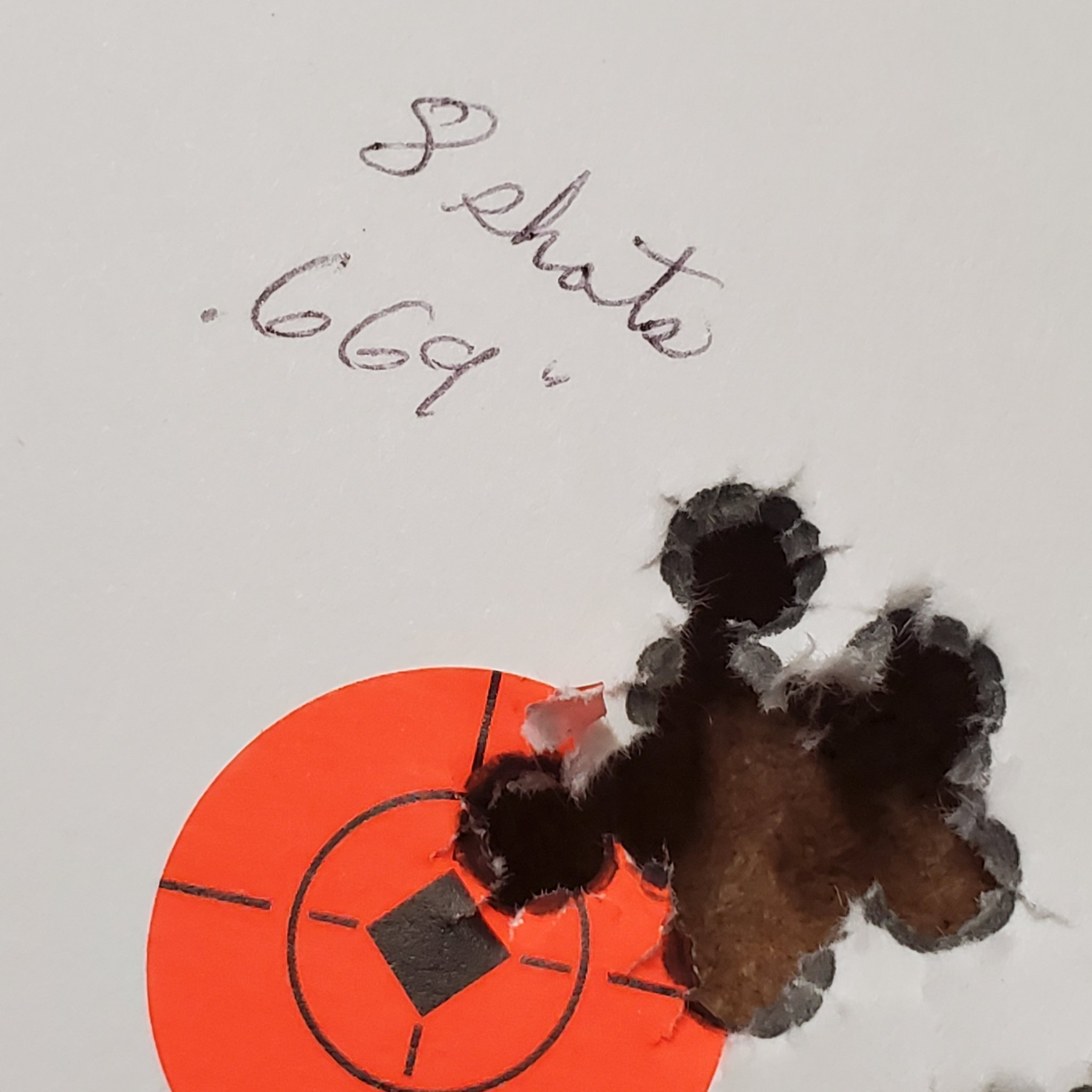

What kind of accuracy were you getting with that load? Do you have a method for testing the subsonic expanding projectiles? Interested in how the slower twist is going to compare. I’m going to wait to order a Mos-Tek 8.6 barrel if it works out well with subsonic expanding projectiles.
My 6.5 twist 8.6 was much more accurate than then my torn rifled Faxon 3 twist.

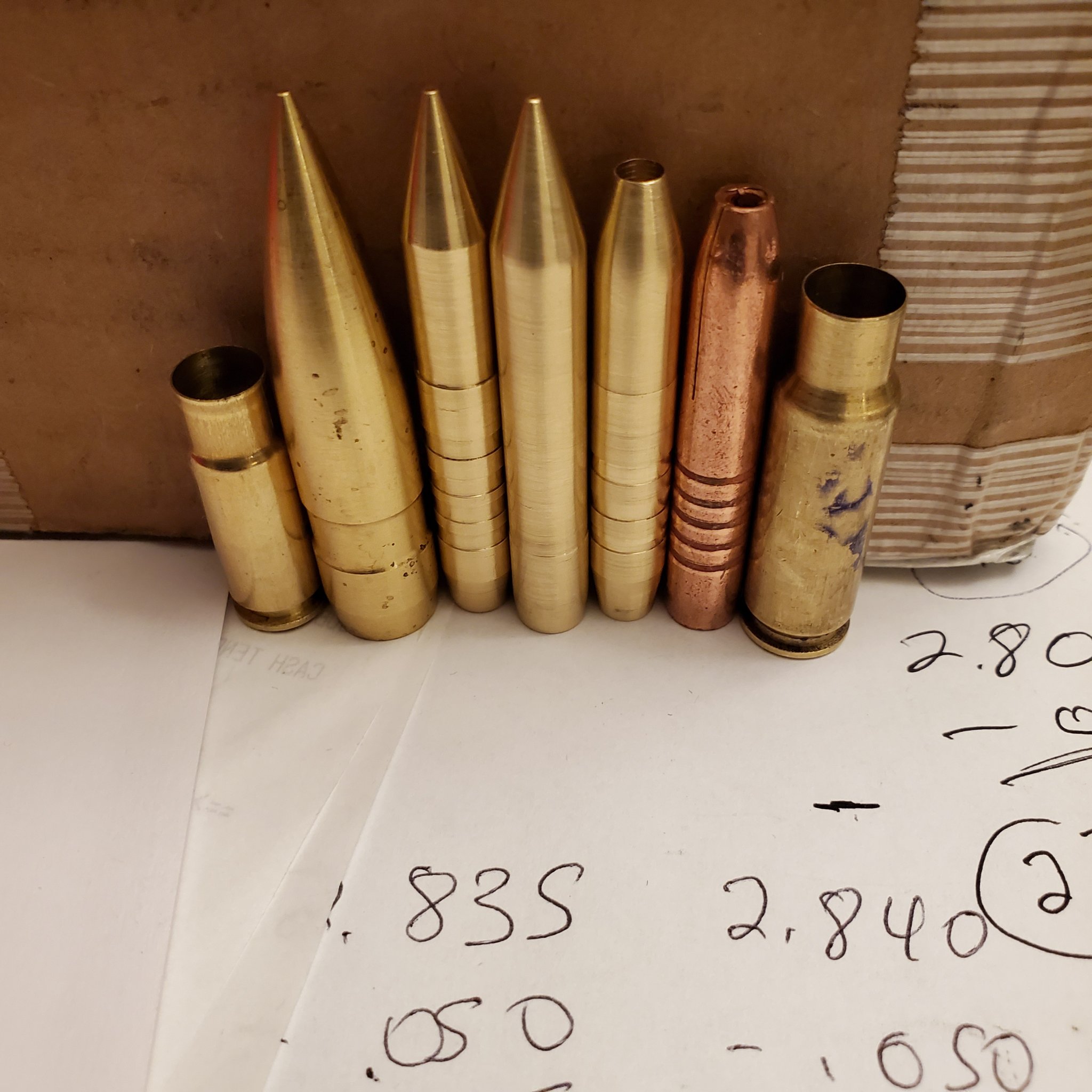

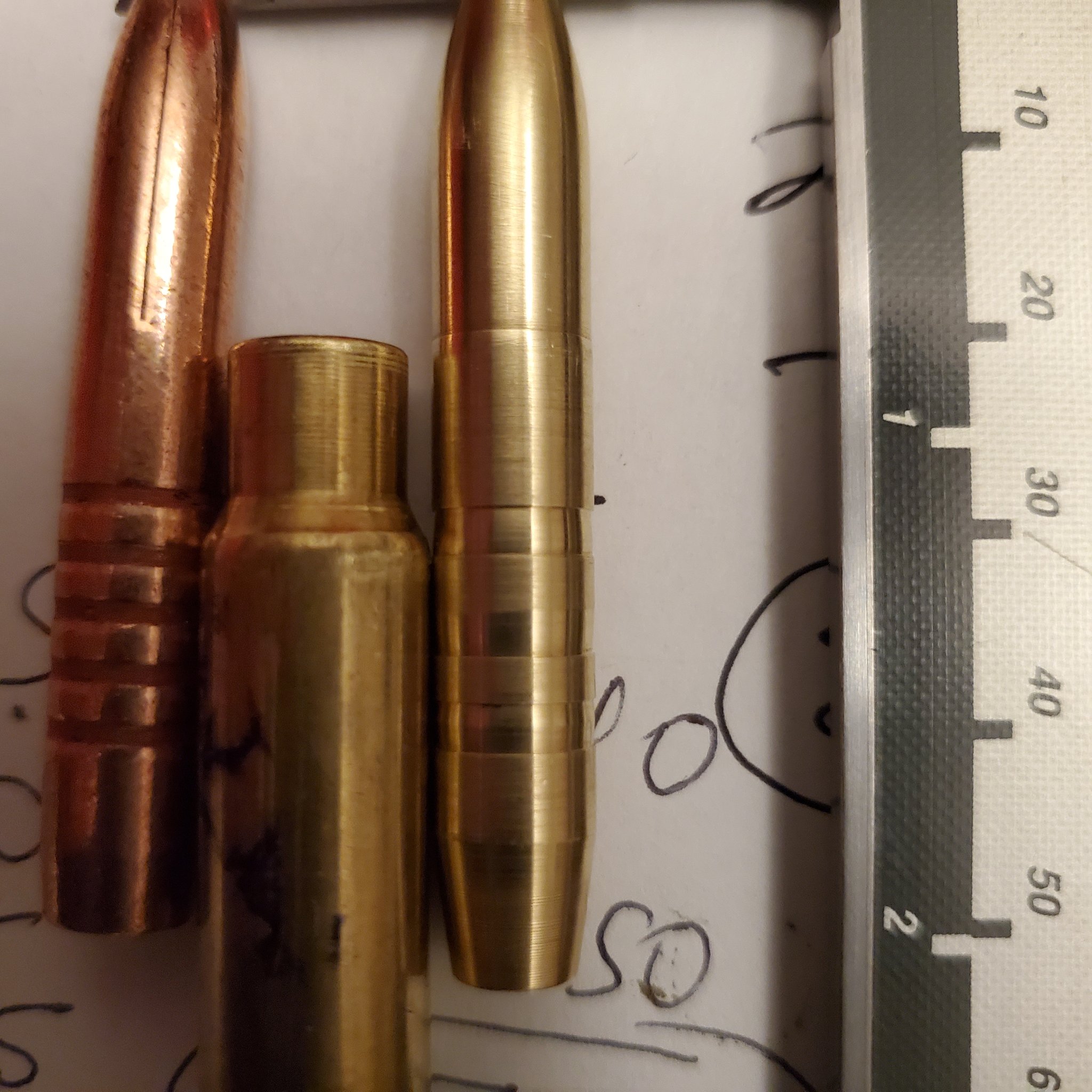

I could actually machine a 400 gr copper bullet to see how long it is and how much case capacity, one has with respect to overall length.
One would have to make a .330" bore rider and. 338" driving bands to keep the start pressure low enough with fast powders not to have an over pressure event.
But in the end I doubt it would influence killing power much, unless you're subsonic hunting elephants, and really need a lot of penetration.

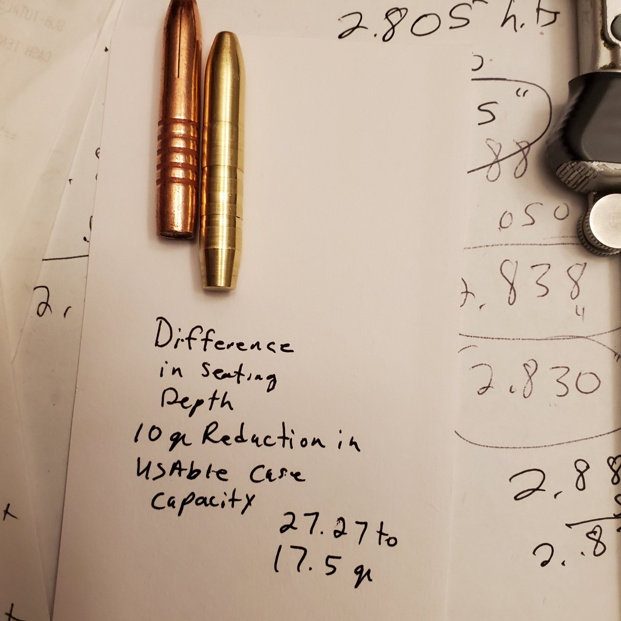

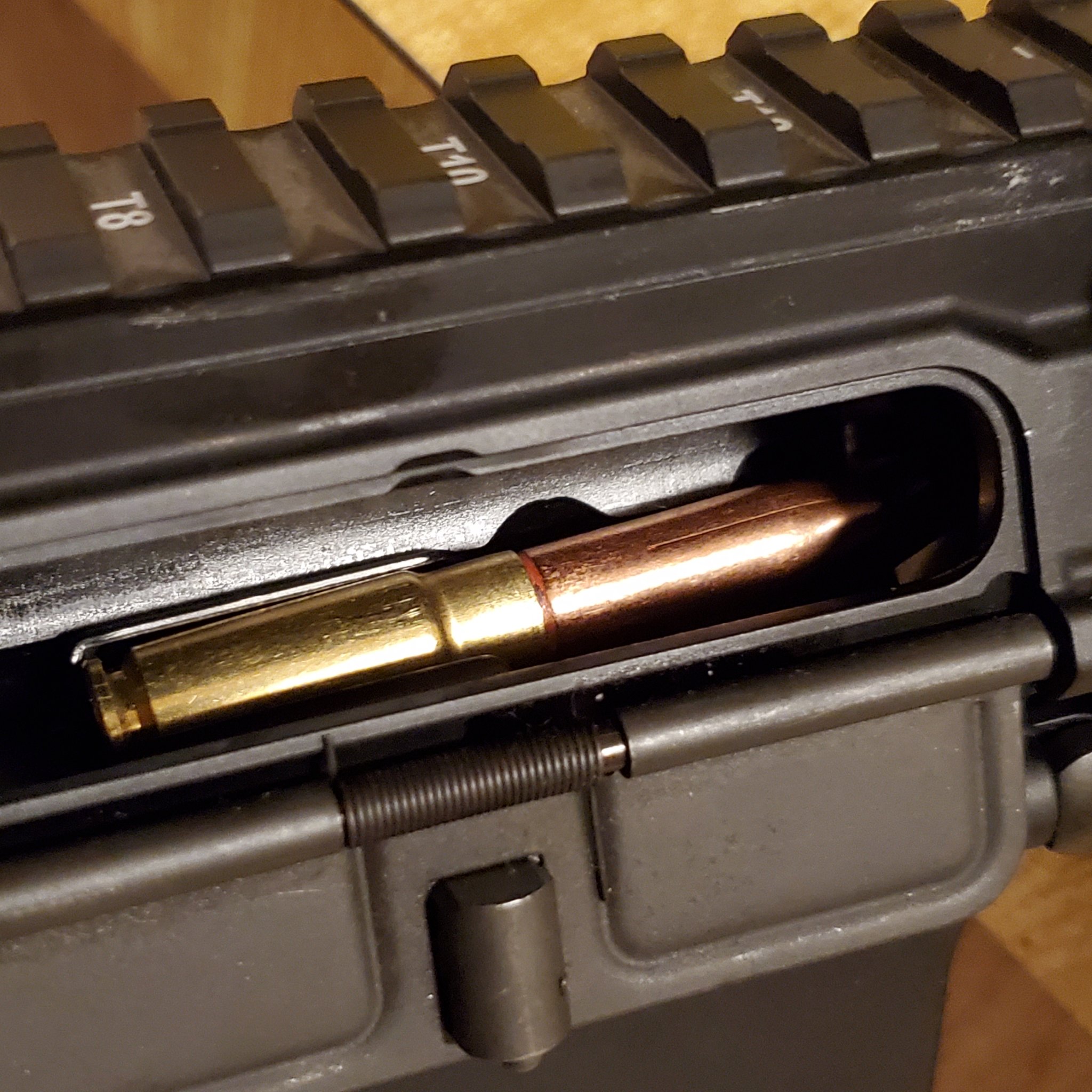

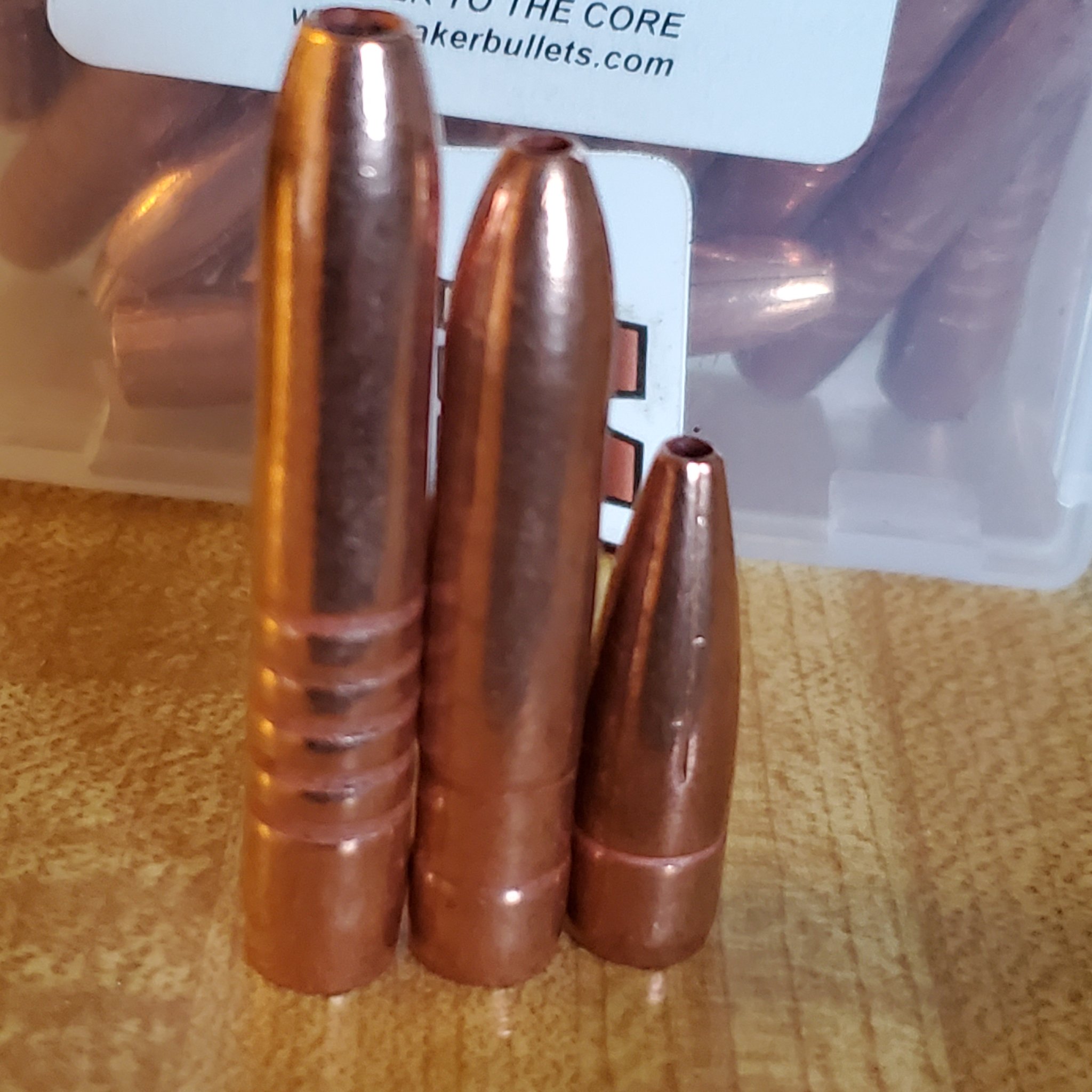

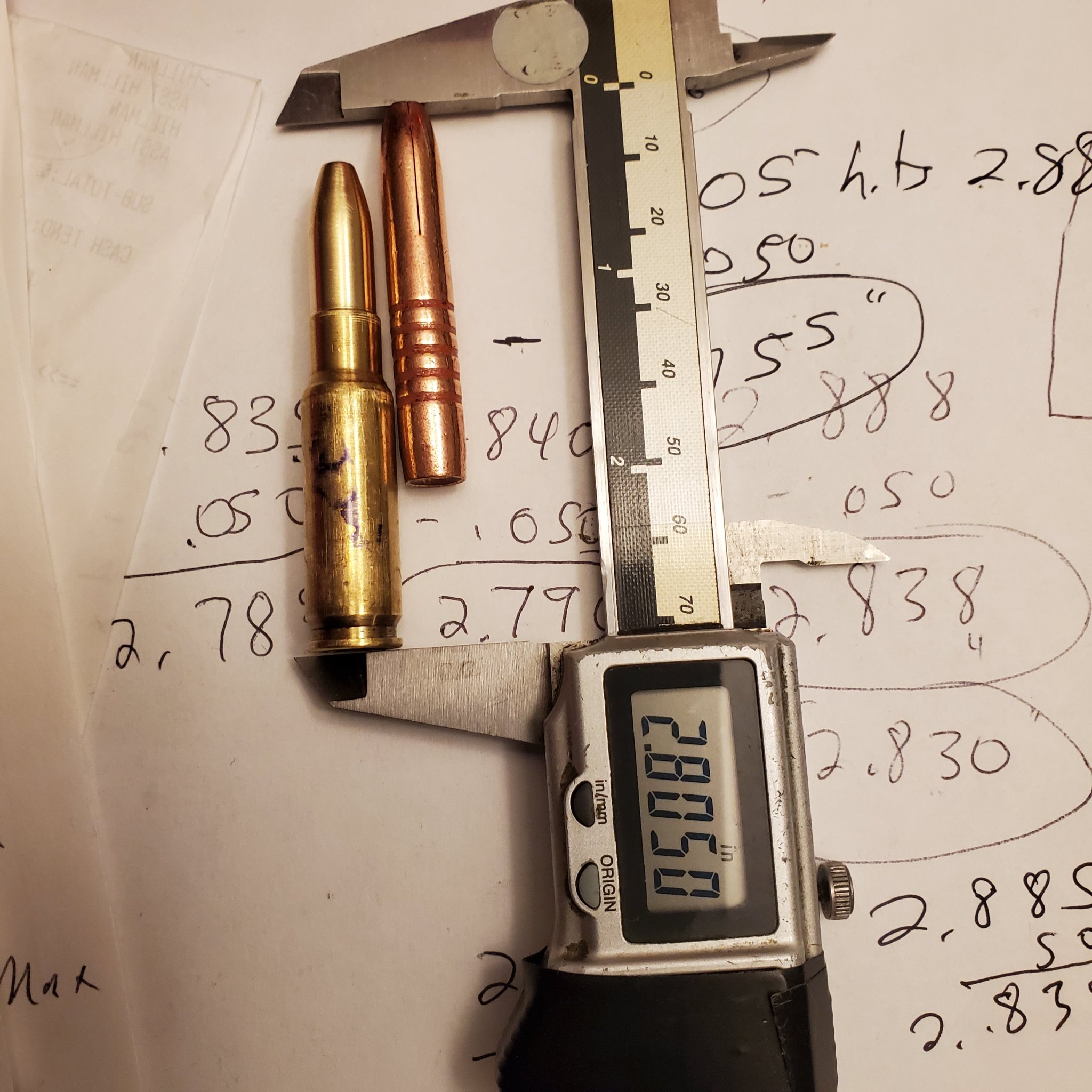

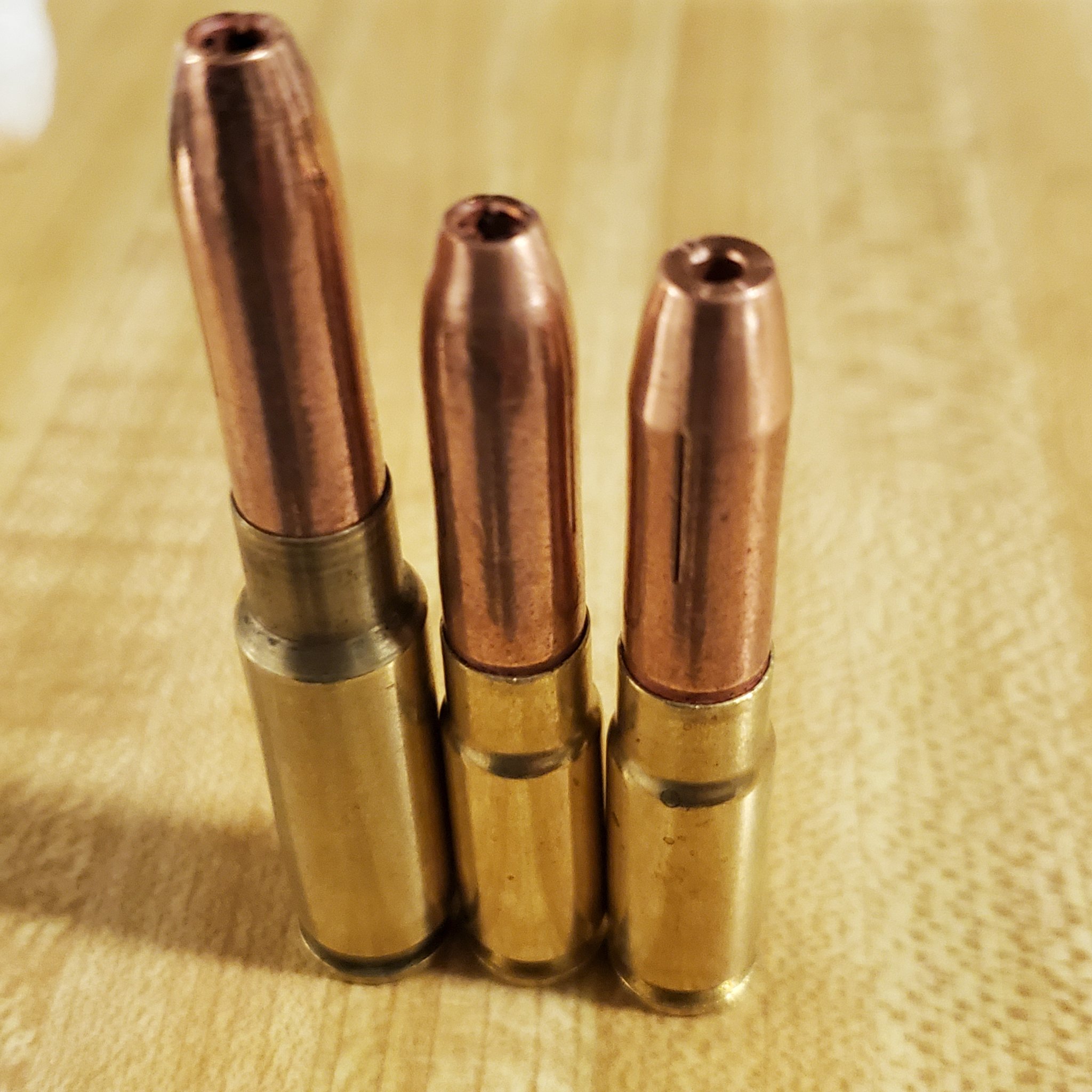

Here is a .338 350 gr un modified Maker in a 6.5 twist AR 15.
It's a bit much. But it will fit 5 in a cut out mag and fit in the mag well.
I could lathe cut 20 grs off the front of the bullet or so to make an easier fit.
But its a light weight package mainly for subs with good powder fill.
I will explore its full potential, but expect supers to be kind of wimpy...we'll see.

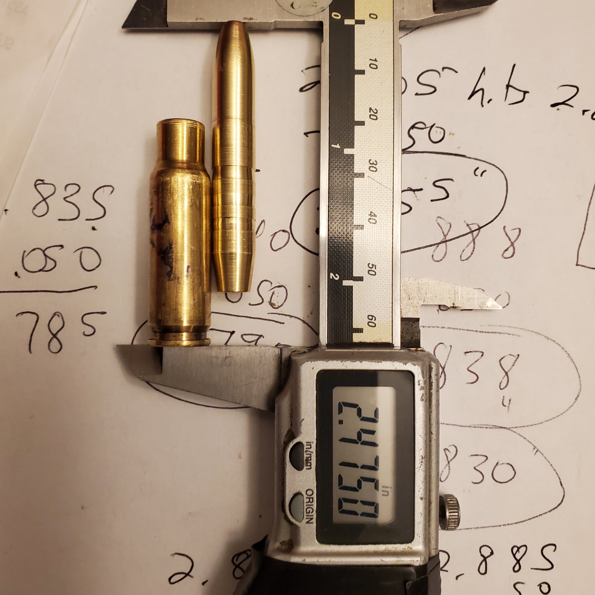

The 350 gr Maker weighed 346 gr out of the box others have been 347 gr.
So to easily fit the 346 gr maker to the AR 15 magazine I took of .055" off the point.
The results is 343 grs, only 3 grains of copper removed.
So if this works out in velocity...anyone who is interested in light AR 15 platform can actually have the same power as the 8.6 blackout in subs, with the 338 Spectre, with good case fill.

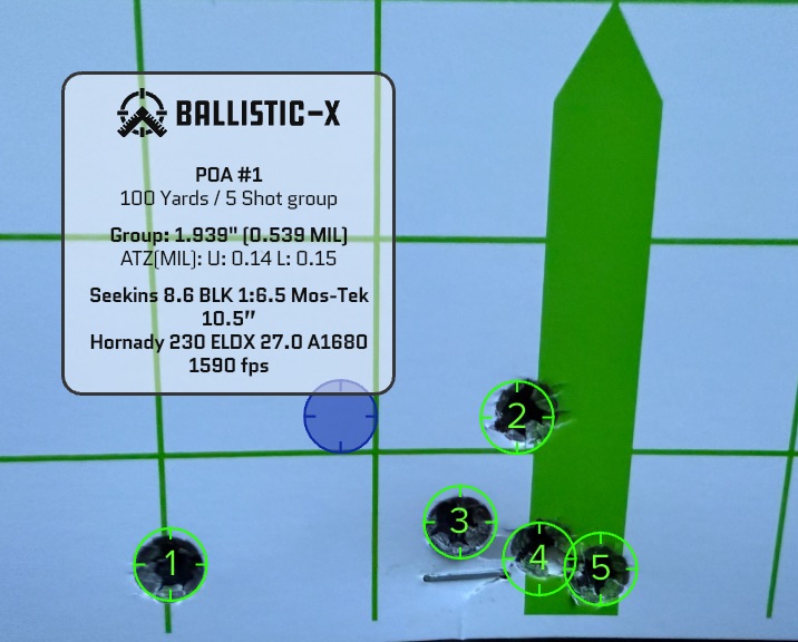

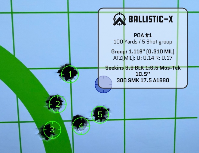

I tend to shoot the 300 gr Berger 15.8 gr IMR4198 and the 300 SMK 15.8 gr of AA 1680 for subs. With accurate results.
They hit low on the target cause it was sighted for supers , but this is 300 SMK sub load with 1680 in the 6.5 twist.
And a Red Dot load, at close to max pressure, so 865 fps is about all there is, and it's so slow small velocity variatons, make a big difference vertically on the target. but it's quiet,

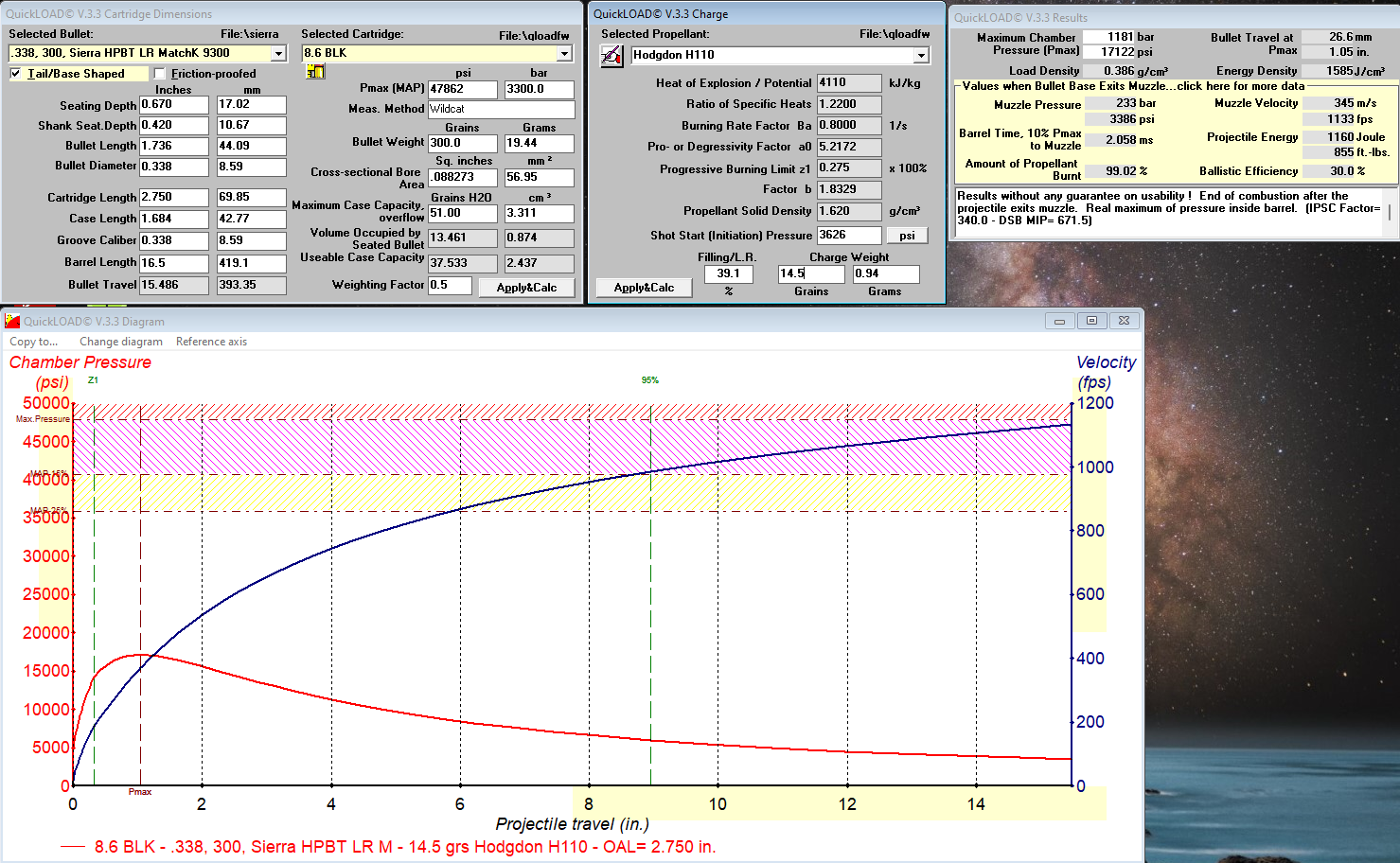

Can you give me the case pressure for these loads? Curious to know your thoughts on the quality of Starline brass also.
The pressure of these loads is low, but depends on factors like case capacity, which differs from the type of case used, 45.1 to 47.2 grs of water capacity, and overall length the bullet is seated to.
But for example one of my reformed cases is 45.1 gr of water, with the 15.8 gr of AA 1680, and 300 gr SMK loaded to 2.785"
The chamber pressure is only 18,015 psi.
The 300 gr Berger with 15.8 gr imr 4198, loaded to 2.820" has a chamber oressure of 19,697 psi. Again low pressure loads.

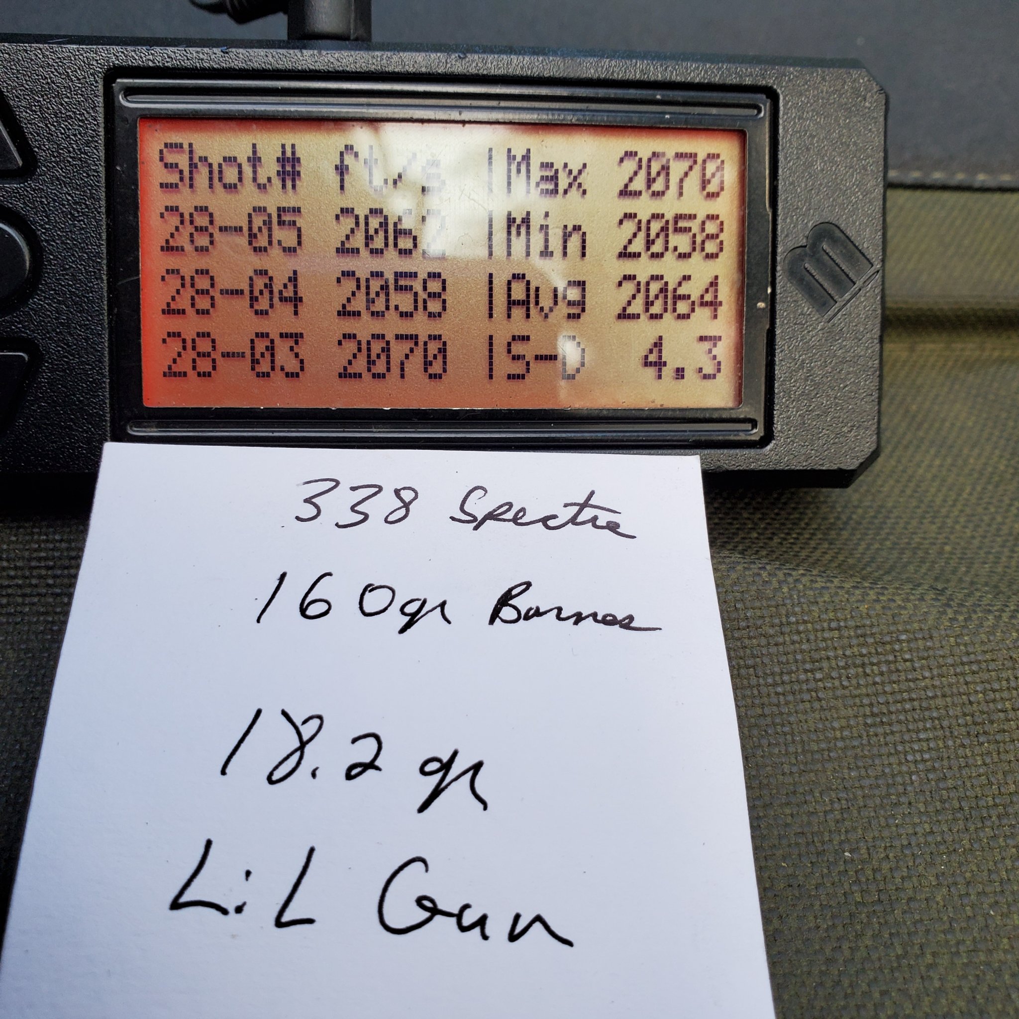

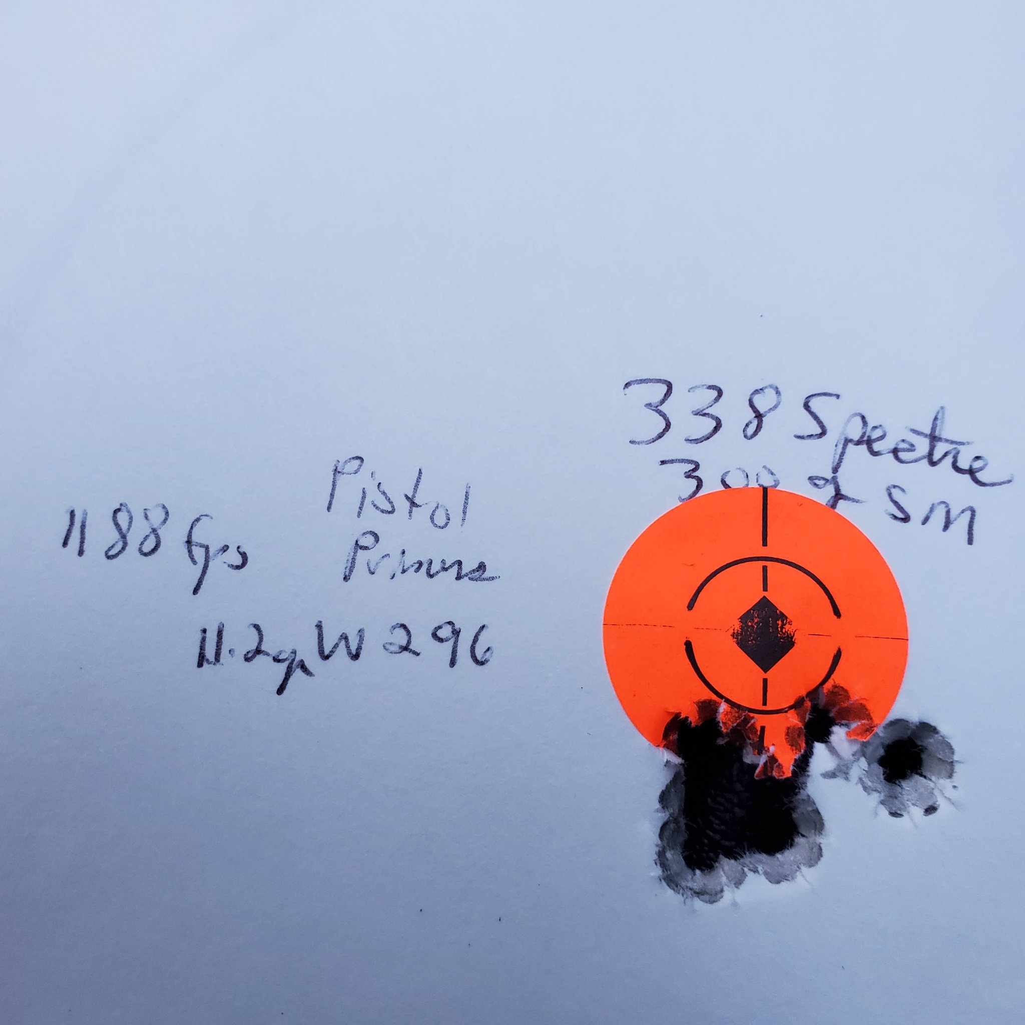

I'm shooting the 338 Spectre with 6.5 twist. Case fill and pressures are higher resulting in better to complete powder burning.
First time out accuracy was very good with a variety of bullets 160 Barnes to 350 Maker.
The 350 Maker is a maximum effort bullet for this case.
The 160 gr to 315 gr will be better for the average reloader to persue, and easily fit the AR 15 mag without a cutout.

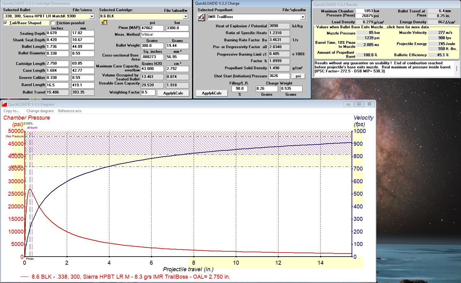

Also Your 47,862 MAP input pressure seems low, for supers and good brass I run 308 pressure since it's a 308 gun with shortened 308 brass...if you need more supersonic velocity, and the bullets can take the RPM of your twist rate.
What is the learning curve like for Quickload? Years ago I had software that was similar but a computer change and life contributed to me losing it. I have GRT but with the developer's passing I've hesitated to dive into it.
Also - By this weekend I should have my 8.6 bolt gun assembled. Solus short action. Preferred Barrel blanks barrel.
It’s a little bit of a learning curve. The YouTube videos do help. And the efforts of @45-90 and others have really helped as well! I got it and glad I did. After about 30-60min, I was comfortable enough to use it.
Reactions: Mike6158 and 45-90
Quickload is great and fairly easy to use but you really have to make sure your inputs are valid (garbage in, garbage out). A lot of the pressure calculation is based off the case capacity, the bullet (length, init pressure, etc) and the OAL vs the model so if those are wrong, for example if the case capacity is listed at 50 and your brass has 45gr of H20 and you have a load that's 59K Psi ... in real life you might be closer to 70K+. Same thing with temperature, powder compression, etc. Start low (or high in cases of subsonic) and do a sanity check with your chrono.
If quickload is showing you 1050 FPS and your first shot is 1400 FPS then stop immediately and look at your inputs. In my experience in a lot of subsonic load development, I usually aim for 1080-1100 FPS in Quickload and it gives me about 1020 FPS then I adjust charge or seating depth but I've never seen a > 125 FPS difference between the theory and the field - as long as your inputs are correct and barrel length as well.

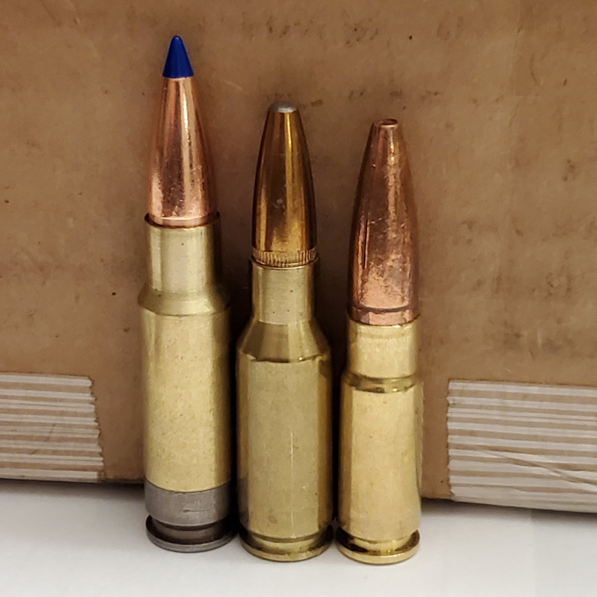

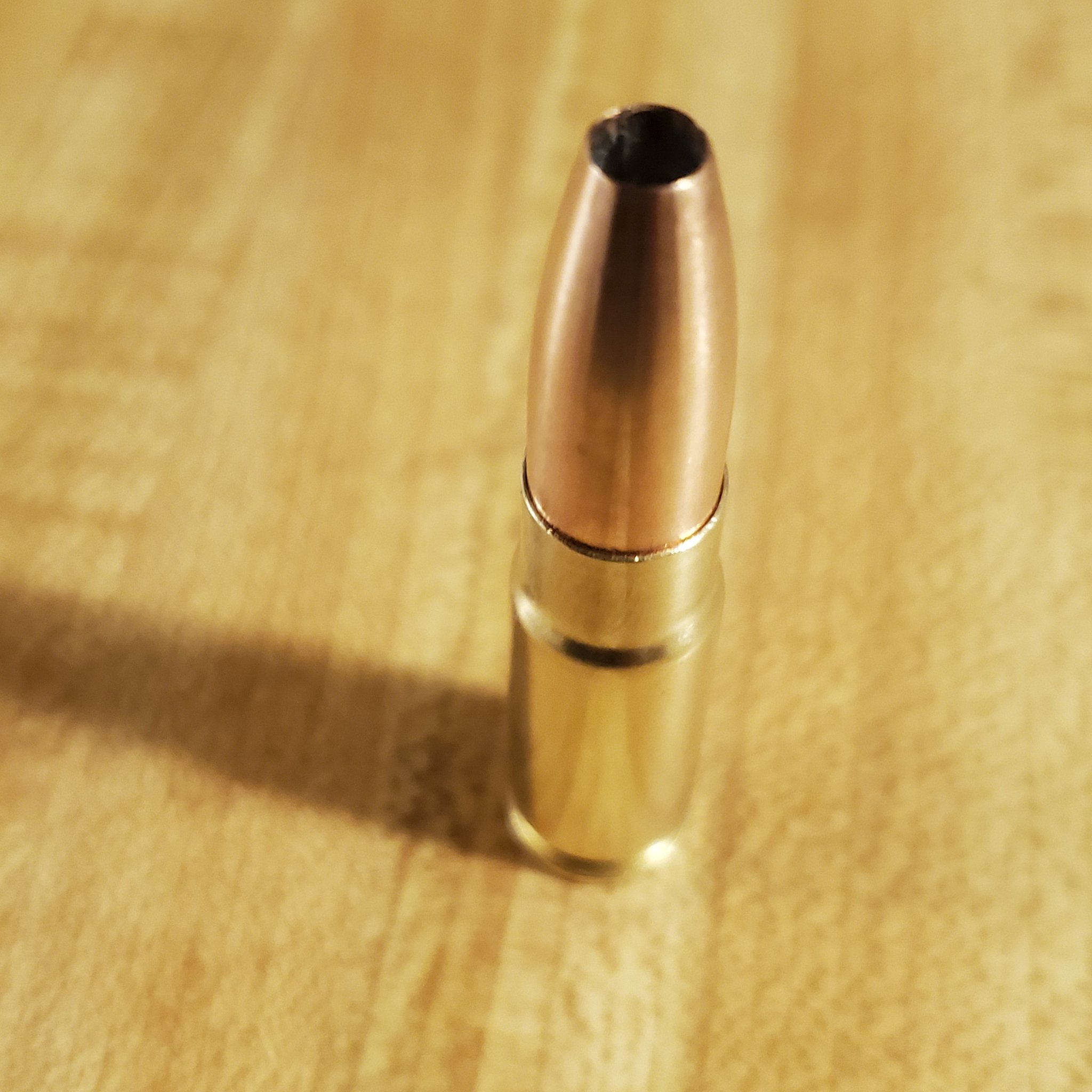

Just got some Maker bullets in today, to shoot for fun...I'm not hunting.
Pictured is the 350 gr for 3 twist, the 300 gr sub and 165 gr are for 6.5 twists.
The 165 gr is called an expanding super, notice the saw slits down the bullet, and built for 338 Spectre.
It could be of interest to 6.5 twist 8.6 shooters. I've hit 2800 fps with the Barnes 160 gr but this is made for lower velocity and could fit some short barreled super applications. Might get 26 to 2700 fps if it would stay together at higher speeds.
It seems to have a fairly large expansion velocity range (Not for 3 twist.) with 6.5 twist 2100 to 900 fps but that would definitely have to be confirmed before hunting with it.

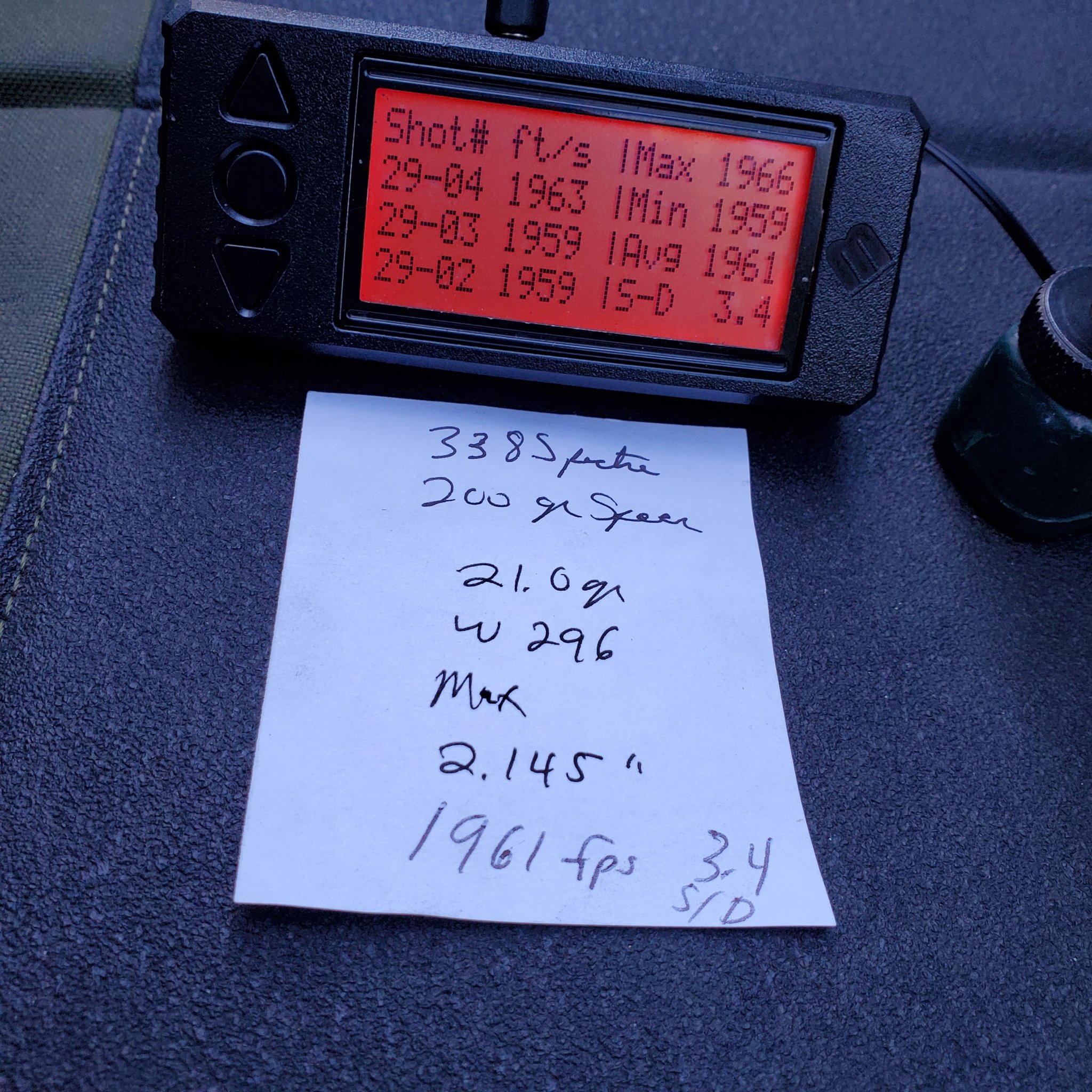

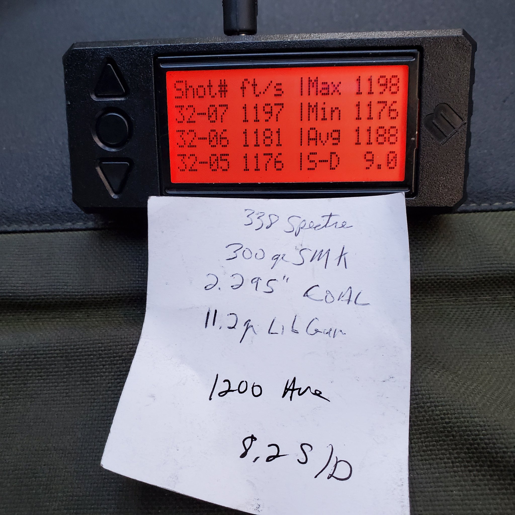

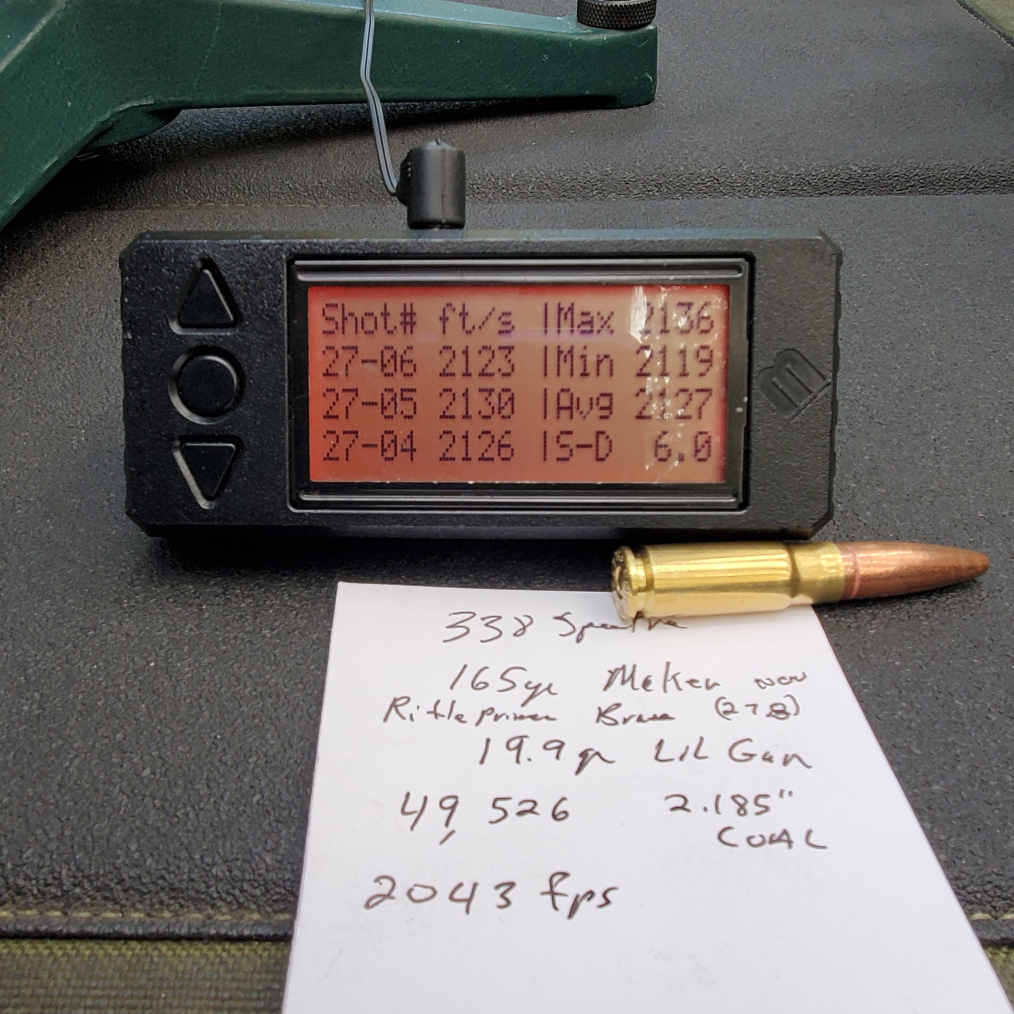

Went shooting the 338 Spectre today.
I'm getting to like this little cartridge.
All loads were dropped from a powder measure and loaded on a Dillon progressive, ...none were individual weighed out, except the first one to get the correct charge for each bullet.
Results every load is single diget S/D regardless of powder used.....except one load was 12 with home made bullets.
Accuracy was very good, as I am trying to shoot left handed, because the right eye has eyesight that went south...and it feels awkward
The 300 SMK load will go through one hole as 5 out of 7 did, but getting lefthand shooting down with an AR seems odd.
The 160 gr Barnes was a bit more accurate than the 165 Maker.
The 178 hp hit 2100 fps, so this and the 338 ARC are pretty much identical, but this has a 6.5 twist rather than an 8 twist.
Maker already has bullets made for 6.5 twist.
The smaller case capacity takes almost no effort to get single digit S/Ds, and very accurate loads. Every bullet exhibits accuracy, no bad groups all day. Three different powders.
Copper bullets, cheap Speer lead bullets, or Sierra match bullets, were all getting good groups.
It's a very efficient cartridge, better for subs than the 8.6 but lacking the supersonic power of the 8.6.
So each is a bit of compromise, IMO.
But for subs only and an AR 15 this little cartridge was way better than my early AR 10 in 3 twist, which wasn't accurate, with huge S/Ds , even supers were disappointing in the rough 3 twist barrel, with only copper.
The cheap lead 200 gr Speer can be run at 1960 fps in the Spectre but 1400 fps in the AR 10 3 twist these lead bullets tend to blow up, plus no accuracy.
Just my experience and why I like the 6.5 twist for both of these calibers.

Seekins SP10 Mos-Tek 1:6.5 10.5”
Garmin Xero
11/24/24
300 gr SMK HPBT (factory seconds)
A1680
Q brass x 2
BTO 2.0130
COL 1.6805
COAL 2.759
17.0 959, 1021, 1014, 989, 1009, 1011, 1004, 1021, 1010, 1003 stable
17.5 1063, 1040, 1051, 1059, 1029, 1035, 1029, 1050, 1032, 1063 stable

Hornady 230 ELD-X
A1680
Alpha LRP new
FGMM 210M
BTO 2.0170
COAL 2.7575
COL 1.6775
26.0 1574, 1528, 1516, 1528 NP
27.0 1581, 1591, 1596, 1582, 1591 SD 6 ES 16 1” NP
Garmin Xero

This barrel is crazy slow. I don't see N32C working with the 350 REX once I get them. Probably have to go with Alliant Green Dot or Blue Dot. What a shame, the SD/ES are really tight with N32c.
All one has to do is change the profile of the 350 gr Maker to reduce case capacity from 27.2 to 17.5 gr of H2O capacity.
Gets pressure up, fill ratio up, and most of the powder burned.
I made a 338 bullet from a 750 gr lathe turned 50BMG bullet.
Picture one the lathe turned bullet is longer than the Maker but seats a full neck length of the case deeper...where the .338" diameter begins, the forward is bore rider.
While the Maker is already in the smaller diameter where the saw cuts are...so it has to be seated out farther, to get to 338" bullet diameter, leaving too much powder space.
One can see the difference the backs off the bullets is where case capacity can be visualized....the 350 Maker is way down there.
Change the bullet design add a little weight and a few more relief cuts, and it would improve the performance of the 8.6 Blkout subs, and have plenty of room for supers.
I wasted some good 50BMG bullets to mess with bullet ideas for these .338 sub cartridges. Even a long skinny bore rider so one could shoot it at higher velocity, single load down the barrel.
It gave me something to do...

It’s a mixed bag. Some it’s spot-on from the start, others take some massaging of values. What I tend to do with a new cartridge I haven’t shot yet is compare QL values vs a series of published data. Understanding that the published data can be pretty conservative, you can usually tweak the case capacity and powder Burn Rate / Heat to make it match the book or get it at least closer.
But just remember that QL isn’t ground truth - it’s just a simulator designed to give you roughly ballpark results. Don’t count on it to be very accurate until you tune it with your own data.
Reactions: Mike6158
Yes QL is only a ball part guess.
Always use published data.
First use published data to compare, you need their exact data they used.
Many reloading manuals do not give you enough data. Like case volume, of brand used.
Then use their data on one specific powder, their case capacity, bullet lenth, bullet construction input, barrel length.
Put in the max powder charge listed say 30 gr produces 52,000 psi their manual max like from Hodgdon data.
Add their data to QL adjust the powder "burn rate factor" just a little at a time to match the 52,000 psi...
Powders are blended and do not burn exactly the same from lot to lot, plus they do not burn the same from cartridge to cartridge...but the case volume, bullet length for a specific bullet and case capacity are relatively close to the same as is your barrel length.
Do not change factors that are known to be true.
Check QL velocity with manual velocity.
It should be pretty close.
Using the same data and burn rate factor change bullets in the same case, and change bullet weight and lenght if actual bullet used.
Type in manual max charge with manual stated bullet ....QL and manual will be close.
Repeat this several times, and get close comparison with the manual and this powder.
Then when a heavier bullet not listed is used and all the correct physical data input for that cartridge and case, Only.
You might, just might, have a starting point for your new heavy bullet, if you reduce the powder charge and actually shoot it ...and check actual velocity against predicted velocity....look for pressure signs.
I like QL and use it where nothing is printed on wildcats.
It can be a useful tool or garbage...the more you use it and understand its purpose as just a guide to help you from blowing your face off. Common sense still prevails, if you don't think the recommended powder charge is correct, or especially dangerous do not use it.
