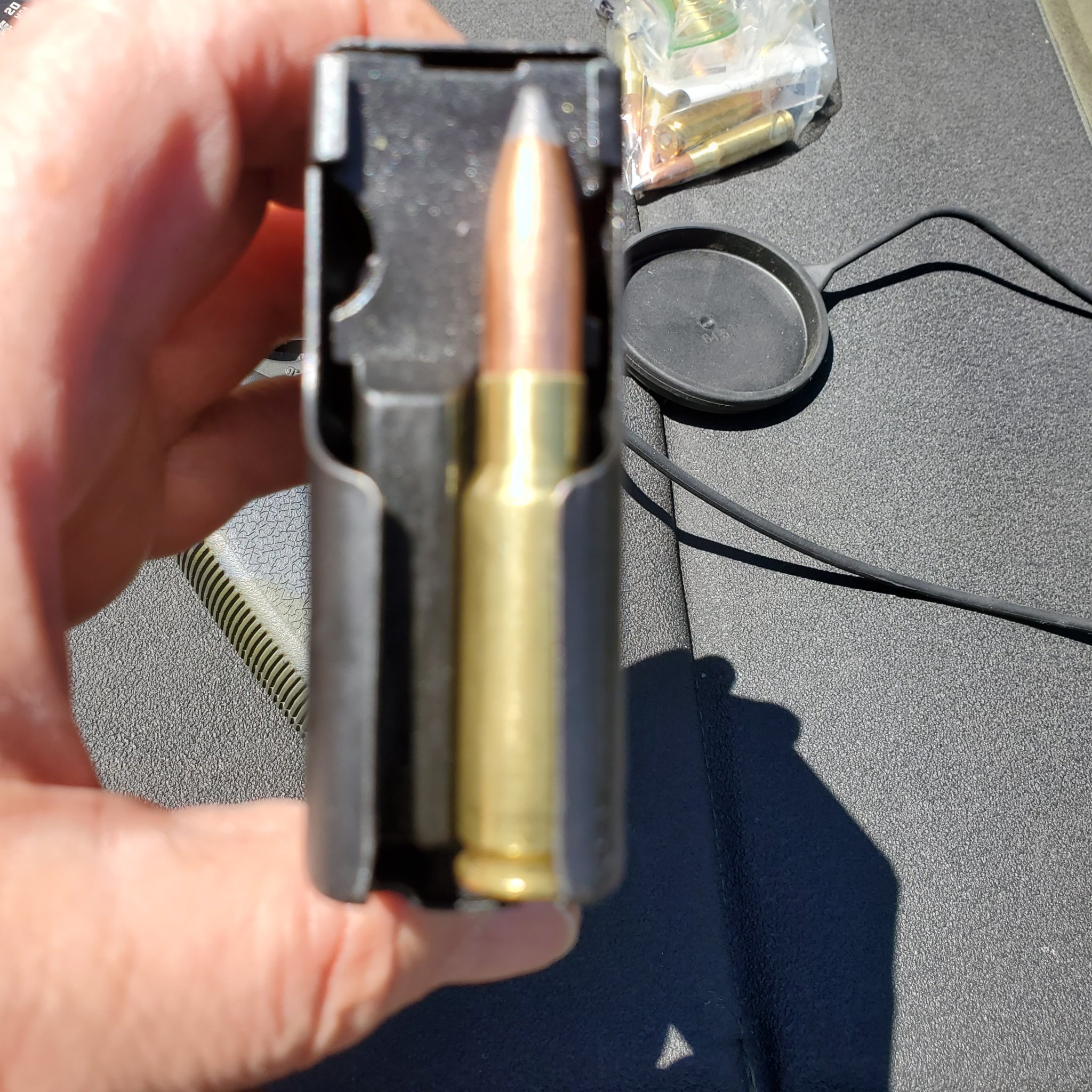

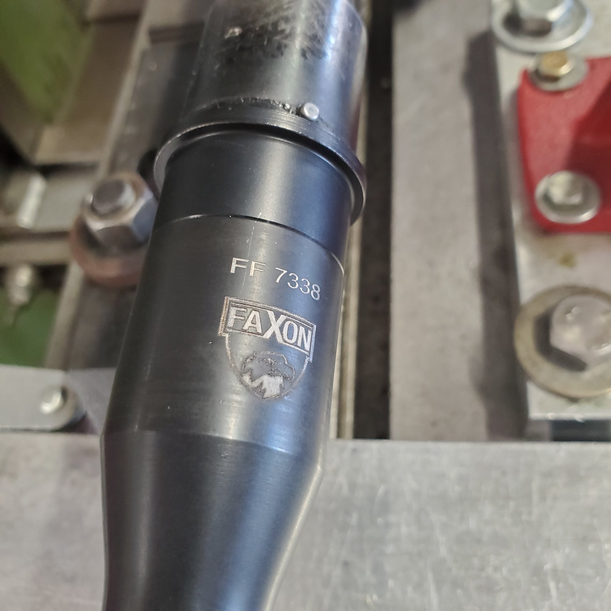

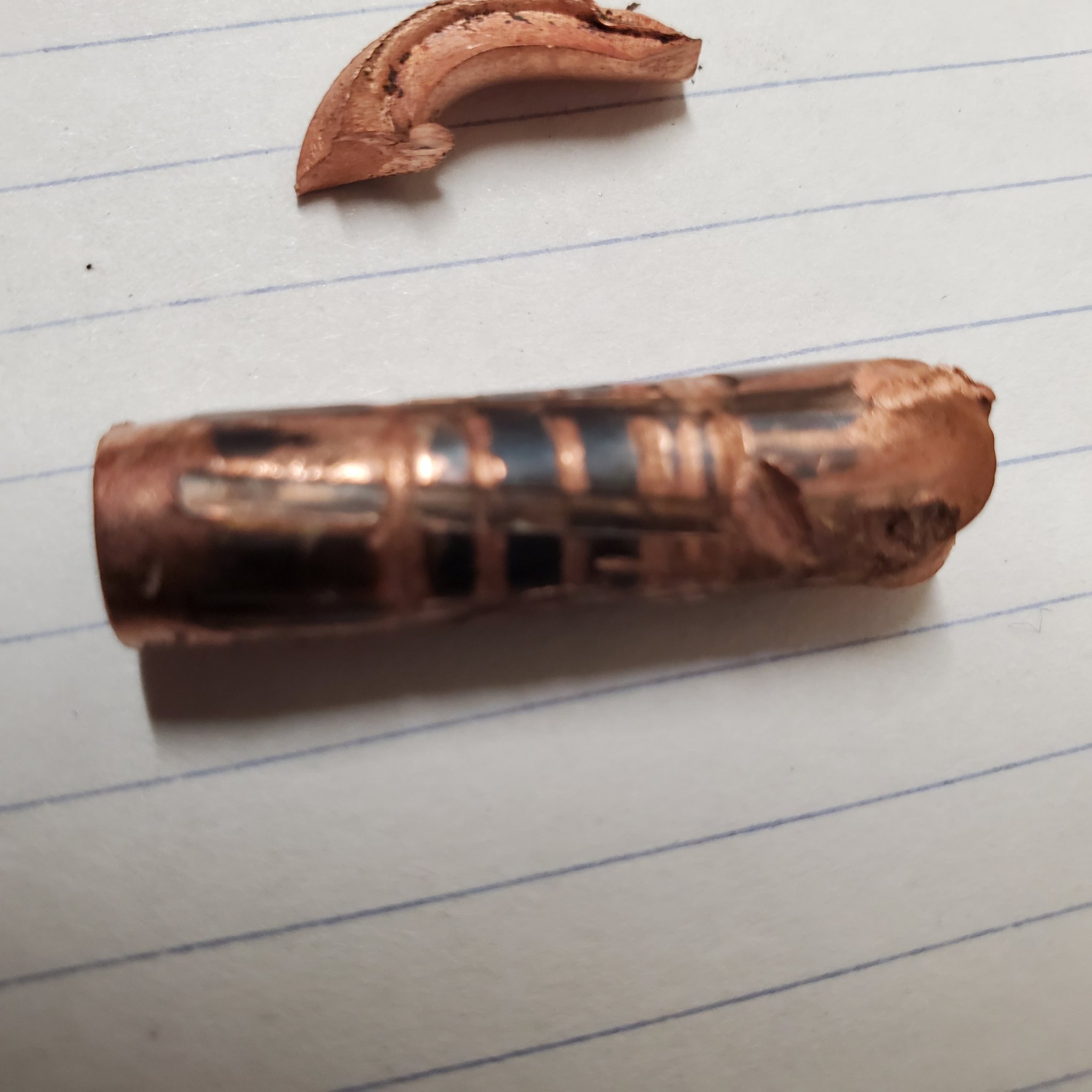

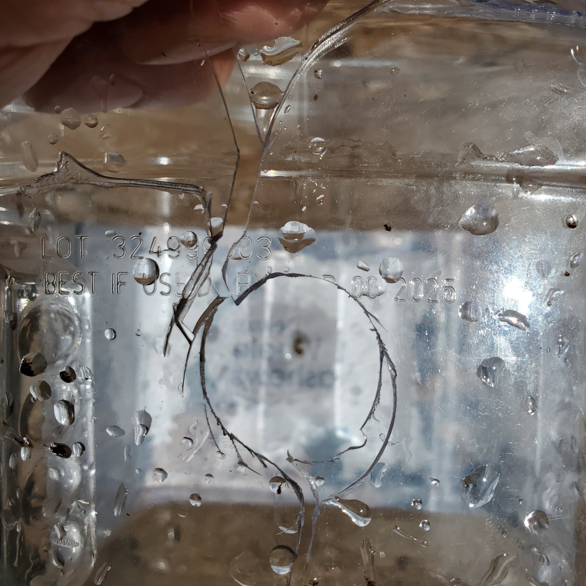

So I completed a test with 6.5 Twist and 350 Maker bullets.
They do indeed open up in the 6.5 twist. But it may be delayed a bit when compared to the 3 twist.
You can adjust the velocity up to 1600 fps to get some real power, with the muzzle device attached and good accurscy, in the 6.5 twist....not limited to 1050 fps as in the 3 twist.

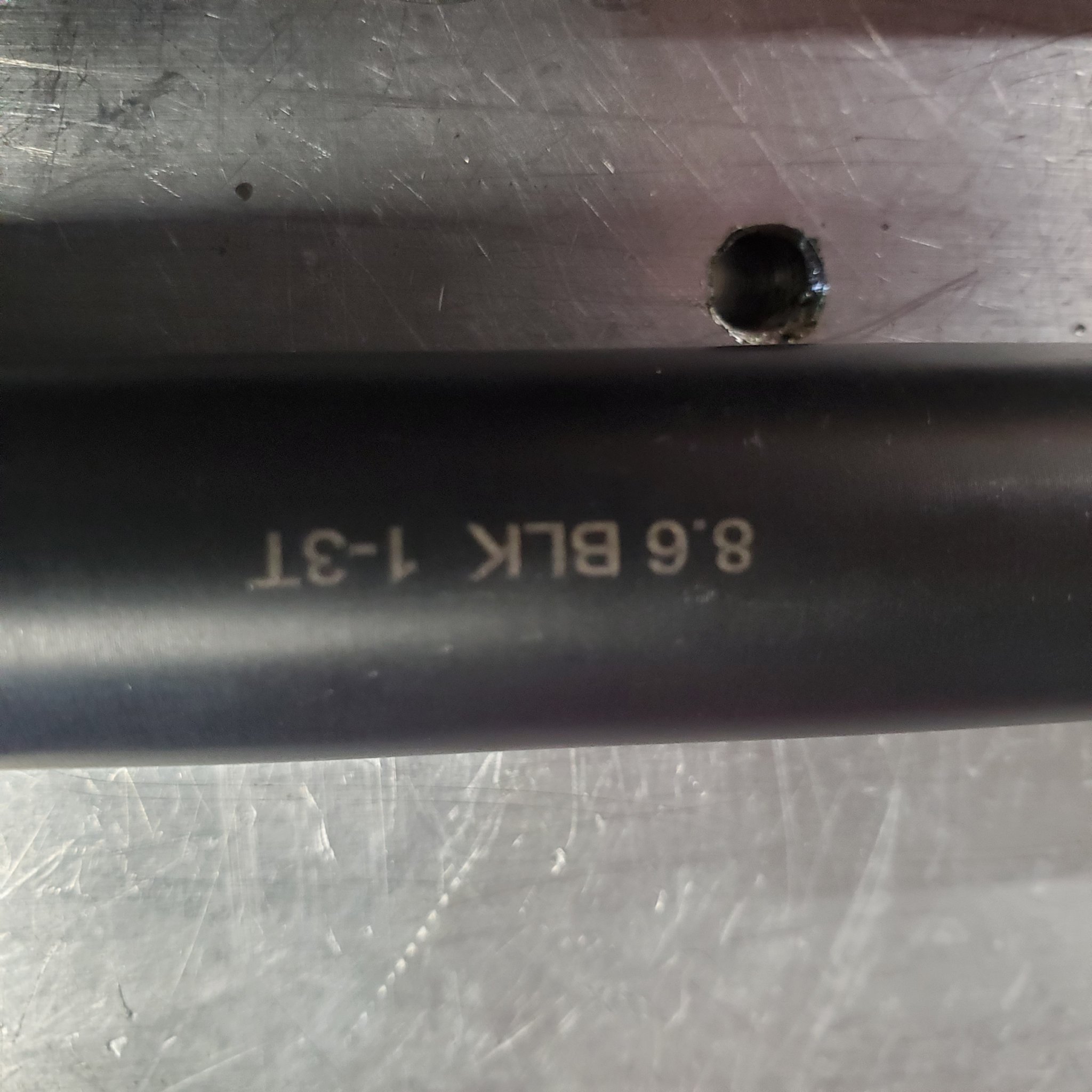

Accuracy, the 3 twist is horrible...group sizes were 3 and 1/3 times larger with the 3 twist with the 350 gr Maker. Some even greater, like 6 and 1/2 times larger!
Reminded me why I gave up on the Faxon rough barreled 3 twist. It just as waste of ammo.
I enjoyed the AR platform, but will do no more shooting with this barrel.

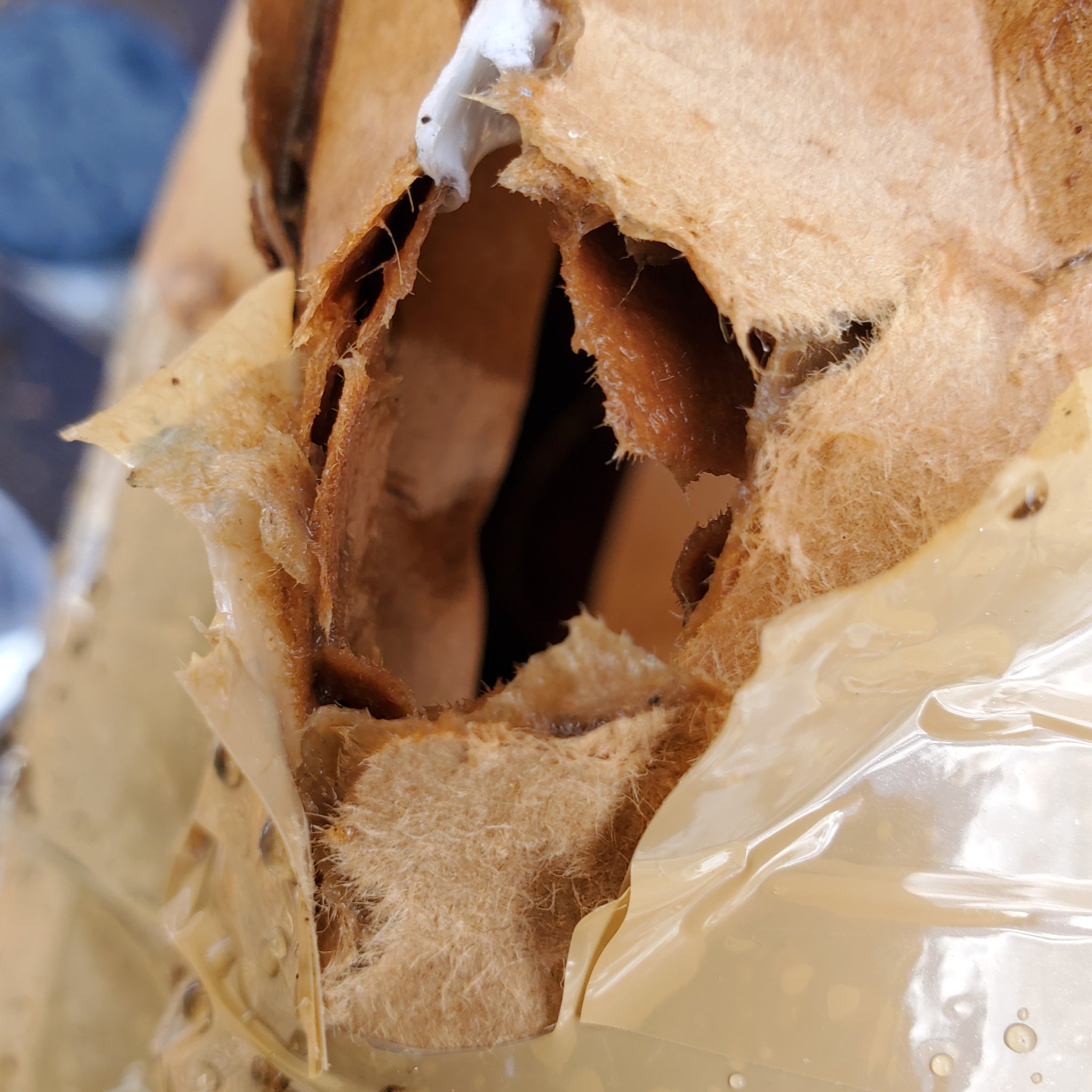

The 6.5 twist and 350 gr Makerl...looking through the back, as the bullet expanded in this jug of water.
Exit wound in wet paper shows expanded bullet with petals still present.
These 350 Maker were not caught in full bloom. They open up and had a huge cavity in a burned log, then lose the petals and penetrate for ever,.. it seems. Stopped it with armor plate, glanced off the plate, and dug into the ground. Took a shovel to find it.
How fast they open is adjustabe by velocity to only 1050 fps with the 3 twist. But do not open at around 750 or maybe 800 fps depending on medium impacted. Steel would be different, gravel was different...so it depends...
I'm only testing these and do not plan to hunt with the 8.6 Blackout.
The performance varies, and is somewhat adjustable, but it's a close range bullet as the velocity changes the performance changes.
So if ya find a velocity and range it works good in, on the animal you hunt, keep your range limited.
Not that it won't kill if it doesn't expand, but works a lot better if it does.
I bought 5 boxes of these 350 Maker bullets and fired almost 2 boxes on testing. Is it a good hunting bullet? Who knows? I haven't killed anything with it.
But it will penetrate, after the petals break off...
And the accuracy of the Faxon 3 twist ...if ya aim at a hogs head and hit him in the lower jaw at 70 yds...that is about my accuracy with the Faxon 3 twist barrel, so expanding won't kill him....but the 6.5 twist will put the bullet very close to where you aim, 350 Maker, or almost any other, in subsonic mode, plus you have excellent supersonic capabilities with any lead bullet guaranteed to dump a hog, economically.
After today the Faxon 3 twist is definitely retired...I have better things to do, than waste ammo, with this horribly inaccurate barrel.
But if you love your 3 twist, keep on using it. Other brands might be a bit more accurate.

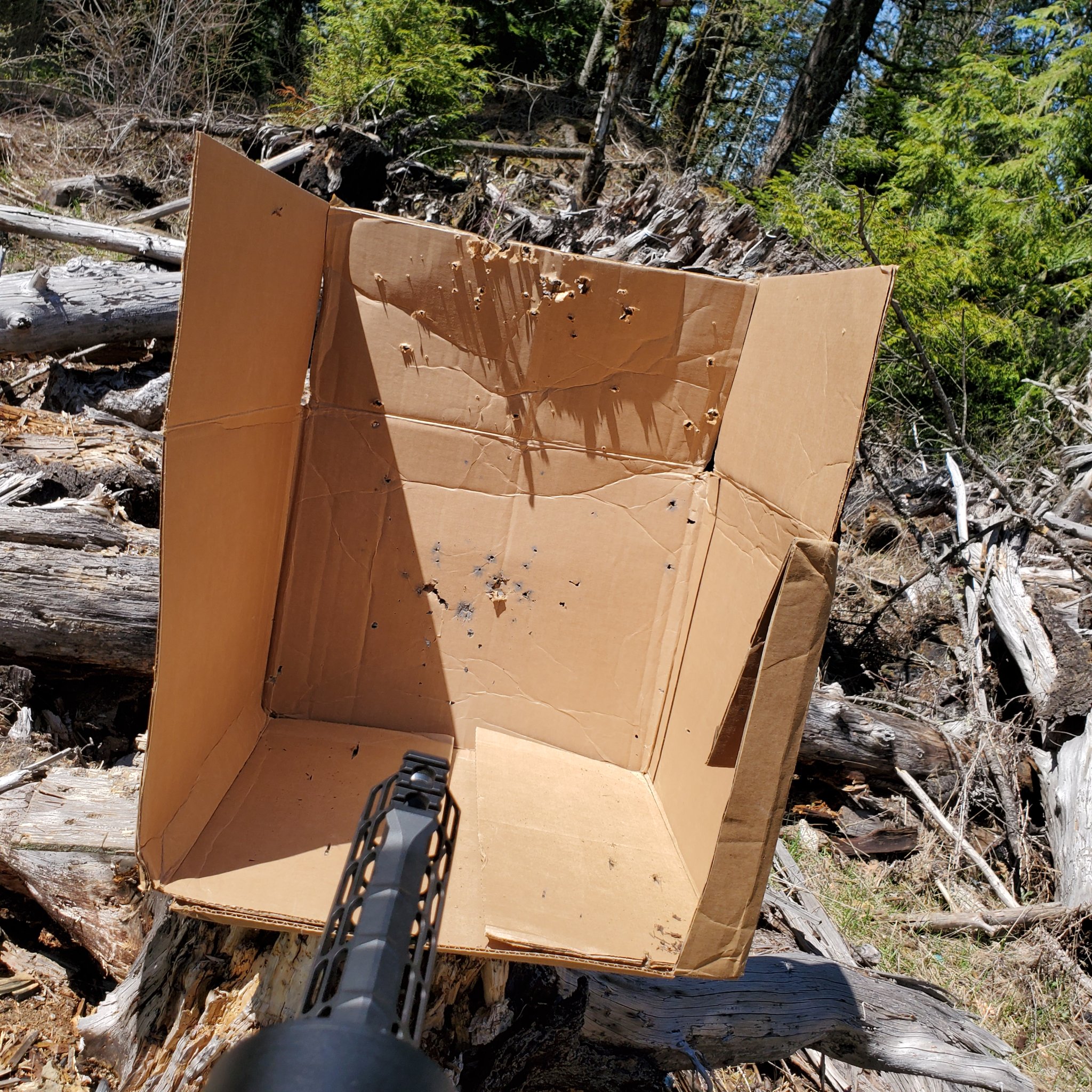

I did extensive tests on the 3 twist....
Here is an example:

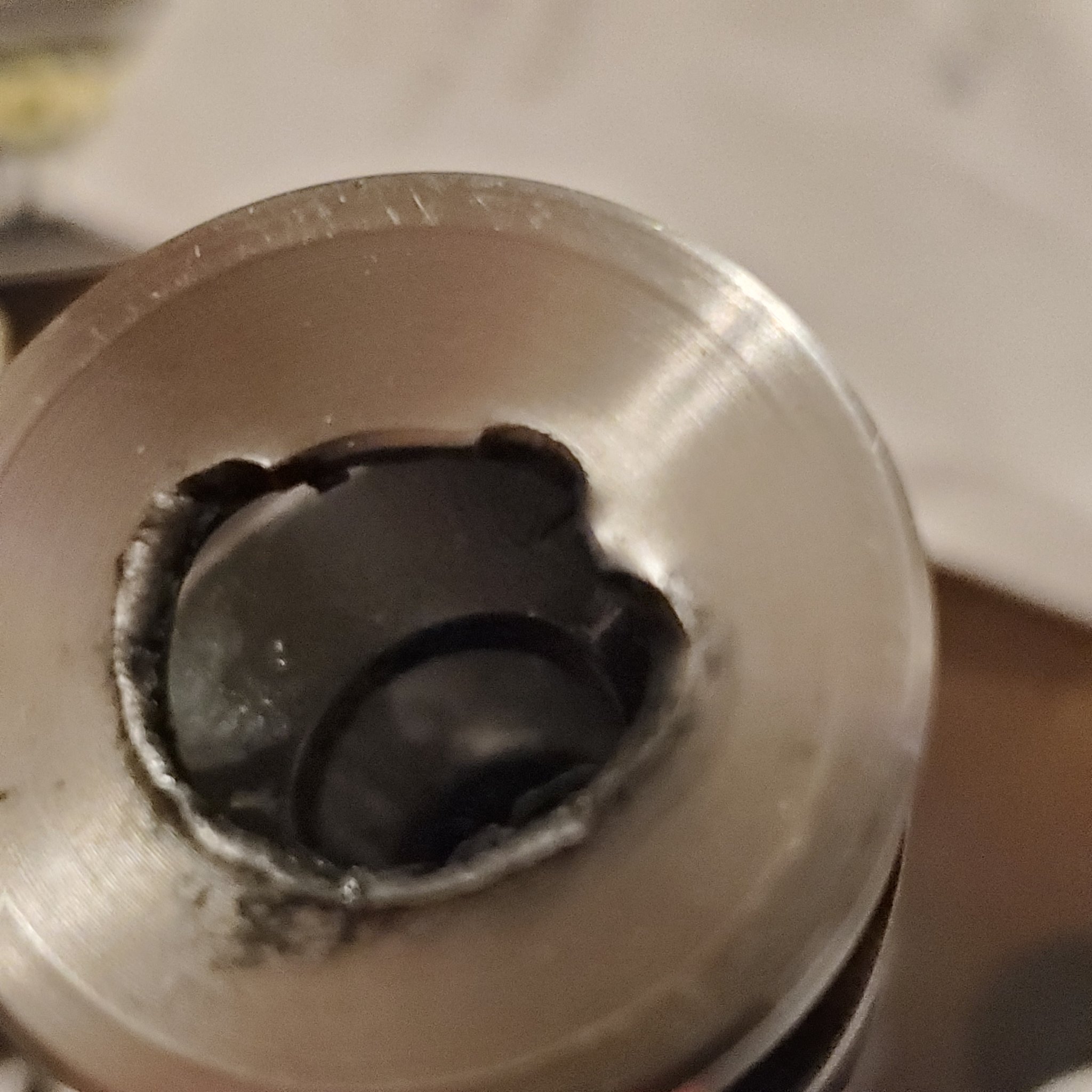

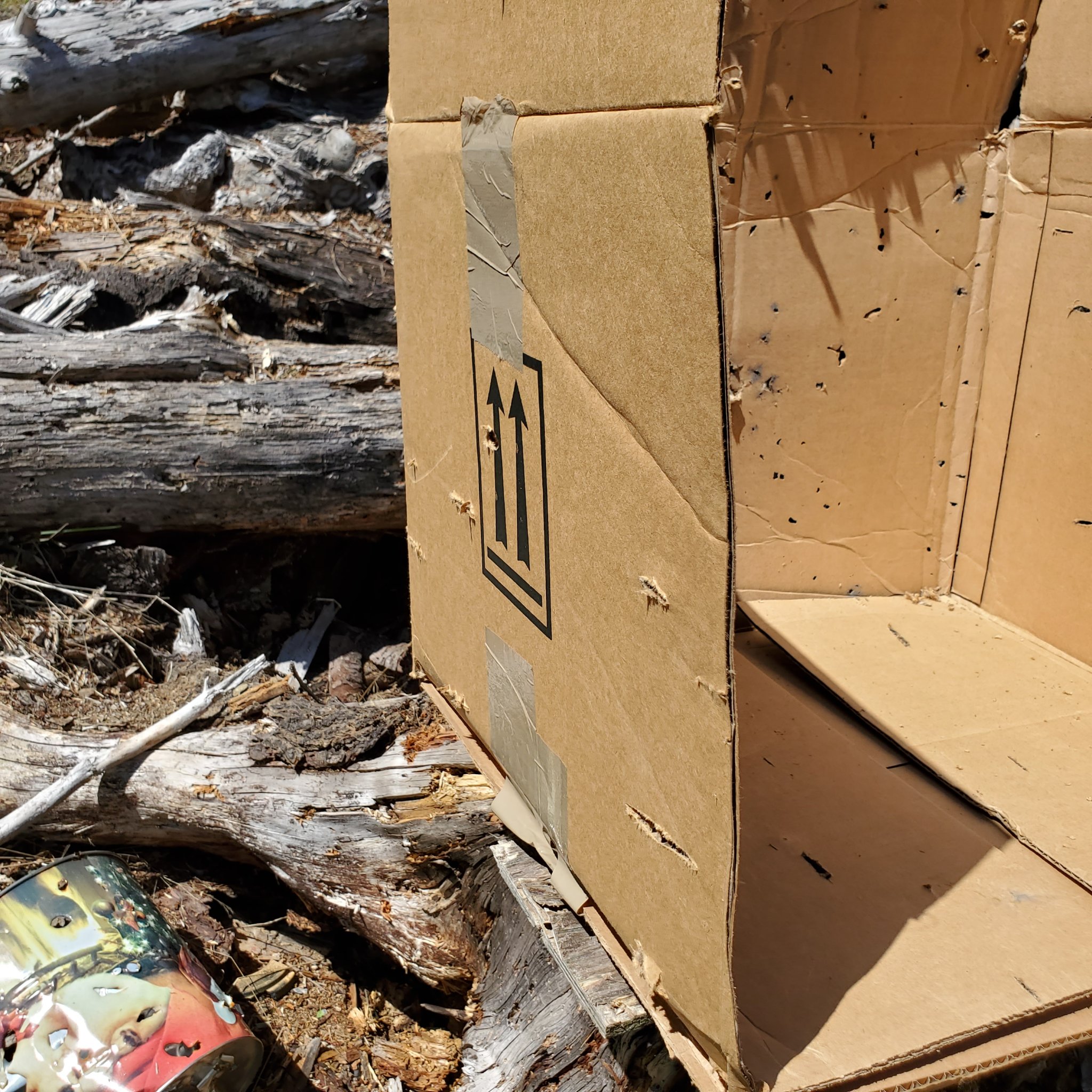

My 16" faxon 3 twist one of their recommended loads that to months to get removed from their site.
A lead supersonic 225 gr bullet out of a 3 twist...will not kill a rabbit at 10 yards!
Notice the muzzle has no muzzle device, (I learned the hard way) and it's fired 2 feet from the opening of a large box.
The bullet comes completely apart as soon as it leaves the confines of the barrel.
Bullet fragments covering the top bottom and sides of the big box.
Back up to 8 feet and the outside of the box is hit with bullet shrapnel, jacket and lead pieces.
The air is full of lead dust....difficult and dangerous to breathe.
I fired 5 or 6 in rapid sucession in the dirt at 10 feet, and the air was poisonous, had to back off.
The 3 twist can be very dangerous.
I did these experiments so you don't have to. Do not have anyone beside you if you decide to try this as some fragments exit at 90° and will injure a person next to you. If you leave a muzzle brake on, the bullet fragments and break fragments can come back at you.
I experience that on the first Faxon recommended lead load...I was lucky it only cased a few hundred dollars in damage, destroyed the break and magnetospeed bayonet.
Be safe get a chronograph, keep velocities in the 1050 fps range and test without a muzzle device...or have some stainless steel break pieces, and deflected bullet fragments, come back to your face and chest.
It will be a WTF moment...

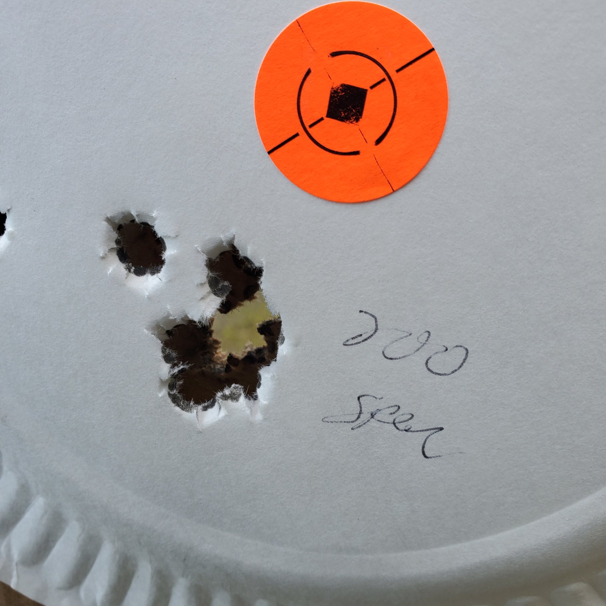

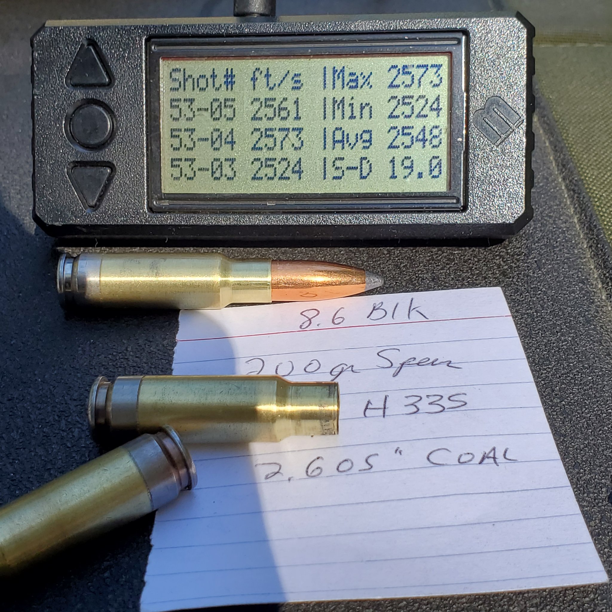

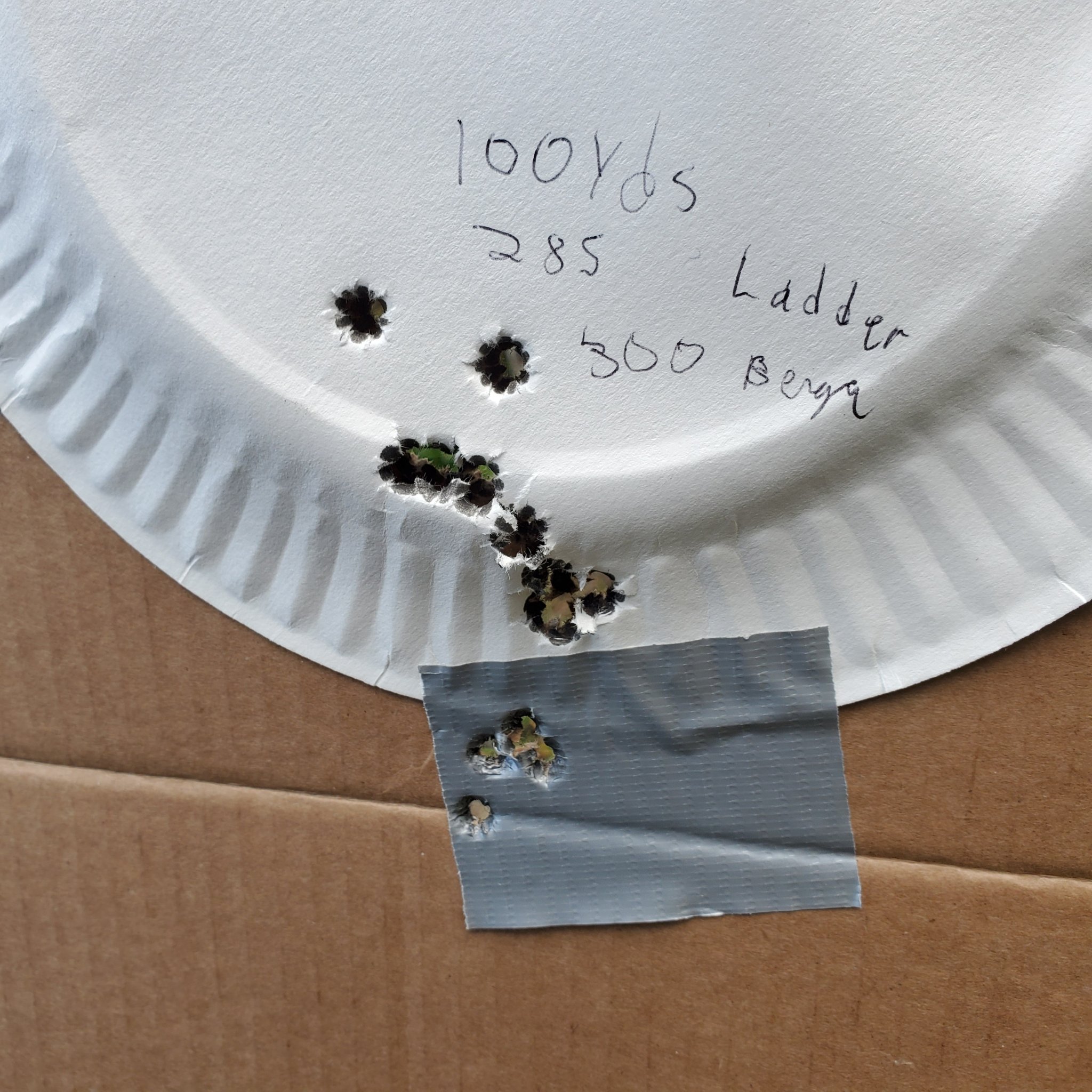

Now take the same bullet but 200 gr instead of 225 gr put it in a bolt gun 6.5 twist with a long barrel...and ya have a dual purpose cartridge.
Cheap 200 gr Speer over 2500 fps... with accuracy.
Or a one hundred yard ladder test with 285 ELDM, And 300 gr match bullets one same target...you can see the bullets grouping together as the velocity increases.
Cause one can go heavy super loads with out fear of bullet blow up, huge gains in bullet energy are available 2850 ft/lbs with the 200 gr Speer on sale for 30 cents, or 2790 ft/lbs for the 160 Barnes, or 2590 ft/lbs for the 300 gr Berger, and 2200 ft/lbs for the 350 Maker...
Take the 300 Berger to 1000 yds 1244 fps remaining velocity with 1032 ft/bs. Drop 53.8 MOA wind 72 inches of drift in a 10 mph cross wind ...that's doable.
I only harp on this for safety for those who like their 3 twist...and there's another option to consider, a slower twist...with the 6.5 twist, giving the option of a real dual purpose cartridge. This is just my journey with the 8.6 Blackout, all it's problems and what I consider a solution to them.

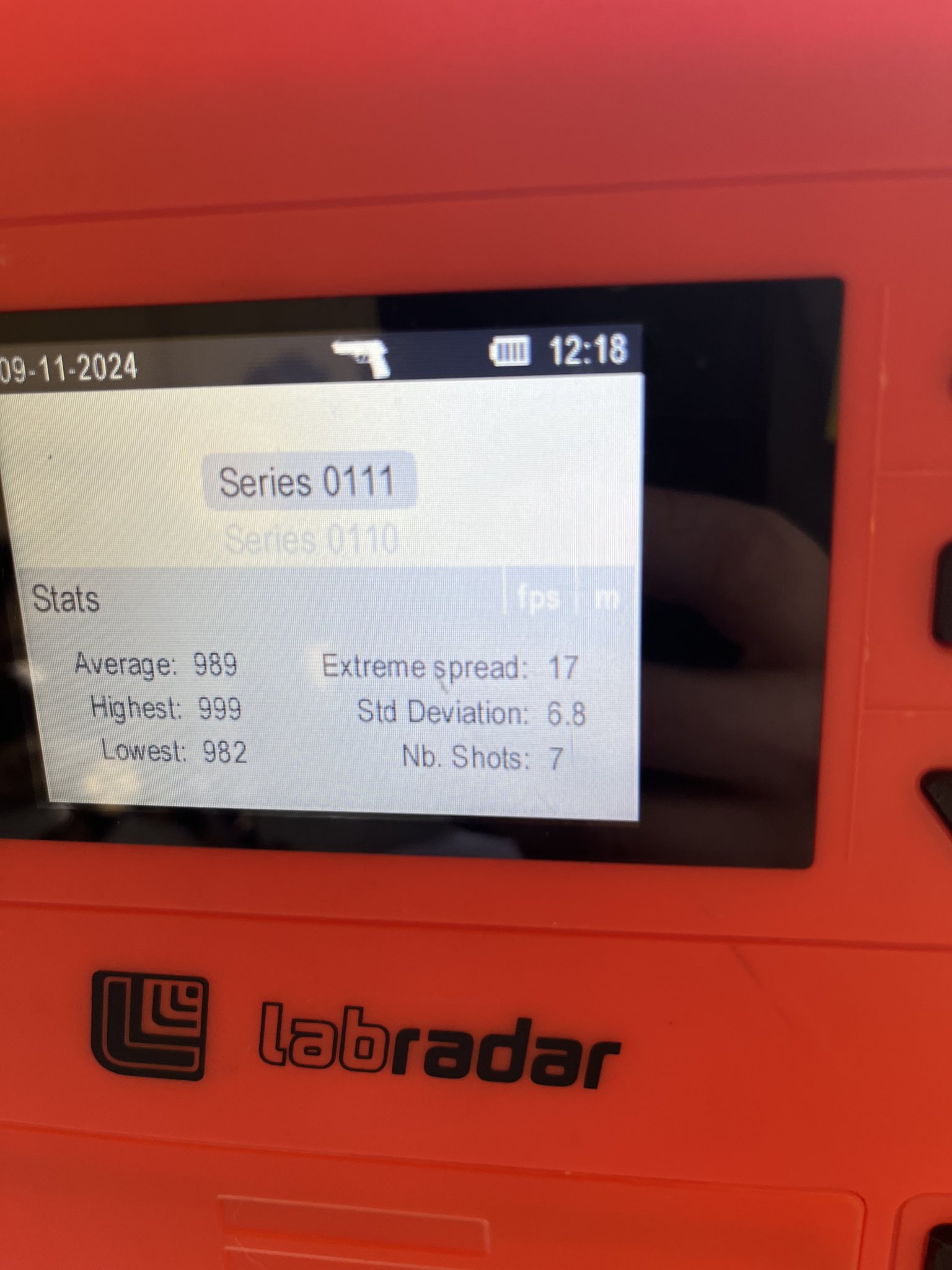

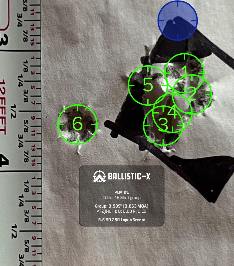

Couldn’t group yesterday because the second round on paper squibed. Went back today and shot a 6 round group. First three rounds stacked pretty close together. The following 3 opened up slightly with the 6th being a possible flyer, ckye pod feet slipped on concrete bench top. With the flyer the group is just under 1.5 MOA. Without it, it’s .8 MOA. I was able to pick up 10 shots (yesterday’s shots and todays) from the load which was 11 grains of Lil Gun, BR4s, converted alpha 6 GT brass and 250 grain lapua scenars seated at 2.7” COAL. Average MV was 979 fps with a SD of 11.9. I feel a lot more confident in this barrel as far as accuracy and consistency goes than the 1:3 so far. Being able to break subsonic without damaging equipment or worse is nice too.
As for the squibs, I had a few more today. When chambering the cartridge I felt some resistance. Fired and nothing happened. Same thing I experienced yesterday with none of the powder being burnt. Popped out the round which is getting lodged where the lands start. The following squib, once I felt more resistance than normal I pulled the bolt back before even trying to lock the bolt down. The round still got lodged. After cleaning Lil Gun out of the chamber and barrel for the second time I called it. All sized brass, neck wall thicknesses and loaded cartridges get checked with a gauge and are within spec. This happened only with the scenars and not with 350 grain makers. Neck tension is set to .002” under for all cartridges. I haven’t measured distance to the lands in the 6.5 barrel. Once I figure out the cause I’ll give an update.
Update:
I measured distance to the lands and CBTO on the handloads. I got a difference of .017”. It seems the lands are closer in the 6.5 twist barrel than pre-fits from Q. I believe seating the bullet deeper will remedy the stuck bullets. CBTO on hand loads with 350 grain makers are under the measurement to the lands.
Reactions: Mike6158
I sat the scenars to 1.99” CBTO and this fixed my squib issue. The lands were pulling the bullets when locking the bolt. No pressure and no ignition. The Mos-Tek barrel has a shorter distance to the lands. I’m very happy with the barrel. Group is under 1” and MV is really consistent. Distance was 100m.
