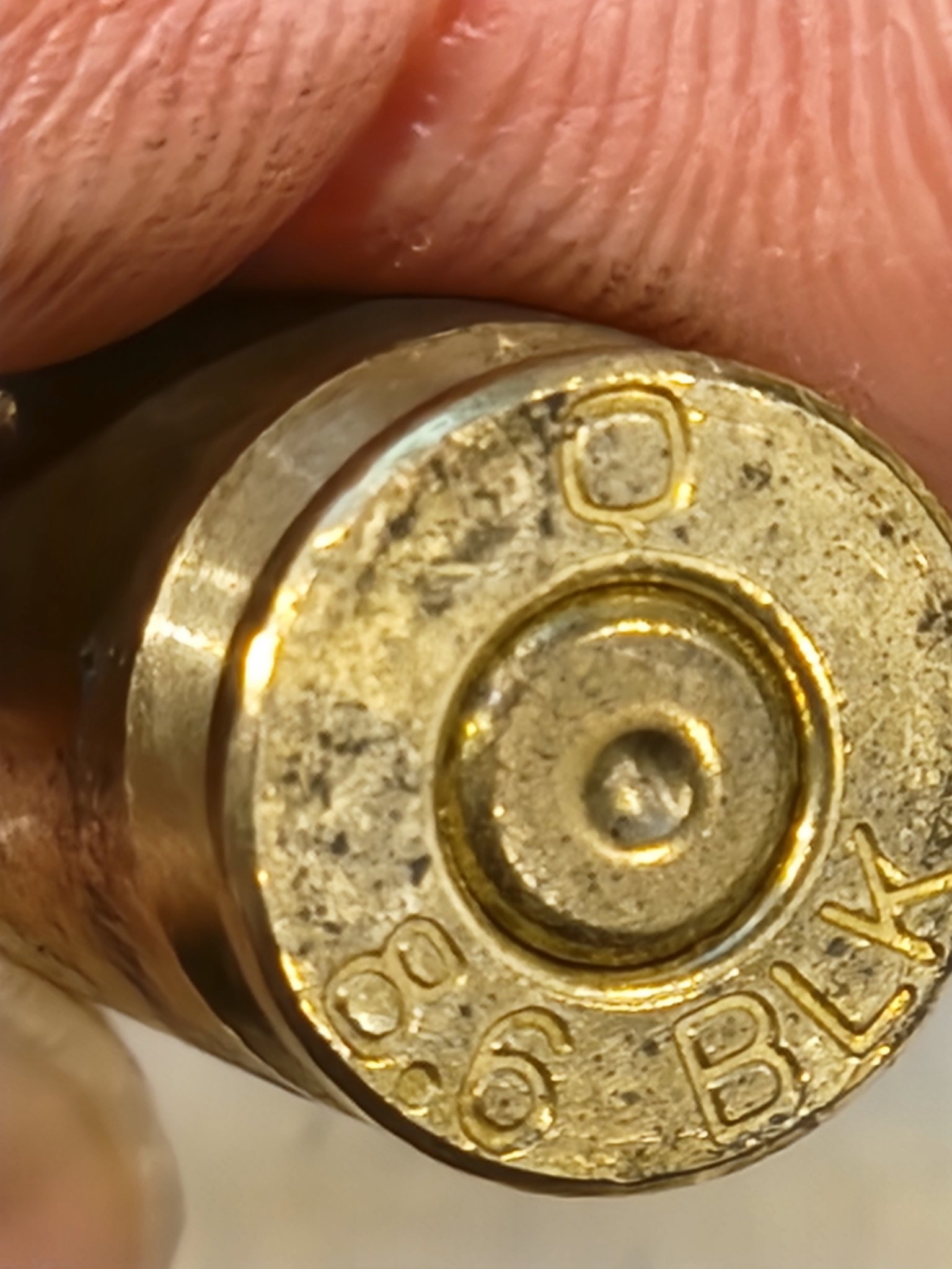

Reloaded some 8.6 for the first time and tested them out yesterday. Just cooked up 4 rounds of each and they were shot using my 8.6 BLK gas gun, with 8" barrel through my Dead Air Primal can. Velocities captured with Magneto Speed v3.
Reloading Setup:
Q/Gorilla once fired brass, Hornady Custom Grade dies, sized to specs using Sheridan gauge, brass was right around 1.790" after sizing.
First load:
Barnes 210 gr TSX
2.650" COAL
29.5 grains, Accurate 1680
Unknown large rifle primer
1694 fps average MV
I was not out shooting for accuracy as I was mostly just seeing if this was going to blow up my gun or not, so no comments there. I believe this round was way over pressure even though Faxon/Q chart said the MV on this should be more like 1750 fps, believe I saw some unburnt powder as well sitting on the bench after shooting. Attached a picture of the brass after shooting, which was already pretty beat up from the original firing, but more for showing the primer came back and flattened fairly significantly.
Second load:
Gorilla 285gr Subsonic Fracturing Projectile
2.750" COAL(had nothing to base on, so went with this)
14.5 grains, Accurate 1680
Random large rifle primer
980 fps average MV
Again, I was not out testing for accuracy, but was much more pleased with this round than the other one as far as performance goes. Faxon/Q chart for a 300 gr Sierra SMK was at 860 fps with 14.7 gr of powder with an 8 " barrel, so clearly there's some disconnect here as well. I was well above the final circumferential cut on the bullet, so maybe I was a bit too deep which drove up the pressure and velocity? Gun functioned well and locked back after each shot, ejection wasn't much to speak of as far as distance goes, but was at least coming out around 3-4 o'clock.

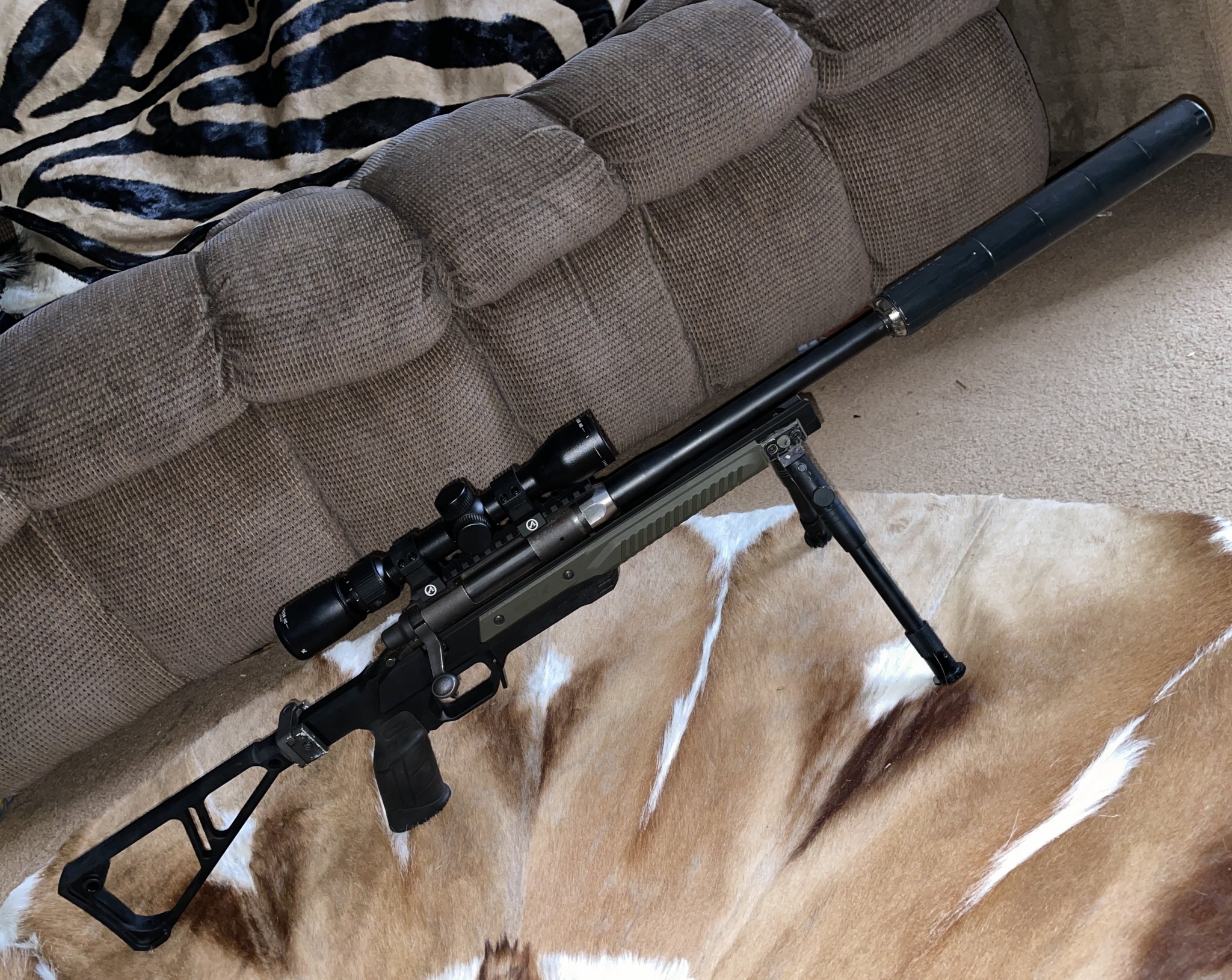

I have a CGS Hekate waiting for this cartridge to move just a little further, hopefully shot show we see a few more companies jump in. Faxon really is the only big company to step up, Q still doesn't even have a can for it. I also think we forget how long 300 whisper took to perfect and become the 300 blackout of today.

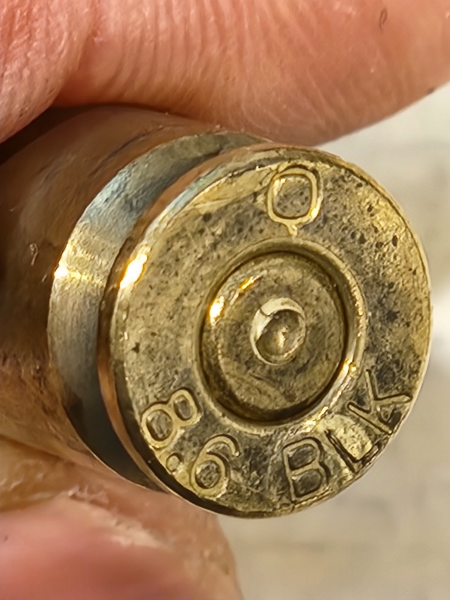

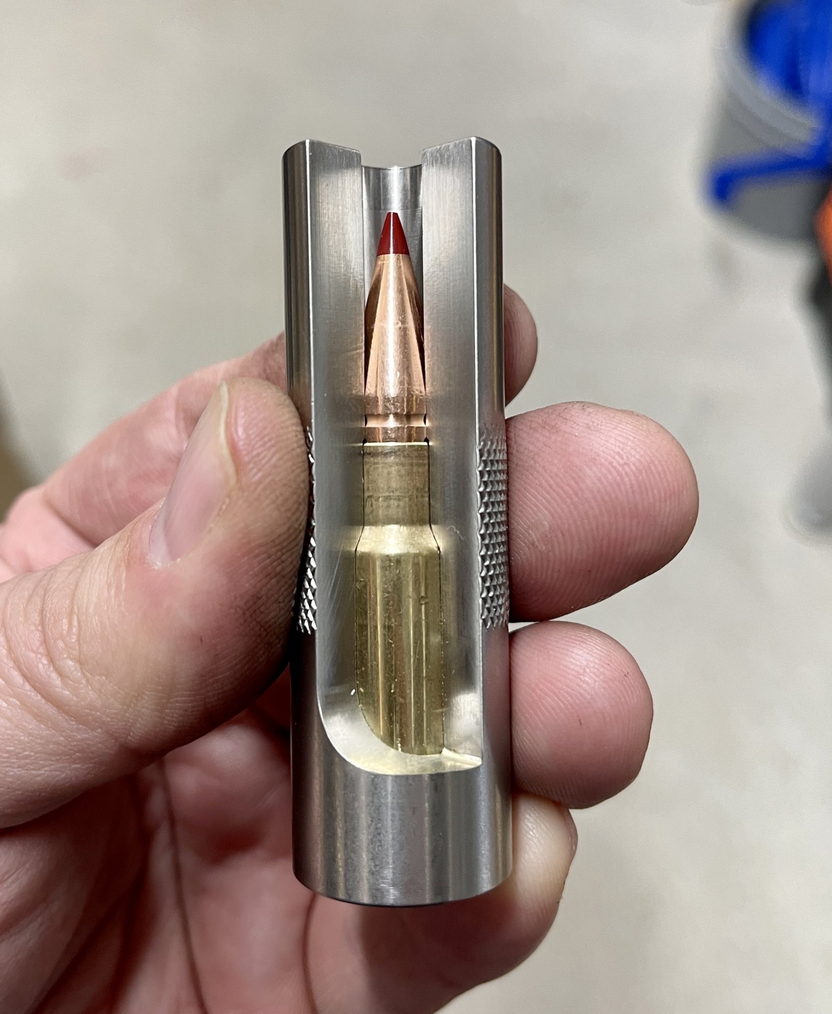

Brass is prepped and primed to do some load development tomorrow.

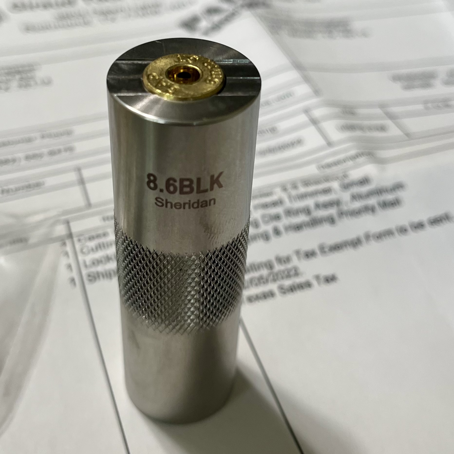

The Sheridan case gauge is an awesome tool when getting set up to make brass for the first time.
Mocked up a round with the COAL at 2.600 using the 185 CX
Where are you getting the Sheridan case gauge? Search for Sheridan case gauge gives me a Sheridan engineering and coming up with a dead page. Also is anyone making modified cases for OAL gauges? Any help would be appreciated. Thanks

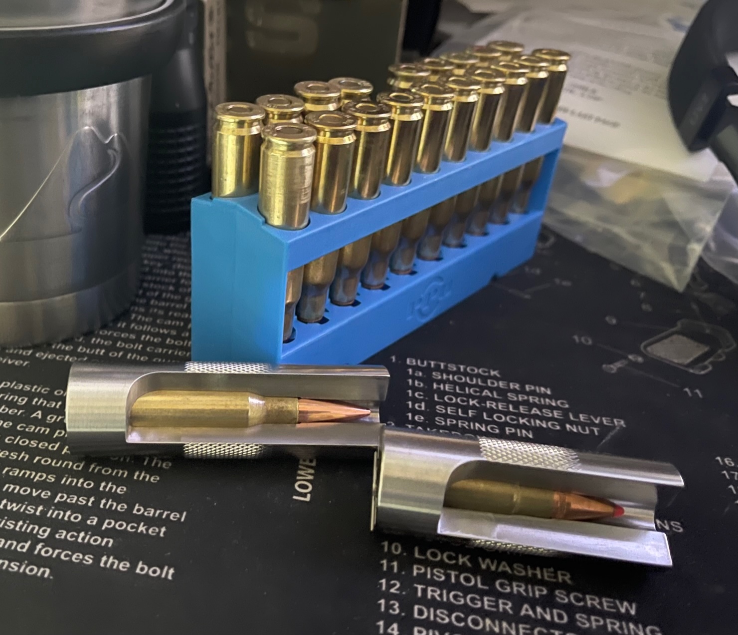

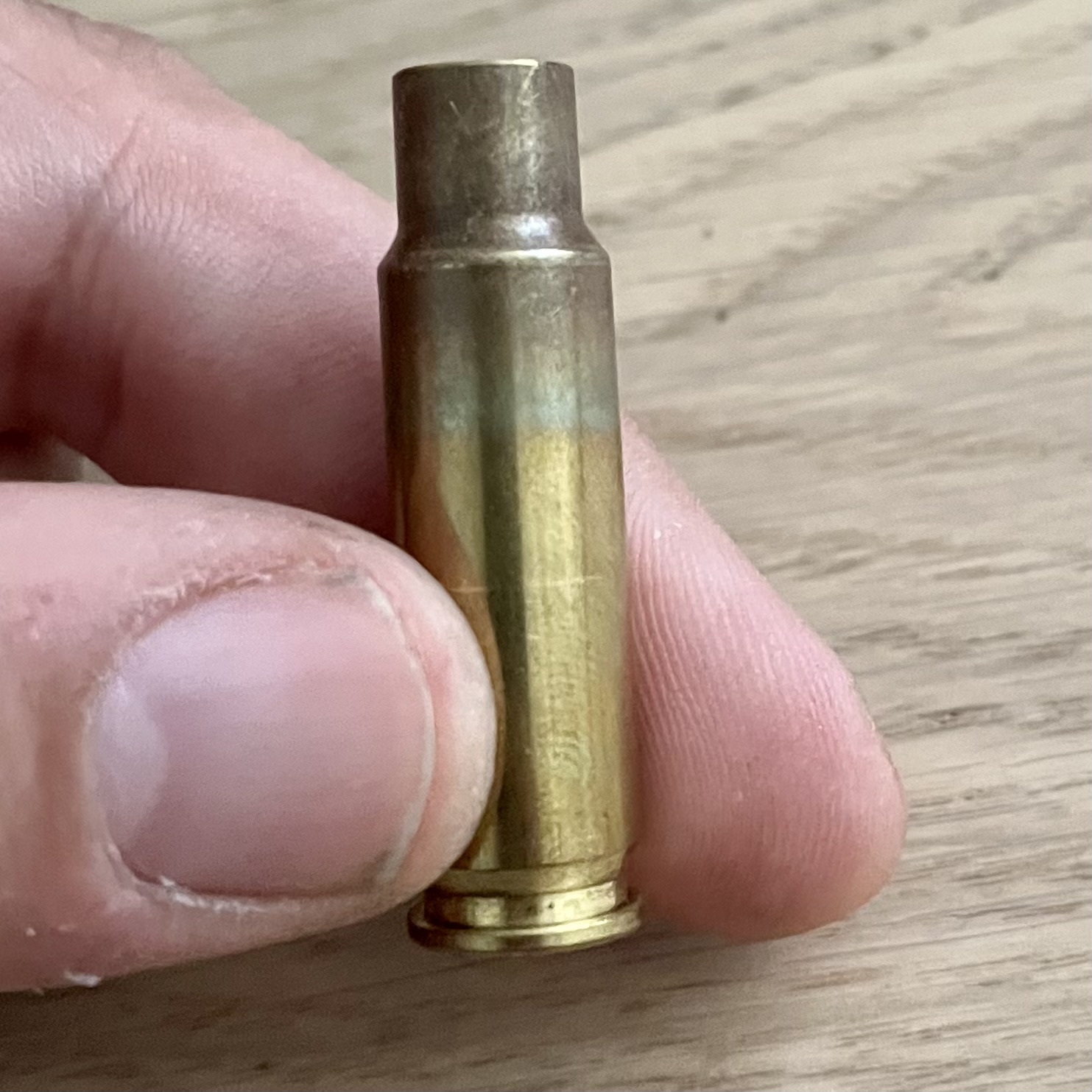

Hiya folks, there are other case options for 8.6 brass if you don't want to trim and neck turn. In looking for brass, I came across this (https://dallasreloads.com/product/8-6-blackout-brass-only/) about resizing 6mm GT brass to 8.6 BLK. Did some math, and then bought 100 cases from Mid South Shooters. Lubed up the cases and set up my HDY AP press with 6.5CM -> .308 -> 8.6 dies (with expanding balls dropped as low as possible and "half pulled" the cases to expand out the neck. Then did "full pull" resizing with the 8.6 die to bump the shoulder back and viola! 100 rounds of perfect length brass. No pooching/folding/bubbling where the neck meets the shoulder, no collapsed shoulders, they fit a Sherridan gauge perfectly and the finished cases come out to 1.683", with a bit of room to grow. Yeah, it's $0.75/case and some folks have a ton of 6.5CM Hornady brass just lying around. However, I'm a fan of small rifle primers for 6.5CM cases and all of my brass is either Starline or Lapua, so neck turning would have been in my future. This gets me 8.6 brass *and* a SRP, so I don't have to try to find LRP in the current environment.
Reactions: dnchrist
Yup this works I can confirm that…but have you loaded solid copper projectiles in it yet? Without a chamfer in the case mouth you’ll get a copper ring forming in your chamber over a period of time from bullet scoring when seating the bullet.

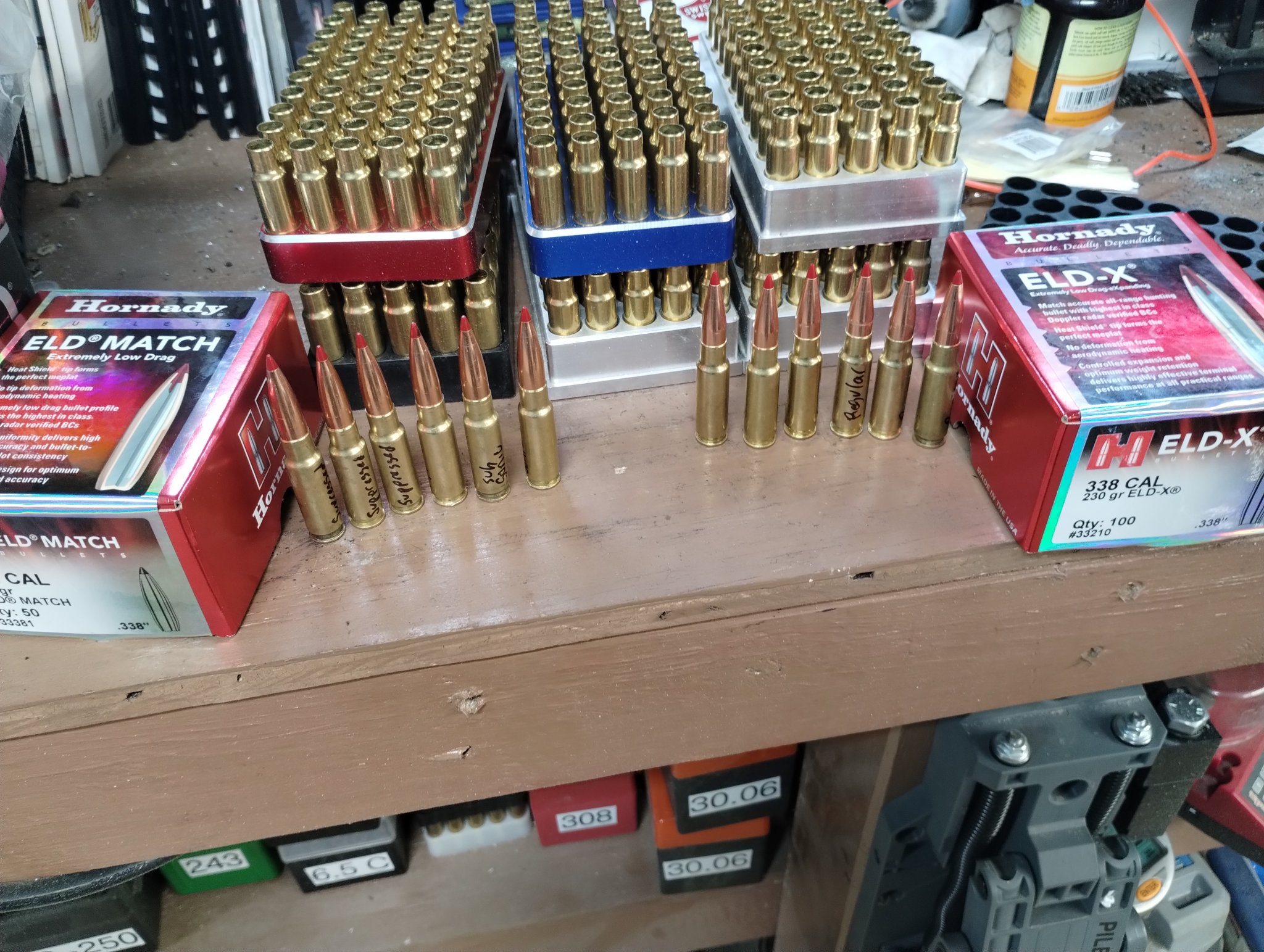

Just started loading this morning. Cutting Edge Raptor ESP 225 (with insert, so 230g)… CFE BLK. with 27.3g I’m getting 1650 and 1 - 1.25 moa at 100y.
Problems with crimping though. The CE’s are only riding with 2 ridges inside. My crimp keeps them in but you can bump them in further if you handle them roughly.
Any idea?
Any idea?
On further reflection, fl sizing die was too deep. I think that’s fixed now🤞🏻
Tighter seating now. Dropped OAL to mitigate pressure spikes… My groups opened up to about 2 - 2.25 moa. Should’ve done one thing at a time.
OAL back up now. Groups tightened a smidge. Somewhere around 1.5 - 1.75”. I’m good with that.
I have 4 loads now, practice, medium game & 2 extreme large game penetration loads. Think it’s time to stop knit-picking and enjoy it.

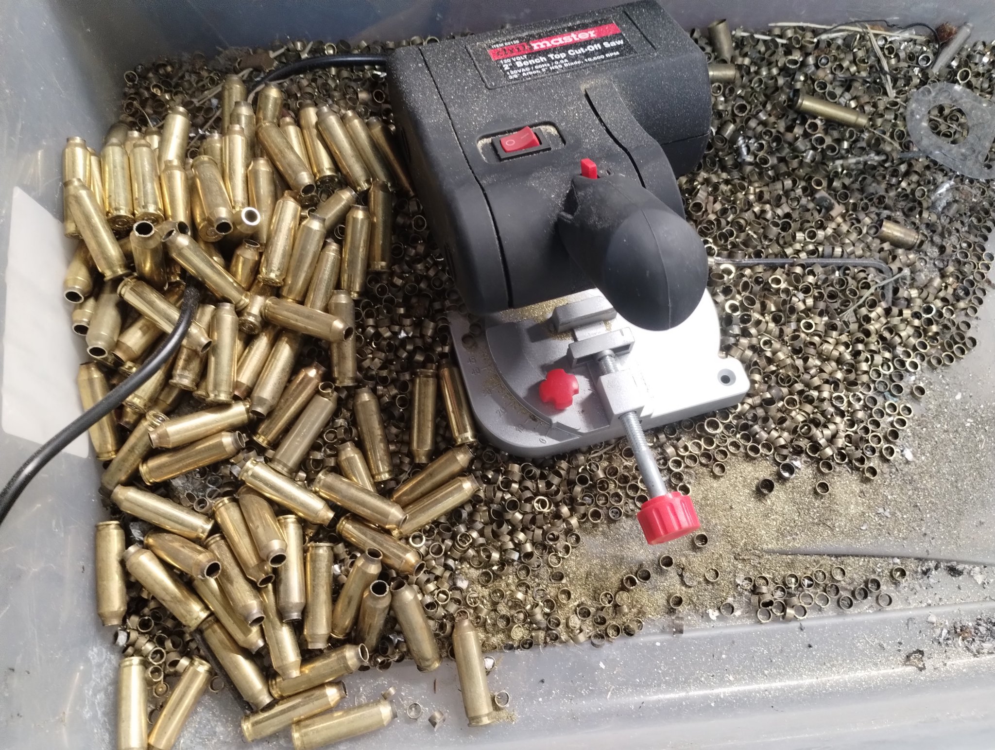

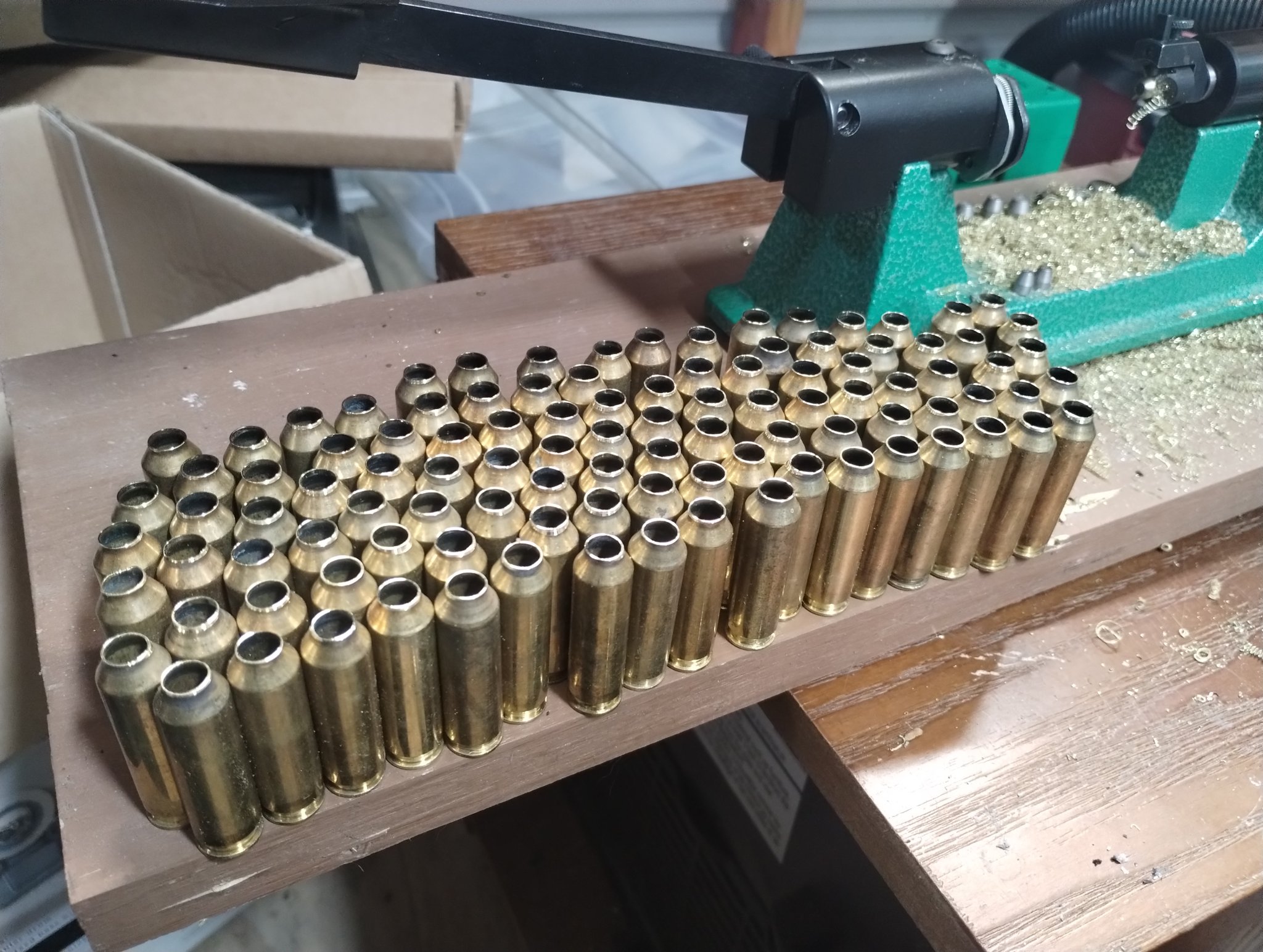

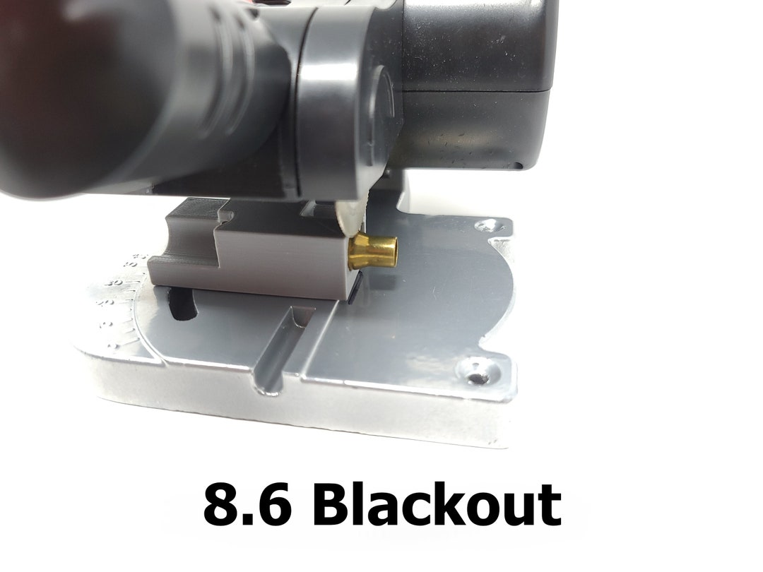

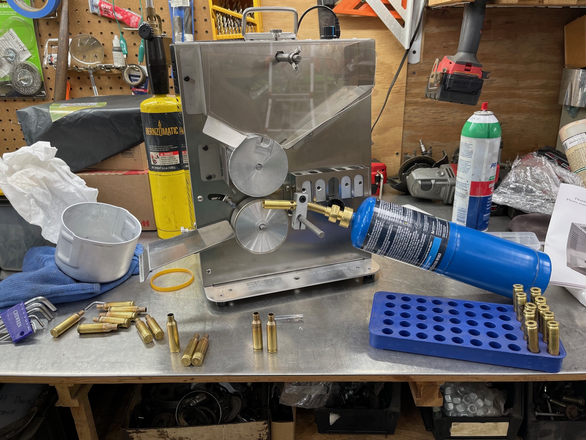

Etsy sells a jig for the Harbor Freight miniature chop saw. Works great! I anneal and then chop, then bevel.
I have the harbor freight chop saw. I got a trimmed case and put it in the saw vise. Pushed the case against the blade and marked the vise with a marker where the case/shoulder meet. I can get the cases cut spot on. Then I trim them to length before sizing them. Makes life so much easier.
Reactions: dnchrist
I added a 3D printed 8.6 guide from Etsy. It uses a ball bearing to lock the case in proper setting. I've done over 300 rounds on it. I also had a problem with my Harbor Freight chop saw. The blade mount acted like a clutch, causing the blade to fit somewhat loose. I modified a bit so the blade would fit much tighter. Much easier and quicker cut now.
I don't have much faith in harbor freight tools, you get what you pay for. When I start to cut a shell and the blade penetrates the wall for some mysterious reason the vice loosens up a little. It didn't have that problem the first 200 rounds I cut. What I do now is after turning it on, I have 1 hand lowering the blade and 1 hand turning the adjustment knob. Soon as the blade penetrates the wall the adjuster will tighten up 1/8 of a turn and you can finish the cut otherwise it will bind the blade. I've done another 200 this way. I imagine with a fixed jig you don't have this problem.
I took the base off for the jig install. You are correct about the cheeeeep vice. Once I got the jig tweaked and the loose blade fixed, I've cut several hundred rounds with no problem. It just chops really quickly throught them and I'm still on the original blade.
I leave a little of the shoulder, which seems to make sizing easier, and then I clean up the length with the RCBS trimmer with bevels.
That's similar to the way I work things. I start by trimming my brass with the chop saw to 1.687. Then I get my 6.5 RCBS 3-way trimmer and trim it to 1.685. This way I am running the expander ball through the least amount of neck. I have a turret press and put a 308 neck sizing die on 1 station and the 8.6 nextdoor. I open the small amount of neck open with the 308 and then size it down with the 8.6. It seems to grow about 1.5 which is fine with me, even though I have a 338 3-way cutter. It's done, trimmed, chamfered, and deburred. Easy-peasy.
Reactions: dnchrist
Work smarter not harder
Reactions: dnchrist
I use the universal deprimer as my first step, then I anneal before cutting on the chop saw to 1.73" (I like to save a little neck lip) because they fit my annealer better full size, and it cuts easier annealed. I chamfer the edges of the rough cut and then clean the cases because I don't want any foreign junk in my die, which can leave imprints on the brass. I size the pre-cut brass because is is much easier on the die. I use a large amout of RCBS #2 (baby snot) on the case. Too much on the outside of the kneck/shoulder area can cause shoulder wrinkles. I just roll the lube on from a pad, and occasionally lube the inside to make it easier to pull. I then run them throught the RCBS Trim Pro2 case trimmer which trims to final size and chamfers inside and out using an attched power drill. I then clean again to remove the case lube, add primers and powder. I've done several hundred and fired them, and this seems to be working OK.
What type of annealer do you have? I need to get one but I'm not to crazy about dropping 2K for one?

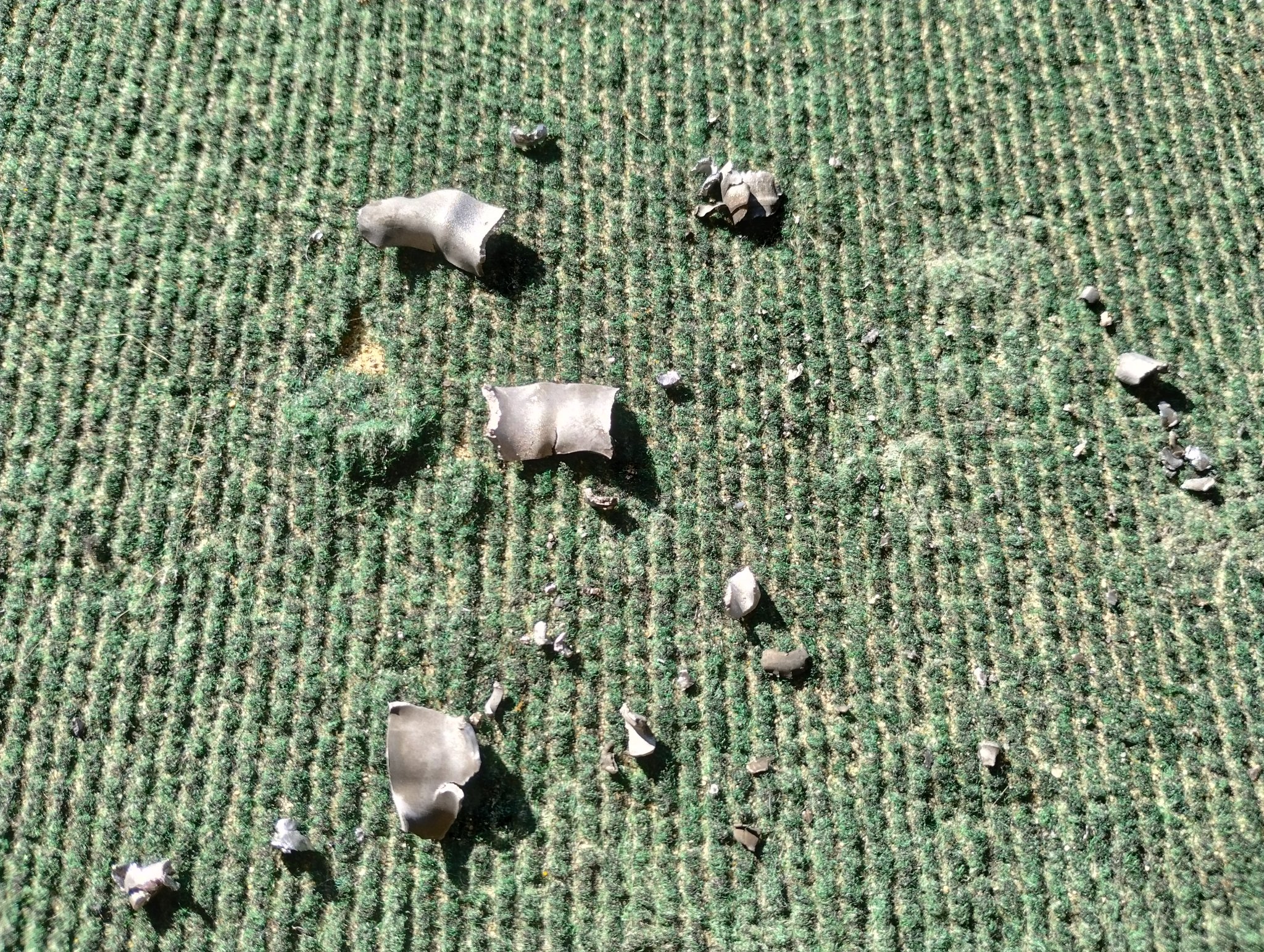

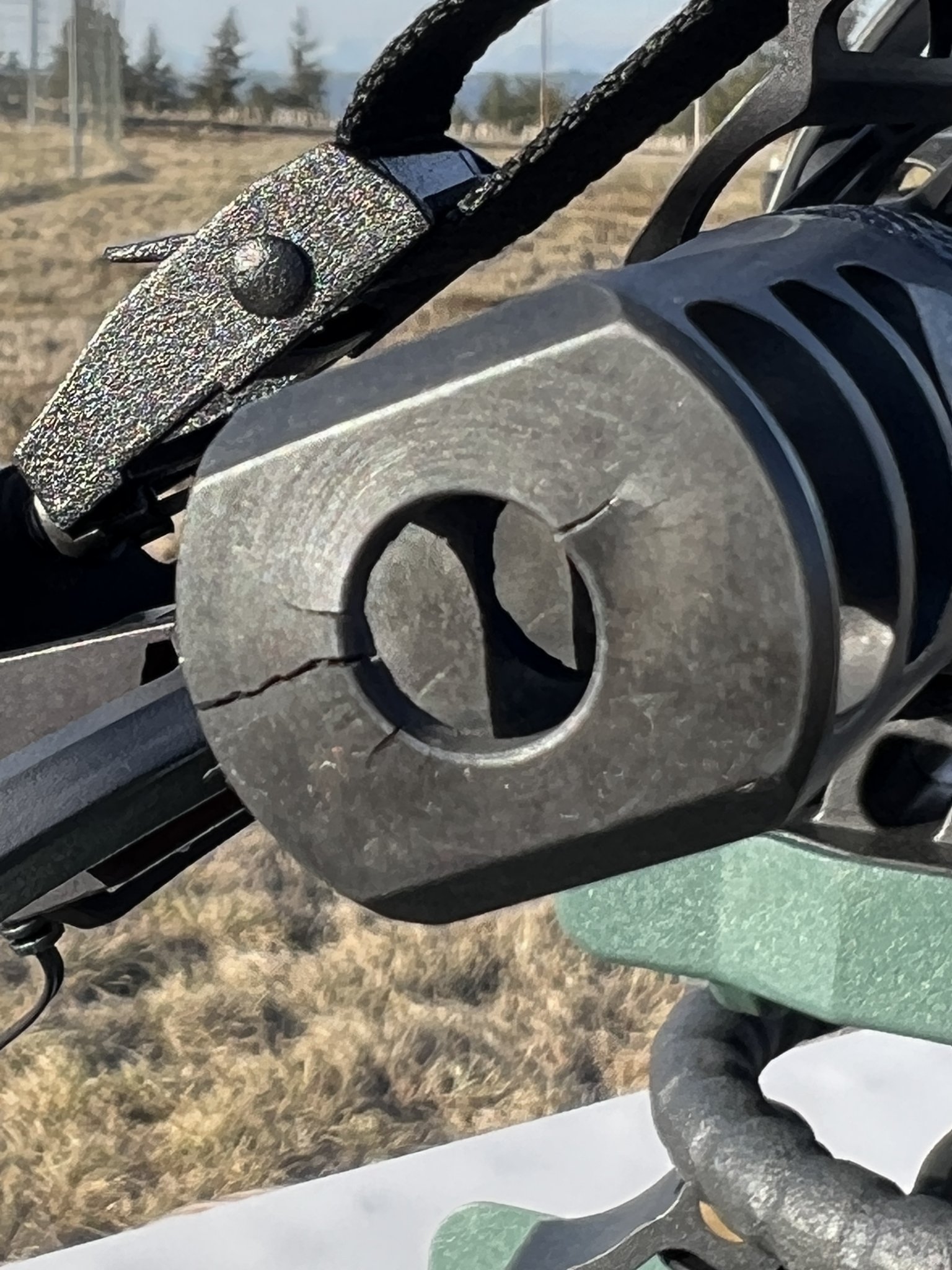

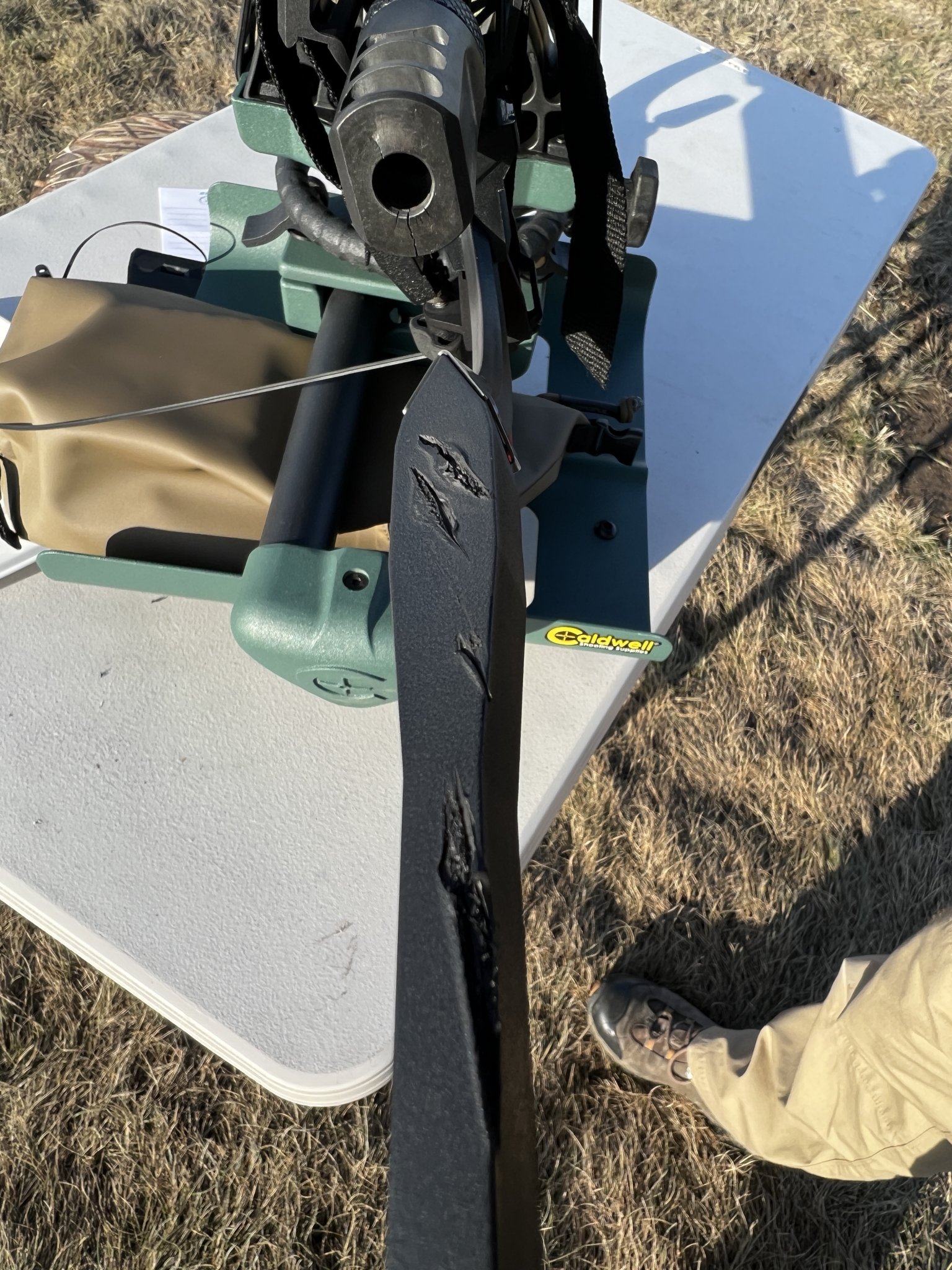

Alright. I learned a hard lesson today. When Q says "only bonded and solid copper projectiles" they mean only solid copper.
I had some 185gr .338 federal fusion (bonded) loaded to very mild pressures, that came apart from the ultra fast twist and took out every single baffle, and the end cap, in my supressor.
Word of warning...test fire projectiles without supressors to verify they are staying together.
Been there, did that 2 weeks ago, although I lost a chrono as well. Steep learning curve and gave me excuse to get a MagnetoSpeed from a Caldwell.

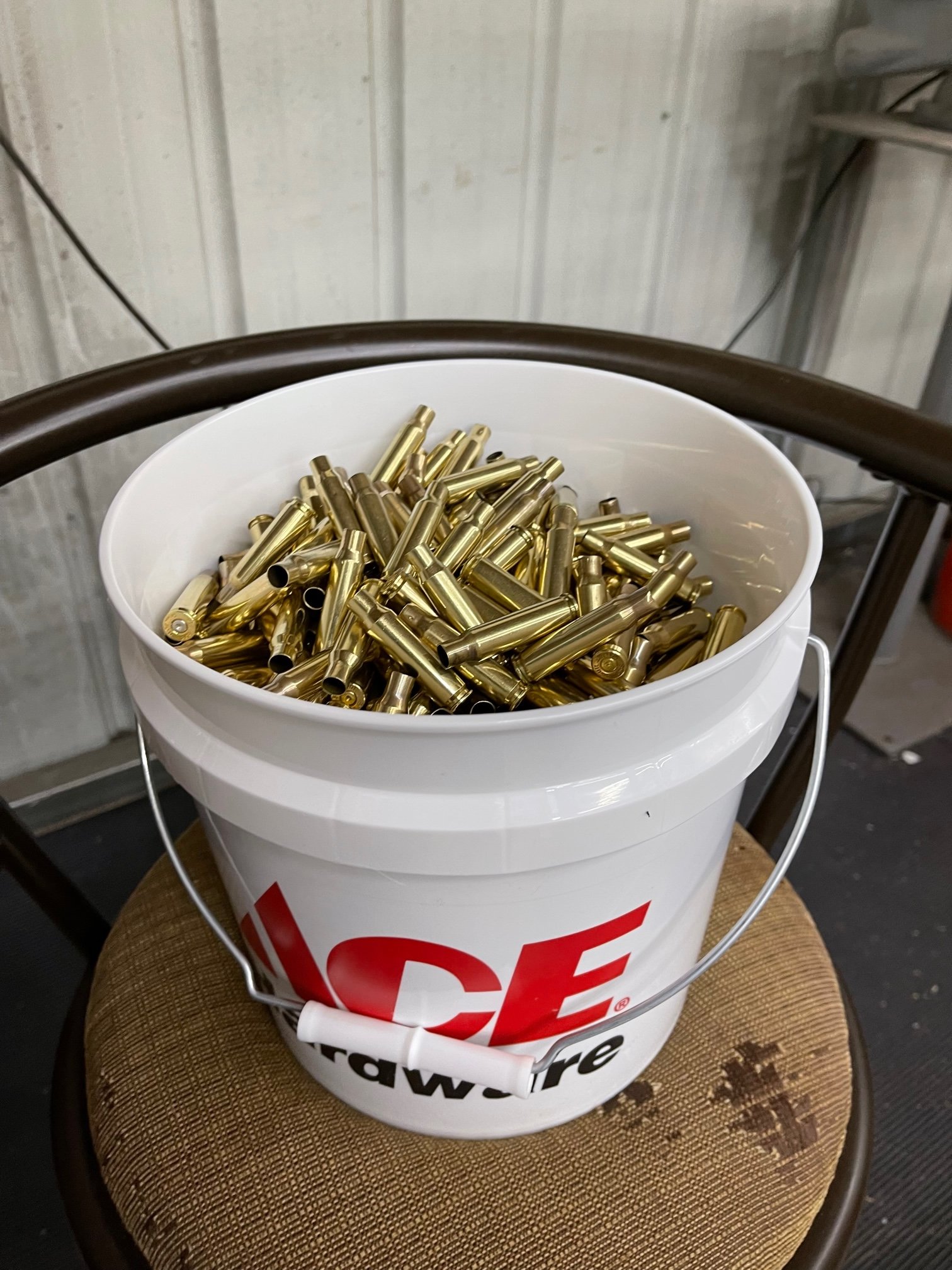

Anyone do any further testing on 308 conversion vs 6.5? I have a TON of 308 and not a whole lot of 6.5 laying around at this point. I ordered some 8.6 dies and have an on press trimmer. Would be only loading 8.6 for subs anyways so the % load to case volume shouldnt be an issue talked about on page one but just wondering if anyone has ironed out more of the forming differences from those two parents?
I load almost exclusively off of 308 range pickup. I anneal, full length resize to .338 (WO mandrel), OAL trim, Neck trim, Resize with mandrel, then case check Sheridan cut out gauge. The only issue I run into is some LC and odd named brass, the case lip diameter is a few thousands to large for the Sheridan gauge and those I chuck up in a drill and file down slightly till they fit. Although they still fit my Aero 308 BCG fine. I do it to make sure it fits full length.

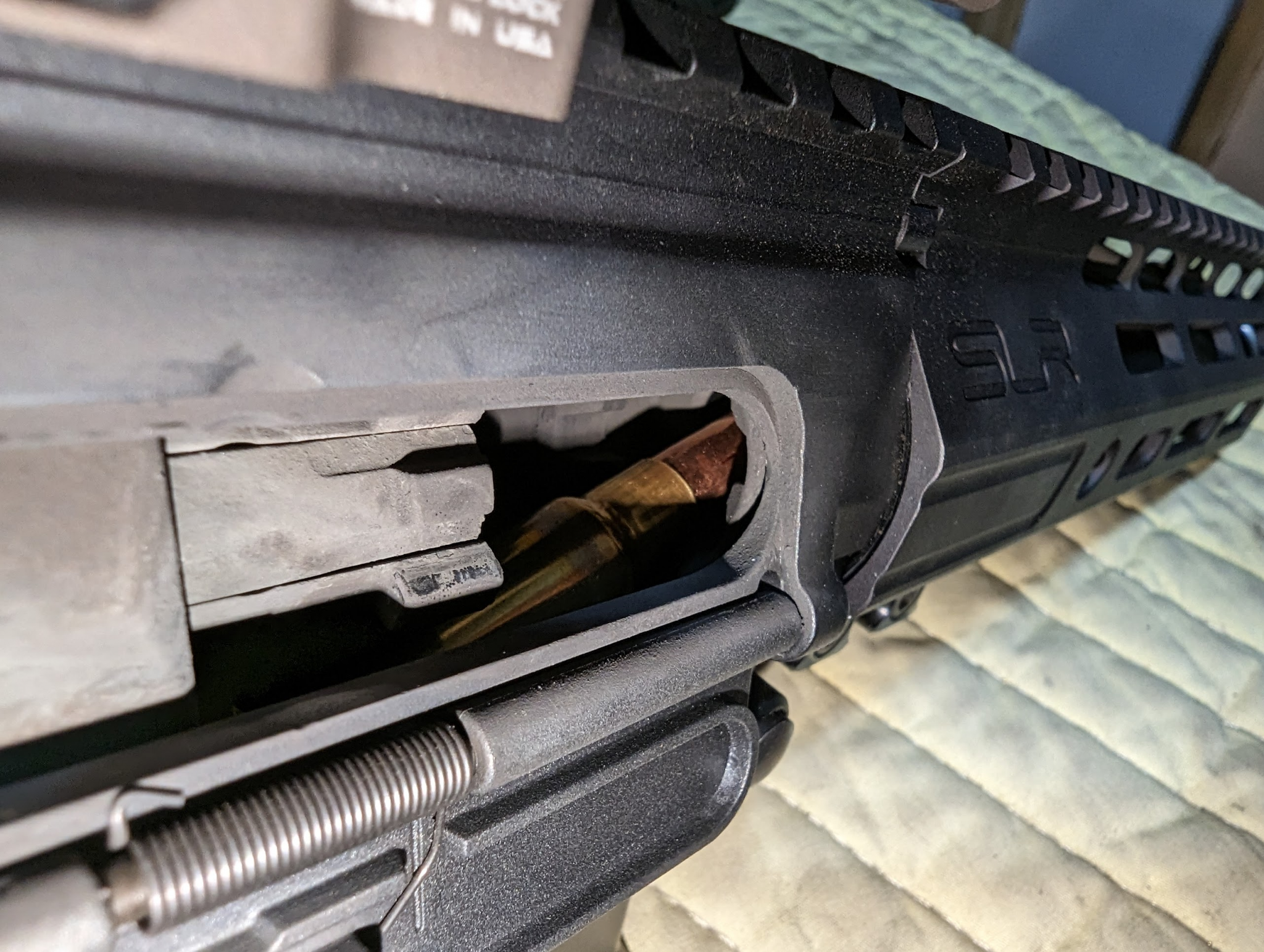

Today I had a double-tap (Actually, the range officer I Iet shoot it had the loose grip) I have fired several hundred rounds through it with no problems. When I cleaned the gun today, a piece of mangled copper fell out of the linear compensator.... had a few mangled threads on the inside of the compensator. Does anyone think this happened during the double-tap because of the fast twist? This was a 185 gr. Hornady CX.
I don't load the 185 CX over 31.6gr of 1680 you can go more but you risk it coming apart. 31.2 is where it shoots good for me 16" AR Faxon. Also lost a linear comp and a chrono found out the hard way.

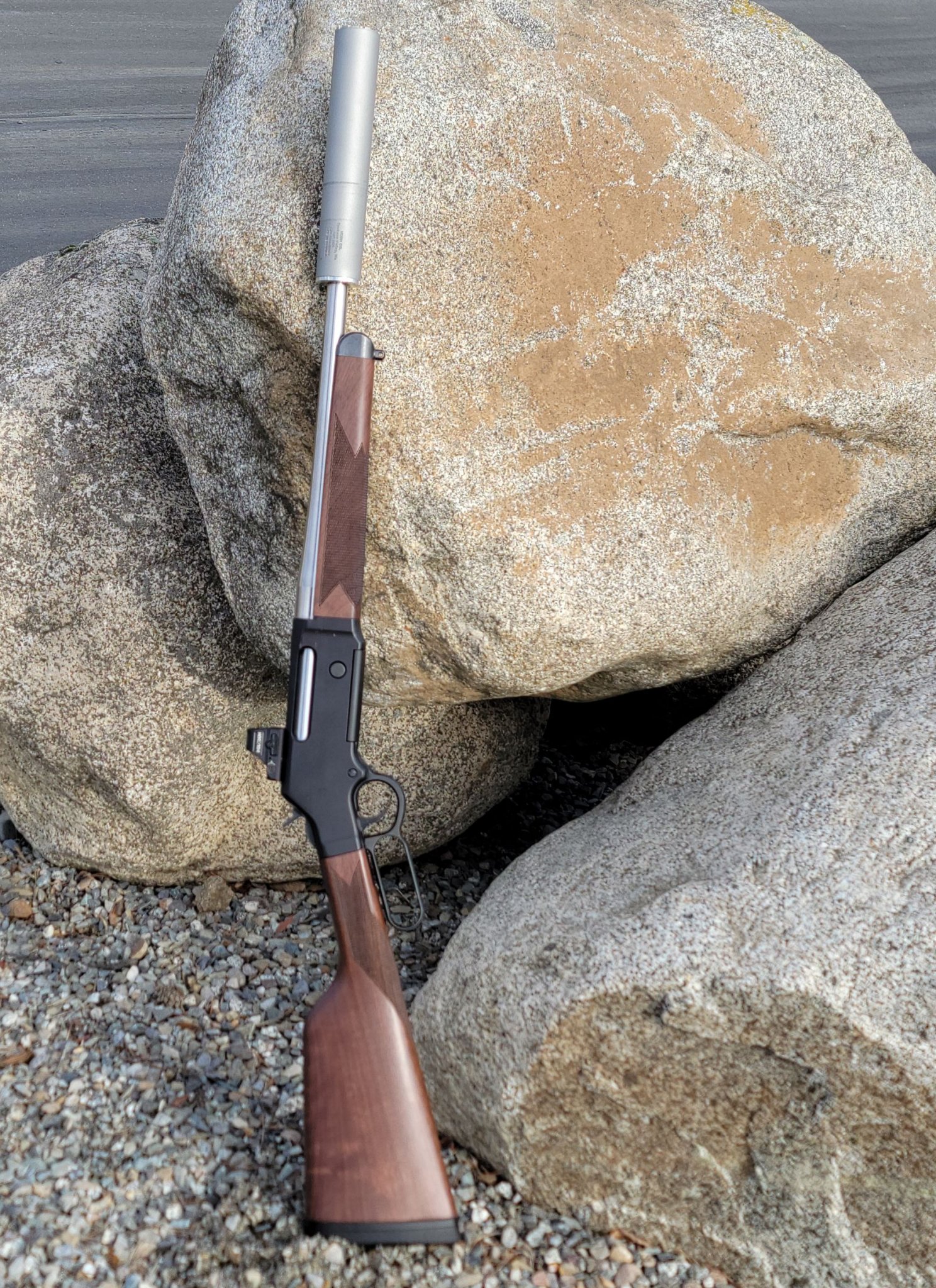

Rifle is 12.5" Henry Long Ranger. (1:3) It's wearing a Delta optics 1-6x now. Gonna do a quick chrono with some custom ammo we received, and then it's getting cerakoted back to a factory look.
It is both, fun and quiet. Looking forward to doing more testing.

Hit by the splody bullet on Saturday. Berger 300gr OTM Hybrid Tactical (thicker "skin" than the hunting versions) in a ladder test of A1680 from 15.8-16.8 in .2gr increments across a Magnetospeed v3 for subsonic testing (2400' elevation). First 15.8gr round was 1022fps while second didn't register. Weird... Shell ejected, but no hole in target. Uh-oh... It appears the bullet exploded when it hit the brake. Cracked the brake and the pieces gouged and shorted out the Magnetospeed sensor. I cautiously continued. Shot 20 total, 19 were good with MOA or better accuracy and one exploded. FSCK. Will continue with brake (it just adds character) but had to order a new sensor. Tried this bullet as a current boutique ammo manufacturer is offing the same bullet in a subsonic cartridge for sale. Hmmm....
So did the bullet explode because it hit the brake or did it explode from the rotational force? Or is it unknown?
