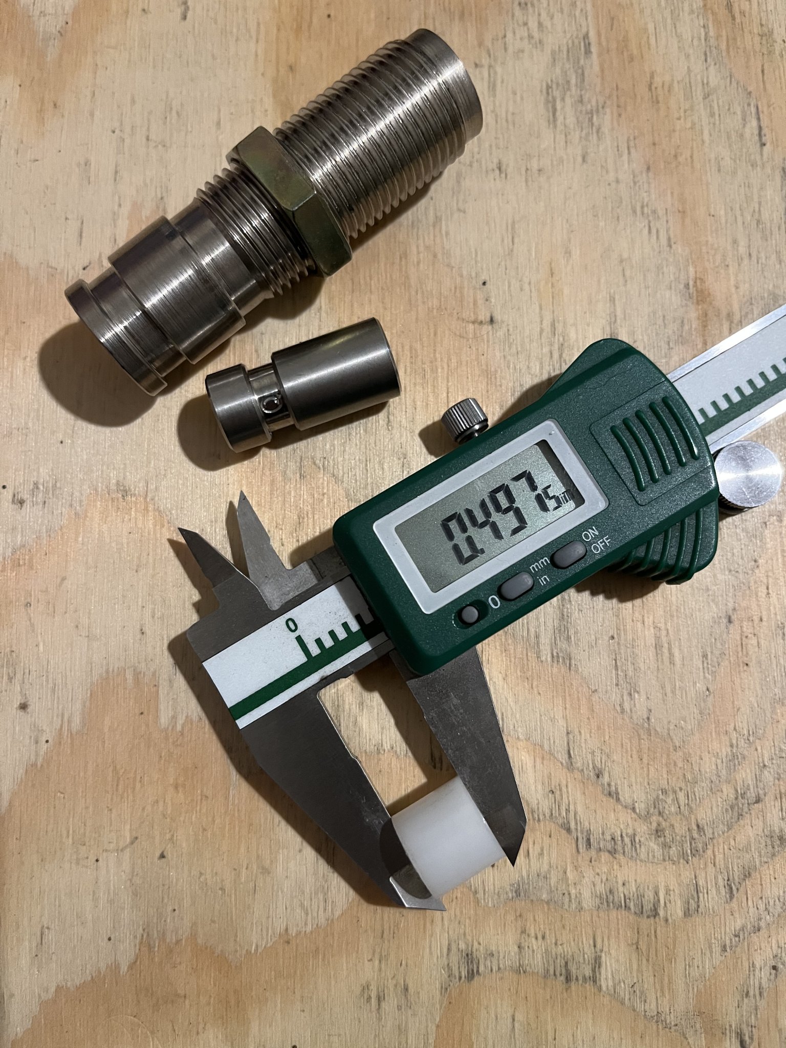

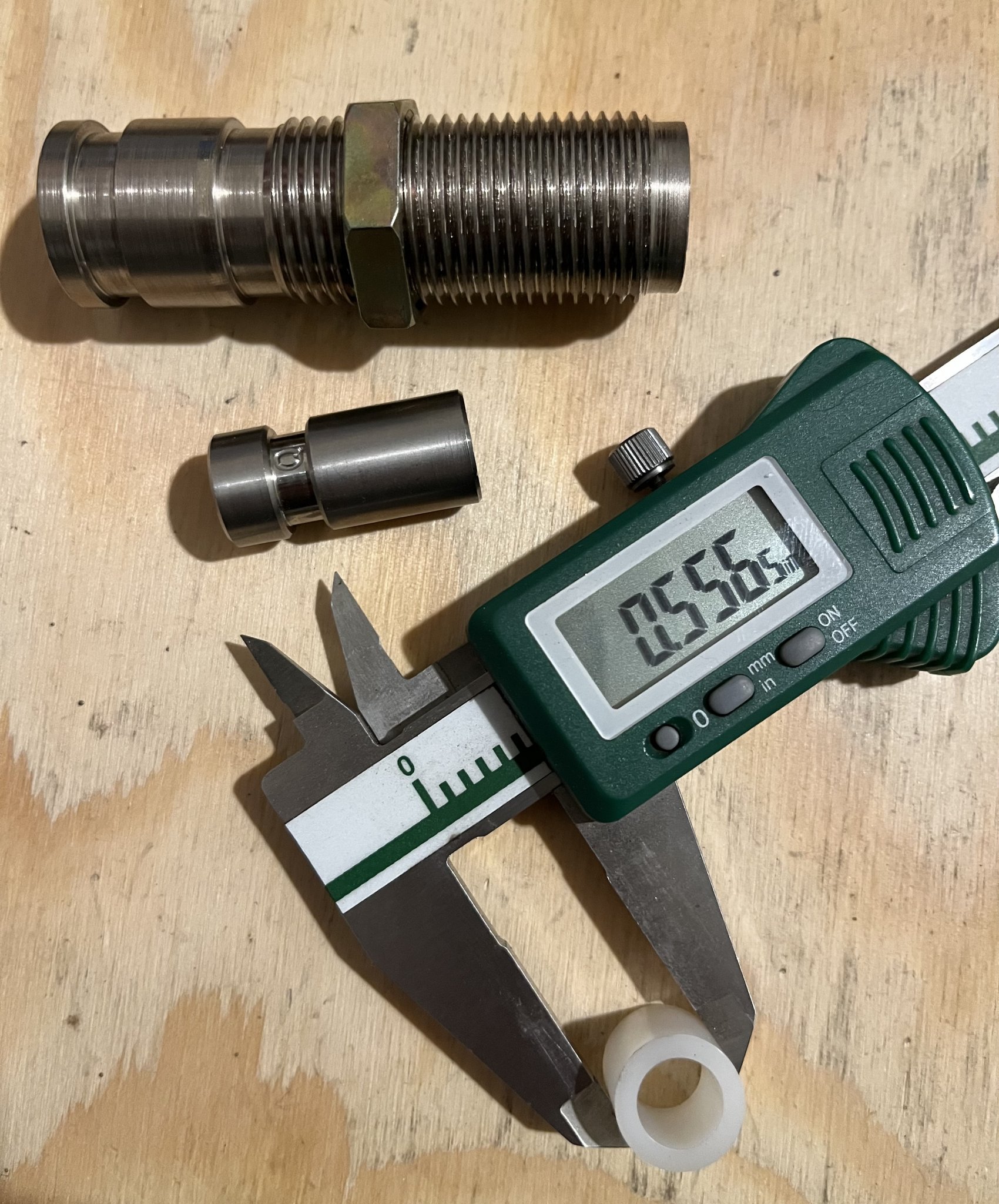

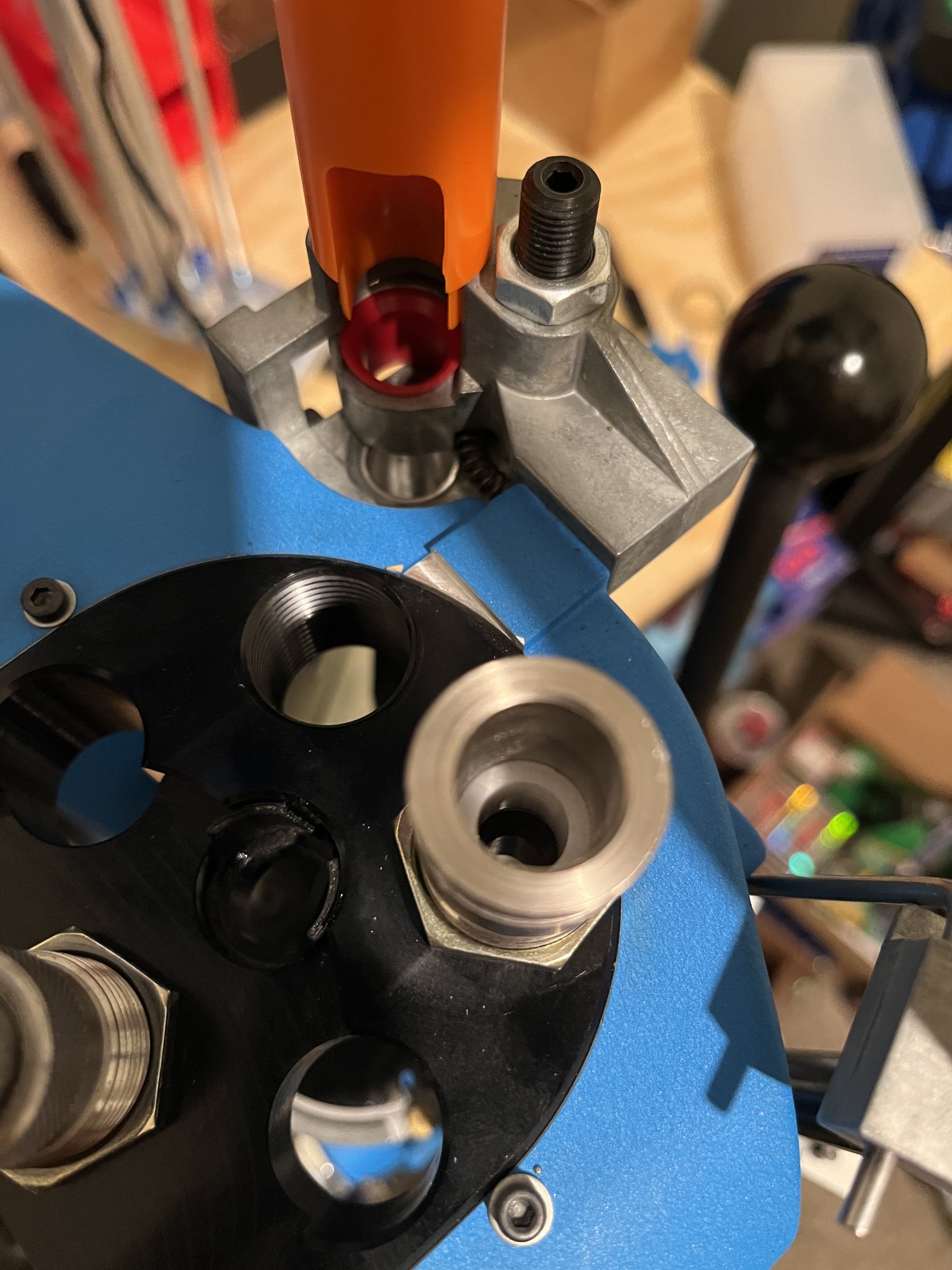

Anyone that's reloading, which Dillon powder funnel have you used, if you have tried one, of course? I'm assuming maybe the "Q" funnel would be the closest since it's .338 cal, but not sure on the shoulder as I don't currently have anything that's .338.
I’m looking for this answer too…trying to set up on a XL750.
Yes. For a Dillon powder thru die with caliber specific insert. Darker grey/ blue piece is the Dillon powder die adapter to the funnel. The lighter grey silver tube is a drop tube that can be used with the Area 419 funnel.

I can tell you that I tested with the Q funnel and there's not enough length in the funnel to fully actuate the Dillon powder measure. You run out of die adjustment downward hitting the shell plate just before you have enough upward motion to make it work. I also tried with with RL450 powder die with Redding 3BR powder measure and the case mouth is just short of making direct contact with the funnel. I suppose you could come up with some type of spacer that would fit within the die body, but I'm sure that could end up failing when you least want it to.
I also attempted to use the 338 Lapua funnel, but there's just too much length in that funnel to make it come close to working.
I can't say I followed the Area 419 discussion, but I'm assuming there's no solution there unless you wanted to do manual drops with their funnel.
Yes you use a delrin spacer from ACE hardware over the top of the Q funnel. No powder spill and it’s been consistent. See attached photos.

Thanks! What's the length measurement as well, please?
It fits snug but it moves effortlessly with the action of the powder actuating motion. After about 120 rds of 8.6 Blackout it comes out with minimal effort, you just tip the die over and the weight of the funnel usually lets it drop out free of the die. Make sure when selecting the delrin spacer it’s the one that has a hole larger than the powder hopper drop tube underneath.
