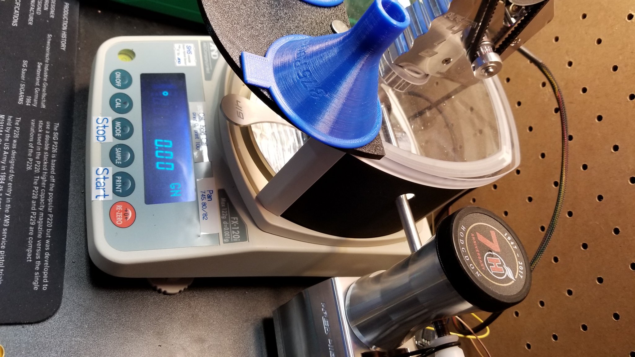

Just got my Bluetooth set up. With the addition of this feature it make the perfect set up in my opinion. I just started load development on two rifles and by being able to input your target weight it makes the process so much faster and easier.
Prior to the V3 I would start with the lowest charge I was using for load development do 3-5 at that charge then using the AutoTrickler like and manual trickler and trickle up to my next load and set that as my new target and do 3-5 of those and repeat again and again til done. Now I just select each on my phone and it goes right to it.
The V3 upgrade is icing on the cake of an already great product but it really completes the setup to make it a perfect package.

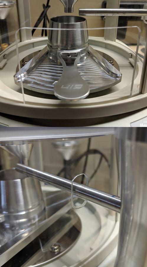

What is everyones method of drilling out the hole on the side wind blocker? I ordered the V3, and when it arrives I want to do this mod. I have read of people cracking theirs and with replacements being $70 Id prefer to make this a first time success. Ive read taping it, but what bit and speed are people using?
Masking tape as mentioned, and I used a dremel with simply a pointed grinding wheel to burn through and get the rough hole, then a cylinder stone to finish it. I also made a cut in my front window (cuttoff wheel/file finish) that allows the pan to go in and out easily while still providing a decent amount of restriction of air movement.
Man that looks slick. Just might have to do that to mine. Thanks for sharing
I used a unibit(step drill). I used the unibit brand, but you can find decent ones at harbr freight:
I made a side panel out of Kydex, easy to cut, shape & trim, cheap, no risk, and no cracking.

Kydex bends with heat, heat gun or blow dryer. Cut a piece roughly the same size as the lexan, place it against the lexan, heat it, bend it to the same curve, then trim to size. Very easy.

Thanks, looks great and ya, should be simple enough. Ebay is littered with it, can you offer what thickness you suggest, seems to be most offerings are .080, and a rough width and length needed?

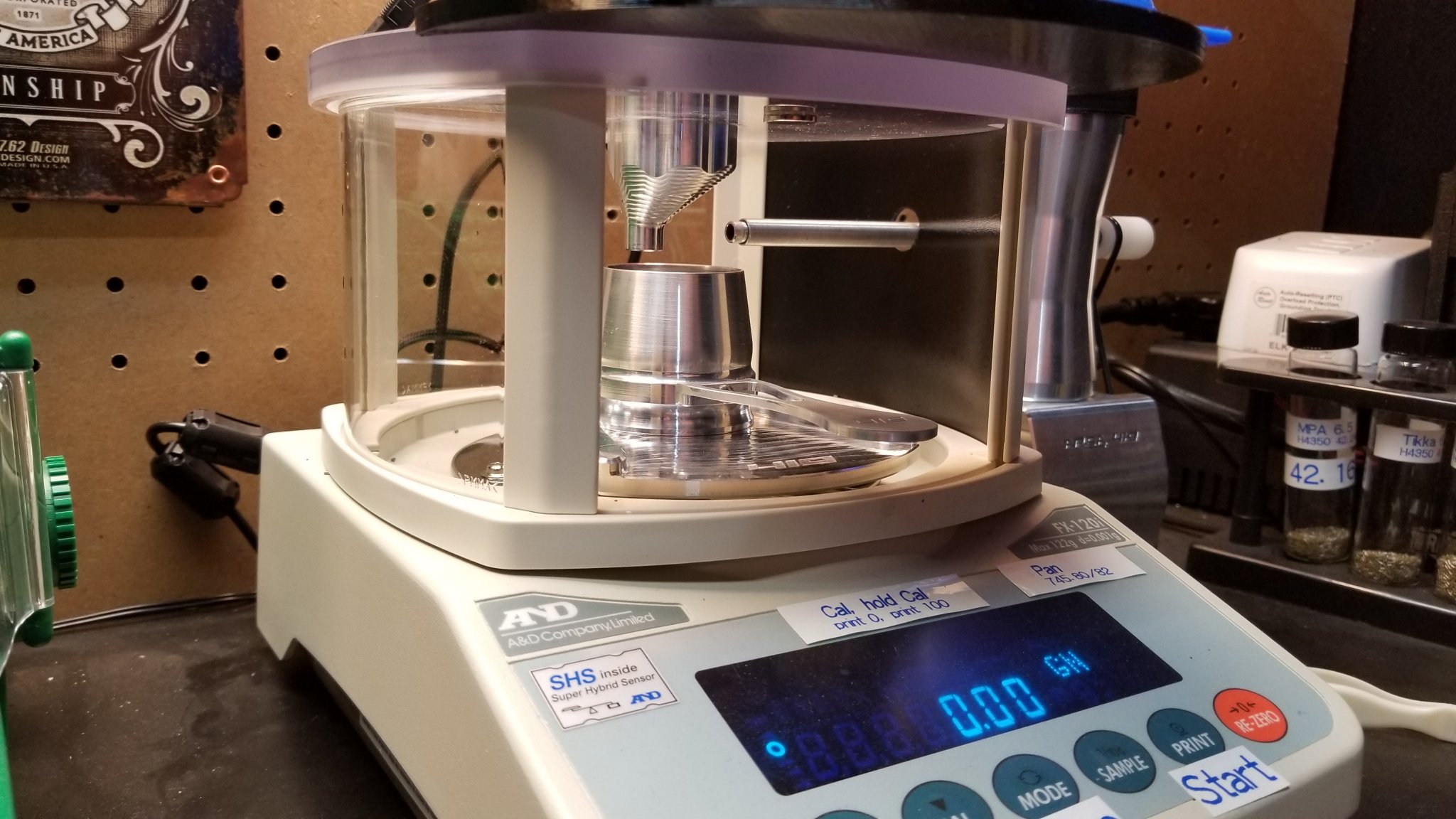

I had a very strange loading session this morning that freaked me out. I have the FX-120 scale, area 419 trickler base, 419 aluminum powder cup and self centering tray. I have used the set up probably only three times (loading about 75 rounds between 22-250, 223 and 6.5CM). Three different powders of course. This morning I was using my setup with the new V3 bluetooth board and started loading 37 cases (22-250) with varget powder. 34.6 grains was the target. After i loaded the 37 rounds, I decided to check a couple of the cases before pressing bullets in and was quite freaked out. At least 15 case (power charge) weighed between 34.42-34.44 grains instead of the 34.6 target. I made sure there was no granules left in the cases and decided to pour all the powder out and start again, not knowing what had happened. I loaded up 10 more round and started checking them and had the same results. I was making sure to set the powder cup gingerly in the tray, had no wind movement and was starting to think, scale? bluetooth board? Have no magnetic fields by the scale? So I started playing with locating the powder cup on the tray in different spots even though I was centering it before. I had some very different zeroing of the scale as I placed the cup in different locations. I reinstalled the pan that came with the scale and started reloading the cases again, I would load ten shells and check two. I did this for 37 cases and when was finished i went back and randomly checked about 10 more cases. Not 1 issue, so i finished with the bullet install and am conviced there must be some type of machining issue with my pan. I am in no way trying to slam area 419, but am glad I experienced this before going shooting and had some weird groups . My previous reloading sessions with my setup before the V3 upgrade, I did not check when i was done, i just assumed everything was OK, and didn't experience any weird groups out of the three calibers i have loaded for. Just thought I'd share, might be worth the effort to check. My bad for assuming.
So you are saying that for each, you visually verified 34.6 Gr and then later weight the same powder and this time it was not 34.6gr?
How long was the scale on, warmed-up before use?
Did you have nothing on the balance plate during warm-up?
Have you calibrated the scale with a calibrated weight since you added the Area 419 tray?
The weight of the powder cup does not change, did you verify the scale gave you the correct weight before zero-ing?
Did you clean the 419 tray, I've seen a 0.02 gr shift from the tray being dirty.
I have also seen a volatage swing move the Zero, an appliance goes on/off. I use a Triplite Line Conditioner, plugged into a UPS, so the units never goes off. I also have a few Ferrite Cores on the power cable going into the scale.
Any major temp swing also can move the Zero
Listen to the guy above he's spot on. Your scale is drifting it happens when its not warmed up or for me when my Air Conditioner is running I'll see the scale drift slightly.
I turn my scale on the day before i plan to reload and let it run 24 hours before i use it, I also close the vents in my reloading room. I have the weight of my Area 419 tray written down next to the scale so every time i pull the scale I should always see that same weight on the scale.
I hope this helps, also ensure you weigh your calibration weight and the beginning and the end of a weighing session.
