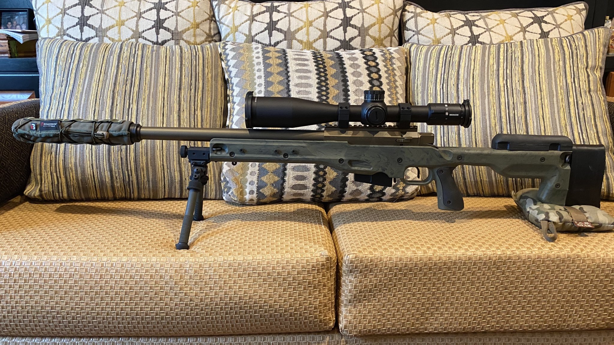

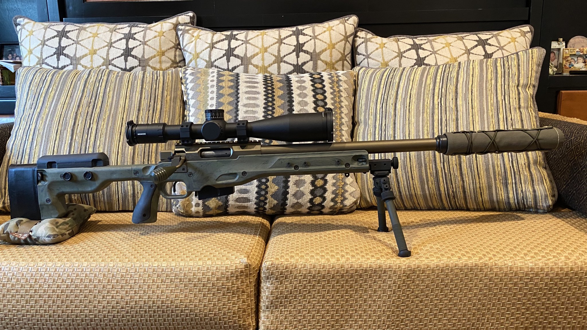

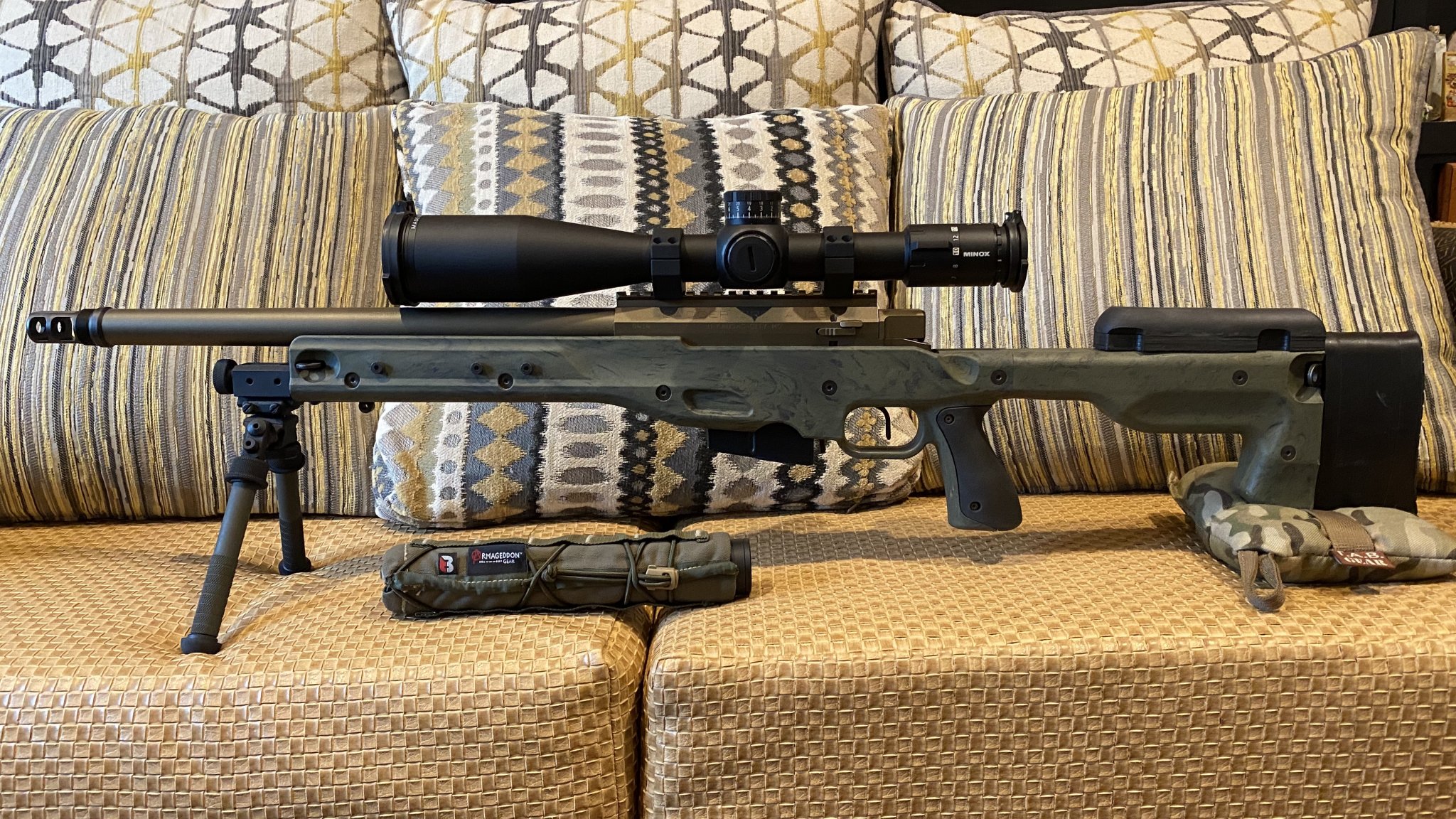

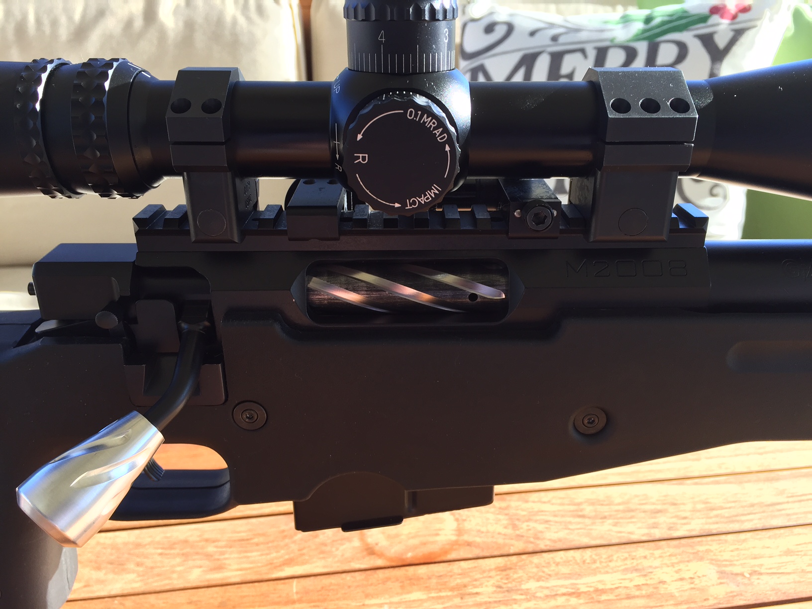

Heres a clone of the covert , with original AI spec BT can .
Later Chris

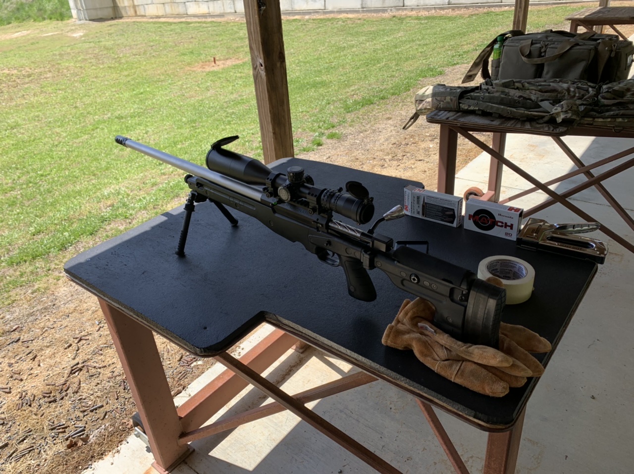

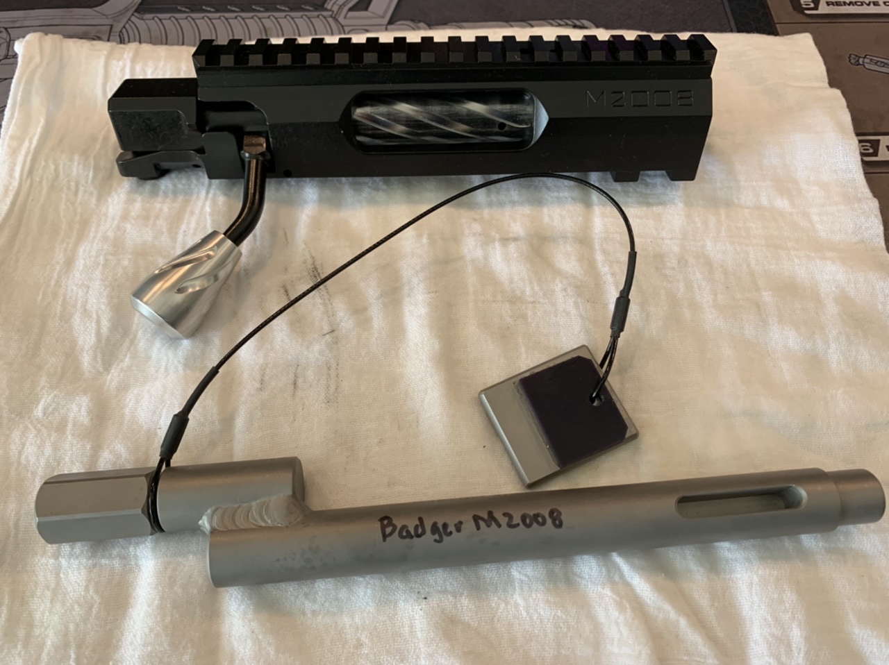

Just screwed on a new Bartlien 6.5 CM barrel and will be working up a load. So far it likes Factory Hornady 120 gr ELDs shot during break-in, so I’ll start with those bullets set 20 thou off lands in new Lapua large primer brass and 44 gr of Superperformance powder along with some 100 gr, ELDs, 135 gr Atips, 140 gr Berger Hybrids, 144 Berger LDHTs. Just to see what the barrel likes best before working up the load.

Is anyone having theirs converted to a double stack, AW magazines?
Mine will take them with the AIAW chassis, but if you hand load and want the most room in a mag I suggest the ARC mags...here’s a link:
These mags have the most room of any mags I’ve found and they also fit my RPR and with just a little filing they also fit my AIAX chassis with a Defiance Deviant Elite action...
