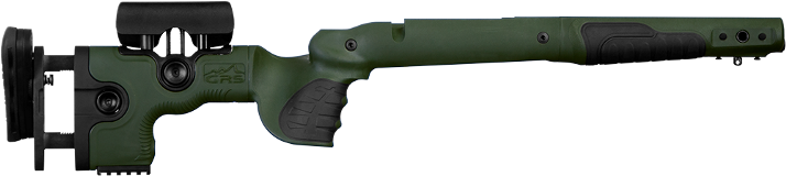

The GRS composite Bifrost stock also seems to be available for Blasers: https://www.grsriflestocks.com/models/composite-stocks/grs-bifrost
