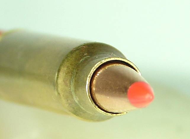

This is what happens when the 75gr A-Max is loaded to 2.260" oal.
