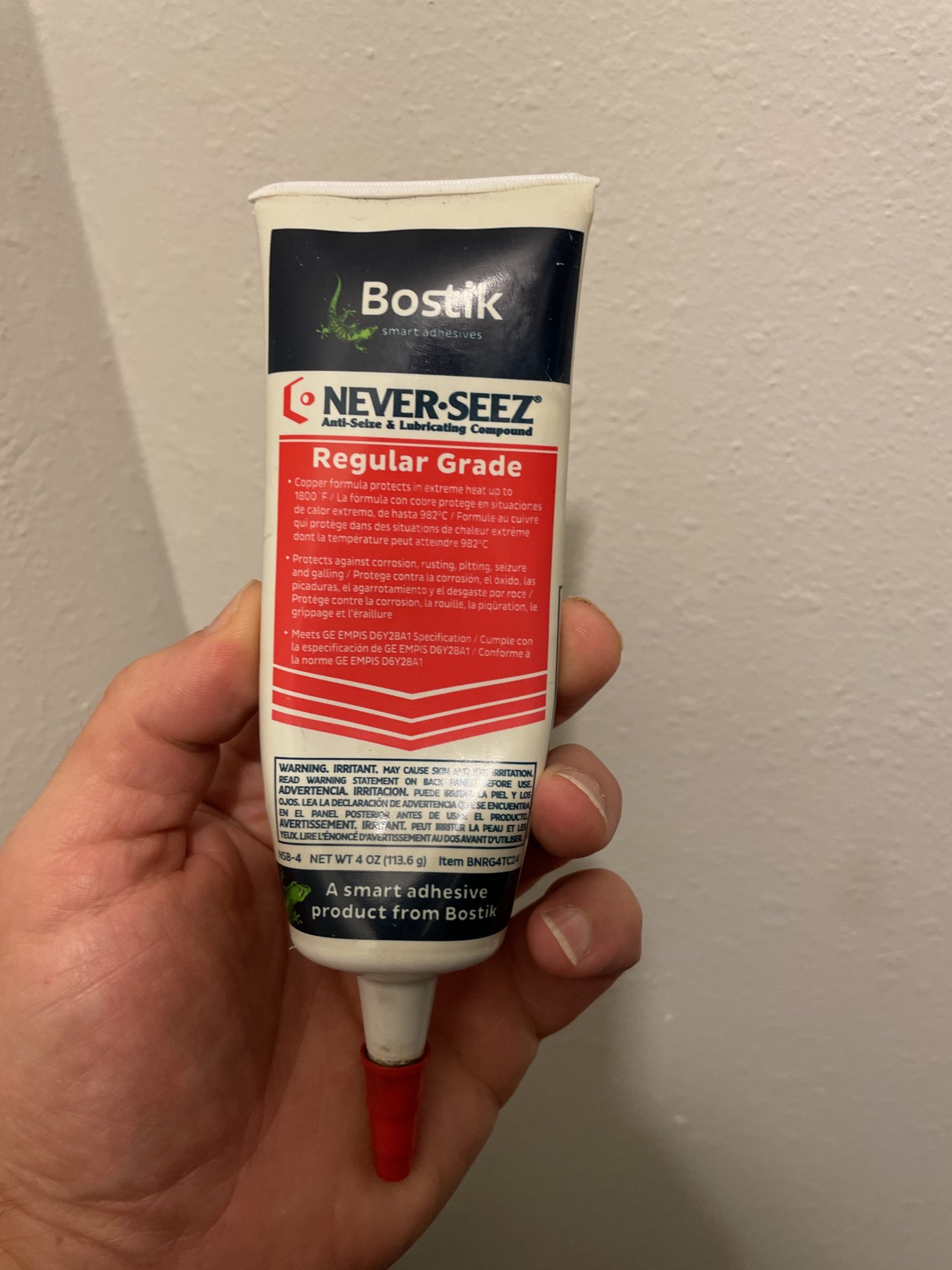

The other item (and I promise I’m not judging) is to find the right oil to slap on the MB outside threads for the suppressor hookup. I’ve had continued challenges with the carbon-weld issue with my suppressor to the CB Mount. It seems like alliant powders were a culprit, as I had both RL26 and RL33 challenges even with Rocksett.
once I put a couple drops of the right high temp capable oil on it before shooting it never had another issue. I just keep a small tube in my shooting bag. Not the most convenient, but honestly much better than what you are experiencing right now.
What oil are you using?
except get the small tube. This is like a 3x lifetime supply.
