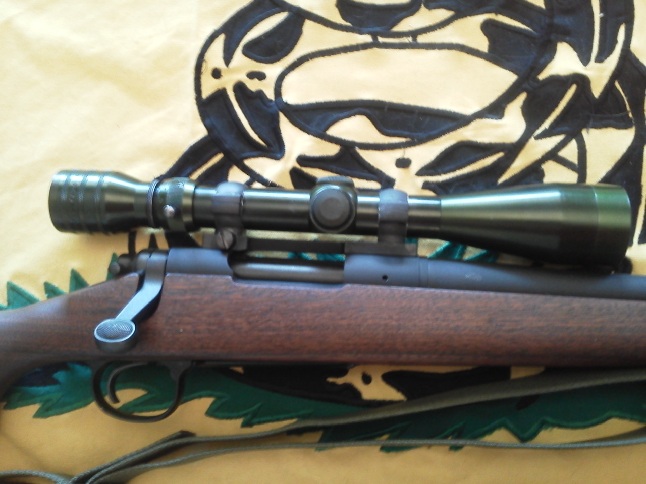

Olive Green 1st Generation done by Tokiwartooth.
Since the M40 trend started a few years ago, prices have gone thru the rooftop. I've seen of-the-shelf commercial 1st Gen sell for 500$+ on eBay. This is ridiculous. People didnt over bother to look at them before. I've seen them sells for 50$ at gunshows not 5 years ago.
Most of these scopes needs work (40 years old), and seriously, it is far from being top-notch optics if not worked on by a qualified repairman (Toki)... Rugged and reliable yes, but not even clear as a 200$ Bushnell.
I would say it worths as high as somebody is willing to pay for it. If its a keeper that you have on a rifle, Toki is right; market value is somewhere between 100$-250$ depending on the condition.
