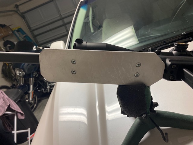

Bravo with a 2-3/4" alum. flat BR plate for riding the rest. Works great, easy to change over to a bipod for F-Class.
