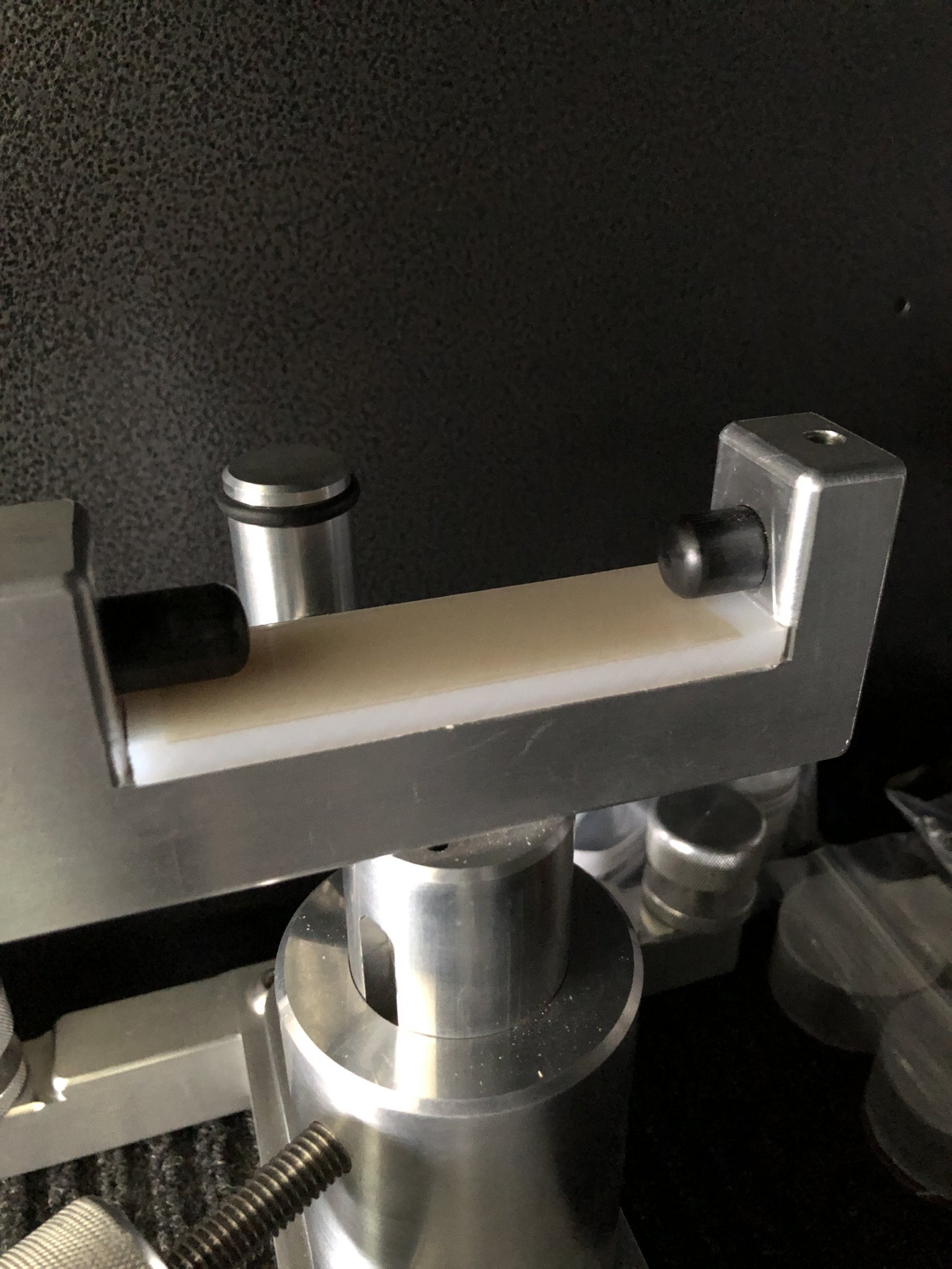

If you test in the manufacturer’s “tunnel” your barreled action will be strapped into an appliance for test firing groups of several different lots. As the rifle owner you have the responsibility to evaluate the data and determine how much of a particular lot you care to purchase.
Eley’s testing facilities are located at Killough Shooting Sports in Winters, Texas. Lapua’s test centers are in Mesa, Arizona and Marengo, Ohio.

FYI, if you own the PQP lite, I ran into an issue with mine. The screw hole for the stop bolt entered the area under the cutout where the delrin roller sits (see pic below). It only affected the left side, and only when the stop bolt was fully threaded into the hole. Basically, the threads from the bolt push up on the roller, causing a slight cant to the right while the rifle sits on the rest. I modified the top of the rest, removing the delrin roller, adding a flat piece of UHMW Poly (1in. x 3.5 in. x 1/4 in. thick), double-sided tape to install on the flat area under the black spring mounted "nibs" that hold the side of the rifle stock. Added a piece of super slippery tape on top of the flat UHMW Poly to allow free recoil. This will keep the contact area under the rifle stock absolutely flat to eliminate any canting from the original design/manufacturing. A finished pic is attached for your review.
Good luck!
RFS99
