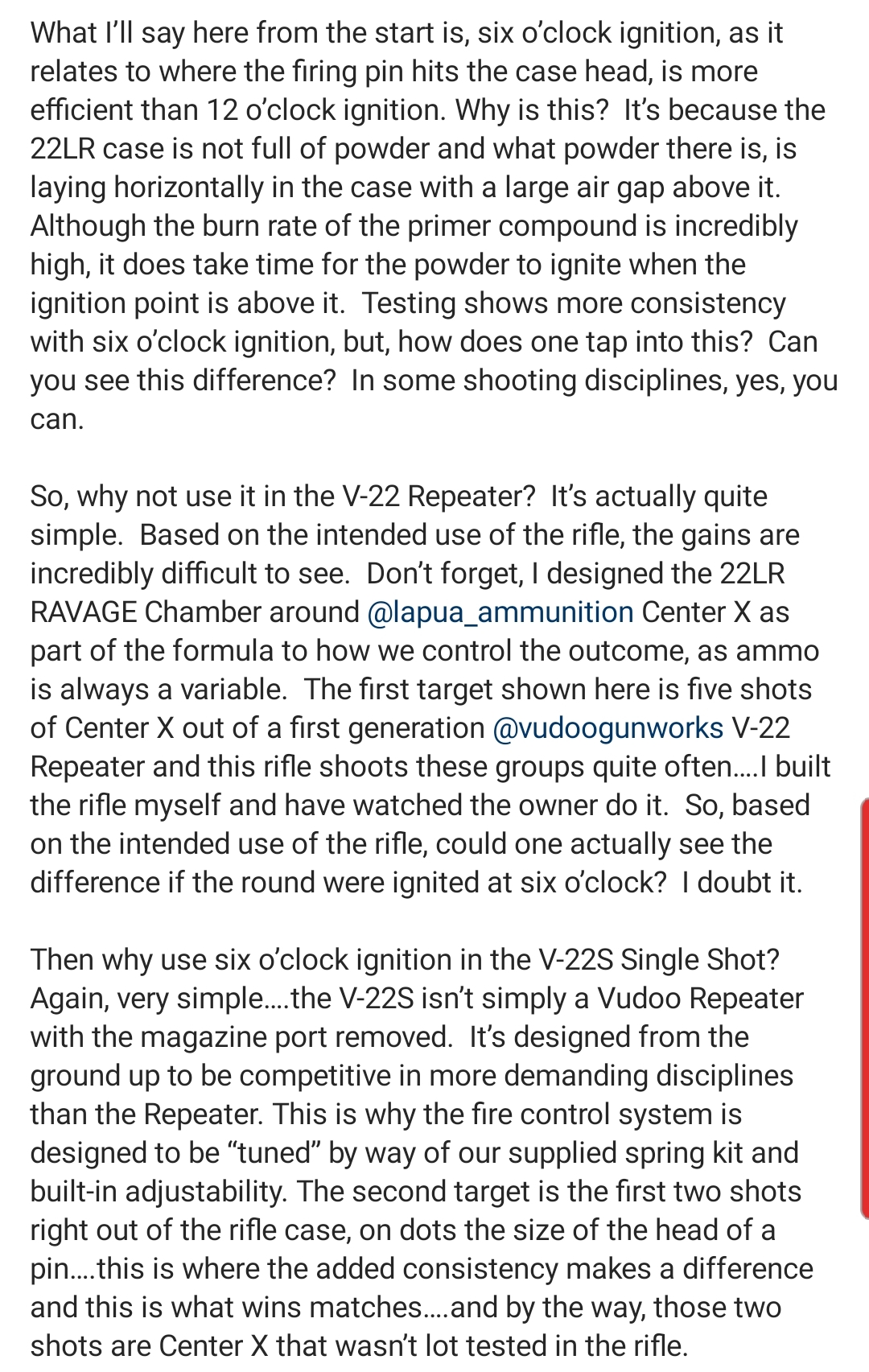

This is probably a stupid question. But, has there been any thoughts of trying a 6 and 12 o’clock firing pin? Maybe even a 4 point firing pin to stabilize ignition. Just some thoughts I’ve have while reading about the problems that occur during pin strike.
This is a screenshot of Vudoo Labs Instagram post in regards to firing pins....
If that helps
Reactions: Mikes733
This was done (not by me) and didn't yield any significant advantages or improvements.

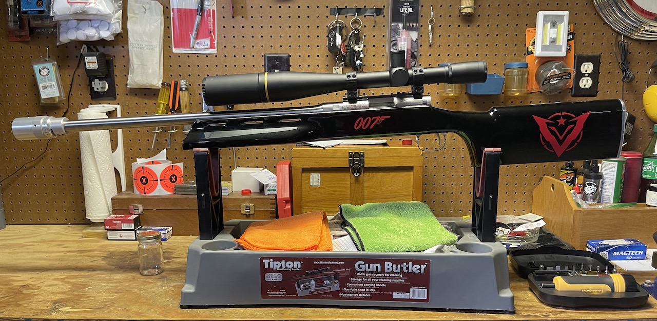

Beautiful rifle and Jerry told me recently he's shooting "007" at the Triple Crown. We sent him a handful of Vudoo shirts for the "BIG STAGE."
MB

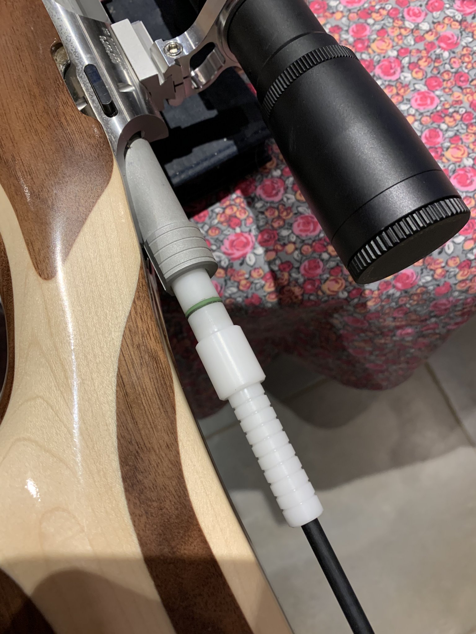

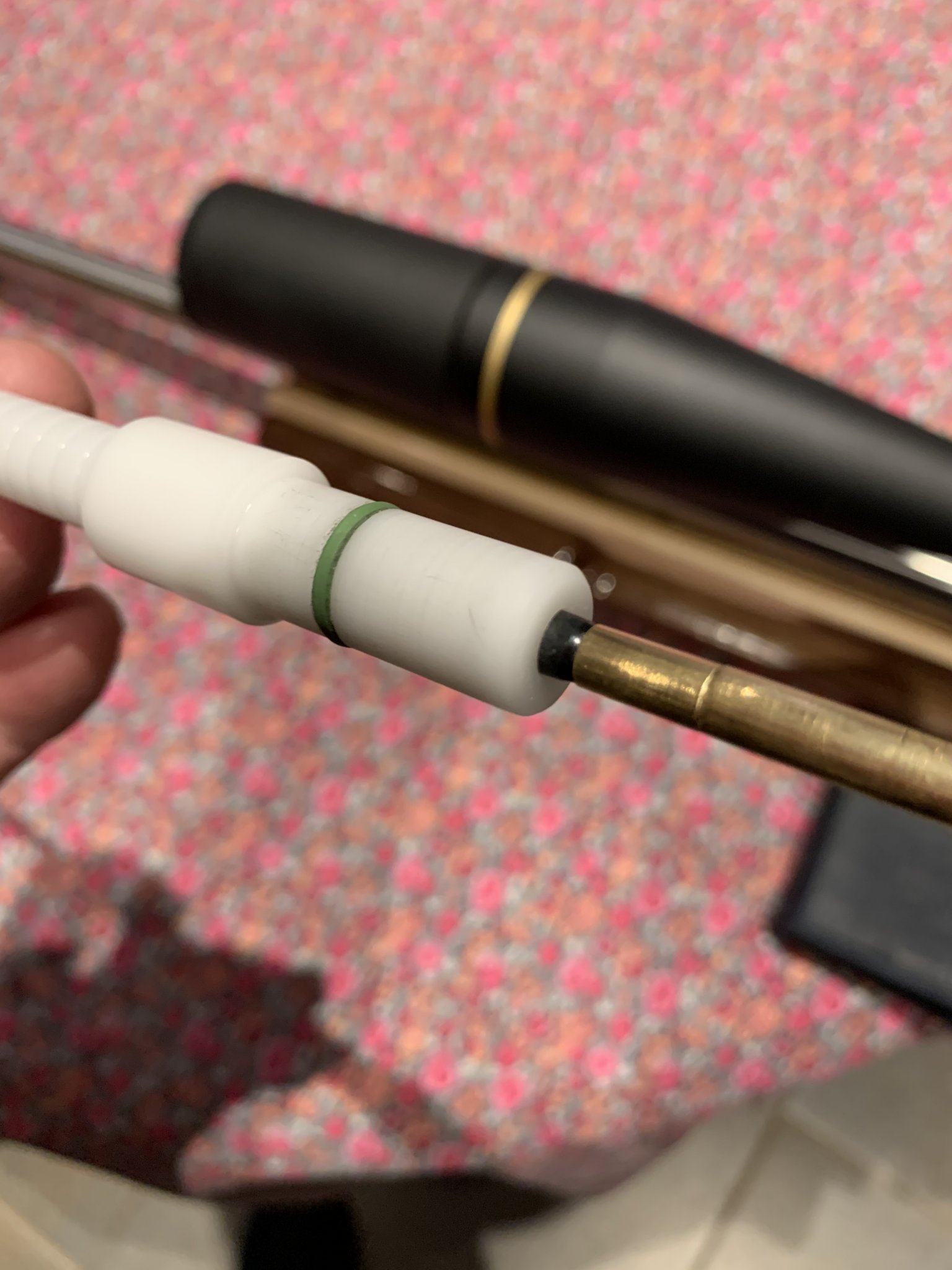

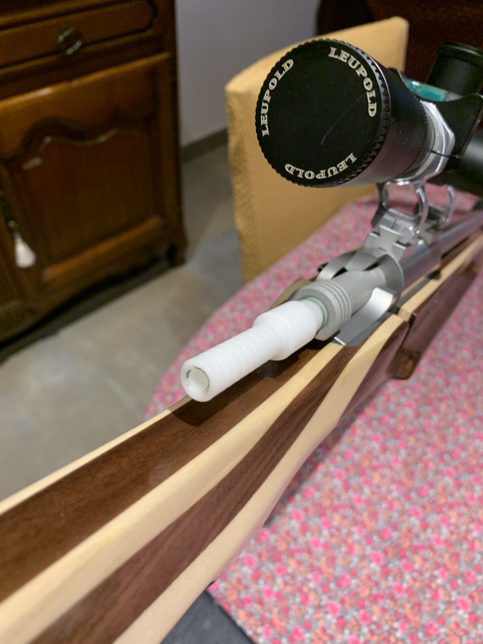

Hello
On a SHILEN Ratchet 22lr barrel I use a DEWEY rod of 0,187" with a spike tip and a 1 1/8" diameter patch
I had a rod support made whose bore is the same size as the DEWEY rod, this support fits into the guide that is housed in the place of the mobile breech.
the advantage is that I am perfectly centered for the entry in the stripes.
I use 3 dry patches to remove the combustion soot and then a patch soaked with triple action oil solution Iosso (I find that the patch is more colored than with the rimfire), then a single stroke of bronze silk brush (without going back and forth).
then I put x patches to obtain a white patch and with a felt cylinder coated with Gun oil at the end of the stem I just go back and forth. and that's it
I did a vision test with borrescop after removing the soot and unplumbing, the aspect is perfect the entrance of the scratches does not carry traces of carbon
the aspect lapping of the surface of this barrel is perfect (currently this barrel has fired about 2000 rounds).
I can shoot 4 cards without cleaning and without noticing a change in accuracy.
My ammunition is exclusively LAPUA X ACT /M+ as I have already explained I select my batches by trying at home at 30m in indoor judging on the roundness of the grouping, I do not select the clovers nor the oblong holes.

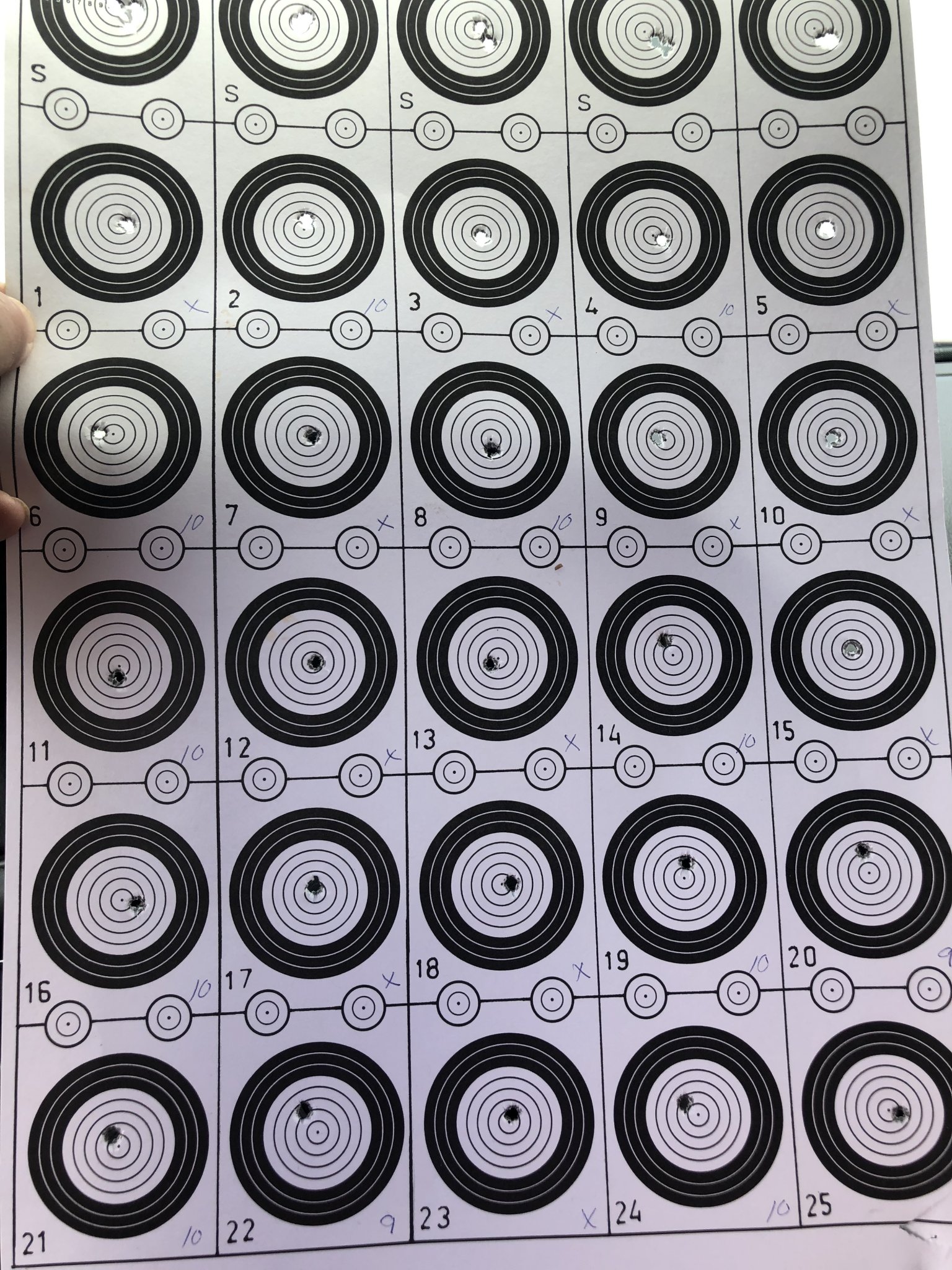

I called M. Ezell from France, and i really felt that i was bothering him, requesting where to buy.
Like Jacques, i am awaiting my V22S from my gunsmith, Luc Brouquier.
Here attached my turbo V3 for the french championship.
Patrick

Interesting, can you show a pic of your home made rod support? What a mobile breech?

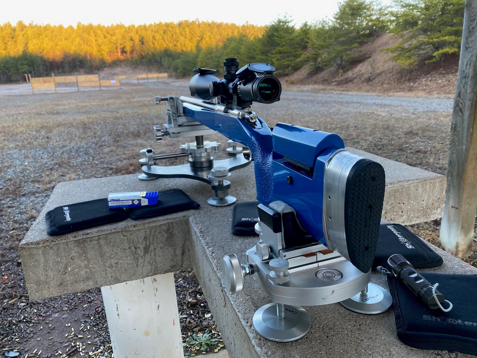

Learning to Shoot. Combo of Technique. Rifle. Rest. Ammo. Wind.
Last week and this week have been my best Match Scores so far. 250-21x last week. 250-20x this week. (I know, slipping...)

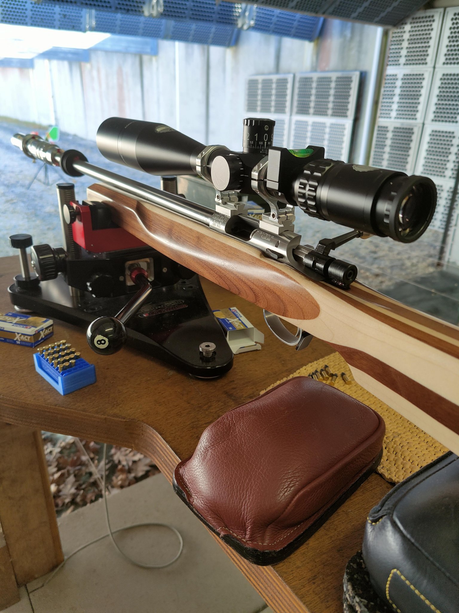

Pic of Vudoo Single Shot, Using different rear rest than the pic. Protektor Rabbit Ear, Slick Silver.
Love my Vudoos. Great pieces of equipment. I am just trying to catch up to their potential.

without tuner and with which barrel? center x ammunition?
I see no flag, no wind during the game ?
perfection!!!!!
Yes, Tuner, Harrell's set on 2.05. With Limbsaver Deresonator, bull barrel. Yes Flags but the wind was not fierce. I tend to pay more attention to how shots hit the paper. If tending upper left, I aim lower and right a bit but "do not give the hole away". Pics of gun were in a different time. Just practicing. Targets were from our Thursday AM matches. each week. Wind from right and rear this morning. 22" Shilen Barrel. Received my V22S in December last year. Still learning. First time I have ever shot Benchrest. Shooting Eley Black Box. Weight Sorted. 51.10/.12 grains last week. Heavy, 51.30 to .70 this week. Black Box seems to do better than the Lapua Midas + though it sorts better.
4Certain
4Certain
