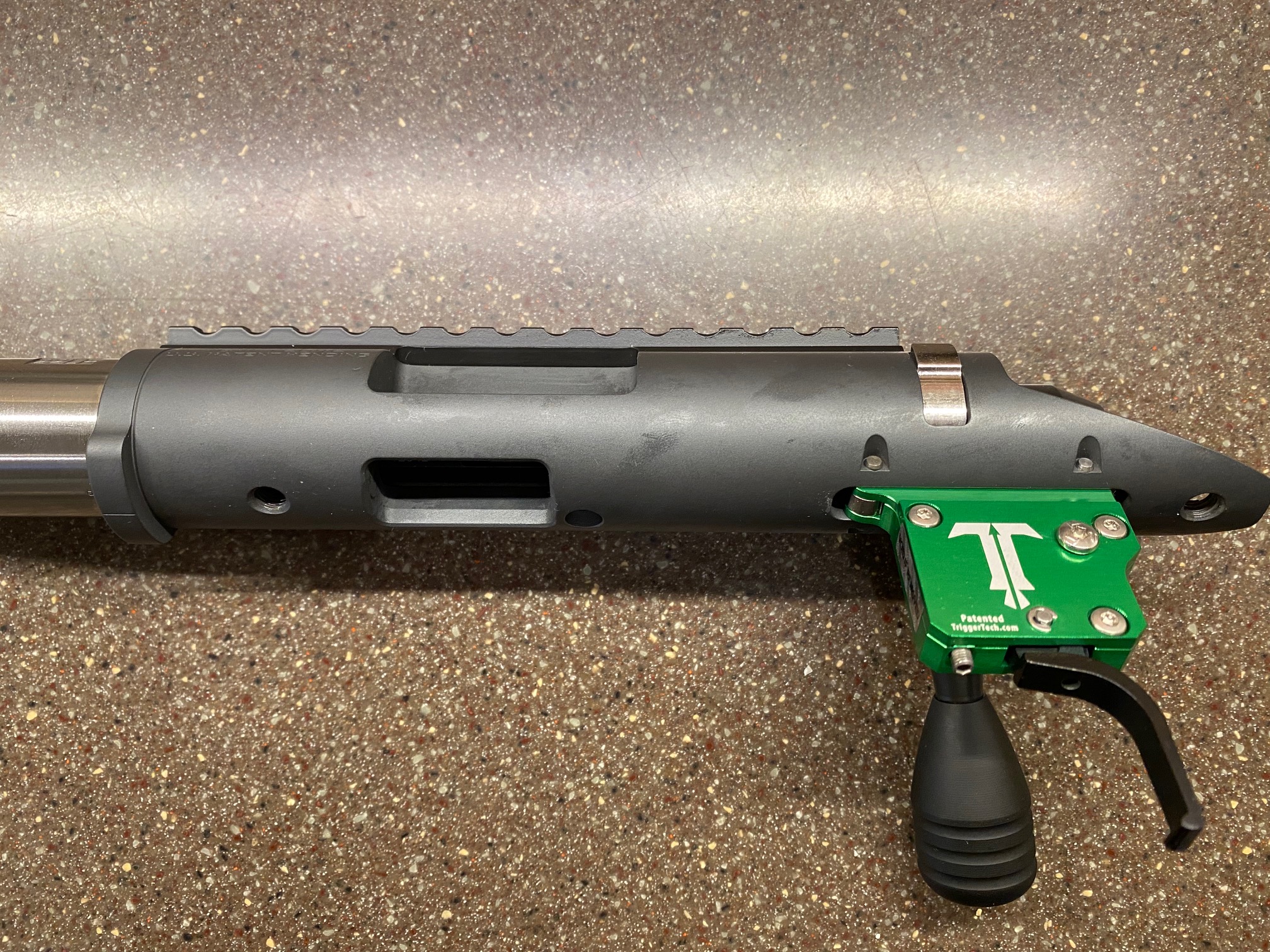

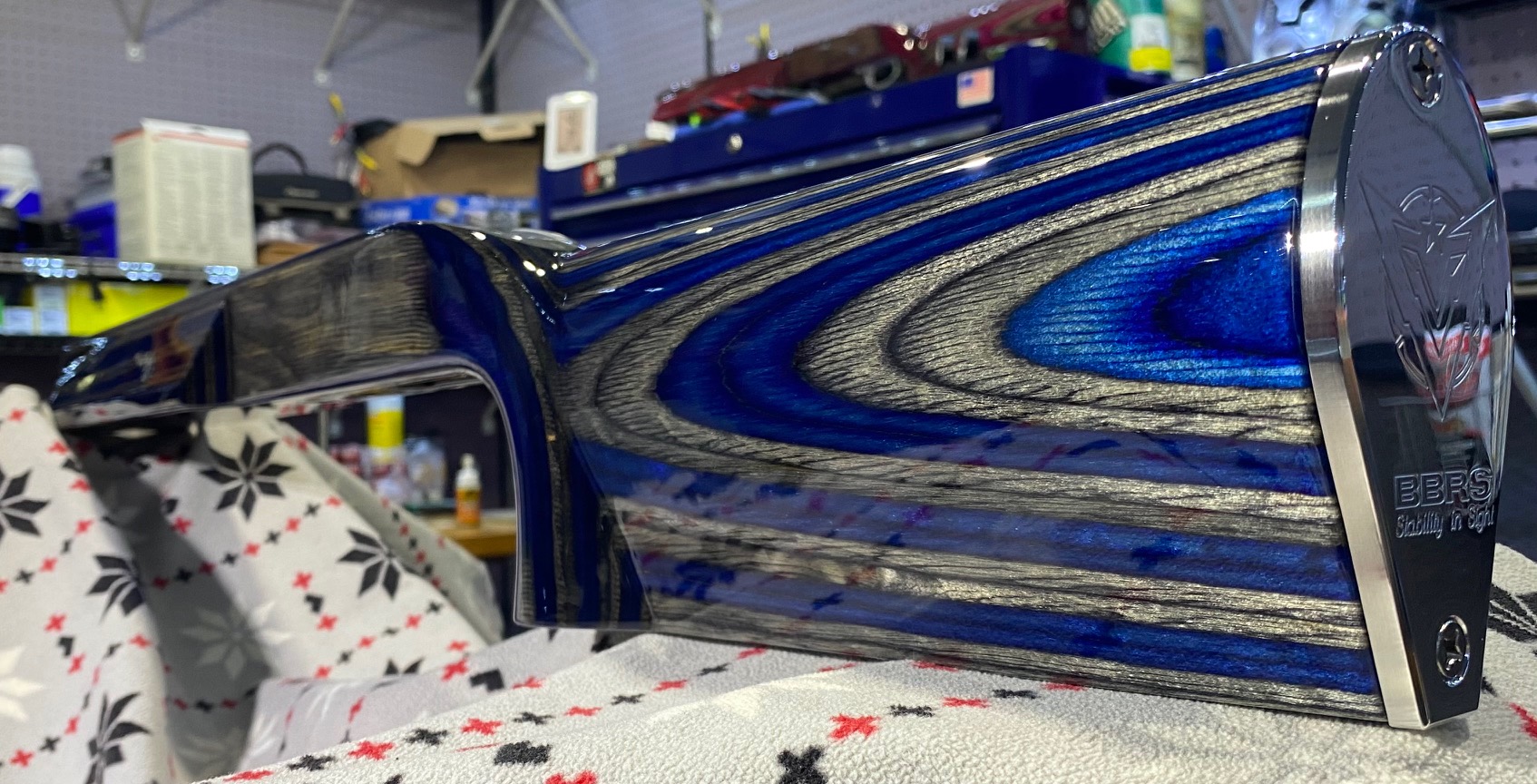

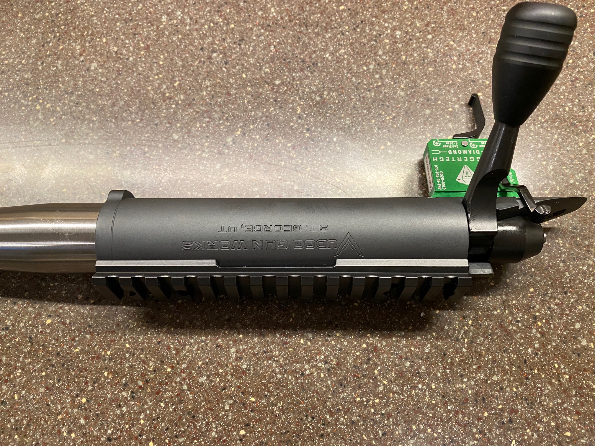

Good morning Vudoo Friends.

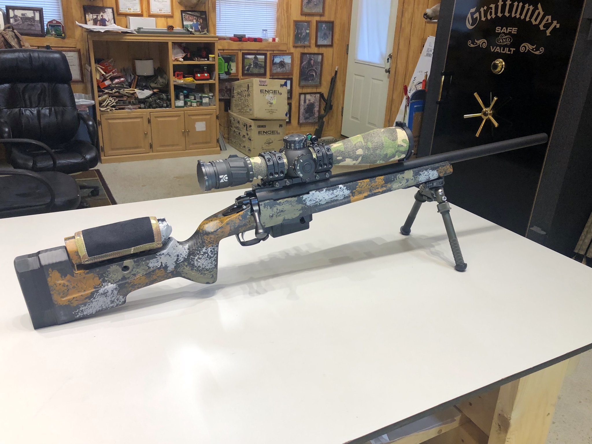

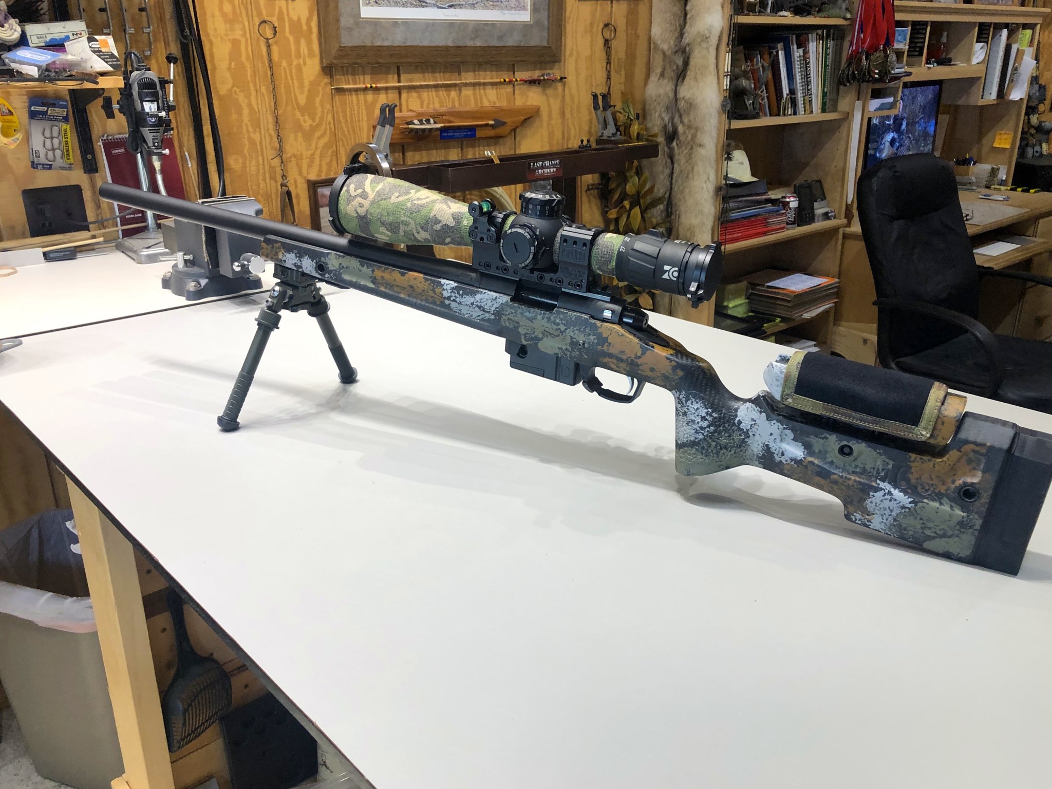

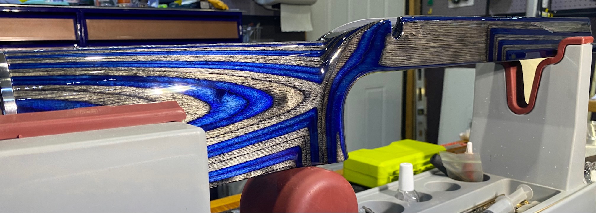

Well, I loved my RBLP V22S so much that I wanted a repeater in that set up. I love being able to look into the chamber without having to stand on my head to do so. I like being able to see when mags are empty... Ordered Mid-June and it arrived Yesterday. Not shot yet... Hopefully tomorrow morning... But it looks great. I got it set up in an MPA BA Comp Chassis. 20" Bartlein Barrel. Trigger Tech 2 Stage Diamond. I ran a mag full of Eley Match and it put them in and out nicely. I was going to wait till I shot it to post, but had to take my wife to Carti this am so I missed this shooting day... maybe tomorrow or next Wednesday...
Attached are some pics for your enjoyment...
Shoot straight and enjoy the ride.
4Certain
3-60 RBLP Repeater Action 1.jpg3-60 RBLP Repeater Action 2.jpg3-60 RBLP Repeater Action 3.jpg3-60 RBLP Repeater in MPA Chassis 1.jpg3-60 RBLP Repeater in MPA Chassis Bolt Side.jpg3-60 RBLP Repeater in MPA Chassis.jpg

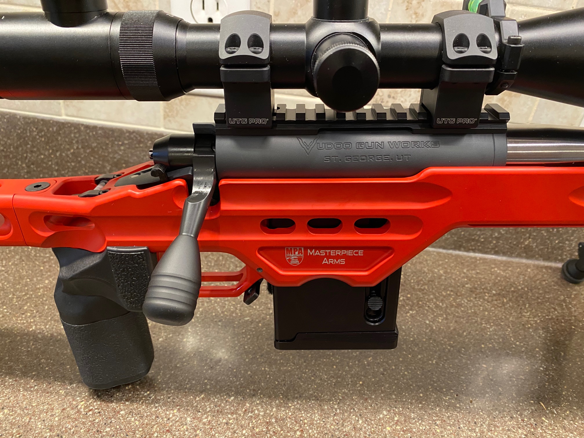

4Certain
View attachment 7772318View attachment 7772319View attachment 7772320View attachment 7772321View attachment 7772322View attachment 7772323

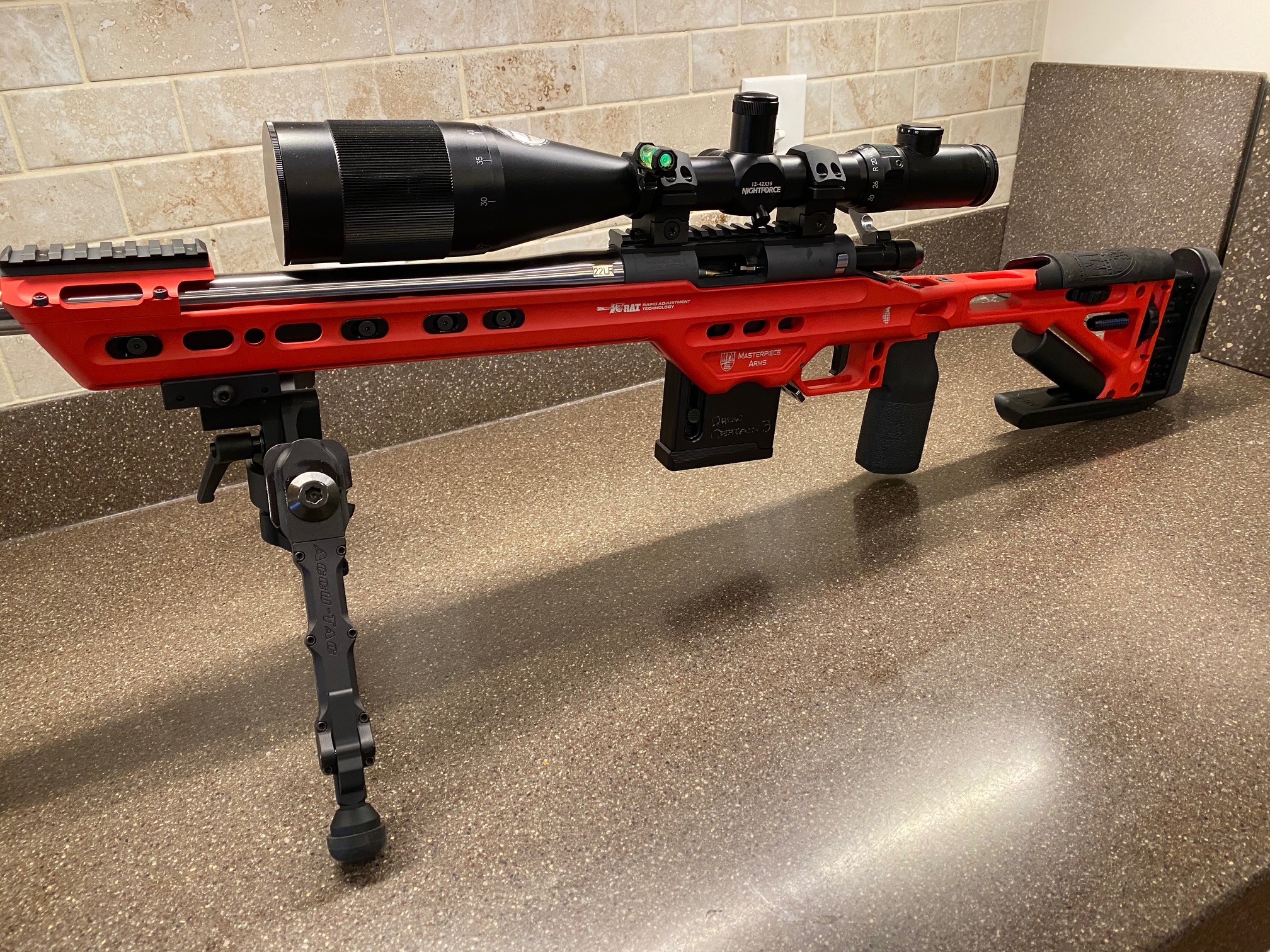

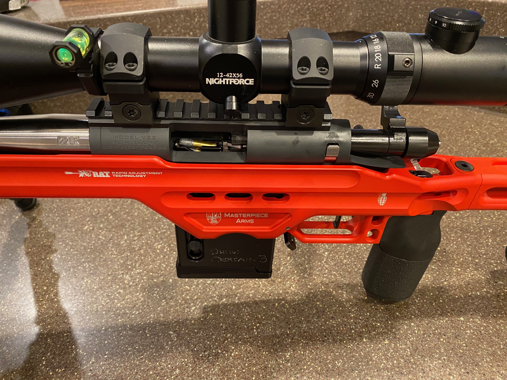

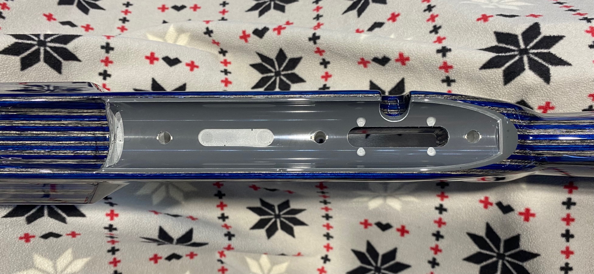

is there a beeding in the MPA BA chassis ?
Good afternoon Riberac.
Not bedded in the classic sense. But the Chassis Interface with the Lug, the Lug Lock and Recoil system has worked quite well for me in both my Repeaters and my Single Shot.
All the best.
4Certain
See the instructions from their website:
  • Make sure the recoil lug clears the round cylinder that is part of the lug lock system. Check out this video to better understand the lug lock.
  • MPA Chassis now use a Wedge Lock Action screw system. This system utilizes 2 washers with each action screw. The washers should be installed with the small serrations facing away from each other (towards the fastener head and chassis).
  • Using a 3/16 hex wrench, place the short action screw and washers onto the hex wrench and prepare to insert into the front action screw hole in the chassis.
  • Place your hand over the top of the barreled action and chassis to hold secure while you insert the Short Front action screw into the chassis, allowing the screw to engage the threads in the action. Just get the screw started, but do not tighten.
  • Using the same 3/16 hex wrench, install the Long action screw into the Rear action screw hole in the chassis and get the threads started, but do not tighten.
  • While still holding the chassis and barreled action, turn the assembly up so the rifle is sitting on the buttstock. This puts all the weight of the barreled action on to the recoil lug in the slot in the chassis.
  • Using the same 3/16 hex wrench, snug up the front action screw, then the rear one. Do not over tighten these action screws.
  • Using an inch lb torque wrench, torque the front action screw to 25 inch lbs or just past hand tight. Then do the same for the rear screw.
  • Then go back to the front action screw and torque to the final spec of 65 inch lbs. Then return to the rear and do the same.
  • It is very important that you always start with the front action screw, then the rear, in that order.
  • Once both front and rear screw are tightened to 65 inch lbs check wedge lock impression by listening for the audible pop and feeling the fastener break free. See full video for details. .

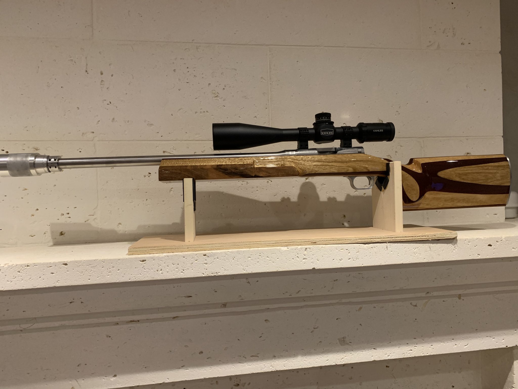

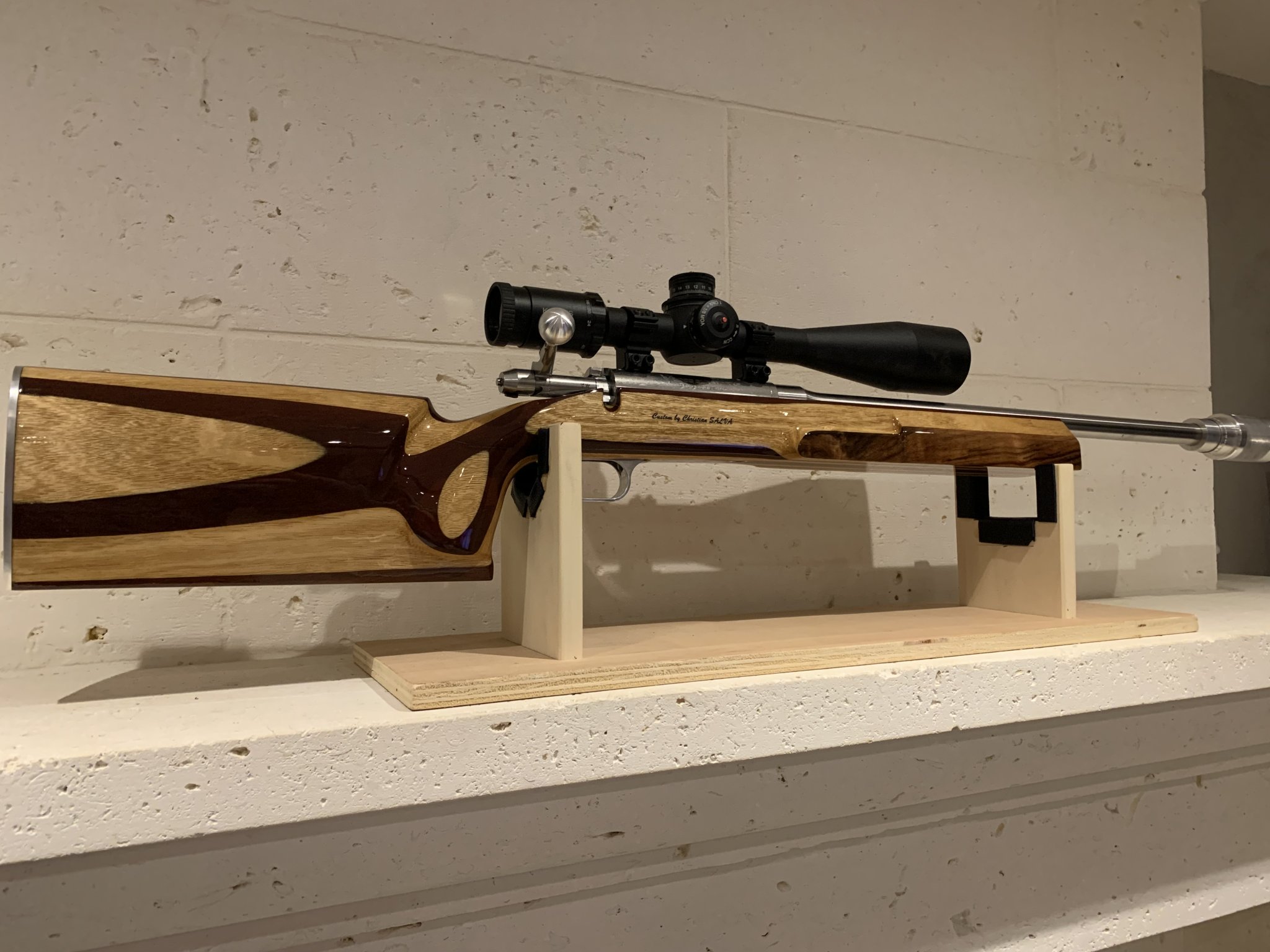

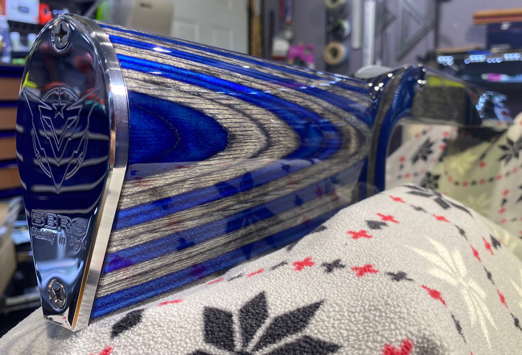

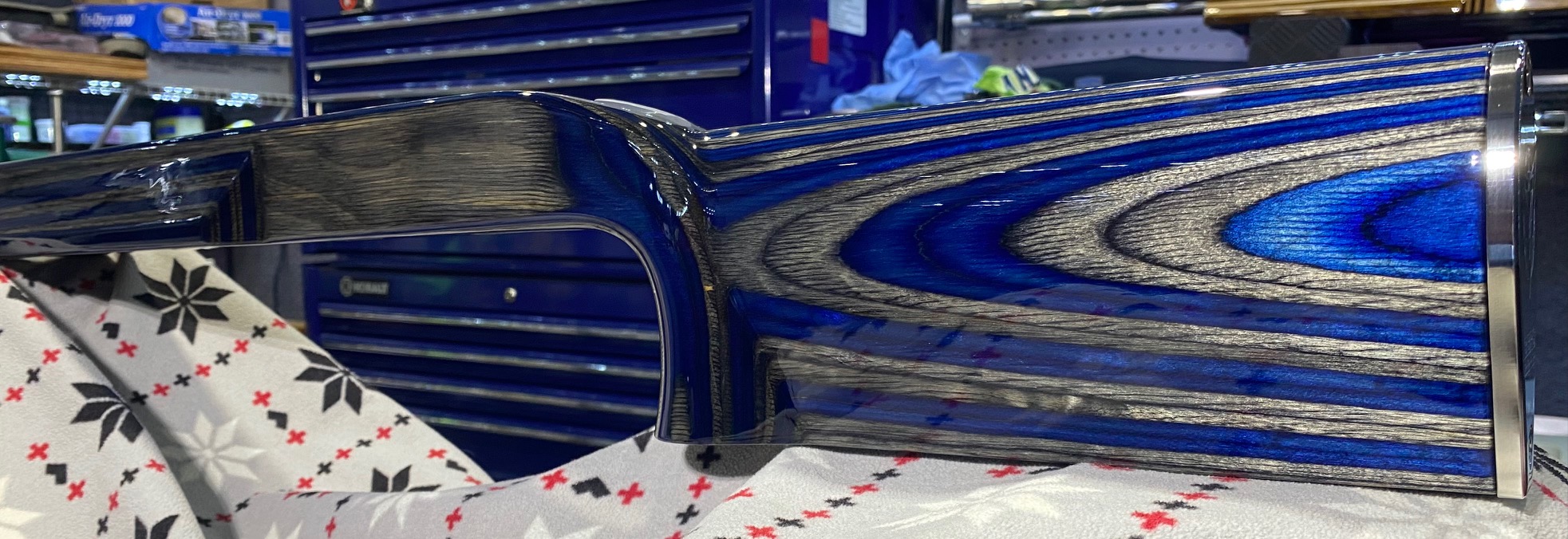

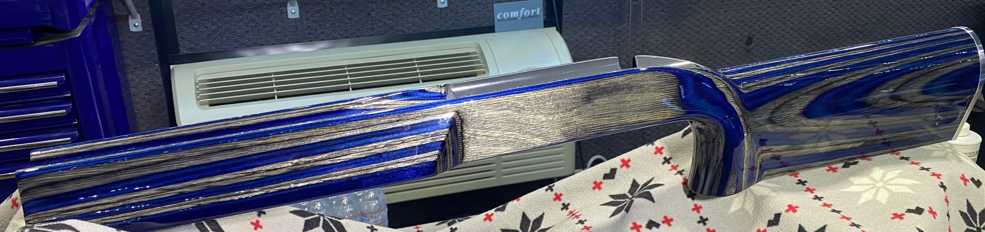

I would have to agree with you 4Certain, the RBLP is the way to go! I ordered mine early June and got it last week. What a great Christmas present to myself! I've taken it to the range a couple of times and it functions and shoots awesome! Mine is set up for NRL and (with a quick scope change) should work great as a backup and or loner F-class rifle. This gun has a 24" Shilen barrel in a heavy palma contour, 40 MOA base, ZC 5-27, Manners PRST1 stock and a Bix'n Andy competition trigger. This is my 4th Vudoo and they have all been hammers!!
Shane
Shane
View attachment 7773105View attachment 7773106
Good morning Shane.
A very beautiful Rifle Indeed! Sweet!

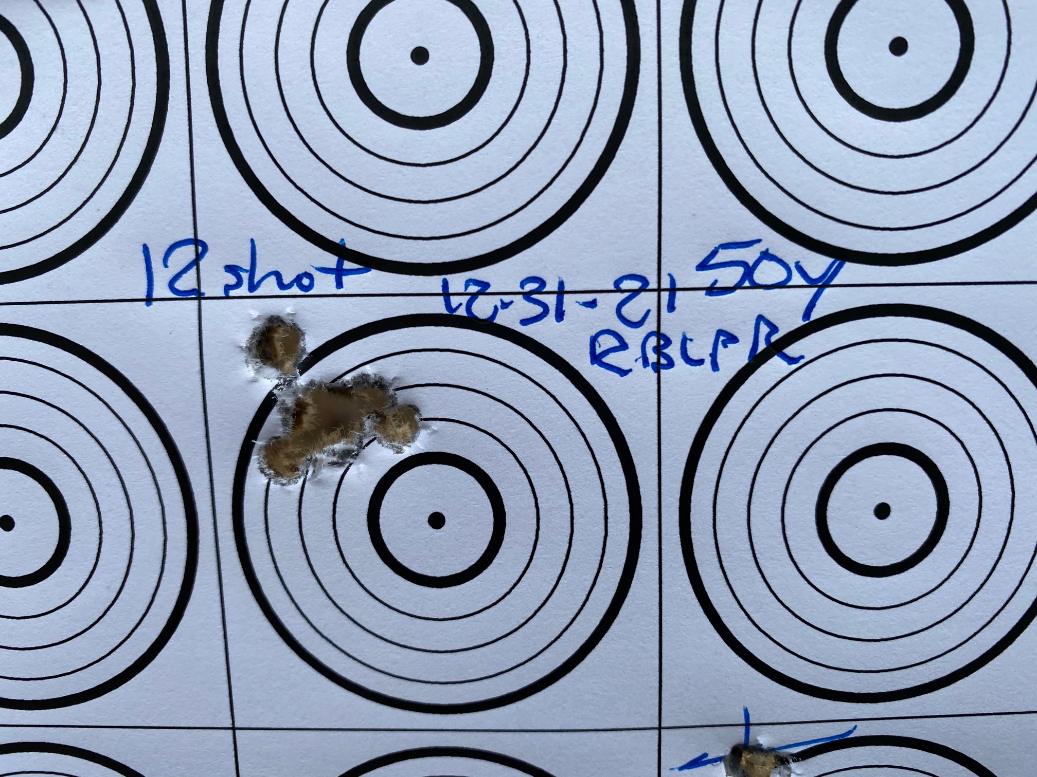

Good afternoon Vudoo lovers.
I was able to shoot a bit this morning. The bench was a wobbly wooden bench. Not nearly as stable as our Concrete Benches at our club.
But it was enough to learn more about my new 3-60 RBLP Repeater. All Groups at 50 yards. The inner dark ring on the targets is 1/2" out/out.
First Target is an odd box of Eley Black Box. 12 Shot Group.
The second target, all 5 shot groups, was shooting Eley Black Box. Then Eley 10x. Then two groups of Lapua Midas+, Then five targets shooting the Eley Match Black Box weight sorted to 51.06-.08. The final group was wonderful! Hope that is my 'normal'! Ha!!
4Certain
12 31 21 3-60 RBLP Repeater 12 shot group Eley.jpg12 31 21 3-60 RBLP Repeater Ammo Testing.jpg
4Certain

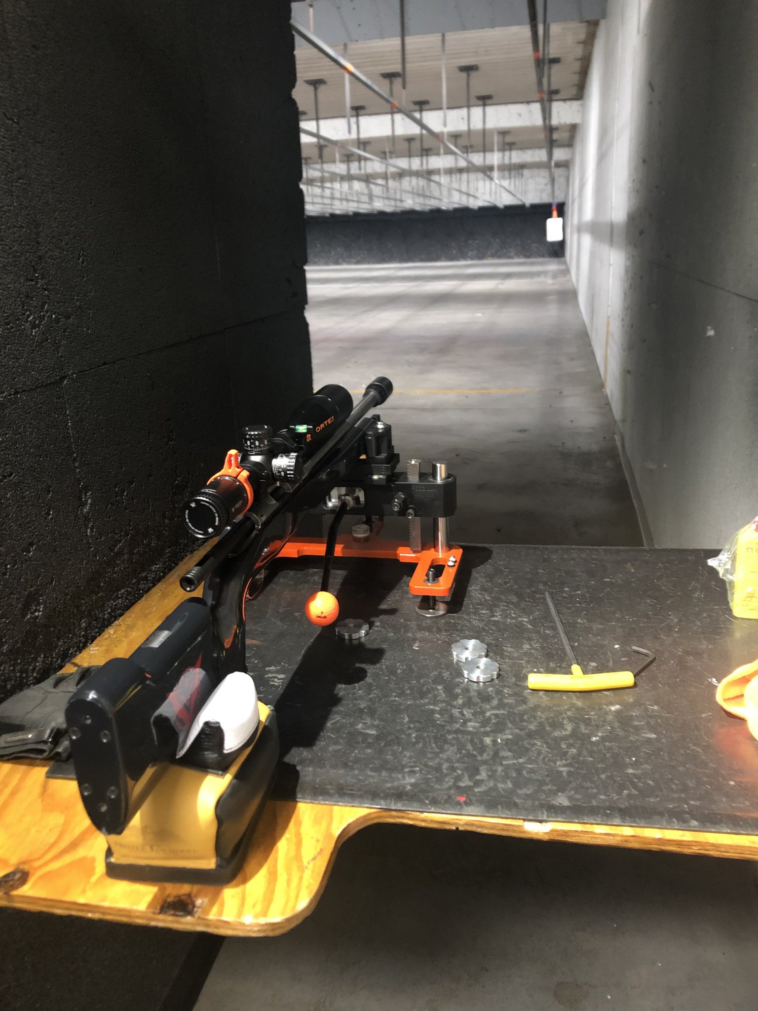

I was hoping to get some suggestions to over come the issue I have with the muzzle moving left at ignition . Three position and metallic silhouette are what i did most of my shooting life bench rest is a new adventure started late in life to allow me to continue shooting with life’s issues such s spine damage and arthritis
F4 plt, what rest setup are you using? That might help us understand what your issue is. For a true benchrest shooter, you don't really touch the rifle other than the slight touch on the trigger to fire the round. So you might want to try to stay off the rifle, no shoulder, etc, and shoot free-recoil. I use a one piece rest (PQP Lite rest from Killough Shooting Sports) which assures alignment from the front to the rear when I shoot. All I need do is push the rifle back up to the front stop, and my point of aim is right where it was before the shot. If you're using a two piece rest, again, try shooting and don't touch the rifle other than the trigger to fire the round. A rear bag can cause what you are seeing if you are putting pressure with your shoulder on the stock. Just a suggestion to try out.
Good morning F4.
I cannot tell you want is happening with your set up. But I can tell you want I experienced. When I was using a very stable but fixed front rest and a fixed rear bag, there were numerous times I saw my point of impact move left, at ignition. I would have the rifle aimed well. Trigger the shot and Boink, off to one side. Seemed Crazy to me. I was not touching the rifle in any way. I was using the pinch method to fire the trigger with just my thumb behind the trigger guard. That was not affecting my shot. I watched that very carefully.
What I ended up feeling was there was a very small amount of Binding or Torque between the rests and the gun due to panning the rest from target to target. I initially solved that by pulling my rifle Fore and Aft on the bags several times with my fingers on the trigger guard before each shot. I would slide the rifle Fore and Aft and readjust the aim point until when I slid it fore-aft the point of aim stayed at the correct spot. This worked pretty well and solved most of the weird left shots.
Once I changed my Front Rest to the T-Rex Rodzilla, the issue became much less because that rest has a Very Smooth rotating top rest for the rifle. I also put my rear bag on a Lazy Susan. That way neither the rear bag nor the front rest would bind on the gun. I still slide my rifle fore-aft to aid in everything being in sync. But it happens so much more quickly and easily. I even wonder if it is necessary with the T-Rex rest and rotating rear bag.
Let me know what you discover.
All the best.
4Certain
Thanks for the comments, I use a Randolph front rest and a rear bag. Think the rear bag may be the issue. I make sure I return the rifle to battery in the front rest but the rear bag does not feel solid. I like to keep light cheek pressure on the stock and with arthritis in my trigger hand I don’t always feel I have anchored the rifle butt in my shoulder pocket, that combined with the rear bag may be the issue. I’ll work on it and hopefully take some videos. I’m not planning to get serious in bench rest it’s just my competitive spirit that pushes me to be the best I can. Health issues with my wife limit my shooting but it is great therapy for me . Again thanks for the comments
You could try placing a USED dryer sheet under the forearm in the front rest, and under the stock on the rear bag and see if that reduces the binding you may be having. The dryer sheet will allow the gun to slide a bit more freely when fired. IF the Randolph rest has ears with adjustable tension, you may need to "piddle" with those settings as well to get the rifle to track better.
You may need to add some filler material to the rear bag since you state "it does not feel solid". Does the rear bag have a solid bottom or soft bottom???
Make sure rear bag has hard bottom and heavy sand. I tried finger pinch with left hand, pulled left. Back to right now with lighter trigger and don't wrap thumb around stock, have it floating above finger. I just started 1 1/2 yrs.ago and no one from club gave any information away. Really got into it last year with an Annie 64. Last Aug. I order Vudoo single shot- left port, right bolt. Again its just to better myself, it gives me something to do etc., order scopes, barrels (CZ457). Its really addictive !!! Plus I won 5 -200 yd matches last year.

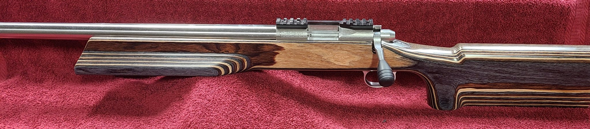

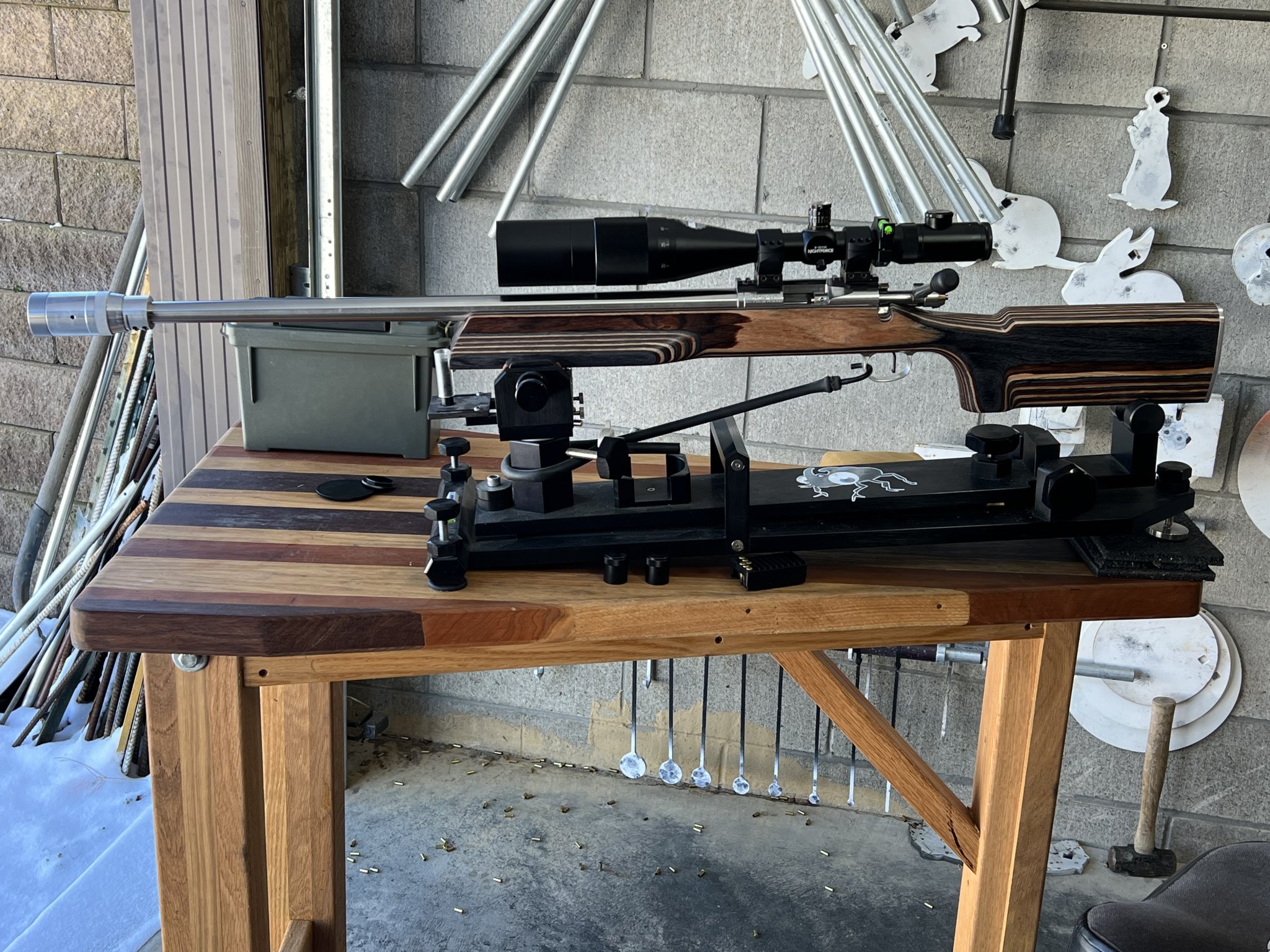

Well the new ROTEX unlimited stock made it to the door. It’s 6 degrees and windy so all I can do is get it all tricked out. Randy did an excellent job and I couldn’t be happier.
Well BillOH said that it needs to be shot so
Here’s the first 10 after getting it sighted in

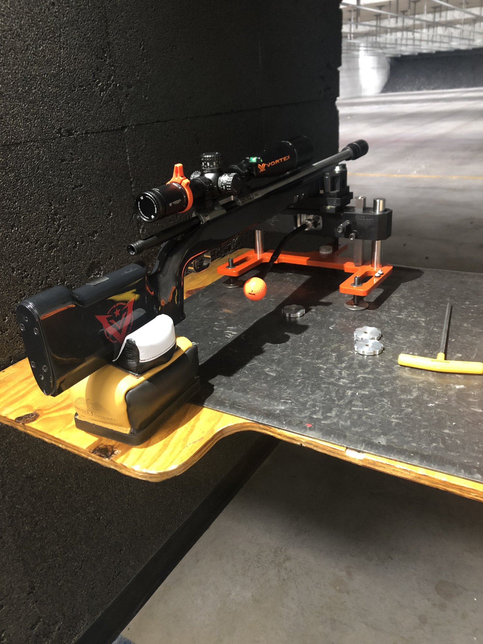

We have the same crap going on here in the Western suburbs of Chicago. I found an INDOOR 50yd range close by. It's not the greatest but it'll do...
GTI, are you referring to Gat Guns? I'm in SE Wis and drive down to do some testing at their 50 yard indoor range. HVAC is strong, and you get some vibrations but it's the only game in town....
Gat Guns is a nice, clean place now that they redid it, however it will not fit my rig. I need at least 3' to accommodate my front rest and rear bag. The range I'm talking about is "On Target" in Crystal Lake. They have a 50yd range with enough room for me to set up and be comfortable. I've attached a pic. What do you think?
DRACO, that's a really nice looking bench! Looks substantial enough to be pretty stable too - bet it's too heavy to pick up and toss in the back of a pickup truck... The old portable bench I built for myself a dozen or more years ago is pretty flimsy in comparison - used 3/4" steel square tubing for the frame, and only 3/4" plywood for the top. It's pretty easy to load in the truck, but there are many times that I've wanted to build something like the Colorado Rifle Club's benches for 1000yd BR, with nice smooth, 3" or 4" thick concrete tops & beveled edges, set on 3" upset tubing legs that were poured in place on their concrete firing line - or at least, that's how I remember it, and it's been about 12 years since I've shot there. Their club either paid a pretty penny to have a contractor build all 20 of them, or they had a really good turn-out of club members to get the job done.
Looks pretty good to me. I use a one-piece rest and lay the rest on the center spine on the 16 inch wide shooting station. At On Target, did you bring the plywood and the mat or did they have those on the bench for shooters to use? I'll have to check it out. I have a mid-barrel tuner coming next week, so I might have to make a trip there to test the tuner, see if I can find a sweet spot, plus check out the range.
Thanks for the info!
