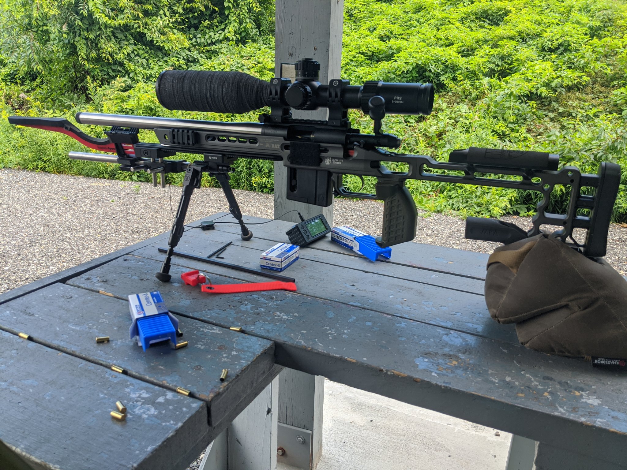

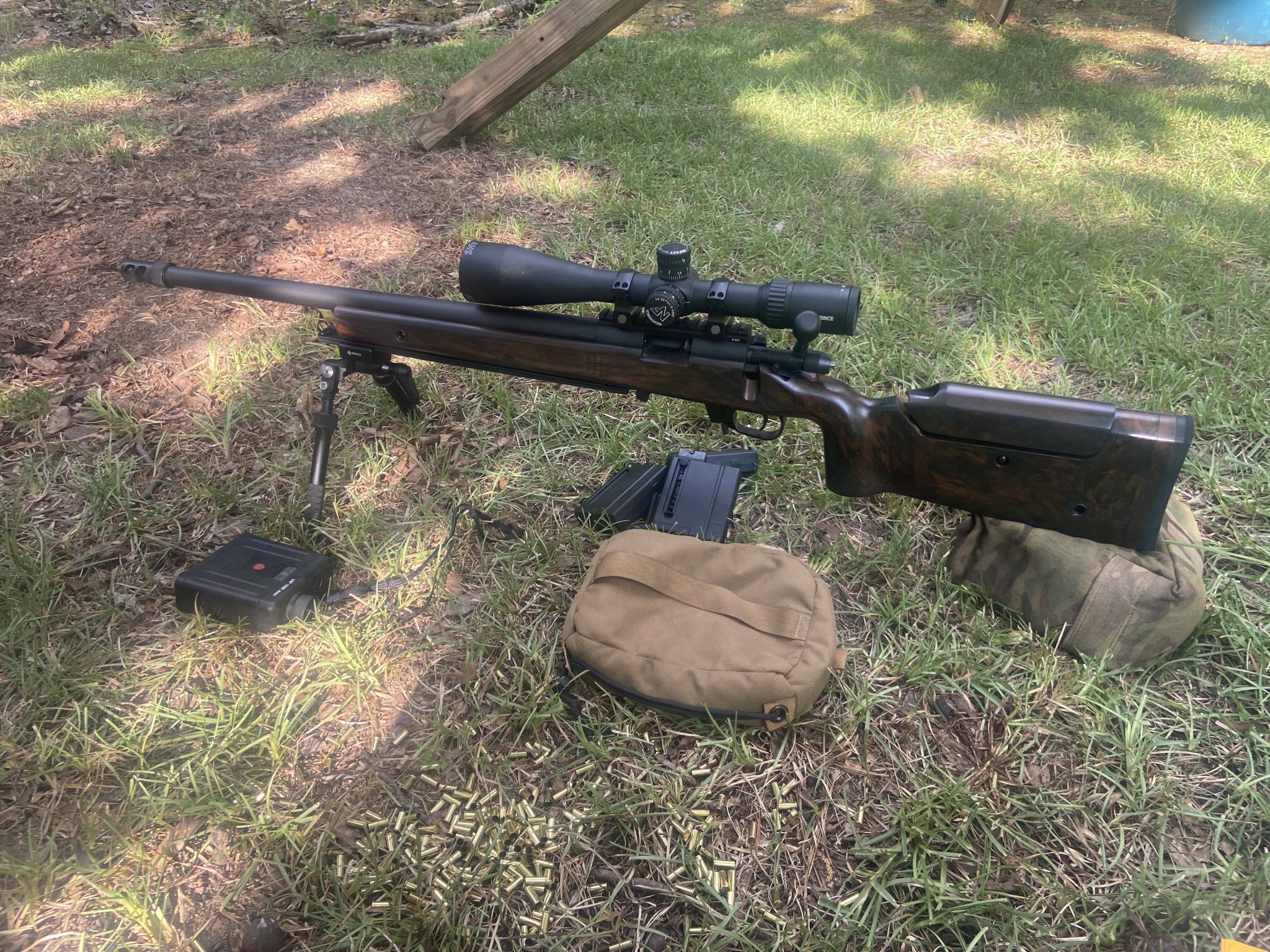

My vudoo made it home today and I got it put together and proceed to shoot 600 rounds through it. Everything thing worked great with the exception of when shooting off a barricade if any pressure gets put on the mag toward the rear from the bag it doesn’t want to feed. Anyone shimmed the back of the mag to counter this?

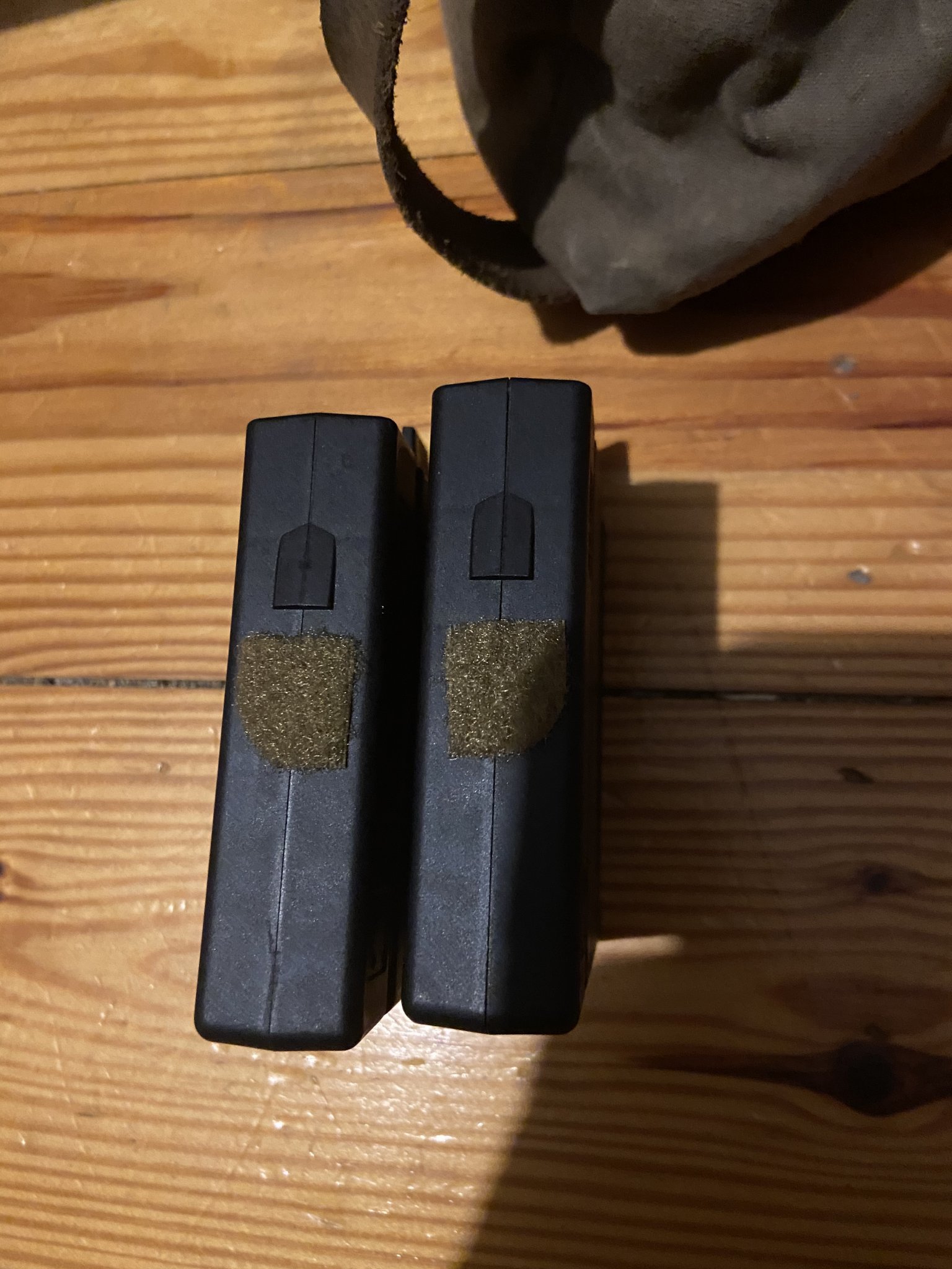

What chassis/stock is it in? I've had this problem with my MPAs. A small piece of fuzzy velcro on the front edge of the mag well solved the issue.

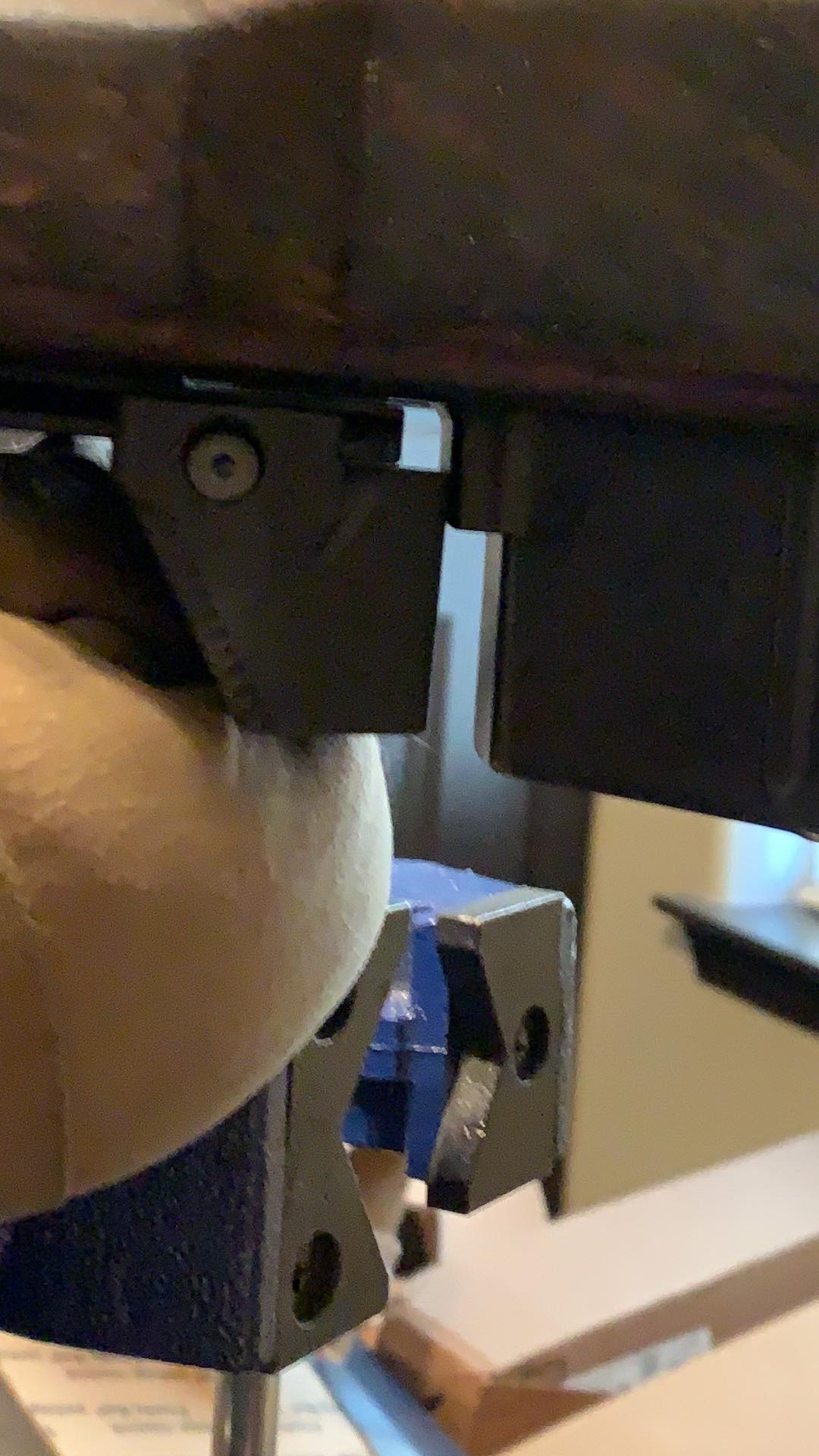

It’s in a foundation stock with Hawkins bottom metal. It seems like it needs something on the back side, the side closer to the trigger, to keep forward pressure on it. I’ll try some Velcro and see how it works. It runs flawlessly until a bag pushes back on it. Thank you.
You may find it isn't so much the need for forward pressure as it is to keep the mag aligned vertically. If the bag is pushing the mag back, putting the velcro on the trigger side pushes the top forward. So the mag is no longer square in the well. But, YMMV. Try both and see what works.
Ideally I would just be filling the space on the trigger side of the mag to prevent it being pushed back when jammed up against something. I’ll report back how it goes. May try it tonight

Are you running an arca rail? If so, put the area 419 barricade stop on it. You’ll never touch the mag on a bag again.

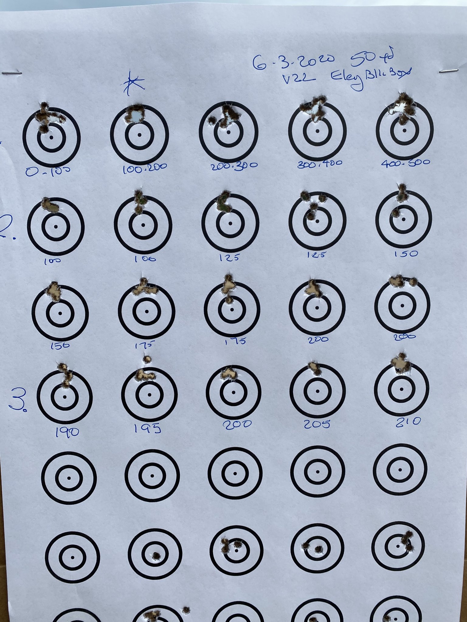

I don't know where to put this response to this topic of rimfire accuracy so i'll put it here and see where it goes. I have been shooting rimfire s for over 60 years. From cans in a field at 10 years old to IHMSA silhouette to squirrels in season. I've read and listened to anyone that wants to talk or write about rimfire shooting and accuracy. Here is what I have come to believe.Early on ammo was better than the guns. Now the guns are better than the ammo. As important as muzzle velocity, ES, SD are this has much more effect on the center fire game. It has less importance to the rimfire game. In rimfire we care mostly about consistency. Which we have very little control over in our ammo. There are some things we do have control over that are measurable. Rim Thickness and Weight. Why is rim thickness important? How many of you have taken a rimfire round apart? I would ask you to take 10 rounds apart and place them on a paper sheet. Dump out the powder and keep the lead bullet and case with the powder. I think you will be surprised to see how little powder is in each case. Now weigh each bullet an notate the weight on the paper. Now weigh each case and notate that beside each case. You will be amazed at how little powder is in each round and see the difference in the bullet weight. Now i'm sure you are wondering where rim thickness comes into play. Well the largest effect of the firing pin igniting the round comes from the primer compound. The estimate of the primers contribution to the total energy is 60-70 %. So you see that round that has a thicker rim has more primer at the point of ignition. You can tell by looking it's not the powder that's important to the total ignition. How close to the advertised weight is your bullet? That weight difference will make more difference than the difference in powder weight. Now the only thing we can control is rim thickness and weight.I rim gauge and weigh all of my match ammo. not my practice ammo. The rim gauge I use is by Raven Eye Custom at Raveneyecustom.com. I just added a Harbor Freight Digital depth gauge. For weight i use a small scale that can measure grains. Rim thickness goes by ammo brand and lot. usually from .034 to .046. If you rim gauge a box of 50 you will get one or two thicknesses for about 70% of the box. segregate those rim thicknesses and use the other to season your barrel after cleaning. After you rim gauge a brick then weigh each round of the same rim thickness and save the predominate quantity as match ammo. Now you have done all you can do that is under your control for consistency. Shoot all the other ammo that didn't make the cut for practice. You will generally see that higher price ammo has more consistency in the areas we are measuring hence the higher price. If you don't want to do all this work for match performance then you can just pay your money an take your chances. Good luck taking your chances with rimfire ammo!
RNailor2 you convinced me. I ordered a rim gauge by Raven Eye Custom at Raveneyecustom.com as you suggested. Will set up my Digital Depth Gauge and see what I come up with. Thank you for your post. While I have shot quite a bit of 22 LR before, it was always much larger targets. Like a Speed Steel Match with pistols and rifles. Beginning to shoot my Vudoo in Tactical PRS type matches changes the requirements. I moved from CCI 40grain Mini Mags to Eley Black Box Match. Now looking at Benchrest as well, it is a really big deal. Thank you for your thoughts. Good info. 4Certain

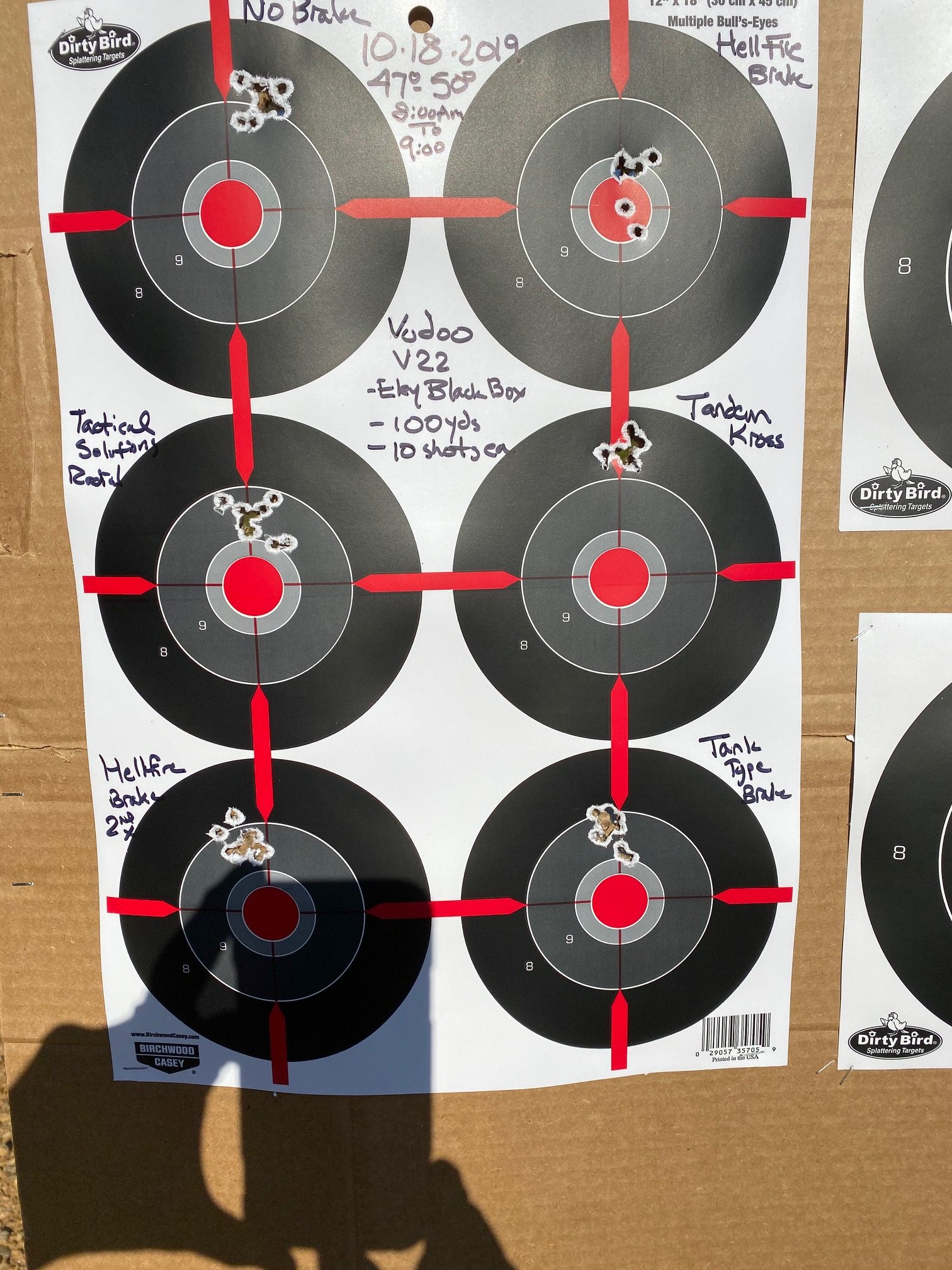

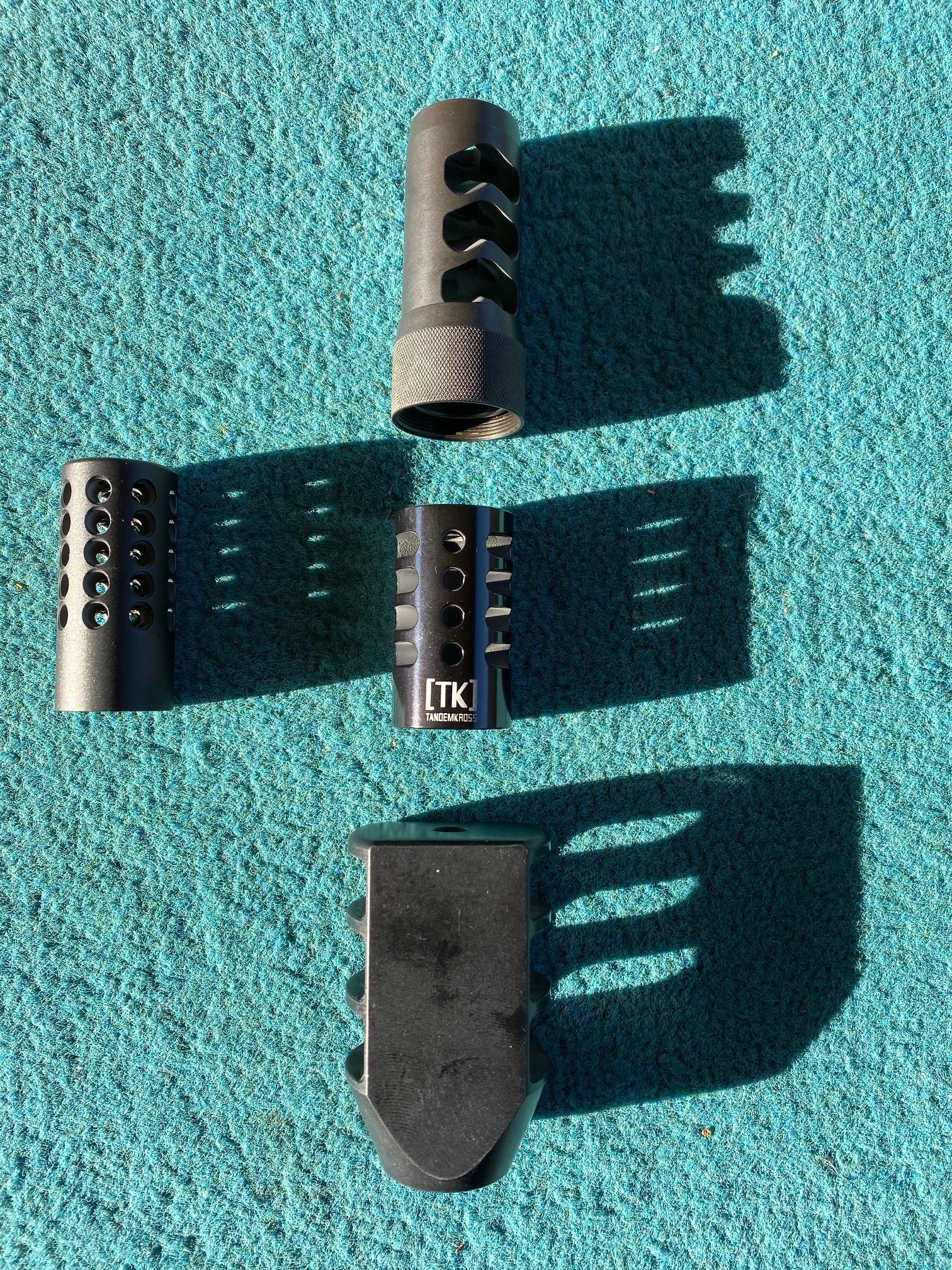

Good morning Rimfire Friends. I have recently installed a Harrell's Tuner on my Gen 1 Vudoo V22. I tried a host of brakes and had a 100 yard Brake "shoot off". Ten Shots Each. Eley Black Box Match. One sitting. One rifle. Pics attached.
After discussing this with a very good old time gunsmith, he suggested that my 'shoot off' showed that the barrel was indeed affected by 'harmonics' and a tuner might possibly be a benefit. So after some searching I ordered a Harrell's Rimfire Tuner. (GREAT folks to work with; and great equipment. I used the Hopewell Method for setting my tuner. Pics of the process are attached.
So far I am leaving it on my gun. I shot a target the other day at 259 yards. Small Tennis ball sized rock (or smaller) on a large white flat rock slab. Wore it out. I have not shot a Tactical Match since adding the tuner. But from the practicing I have done, it seems to be shooting quite well. The hard thing about that is the Vudoo shoots quite well all by its self! But I am curious. Has anyone else tried a tuner on your Vudoo? And with what kind of results? Thank you for your thoughts. 4Certain
  • Hopewell Method for Tuning your Tuner.pdf
