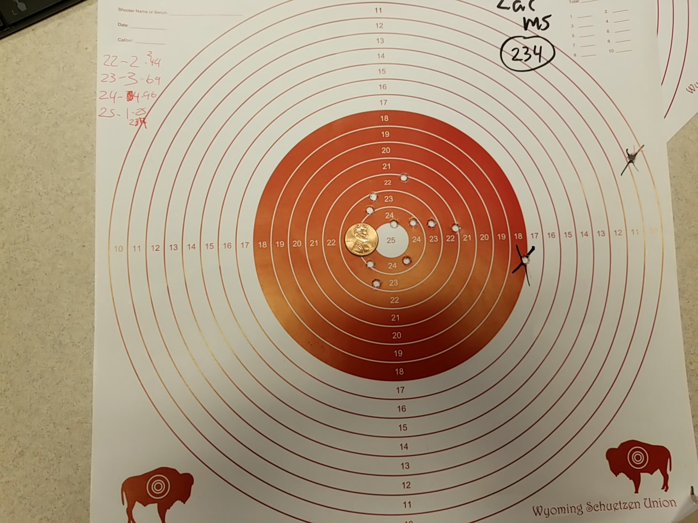

I finally got the Krieger installed on my V22 this week and got it out to shoot at 50yd. I put 150rd through the barrel, then I pulled a bore snake through it twice before proceeding with the below ammo testing.
Target below was shot from the bench with a bipod and rear bag @ 50yd. It was 93F out, dead calm and 60% humidity. The Kreiger shot really well, shooting better agg than my previous outings with the Benchmark and Green Mountain barrels installed. This lot of SK+ has just hammered in 9 different 22lr barrels with my chamber.

@padom:
I would like to have 1% of the money made on rifles sold because of your marksmanship. Hotel Sierra.
Reactions: CBeck and padom
Padom, nice shooting! I think Lapua screwed up and put that lot of SK+ in the wrong boxes. (y) It sure shoots like Midas+. It's good luck that you found such a great lot out of their lower tier ammo. I hope you bought all you could find.
Yea its shot great in so many barrels...i bought a few bricks when lot testing many many months ago. It was gone once I knew how good it was....I havs exactly 1 50rd box left...😢😢😢

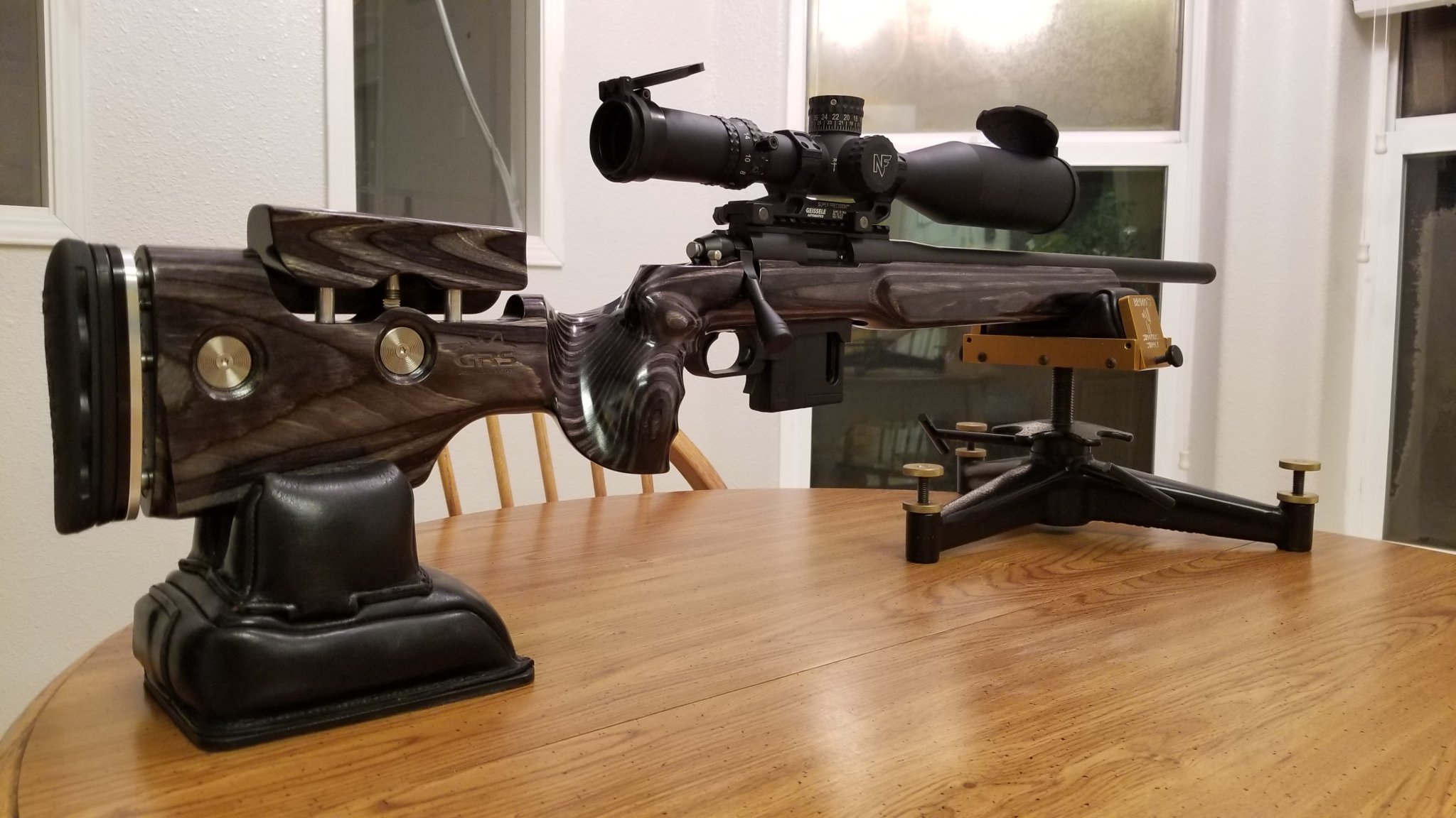

Playin' around with a few things today....
MB
Work of art. I don’t think I’ve ever been so excited on a gun purchase. At what distance are your shooting?
BTW do you have a picture of what color Vudoo Green is? It sounded cool so I picked it for my rifle even though I’d not seen it. I figured it would have to look decent if you were willing to put your name on it. If not I have some Krylon
Reactions: RAVAGE88
Thanks! That was 50 in a really twitchy wind.
I have a picture somewhere, but shoot Greg an email and he can get it to you quickly. The story behind Vudoo Green is, it was an accident that turned out to be a really cool color, so we wrote down how the accident was created and have replicated it quite a lot, hence the birth of Vudoo Green.
MB

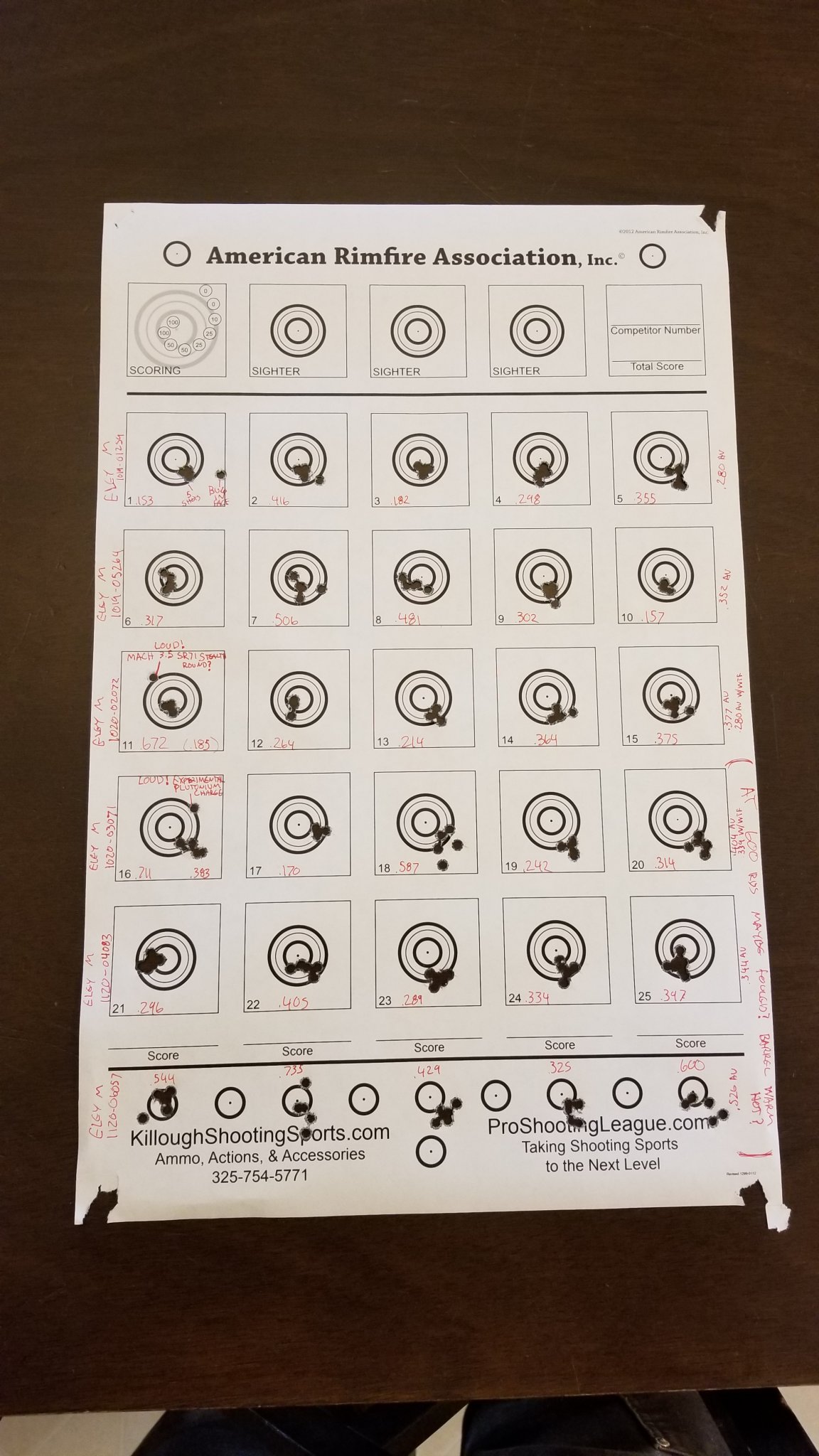

The Higher Location of the Mag Catch helped. During the Mini-Palma 45 shots, I only had two shells that did not feed right. That was much better than I had been having. One thing I saw was my mags were still not High and Tight enough. So today I worked on it a while. Now they are "Jam Up - Jelly Tight" against the bottom side of the frame. I did some feeding on my desk. They bullets went in better and easier than I have ever experienced. (Thanks Greg!) This is with the Aluminum mags. The Polymer mags have a little trouble clicking in. But with a little persuasion they stay. I may just touch the little mag catch step with a file to raise it just a smidgeon. But not just yet.... My next match will tell even more. But I am quite excited and hopeful that my feeding issues are almost over. That will improve my scores, I am sure. No more 'nicked' bullets.
I do think I need to order the Eley Followers for my mags based on what Mike Bush said. That will hopefully happen soon.
Stay safe and enjoy the process. 4Certain

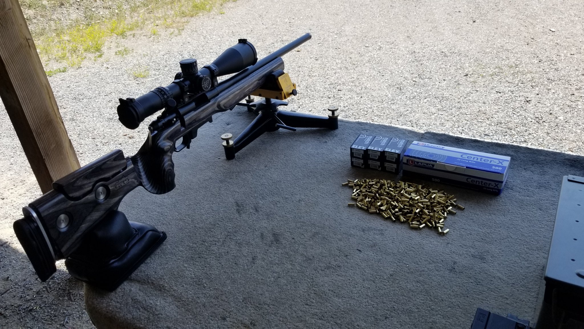

Just messin’ with ya Dude, I’m taking this rifle to the inaugural BulletPro 150 and was playin’ with ammo.
MB
From my limited experience, it seems trying to find the "Best Shooting Ammo" for a barrel is a Very DEEP Black Hole...
I suppose the best way is pick your favorites or the ones that have worked the best in the past and test, test , test!
But you working on a SECRET Sauce would not be out of character....
